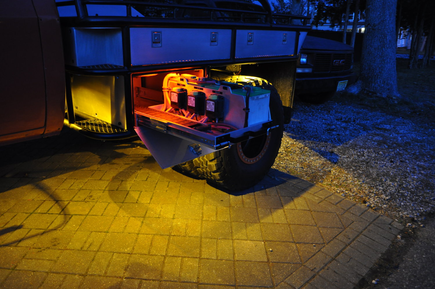

iffy weather tho....

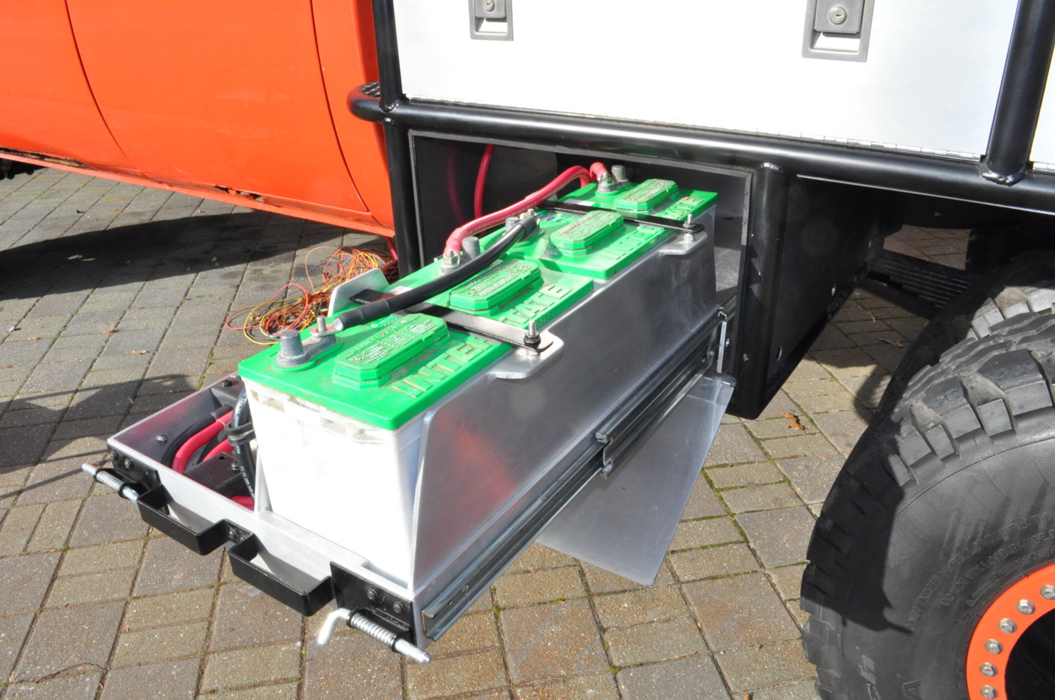

wish I still drank, I'd toast myself tonight.... I can't believe I pulled that sh*t off...

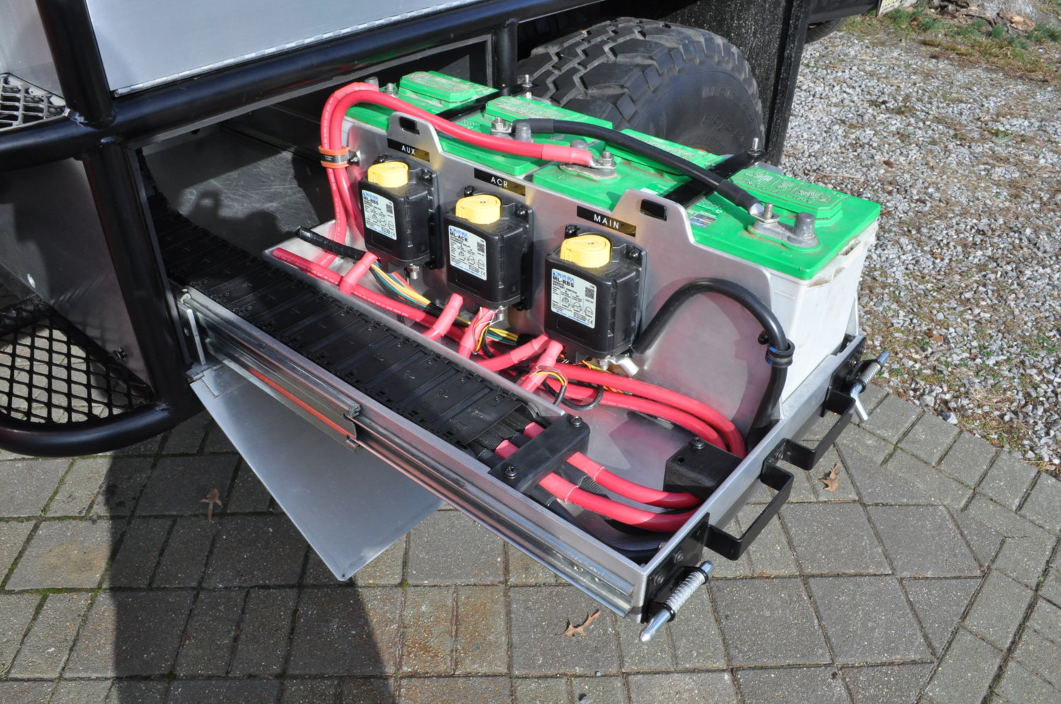

Looks awesome paul! good work.

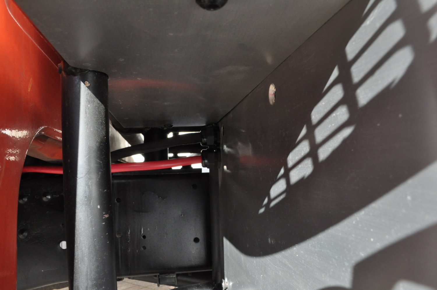

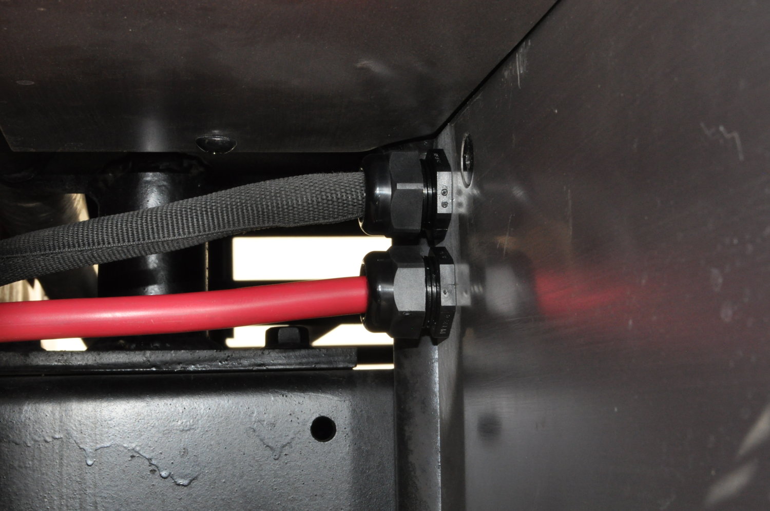

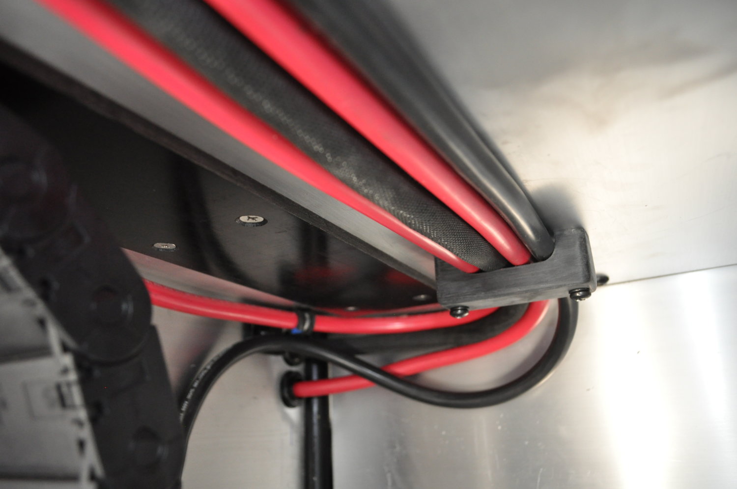

For some reason, i expected the wire track to be more visible. Looks killer that it is barely noticeable, unless you are looking for it.
And people wonder why fab work cost so muchthanks.. that's exactly what i was going for... subtle, but, "Hey, wait, what's that I see" gig.....

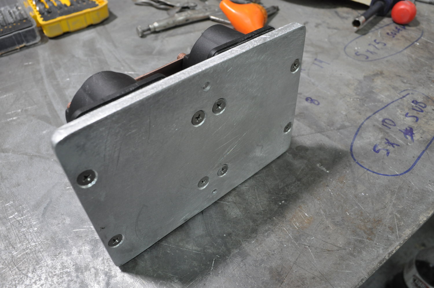

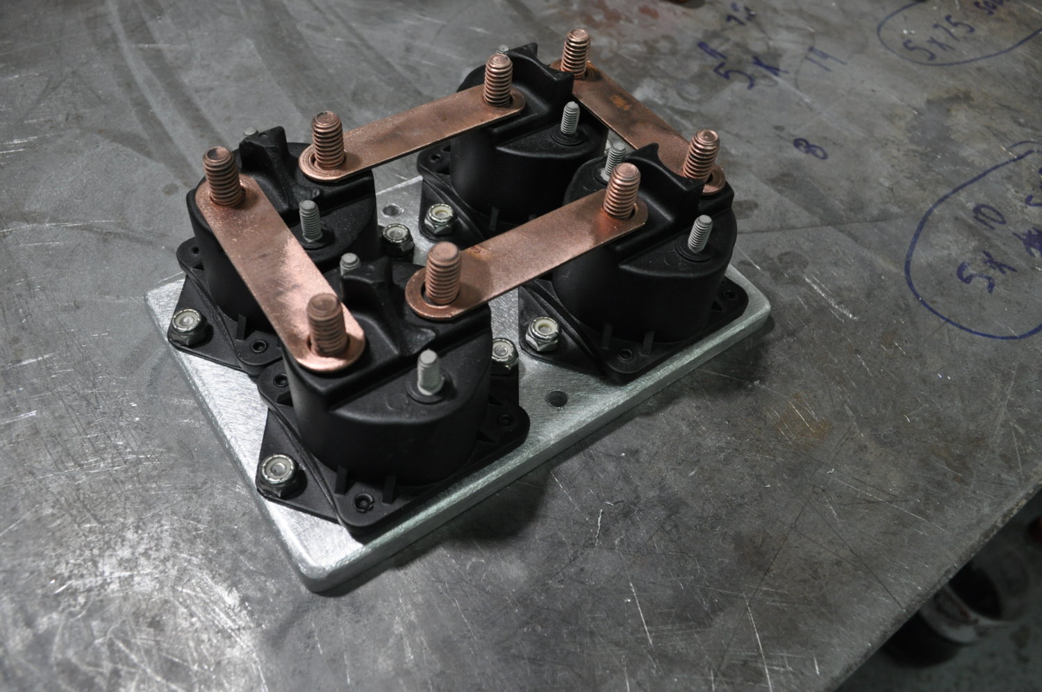

cold day today... cleaning The Lab™ ....... working on the solenoid pack, maybe take a few more pics later.. hopefully tomorrow i can get it back apart for the next round.. next time it goes in will be for good....
FTR, from x-mas till now, I prolly have 125 to 150 hrs in... so with the original tray build ya figure this is 200+ hrs...
another hr of my life I won't get back...

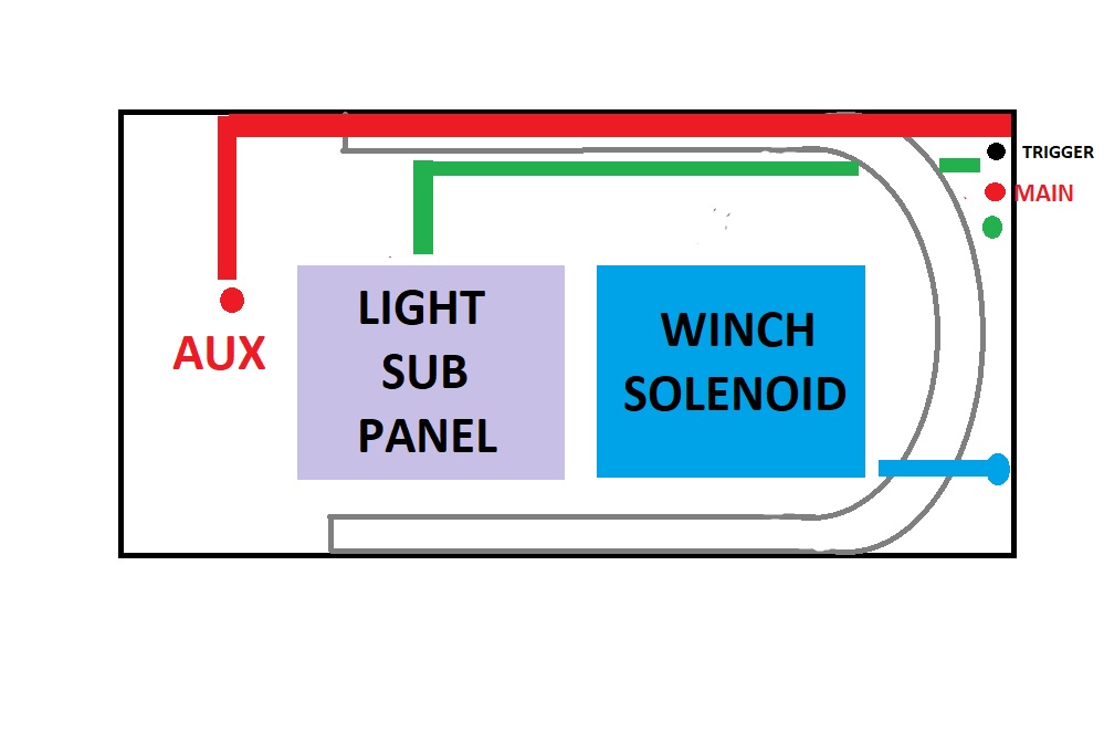

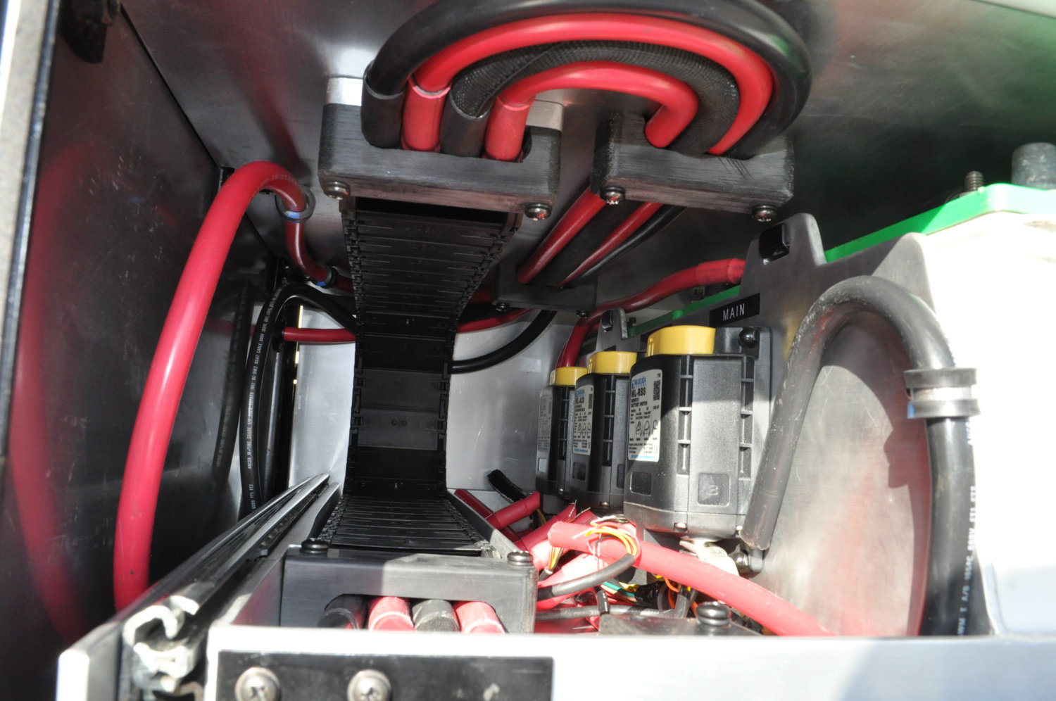

You could build a bridge over the end of the track and mount an inveterate. Even pushed all the way in, it doesn’t look like it would hit the halfway poi t
only way you could do that, would be to mount it on the tray, above the track.... not on the ceiling... hmmmmmmmm.......
yep. Front side to edge of drawer, back side supported above cables. Doable depending on inverter size, but might get a bit cluttered.
