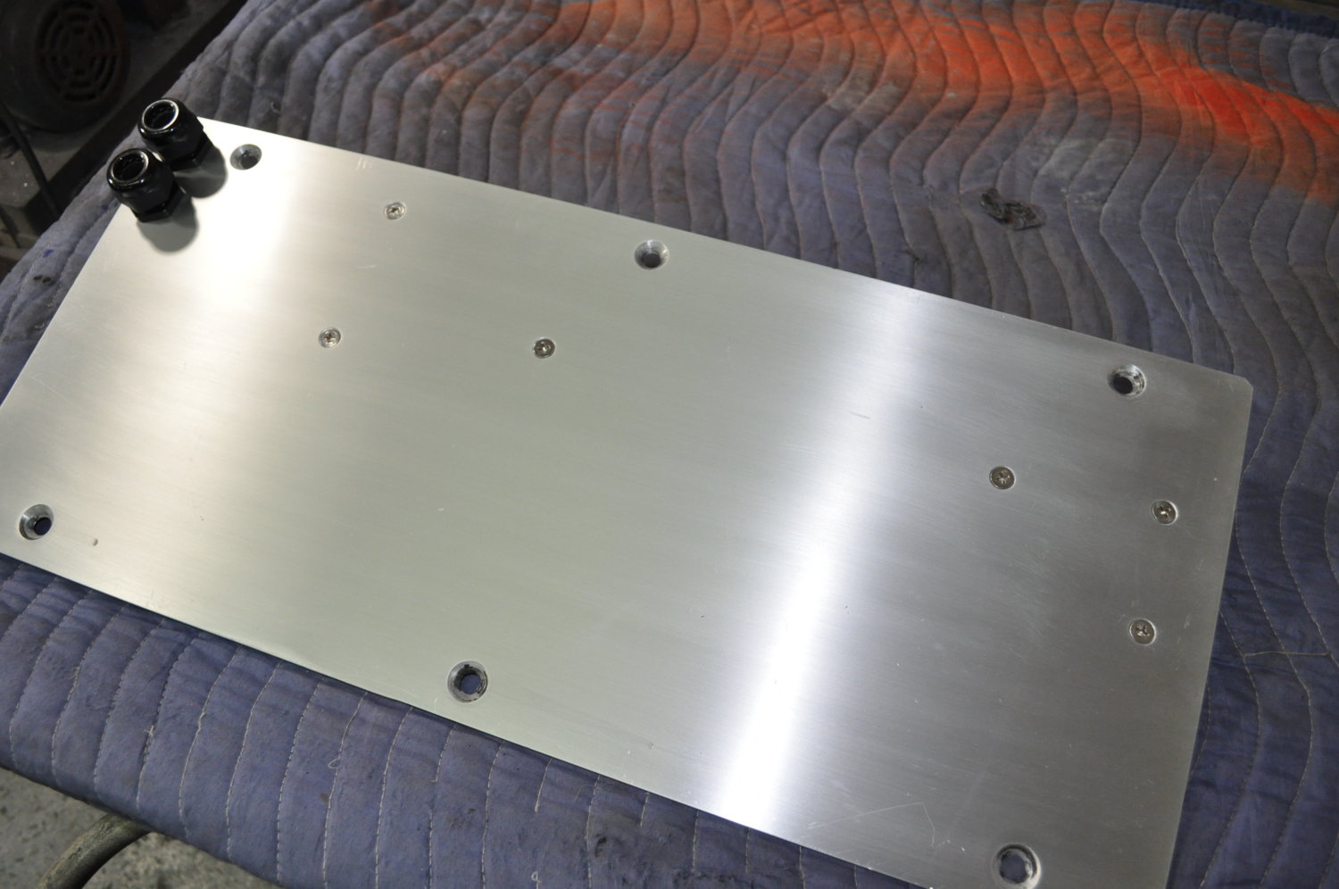

here's a few of the other details going on...

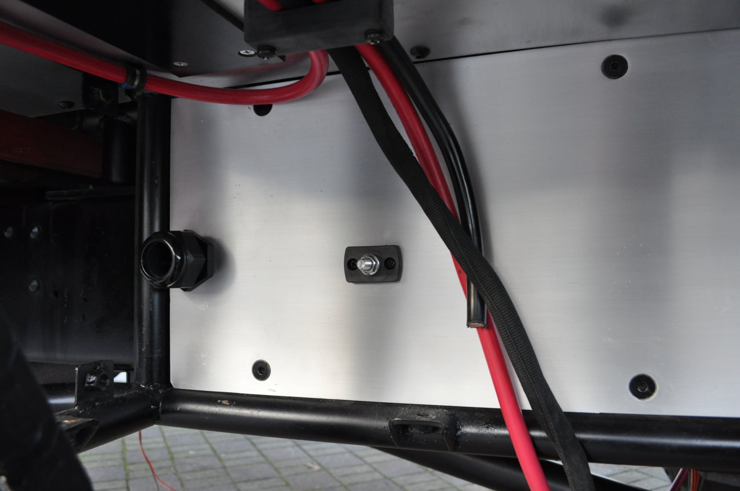

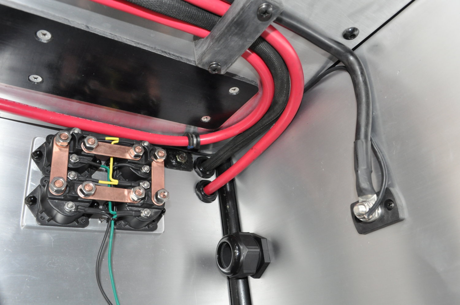

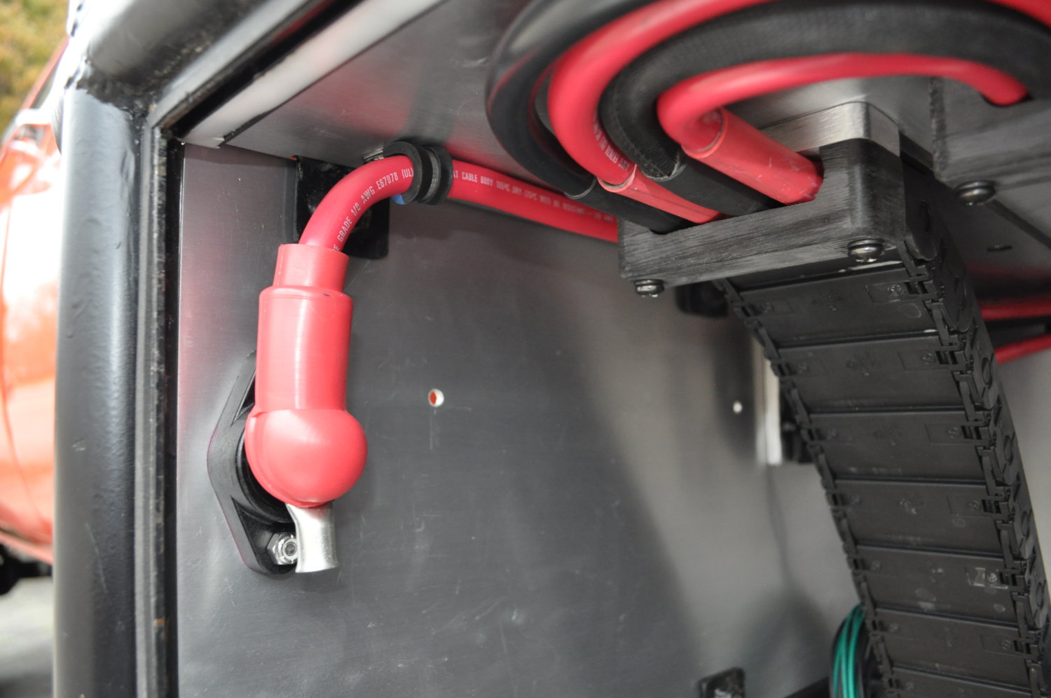

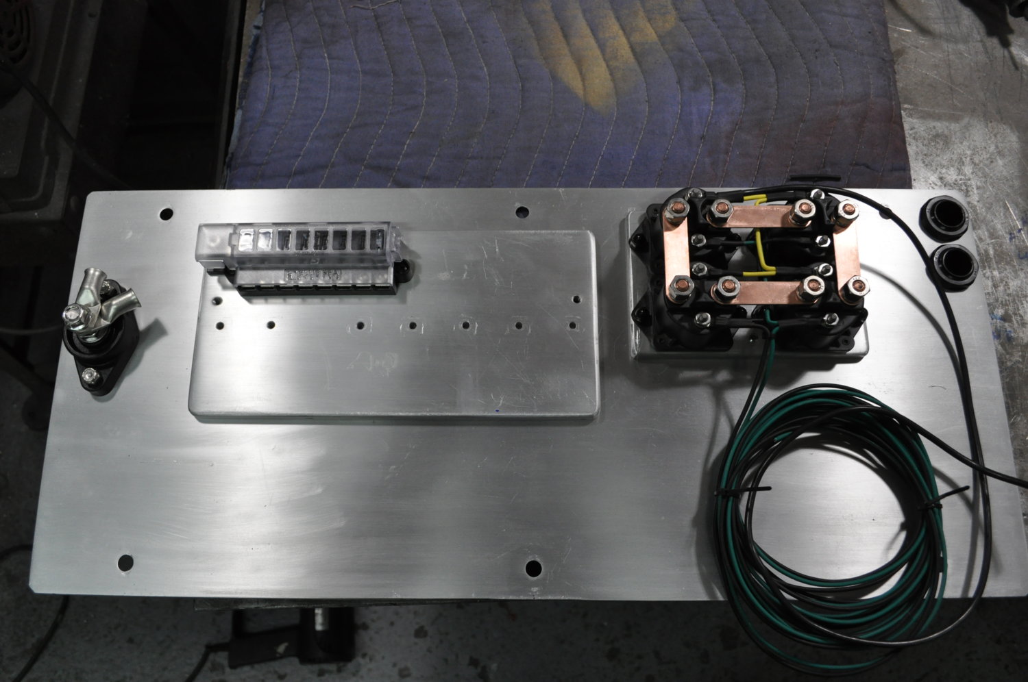

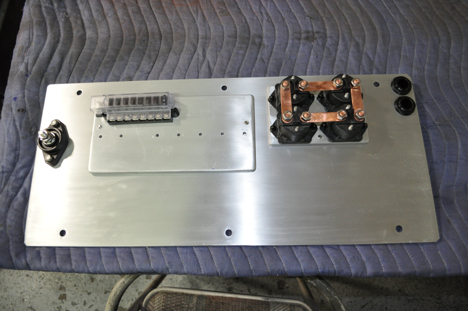

here's the back panel.. need to drill/tap the pass-thru grd mount holes still...
full

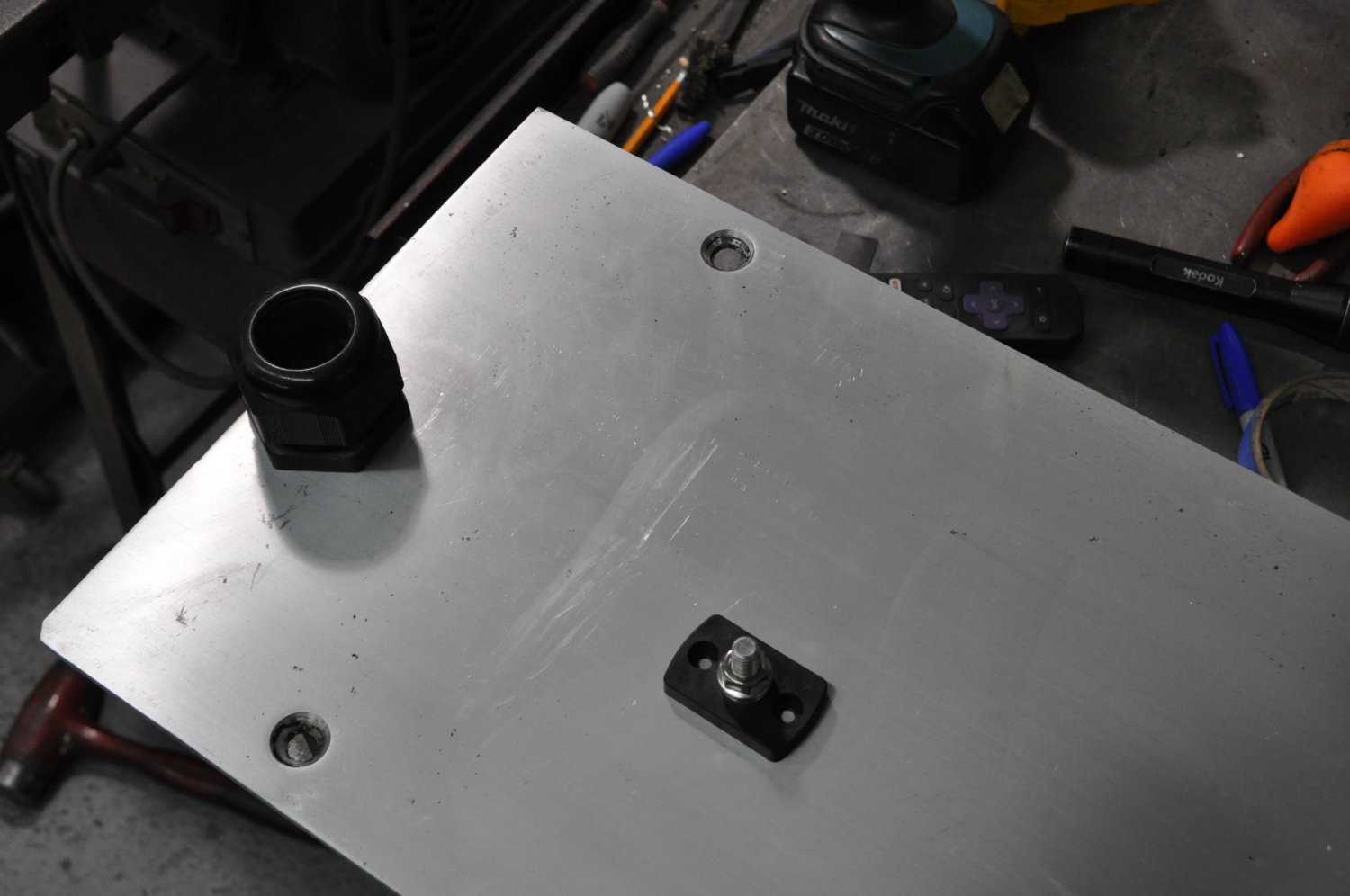

but the real hold up is that I'm waiting for the large locknut for that liquid-tight fitting.. had a few leftover from the K5 build, but I guess I never got the nuts..

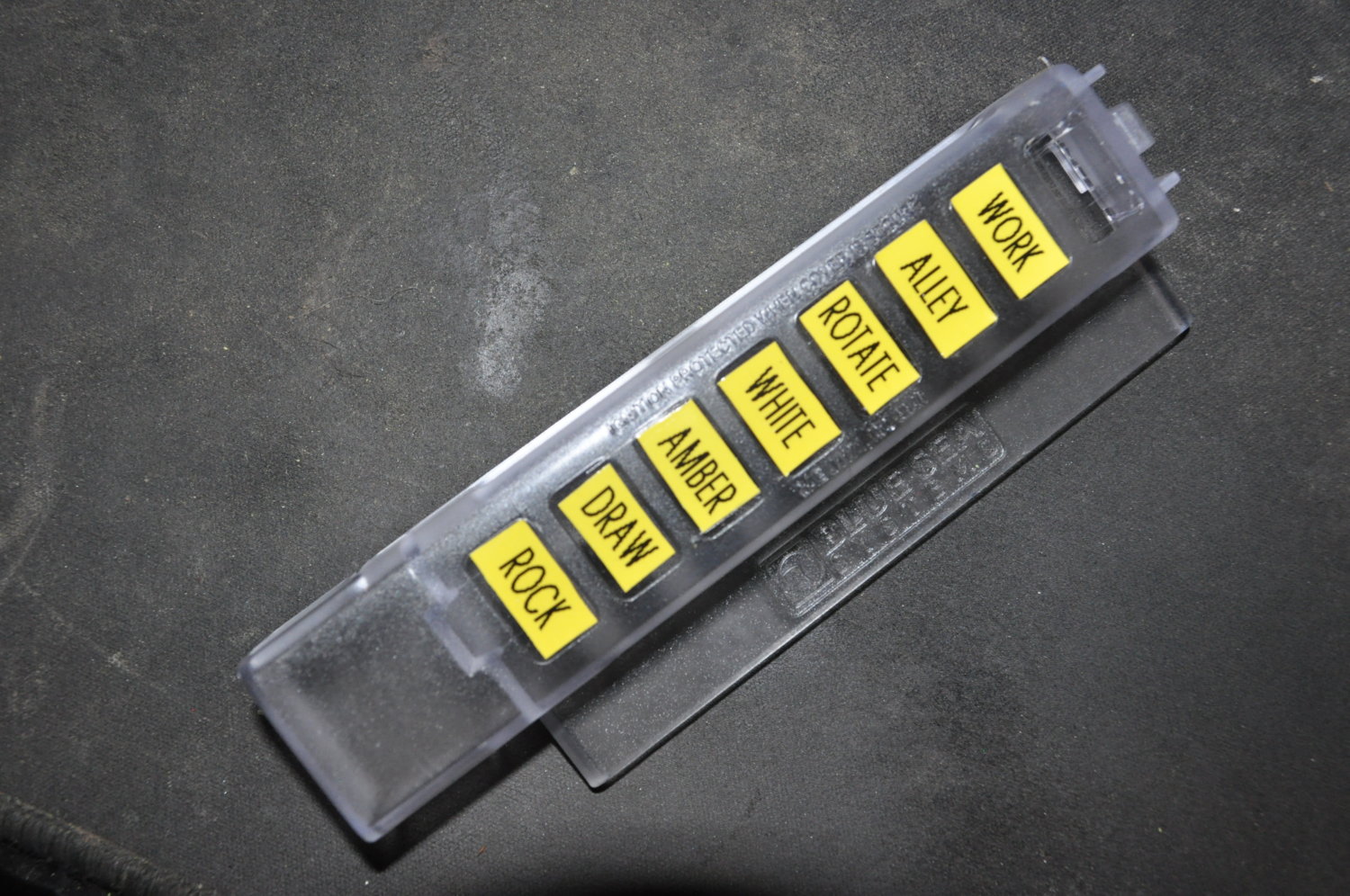

and some of the tray details.. it's all sanded/2 coats sharkhide and being final reassembled... here's the boots I'm running down at the bottom of the switches....
full
for all the times ya get fugged, sh*t's off a 1/2", can't bolt this, yada, every once in a while The LAB™ Gods hook ya up.... those acorns I'm running on the switches are perfect as they sit right down in between the side ribs... couple threads, and ya just spin em in with the screwdriver, they lock in out front, no tools.... :woot: :saweet: :pimp:
guess I should get a box of the black acorns.... :doah: :haha:

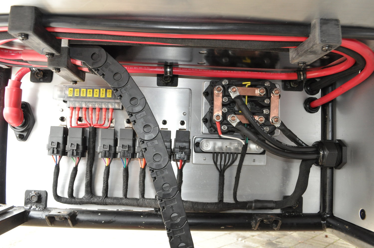

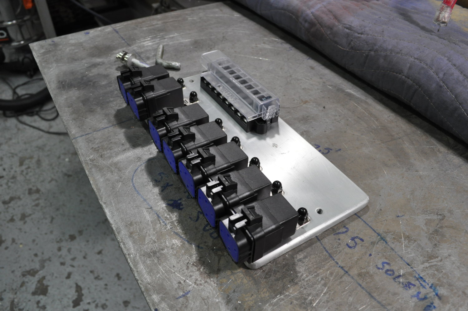

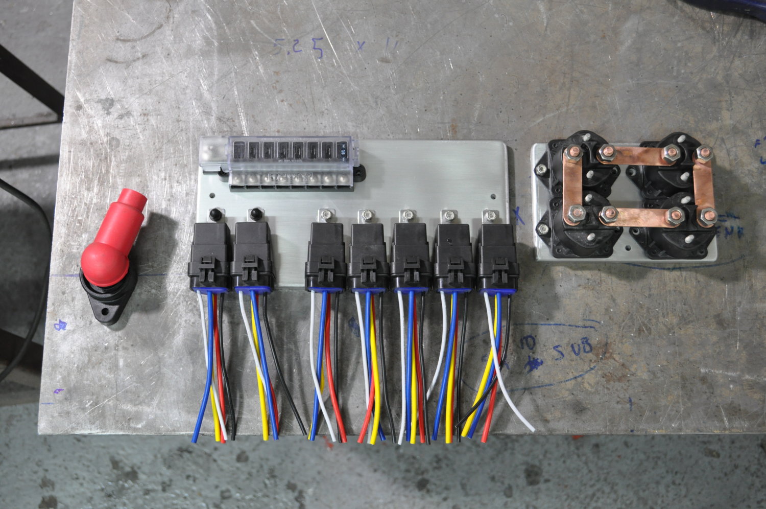

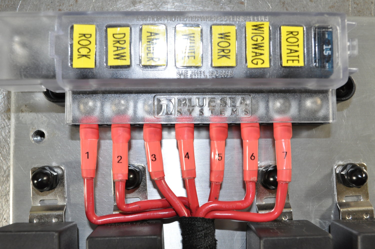

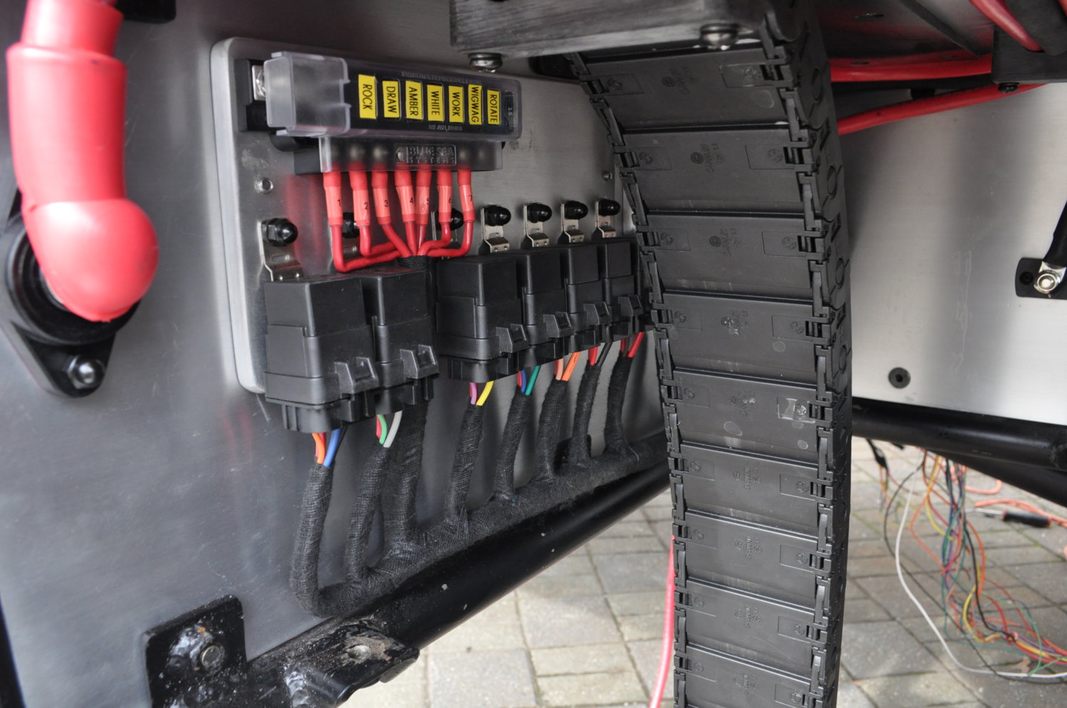

so, I had about a dozen of those relays kicking around at work and wanted the freebie action. but they aren't exactly what i'd like to run here and I decided to order what i really need..... I could make these work obviously, but the tight confines and precision i need on this project make a 4-pin, self-terminating relay much more streamline and to the point......

back panel is done and back in.....

the side panel metal work is done... just need the breakers and start building the harness.....

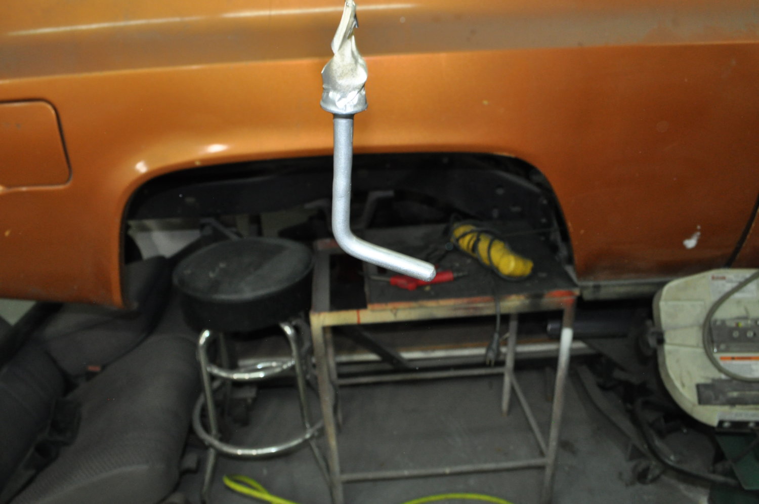

oh, and here's the custom clutch lever...
full

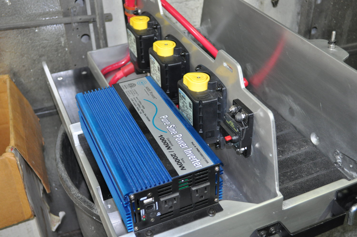

Inverter shelf came out sweet.
thanks...... :) considering it was an add-on, I think it came out pretty slick.. allows plenty of ventilation around/under the inverter, can still spy the sick carrier under it...
the 4 mounts are 4mm screws thru isolators into the tapped alum... all dictated by the isolator hole size..
i like how it worked out perfect that the positioning of the 3 switches initially, ended up making the perfect spot for the breaker.... :woot:

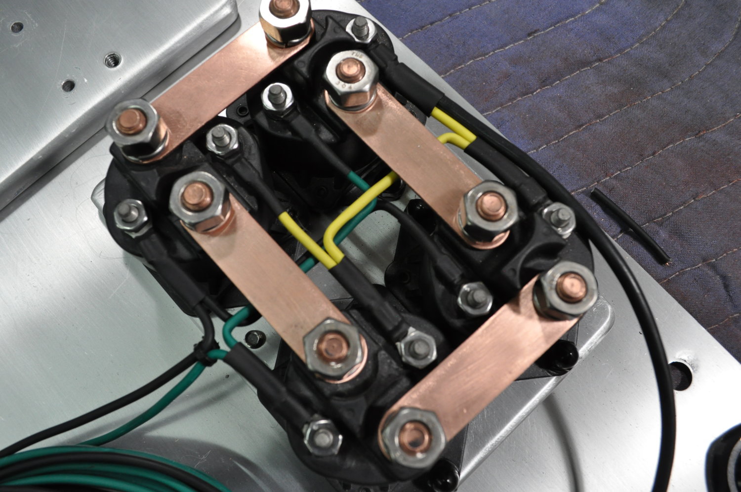

the other new one for you guys is I'll be adding a grd busbar below the winch solenoids.... I'll be done with that whole harness on mon/tues.. the power/grd wires are done already.. tomorrow I'll do the triggers and feeds... next decent day I'm gonna run the 3 1 awg's for the winch....

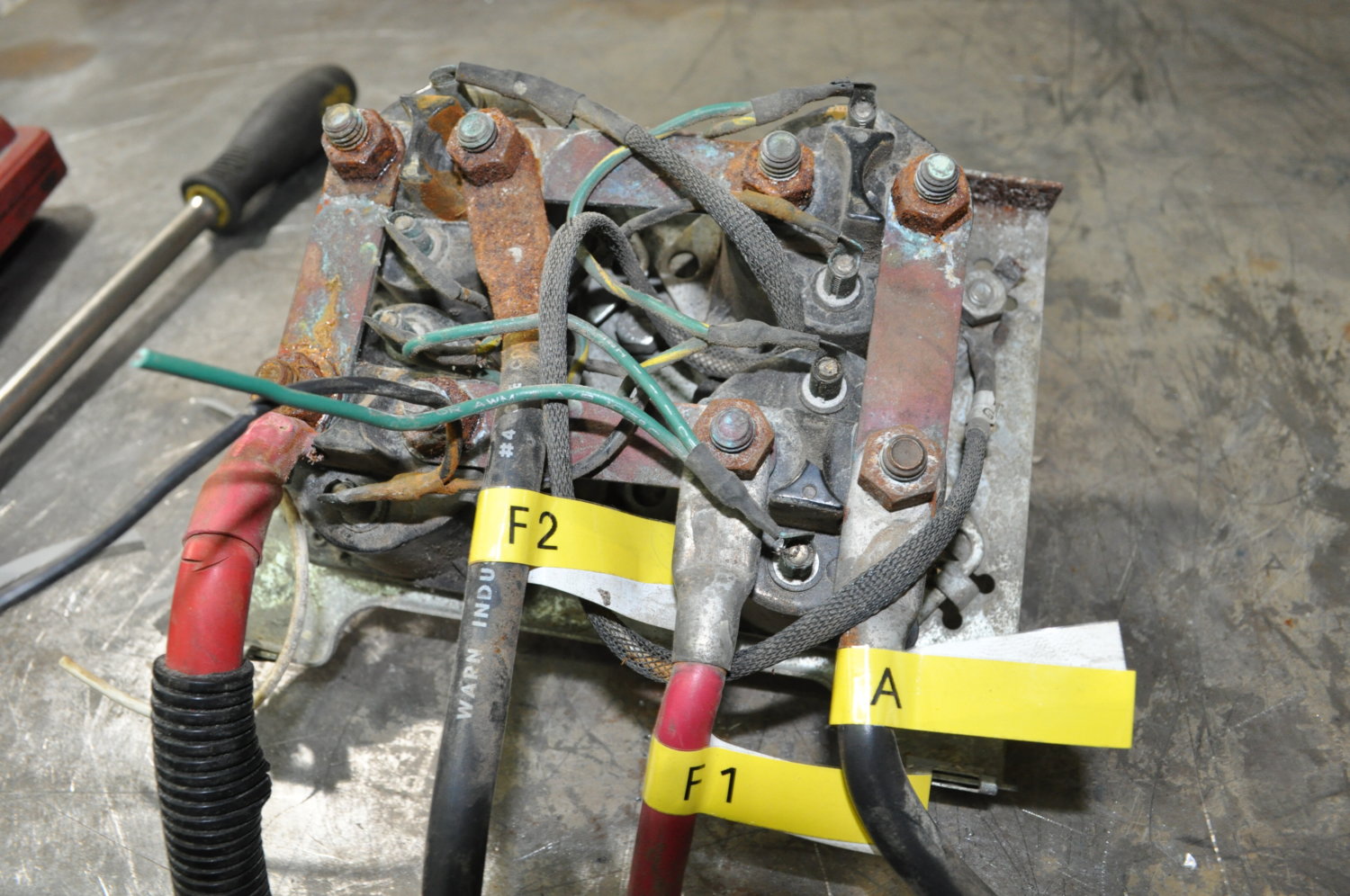

finding uses for the label maker... wanted to do the black labels with white text, but they just kept printing like sh*t... this was the next best... i have black on orange-ish, but it's not nearly as easy to read as the yel/black... I like this tho, it'll be easy to spot as a quick reminder...
full

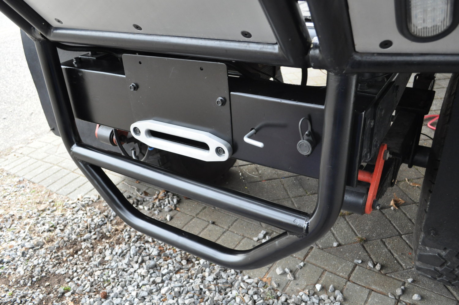

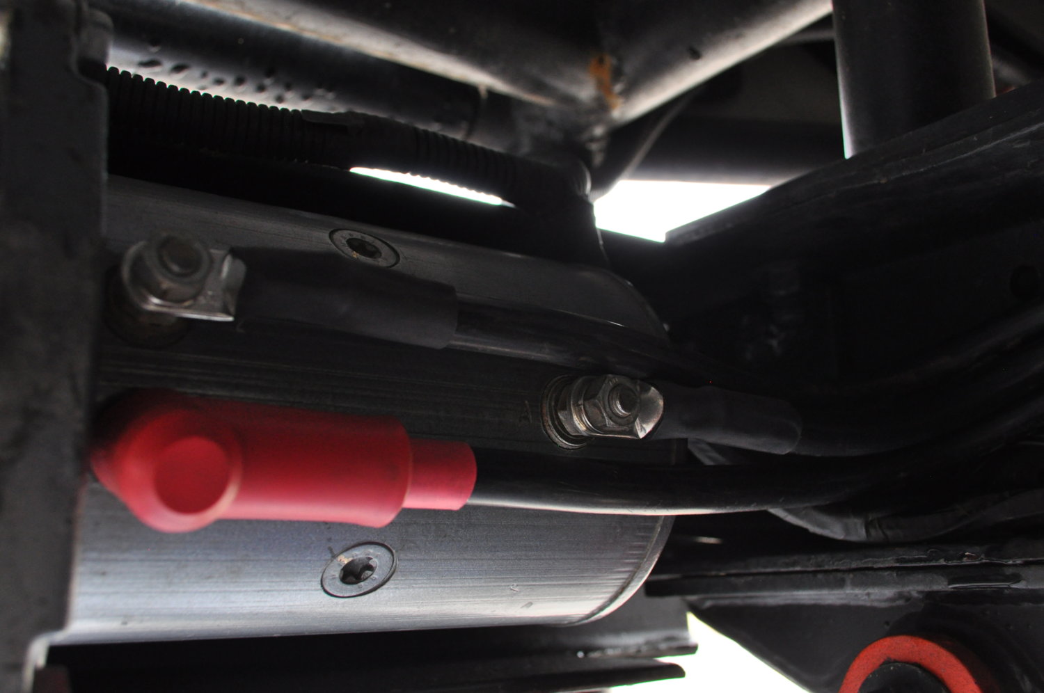

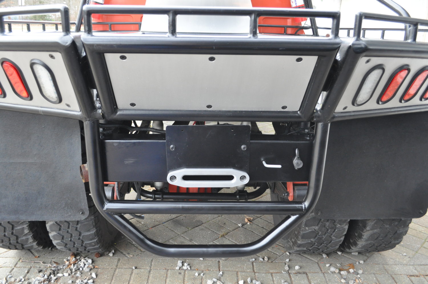

the winch is in.... just need to do final wire hookups at the winch after i secure the wires down the rail.. grade 8 flanged bolts...
full
winch line showed today too.. hopefully by the end of next week it'll be on and functional...
full

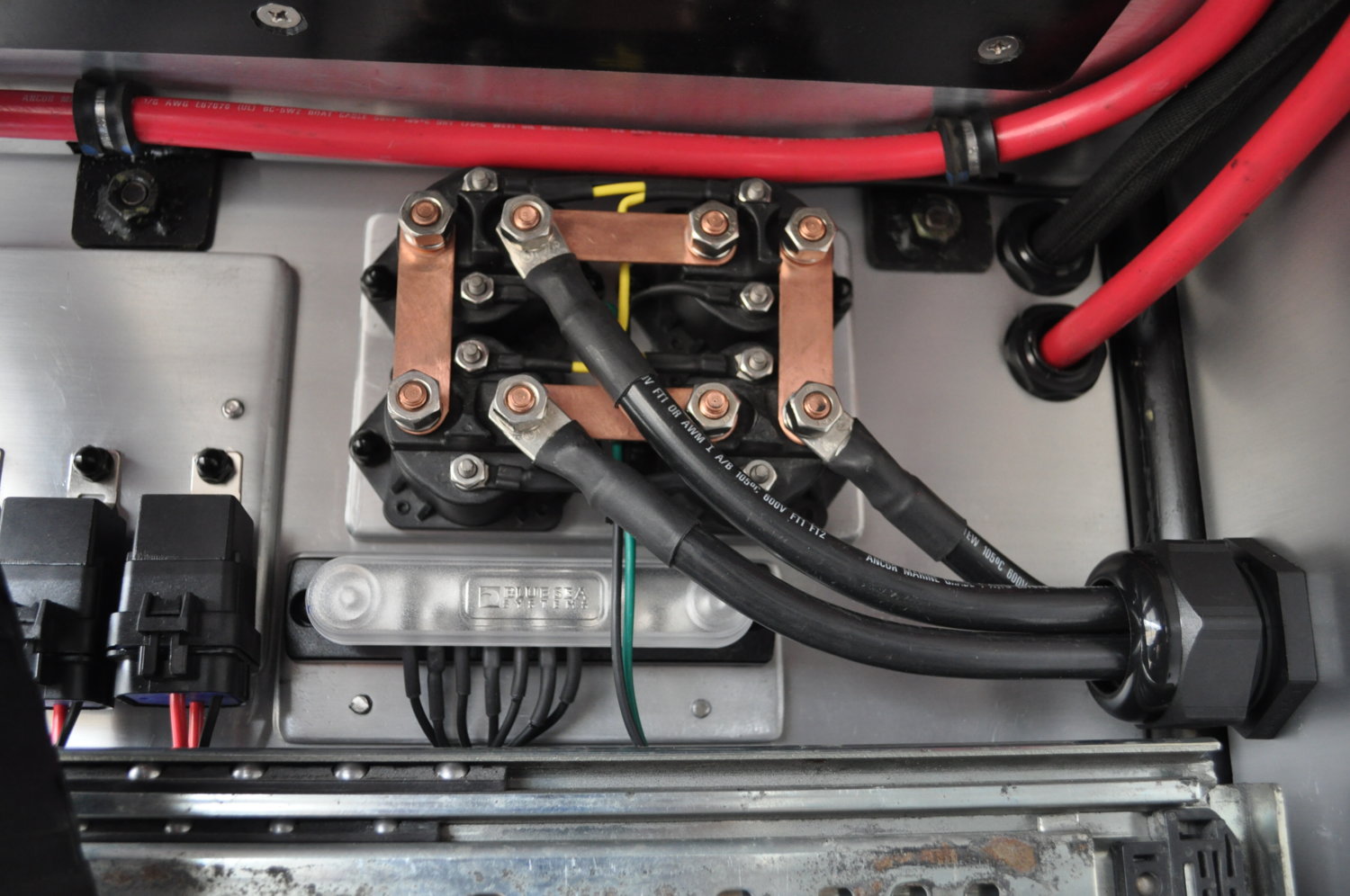

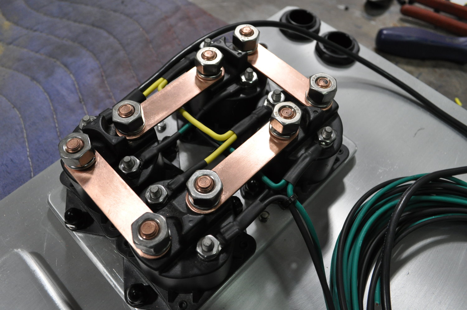

the corner right now... grd buss is in... I'll do the big power feed to the solenoids once the tray is back in...
full
just waiting on trigger wire for the relays to finish up that harness....... they sent it to my old addy.. idjits... hopefully i get it tomorrow or monday...

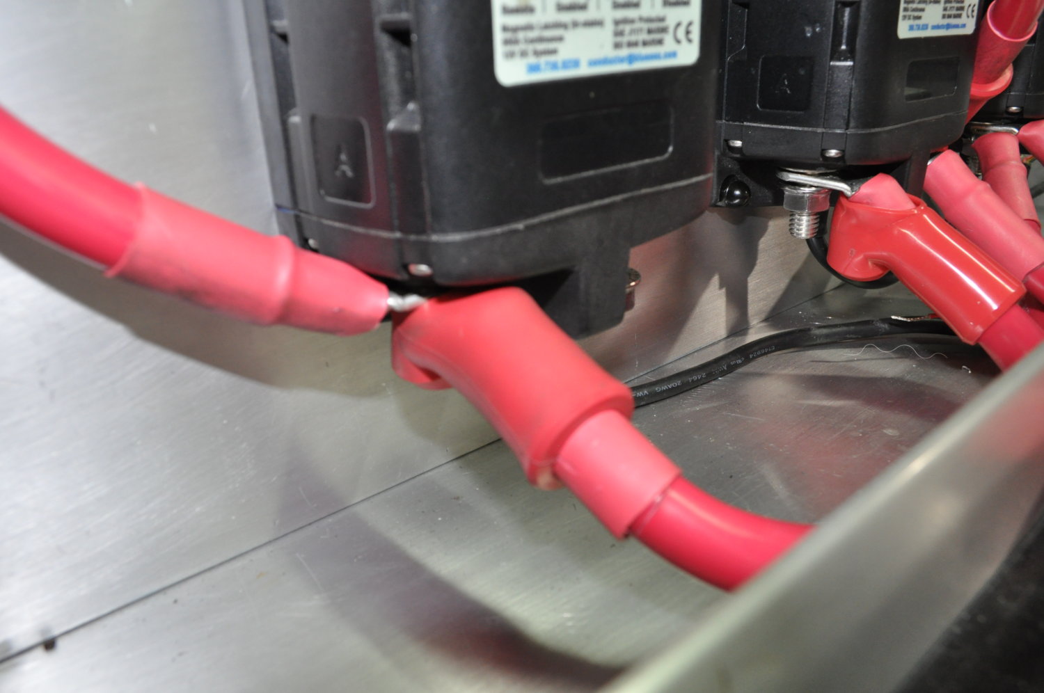

boy, I've been working on boats too long.... talk about 27 lb's of sh*t in an 8 lb bag...

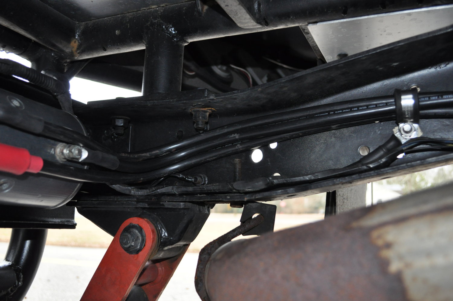

while the harness worked out perfect down in the recess behind the slider, man, what a clusterfug to get the slider in....
full
it makes me glad that i waited to do the winch power till last.... all this time I was gonna run it down at the bottom, next to the other harness...
but now with that grd buss in there, I don't think I can go down off the solenoid... maybe.. might have to go back to the original plan to go on the ceiling next to the aux feed to the front...
