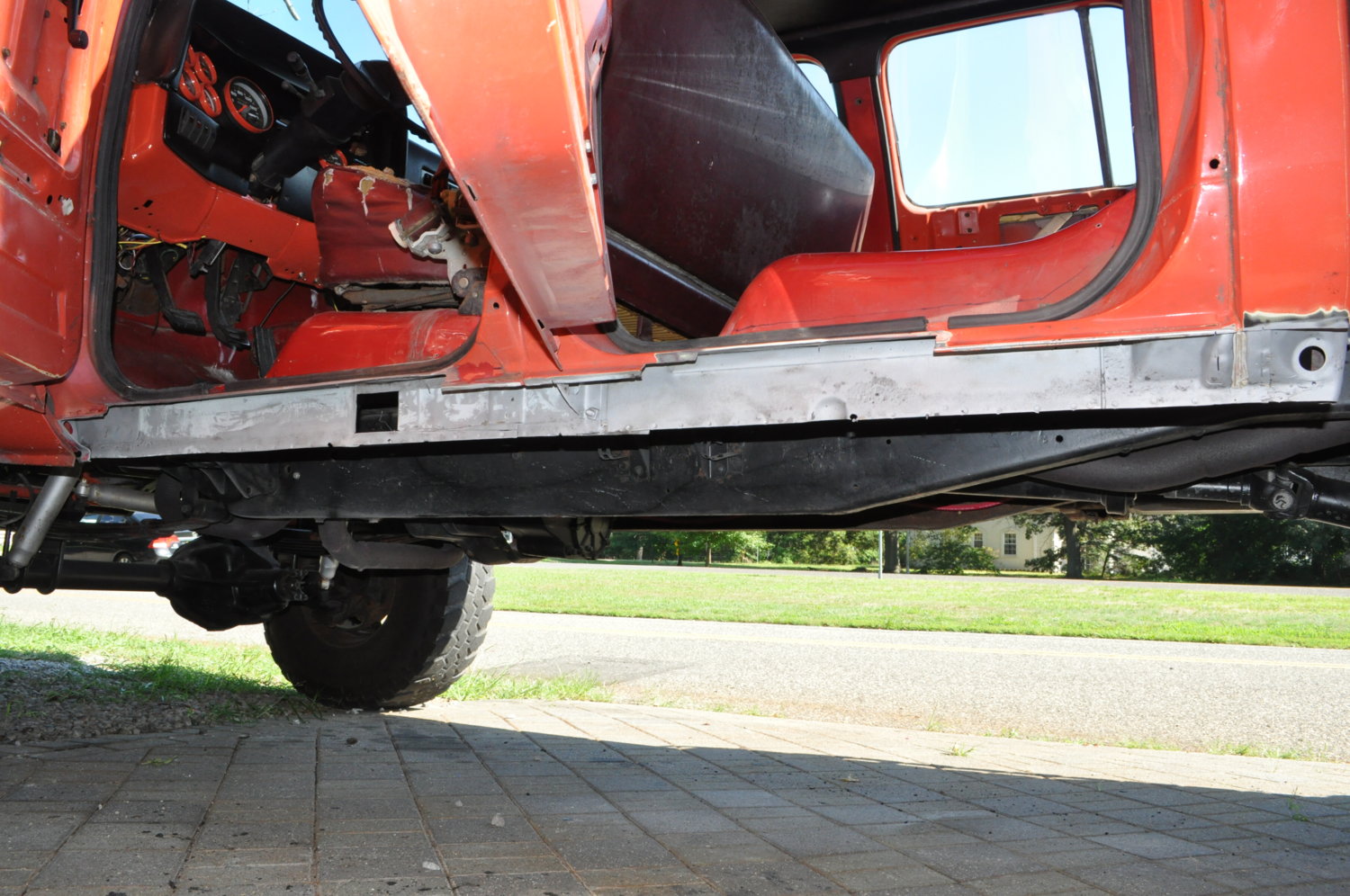

tomorrow I'll take the lower strip off, grind/trim it up, and if I'm lucky get it sandblasted and primed by the end of the day... I do need to do like a 4" x 15" patch in the inner rocker... no big..

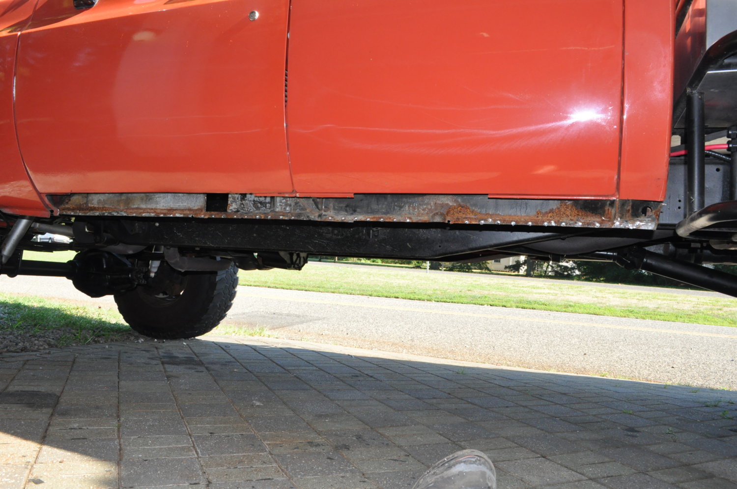

But I did finishing trimming/removing steel today.. you can see the 12" long patch i need to do to the left... next weekend I'll blast it, fit/grind the new pieces, etc.....

the cavity will be primer, ryo red douche... than when done, I'll spray cavity wax in it from both ends....

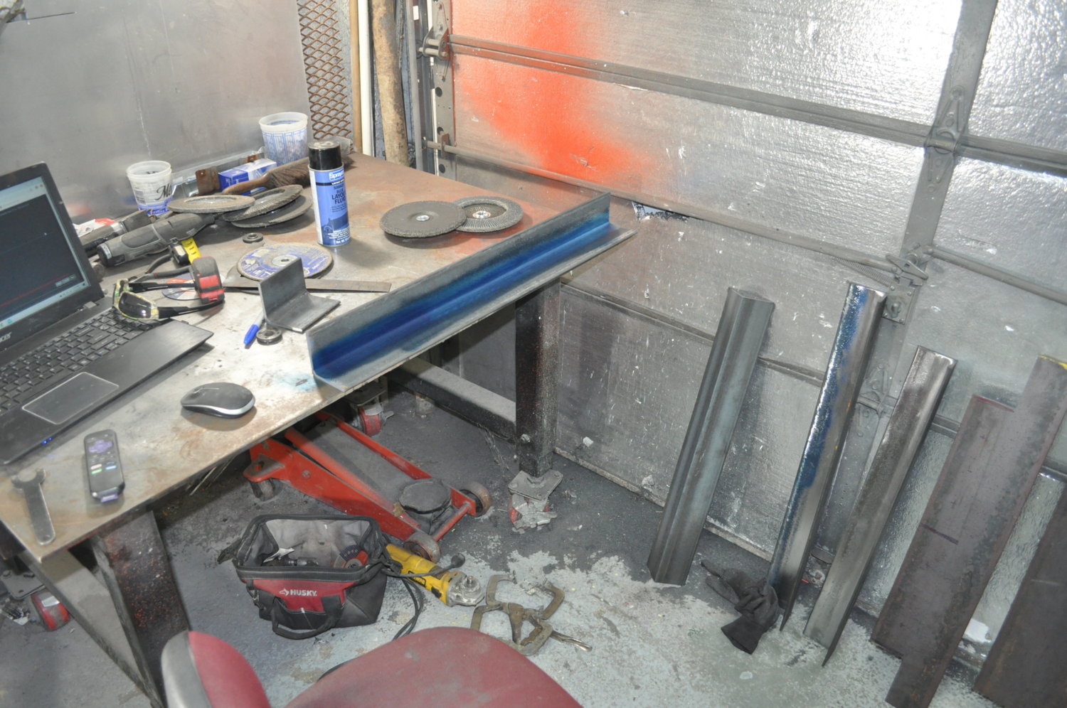

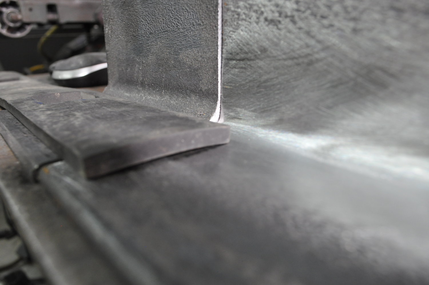

an evil task I had to do that I needed to get over first for this frame project was, I knew I needed to square up the inner corner of the angle so the tank will sit all the way at the bottom with no chafing, etc..... the one side really wasn't needed as the bottom will have a 1/4" rubber strip... but on the sidewall I want the tank relatively close to the wall.. maybe 1/8" or less...
here's how I spent my sunday afternoon...

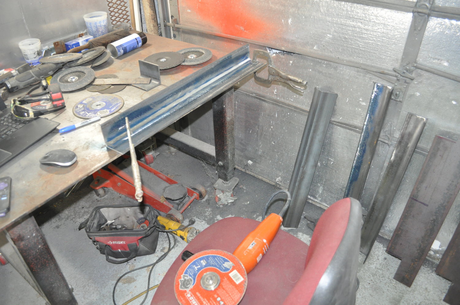

no Kai, too much grinding dust...... start with a 7" cutoff, flatbladed.... then finished off with a 7" 40 grit flap disc...

what I'm gonna do is once the tank is installed in the tray, strapped down, etc.... I'm gonna run a bead of caulk in both of those gaps, side and bottom.. the top one, to the sidewall will be more important as I don't want crud and sh*t getting down in between the tank and frame... than a fatter 1/4" bead pumped in around the wider bottom one....
I feel that I don't want to try and add anything chafe-wise on the sidewalls necessarily... just a well-gapped fit... possibly a very thin piece of UMPH slide down in before I caulk the top closed, if there's room.... that's why I want them to have the frame when they build the tank....

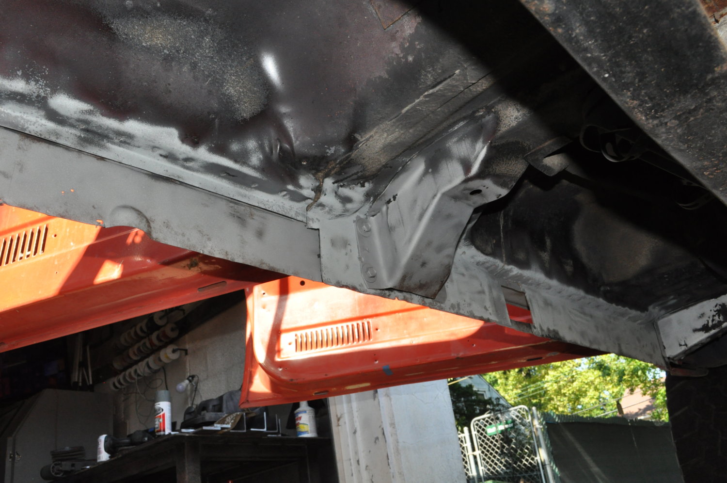

blasted......
full
hard to do rotisserie quality work without one... ;) I'll carry over the strip/refinish of the floor underside when i do the new drivetrain...

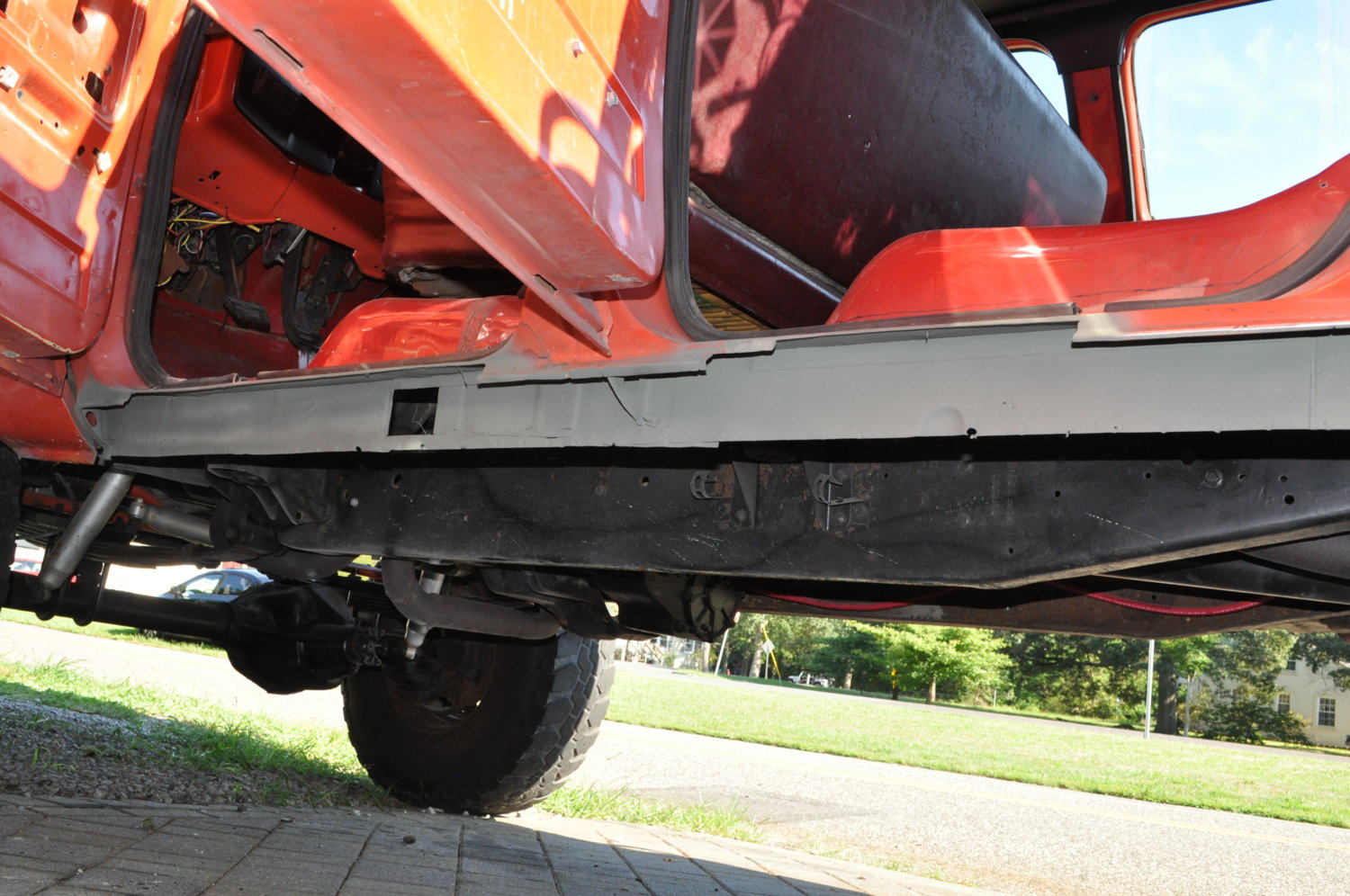

next week I'll trim/fit the new metals going in, etc......

1/2 day today.. got the main rocker mostly trimmed in.. but as with most taiwan stuff, it needs tweaking.. they didn't bend the lower flange enough, so need to homebrew brake that tomorrow...
