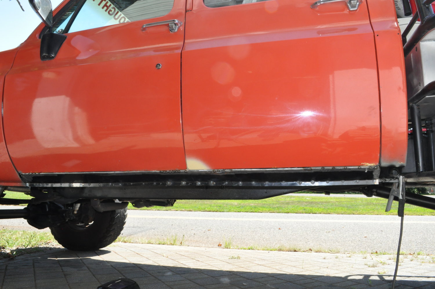

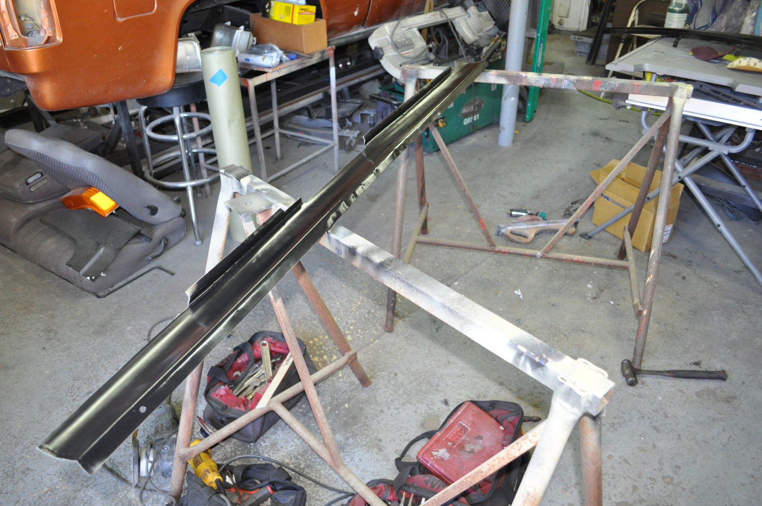

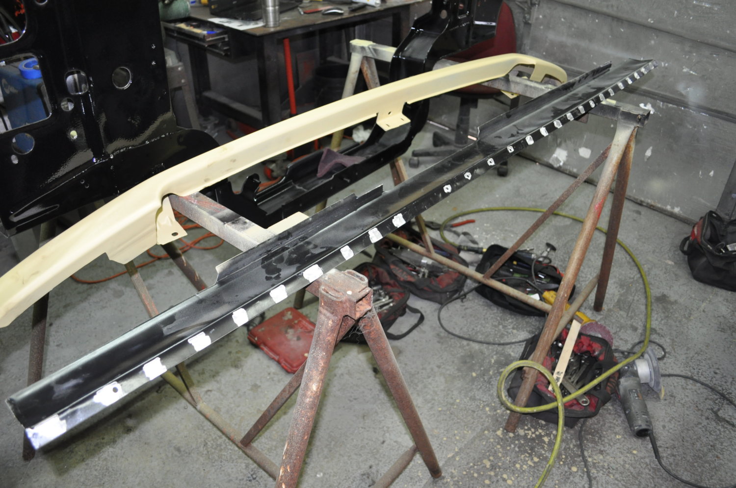

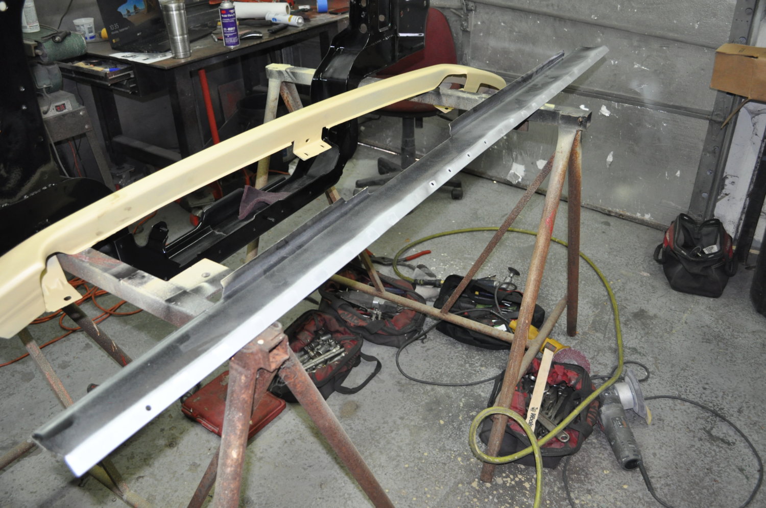

rocker is ready for final trim/burn....

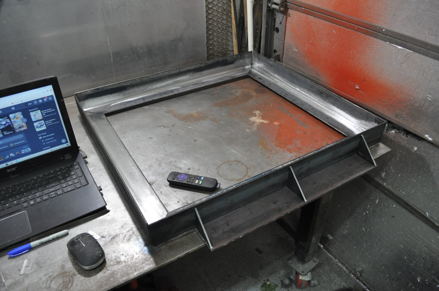

here's the basis of the tank tray.... the 2 side mounts are 6" x 3/8" strip , to match the bed mounts... than sitting on top of that is 3" x 3/16" angle... few other things to add as I go...

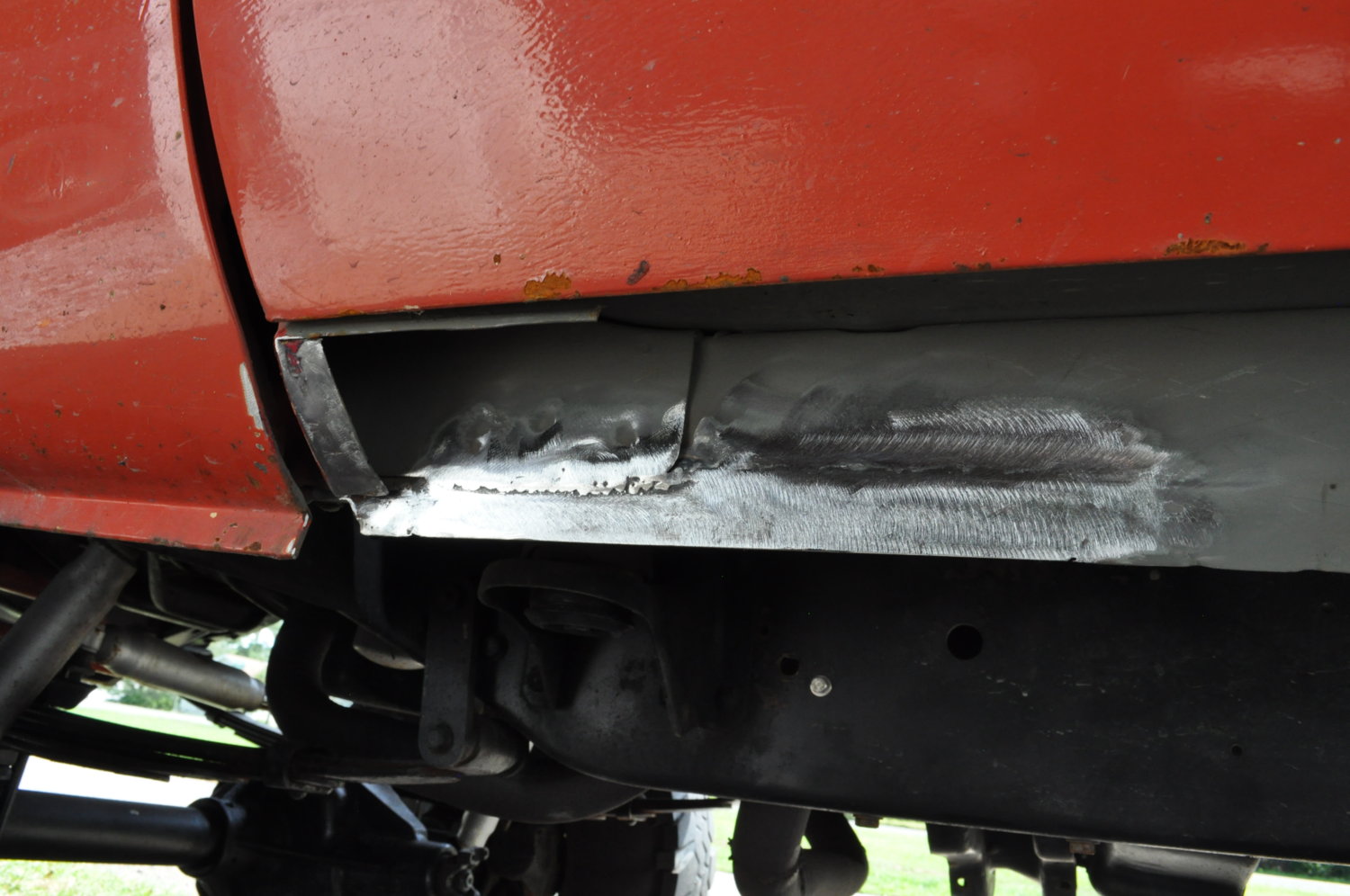

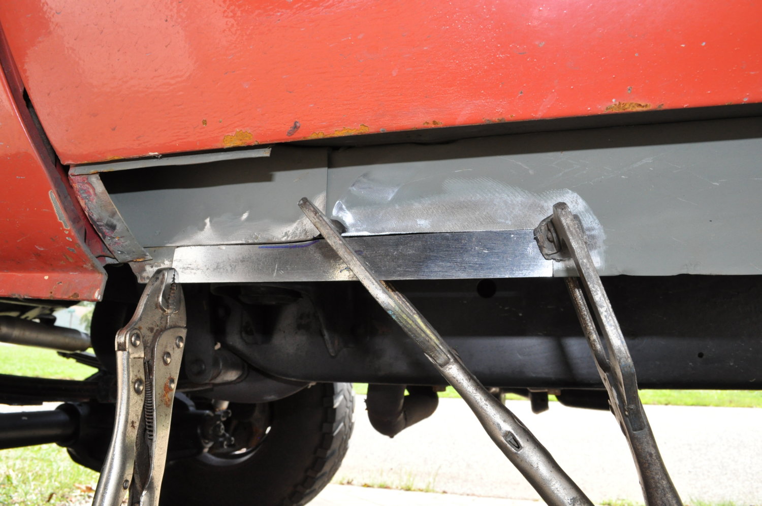

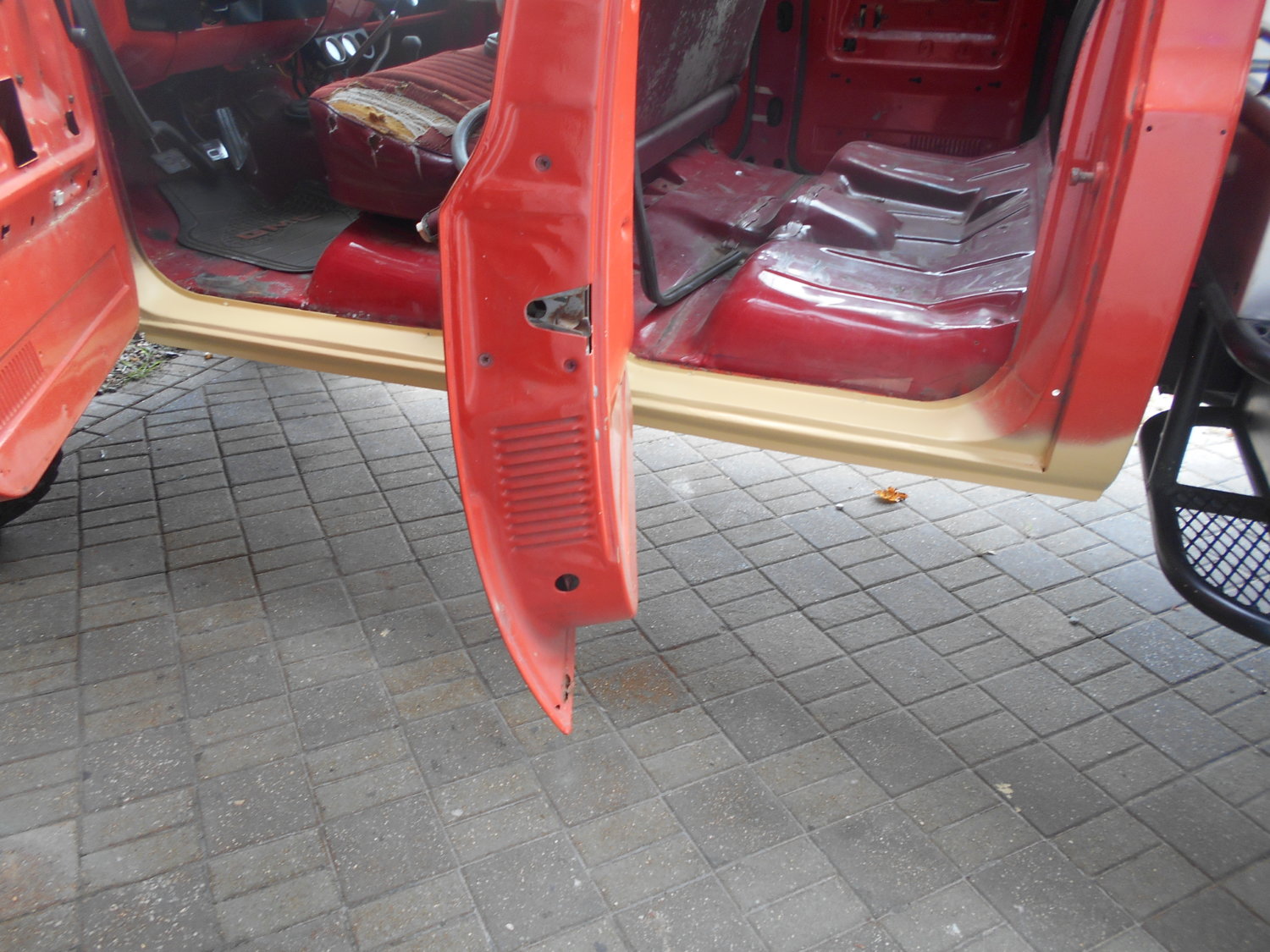

ok, got a 1/2 day in today..... got 3 of the 4 smaller, and inner patches done today.....

tomorrow I'll do one more small one in the back, and do final trim/prep of the outer... I forgot to get seam sealer, need that before I close it up....
but I did get a bunch of primer, paint catalyst, etc.. every time I walk out of there it's 200 to 300 sheckles.... need to check into some Furd red/argent too...
next weekend I'll burn in the outer... following weekend, I'll bodywork and prime it...

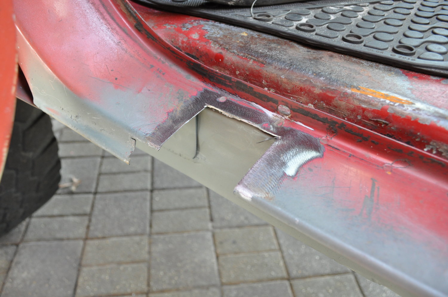

I decided today while trimming the main patch, to add 2 access holes in the inner for 1" body plugs.. like the one at the front and rear...

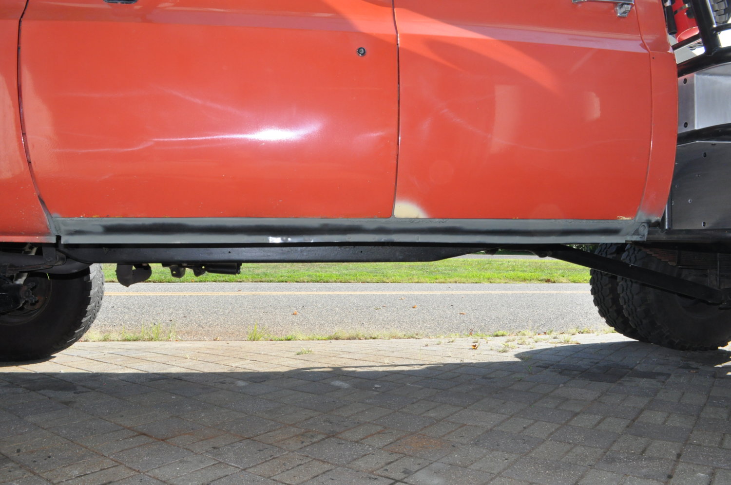

only getting the inner stuff primed/painted today, see about starting to burn in the rocker over tomorrow and mon....

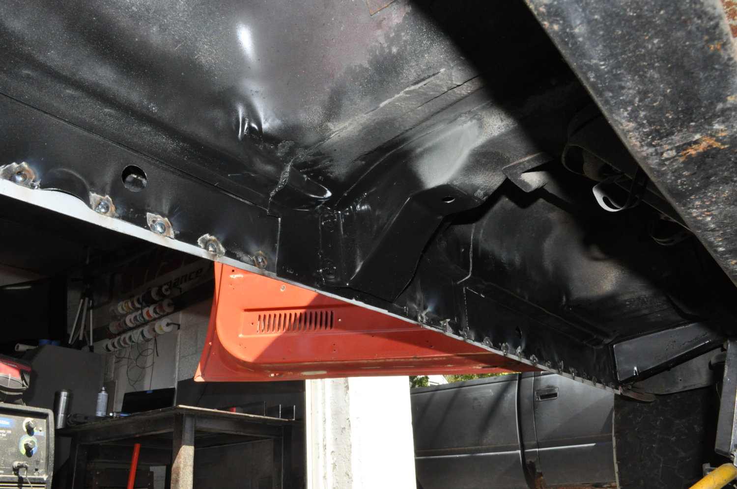

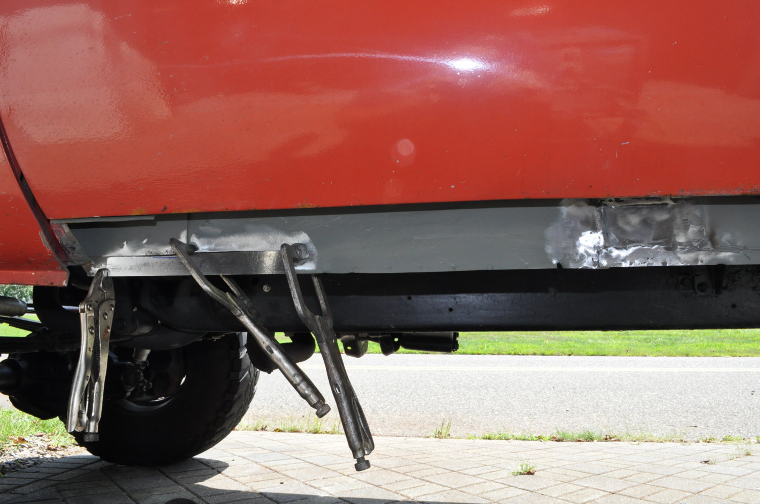

got a few hrs in today.. got the 2 additional holes/plugs in for the cavity wax... so this is all in fake zinc, 2K and leftover black from the rad support deal....
full
the finished patch has the same treatment on the inside...
full

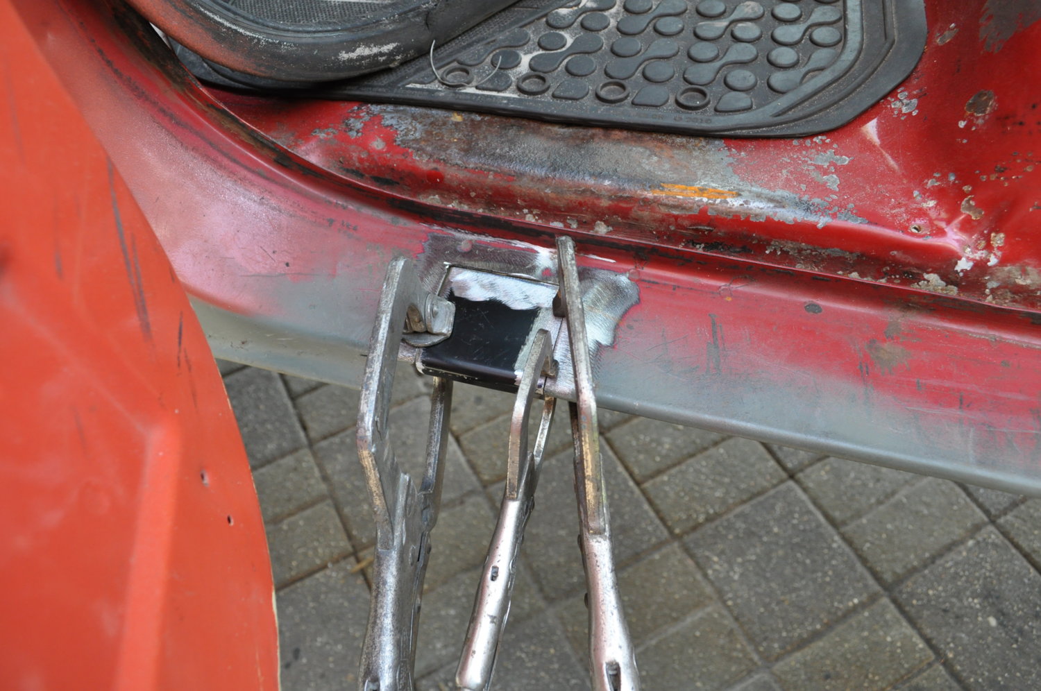

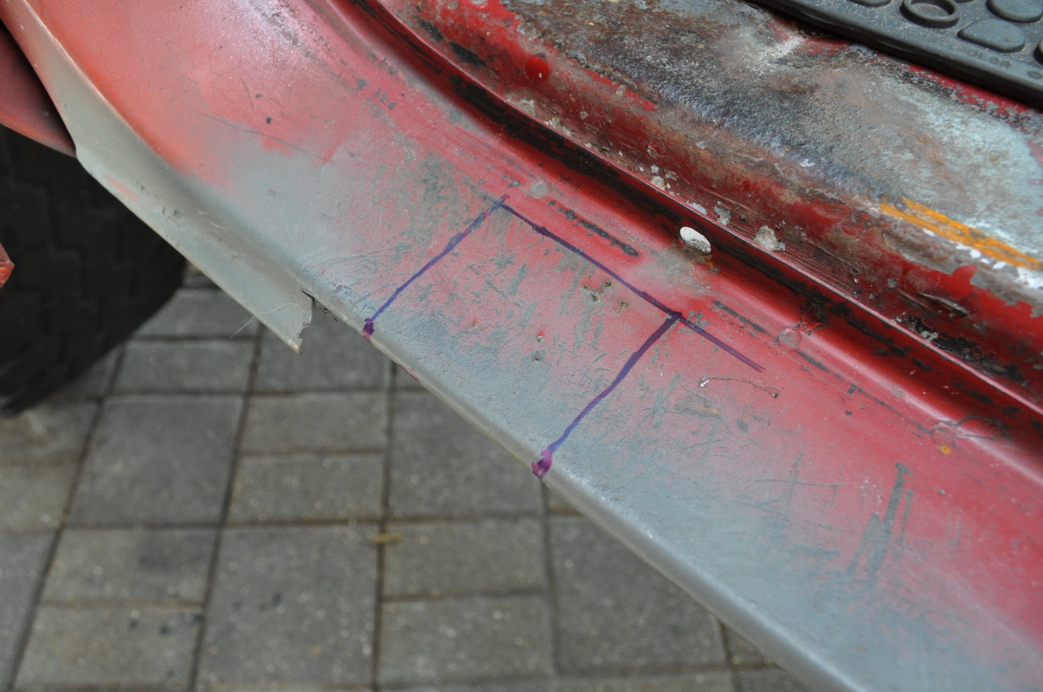

next it gets clamped up, marked, than spot grinded at the weld areas.. bit of weld-thru..
got family stuff tomorrow, but should have a day and a 1/2 to burn this in hopefully...
basically how i roll.. spot ground...

bit of weld-thru...

tacked in....

plug-welded...

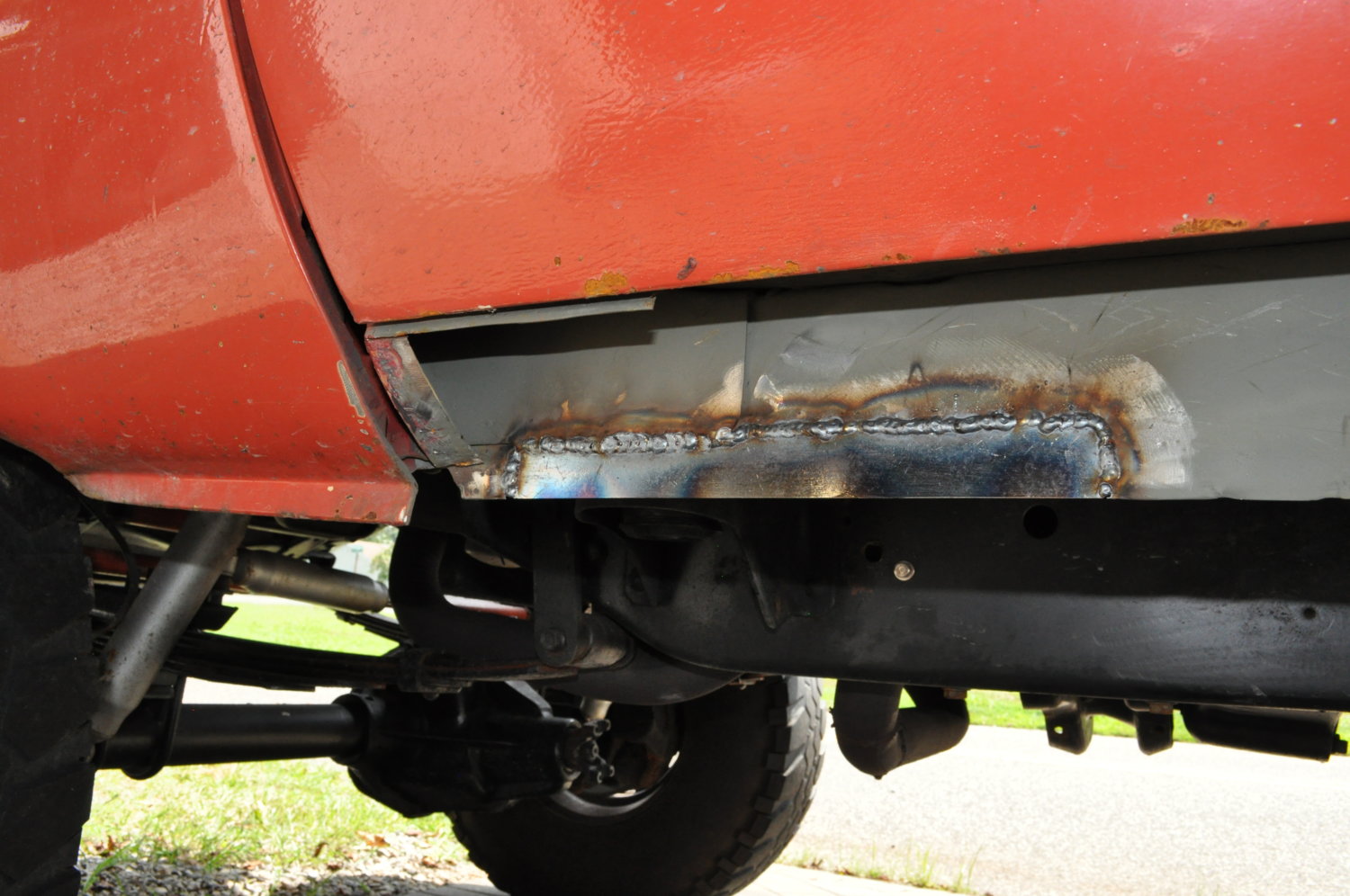

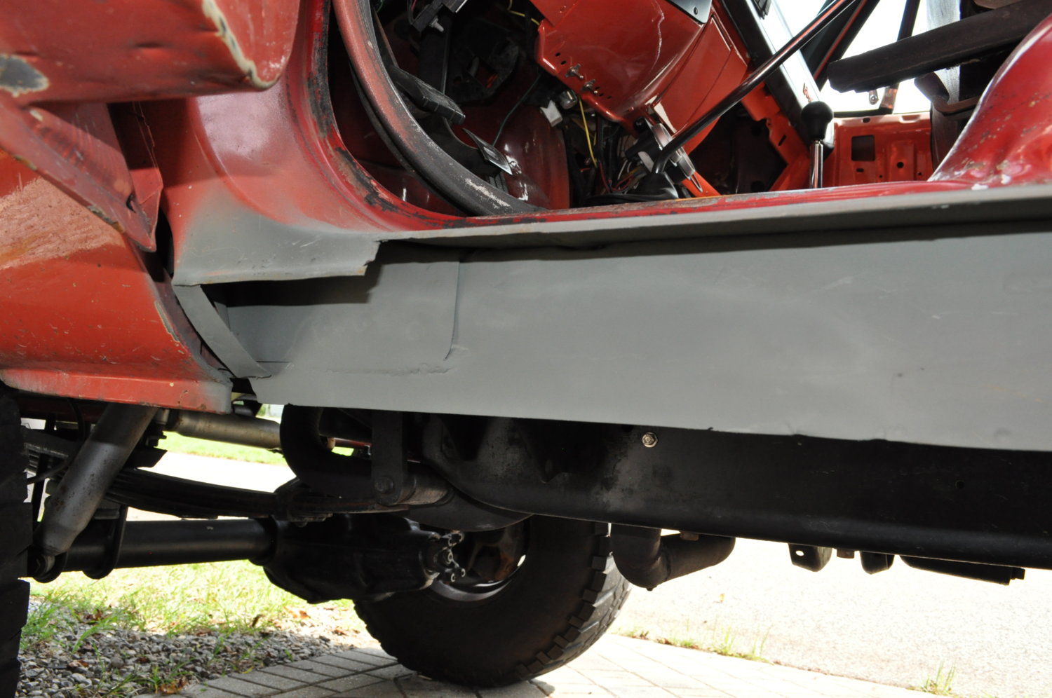

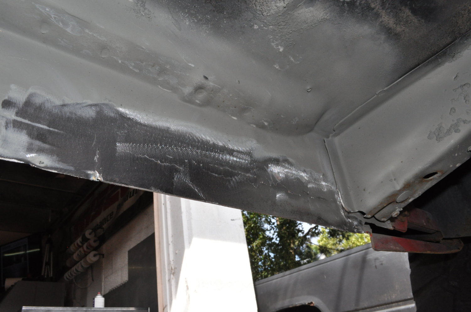

fully burned in with a spritz of primer to get thru the week..
full

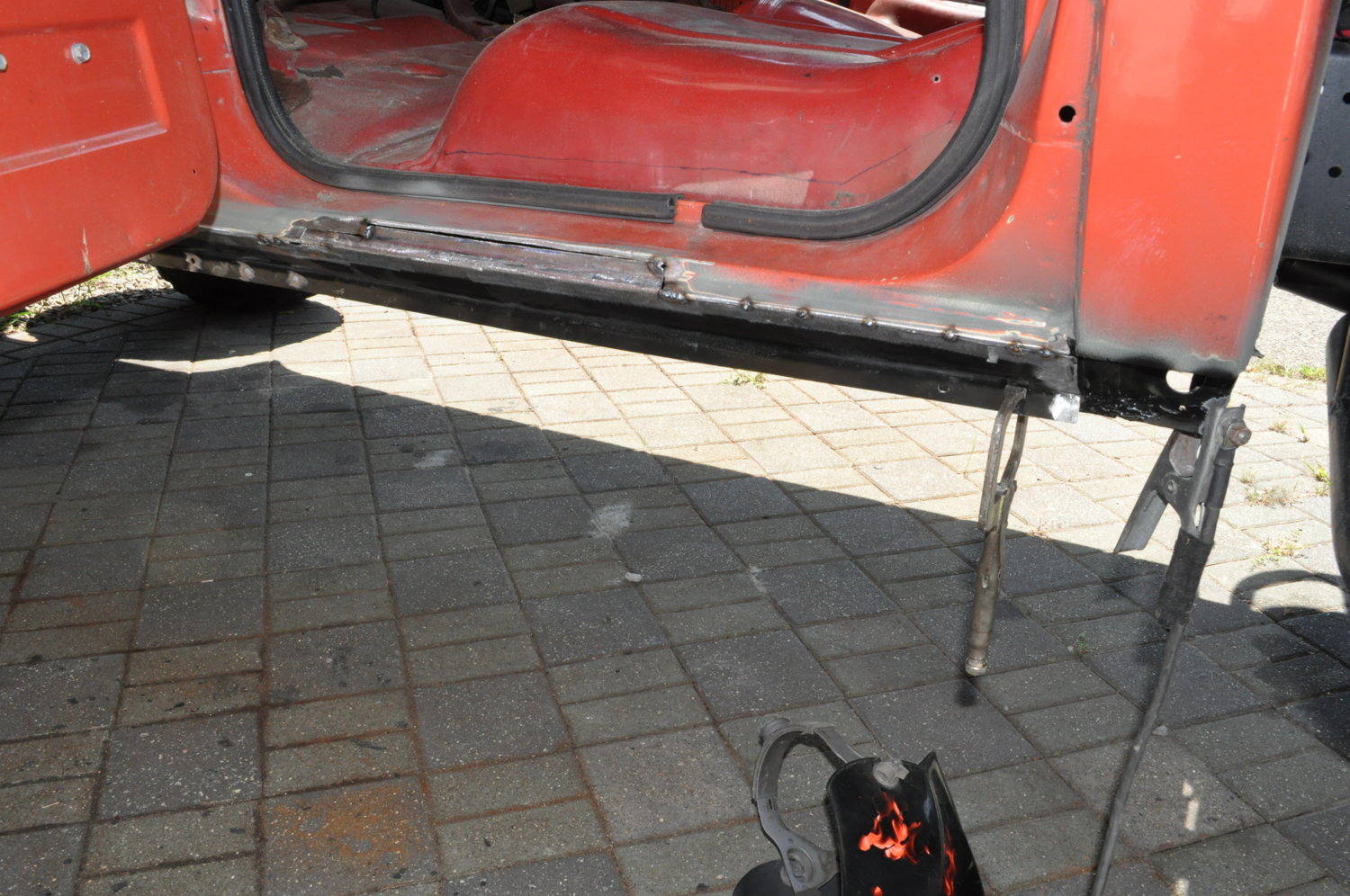

sat I'll grind all the welds out, and finish the cab corner..... following week, any bodywork, prime/paint....
stoopid taiwan cr@p, even that bottom lip is uneven if you look close .. the center is like 7/8".. the ends are a fat inch... need to grind that flat next week... other than that, my patience paid off and for a patch with 6' of running weld, it came out on point....

Damn that looks clean. I've been trying to up my sheet metal game lately. It doesn't come out like that just yet...
thanks.... :)
I actually have to go back in and trim up the bottom lip a bit more, it's still not quite level.... about an 1/8" in front and back...
but other than that, I'm VERY pleased with how it came out considering how off the Taiwan stuff is.. my kingdom for a brake... :doah: minimal mud and the buttwelds went well, just had to go back and touch up 2 spots with the MIG after grinding... but it took me a day to fit it up, and 5 hrs to weld it in...
