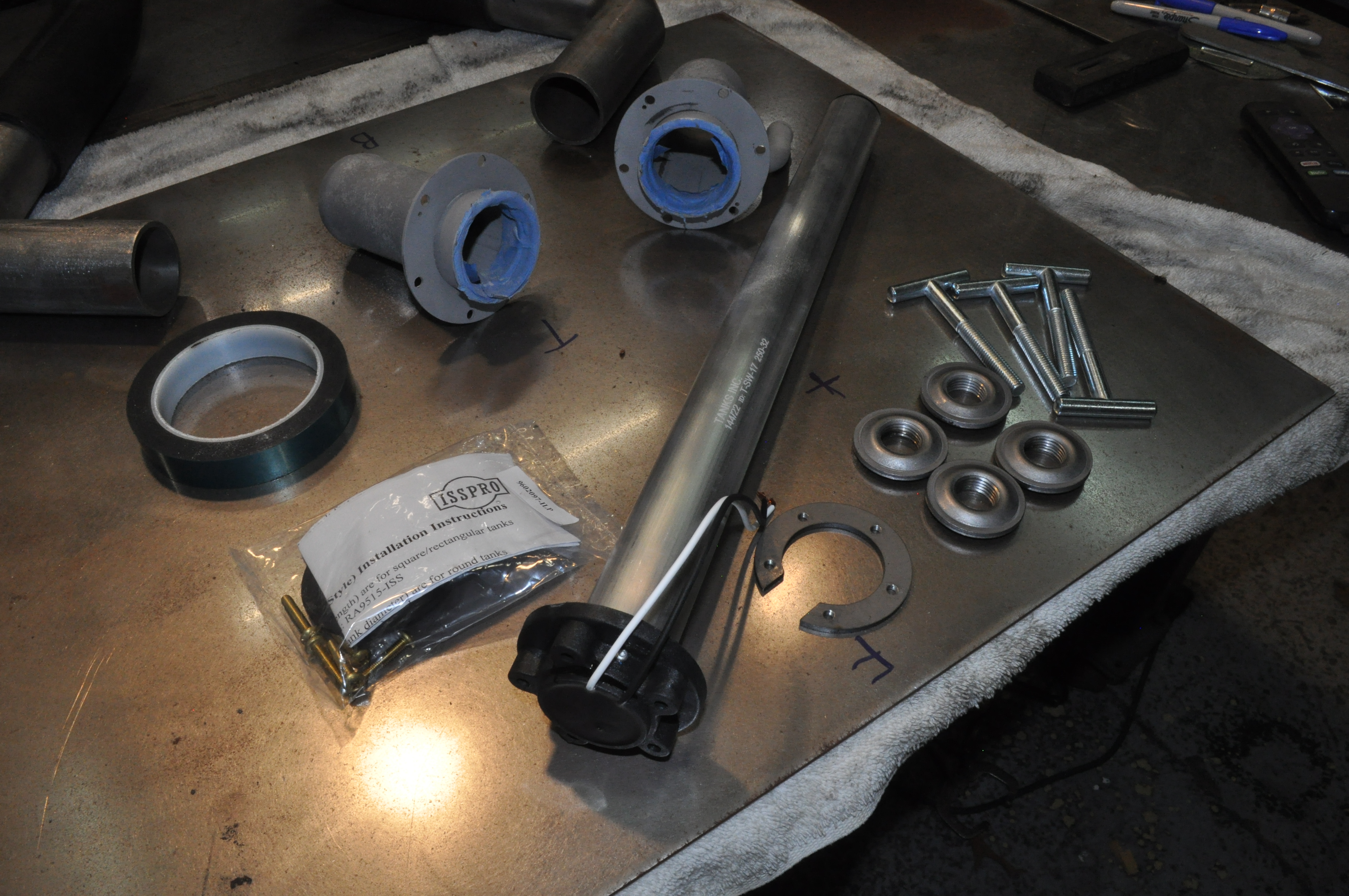

so... after some life..... trying to gear up for putting the top of the tank together...
an order from Tanksinc.com showed today.... 1/2" NPT weld-in bungs, T-bolts for the stainless holddowns I'm building.... and a threaded, weld-in bung for the "no moving parts" fuel sender for an 18" tank.....
full
props to tanksinc, they had the oddball sender size i needed on the shelf, and my order showed in like 3, 4 days...

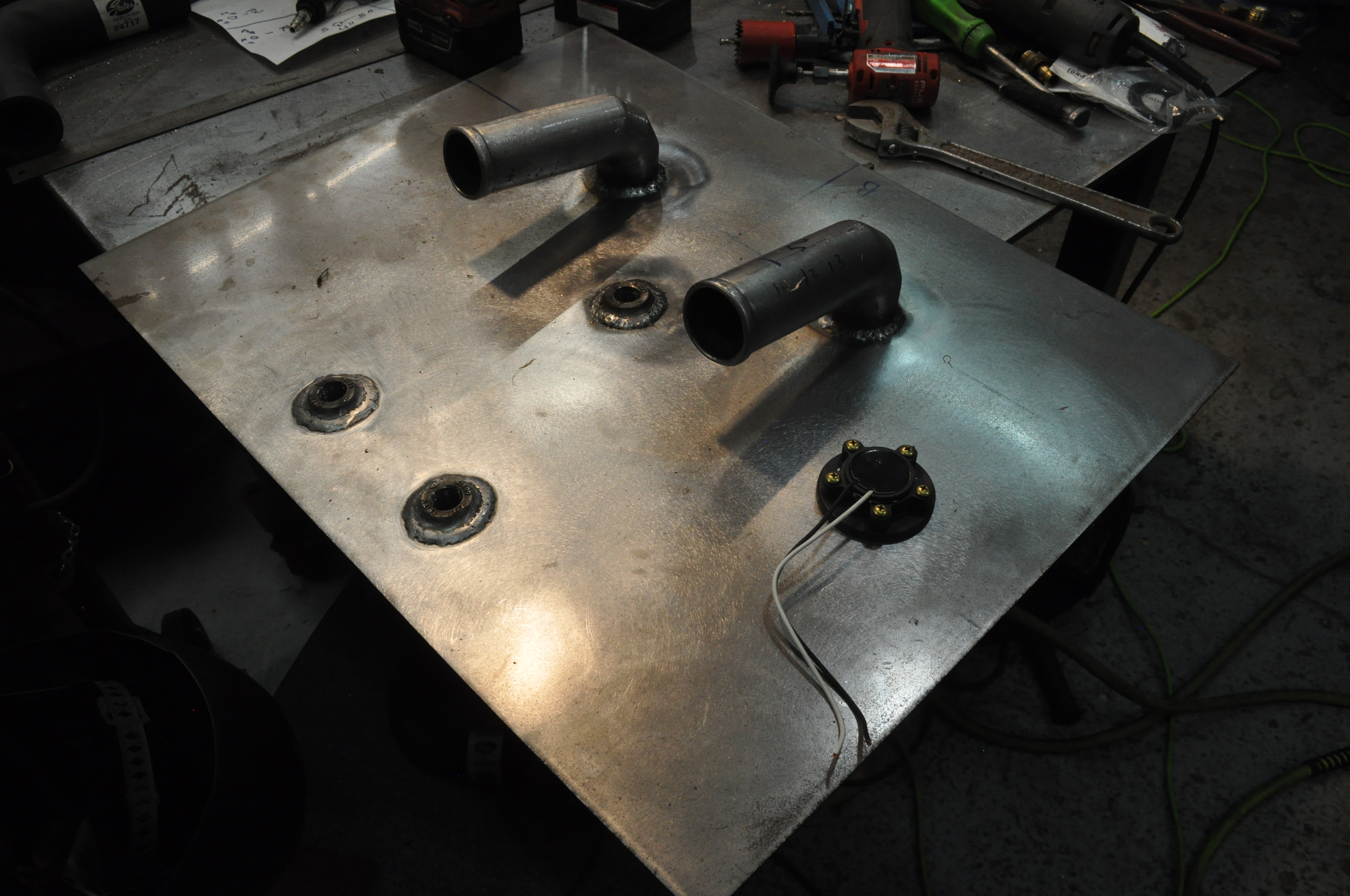

you may also notice the fills there, out of the blast cab... and a roll of dark green tape... need to prep them for my pool bud to powdercoat em...
the weekend work will be starting to get the top prepped... need to finish smoothing the wall cutouts for the fills...
full
first time I've had the ole Parker Metalworking fireaxe out in a while! :doah: :haha:
but I also need to start drilling/fitting the 2 fills, the bungs, sender, etc... so I'm sure I'll need a couple new holesaws... also the slits for the wall plug welds, which I'm also looking to tie into the lifting hook...
I have a bit of time here, so I also need to see about getting a small roll of SS wire for the Miller.. and gasp! maybe even the proper trimix... :whistle: I doubt that tho, probably run me $200 to get into another bottle these days...
I just need to plug weld the end, "fold over the T-bolt" sections... I could even weld it in steel and just douche the ends in rattlecan prolly if need be...

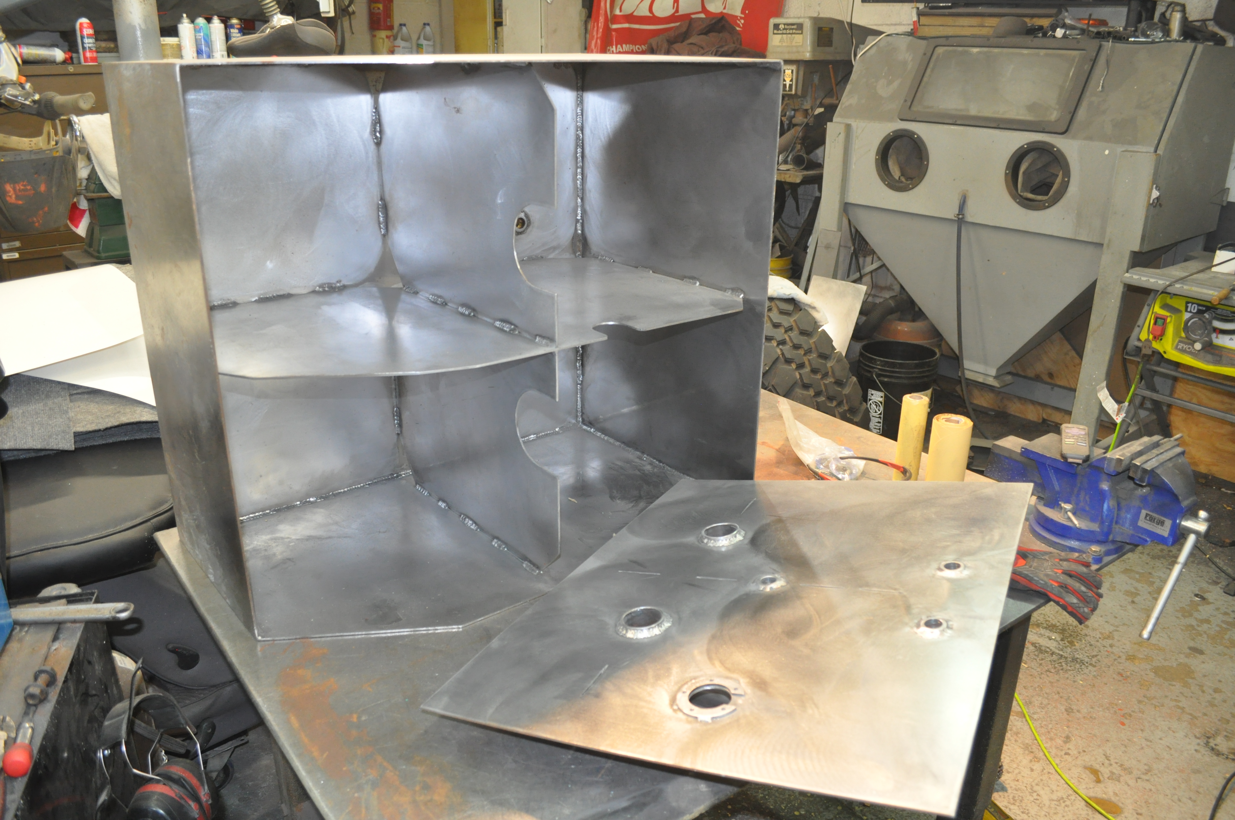

drain bung done...
full
also finished smoothing the baffle wall cutouts...
tomorrow I start working on the top plate after shootin pool.. I expect that to take a couple weekends of fit up before burning in......

but weld slits are cut, tank is on the bench...
full
i'll try to sneak in some hrs after torture this week to finalize the walls... want to find a good wire wheel to burnish the welds, get a real solid 320 sand, if not 400 on the flats.... possibly a final compound/wheel...
but plans are to burn it in next week... get to the exterior, straps, etc...

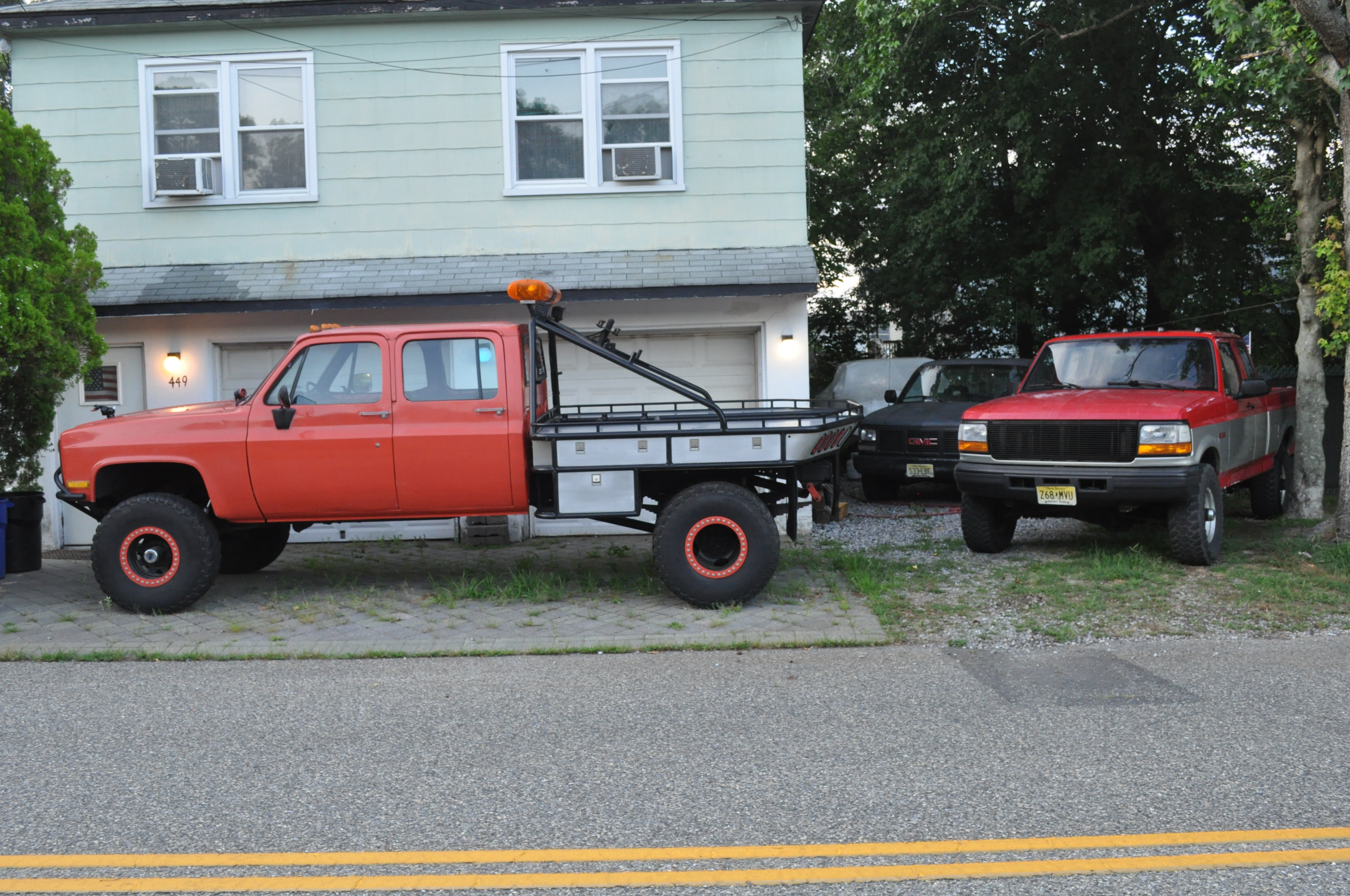

as an aside.. it's amazing how much better utilization of space it is with the 2 drivers being angled next to the house now .. front to back, the furd would nearly stick out in the street... keeps me from having to park the furd on the grass...

*edit* man, that furd needs a bit stouter stance... :(
