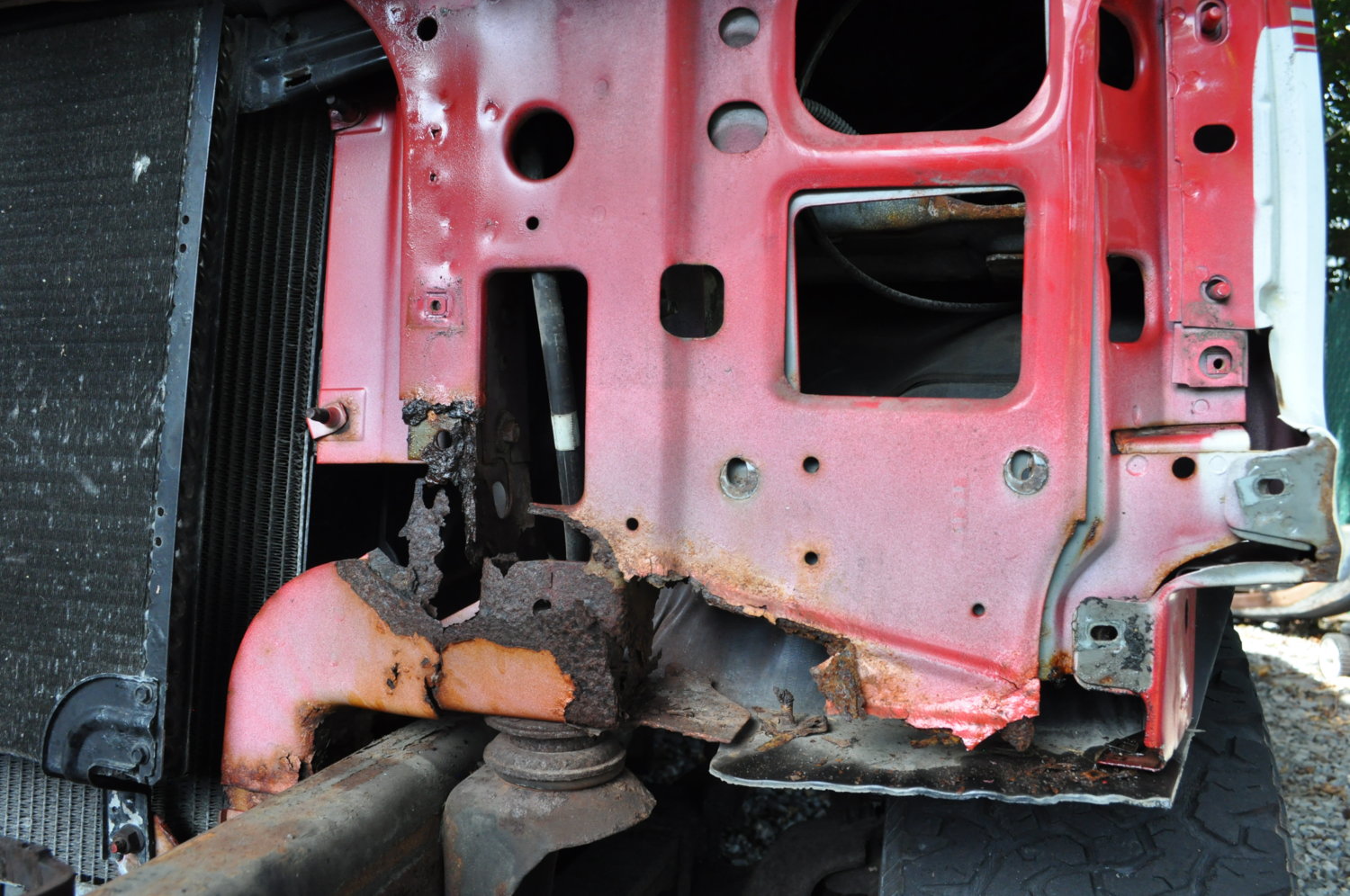

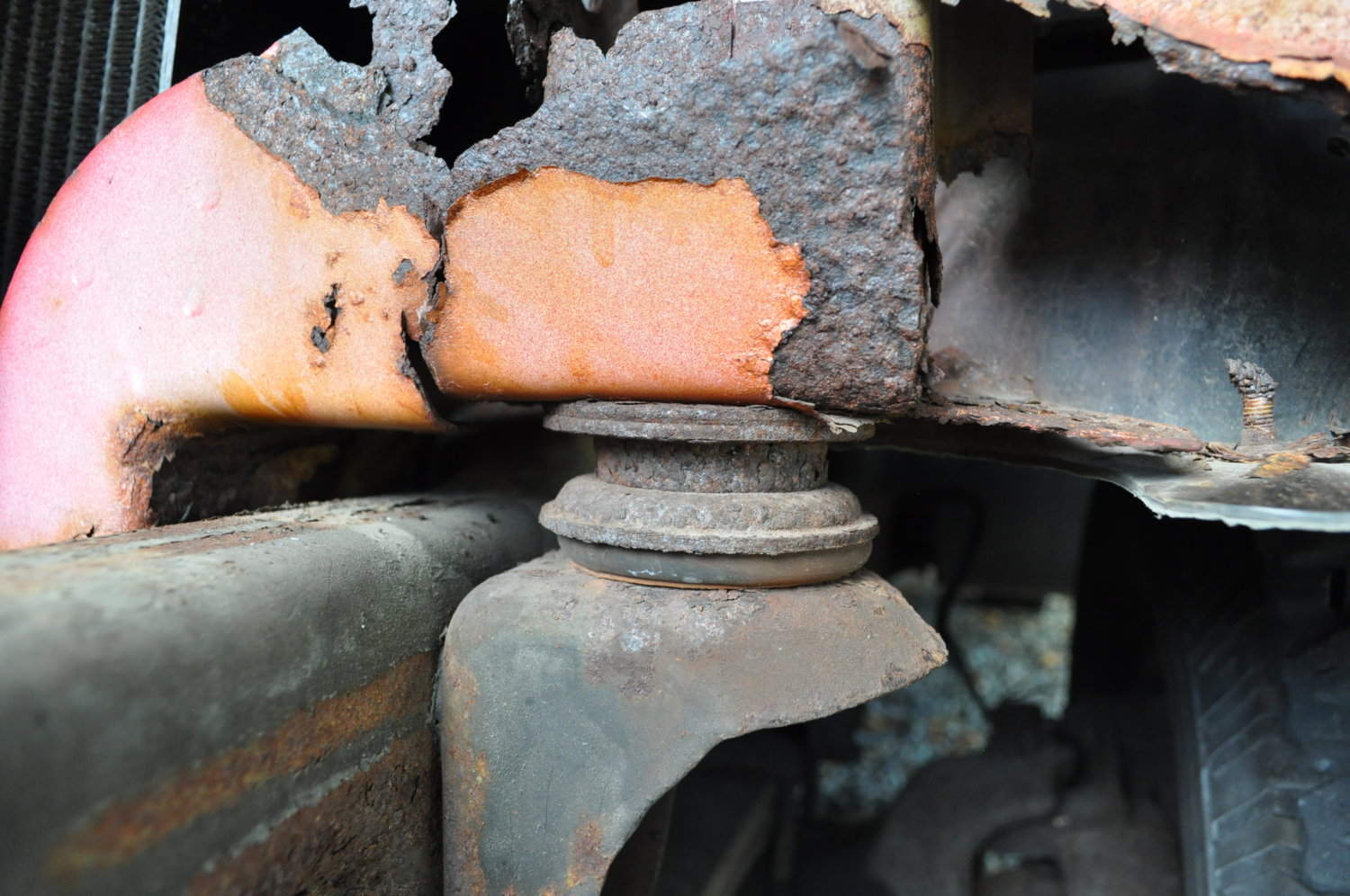

here's the worst repair I'll do.. the other side is about 1/2 this...
full
for now, I'll just trim it up a bit and blast/prime it... till I get a patch panel, 8th day of the week....
got stuck doing quiet work today.. good neighbor and all that....

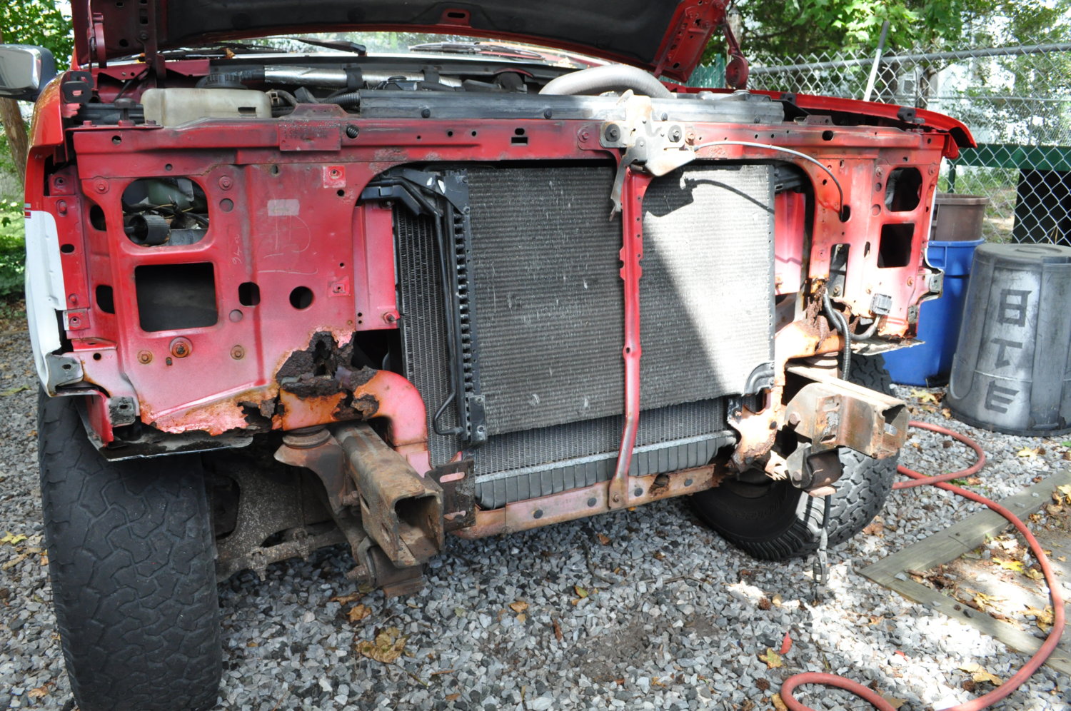

here's a better view of the carnage...
full
full
full

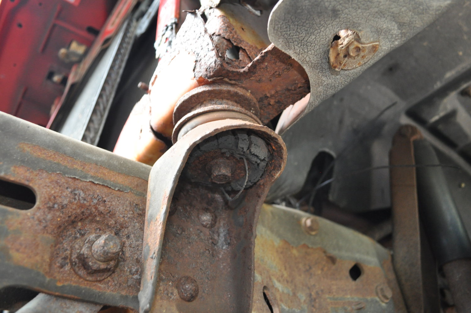

here's how the rig will sit for a few wks until Mutt's rockers are done... than I can move this into that work spot and disable it... basically it's the 2 mounts and rad/condenser brackets and it's out....
full
I think I like the whole plastic wheel well deal.. i think... so far the furd engineering hasn't fugged me... in due time I suppose... ;)
Damn I don't miss the rust belt.
It's weird tho.. There's a few spots that are pretty hammered... But a good bit of the rig is in unbelievable shape when you consider that rad support..
Probably one of those combination effects. Not so thick/well coated metal in a spot where the salt can just sit and rot it out. Also, a lot of people don't stick the hose in there and wash it off very thoroughly.
Sorta like cab corners.

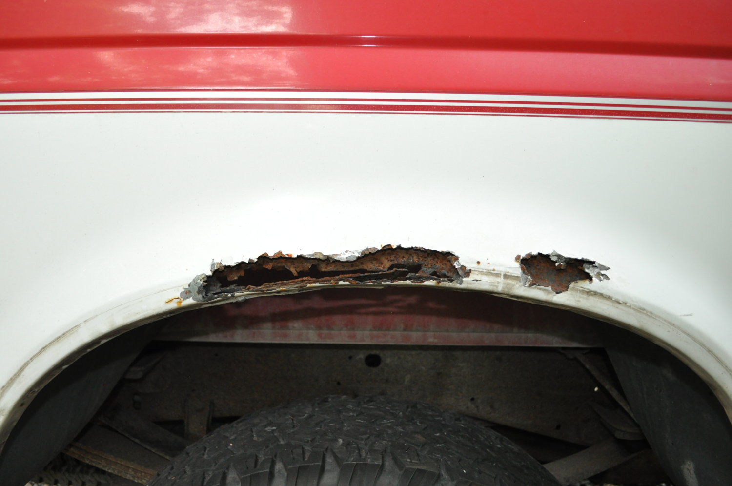

exactly.. that's what happens to those rear well lips... other than a golfball hole on each inner, the rockers are solid.. fenders, floors and cab corners are fine... new gate and those 2 patches will fix the bed up enough...
considering this rig has been a daily in Jersey for 23 yrs and literally hasn't been washed in 15 yrs, I'm pretty content with it... once these mounts are done, I'll be much more confident in it becoming a solid, clean, long lasting rig.. bit at a time.....

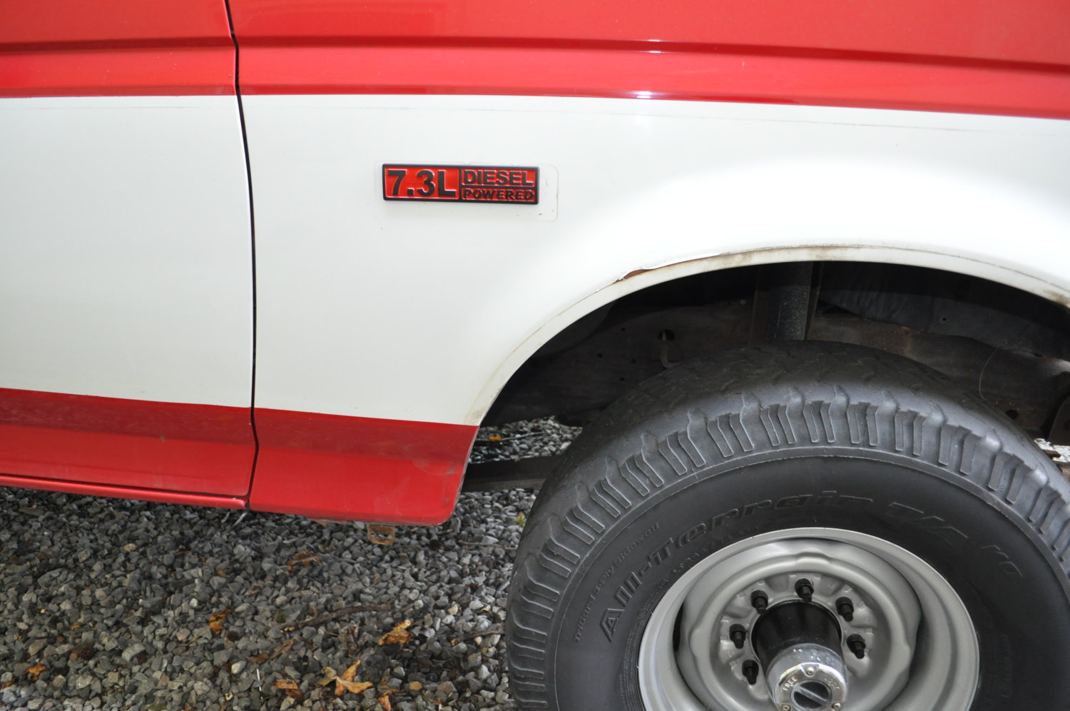

got the emblems... just scotch taped for effect... I think it's gonna look killa with the panel in argent silver..
which I also picked up today.... never shot the Nason base/clear.. we'll see, it's friggin cheap...
full
the red is close enough to the "Vermillion red" that I'd probably just leave em... especially if i reshoot the rig with fresh red..
just some old body guy babble... you'll notice I pulled the striping.. what I'll be doing is bumping that white, soon silver, up a tad at the top, and down at the bottom to bring it a bit closer to each body line....
than I'll be dividing the 2 colors with a 1/4" wide satin black stripe.. than a 1/8" of argent, than a 1/8" black... below the top 1/4", and above the bottom one... so the 1/8" one stands out a bit...

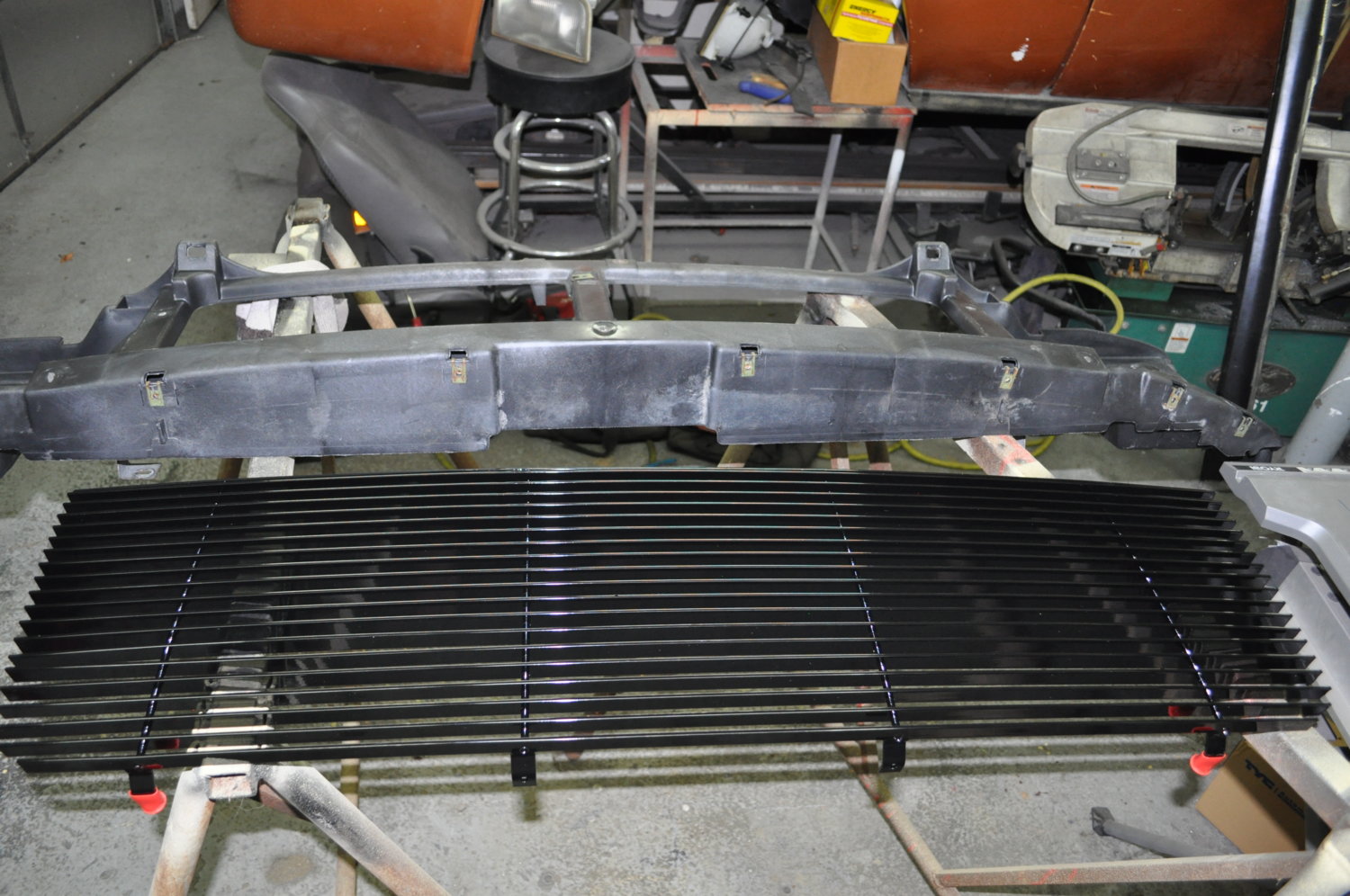

I'm so glad I decided to "step up", and try to buy a quality piece with the billet grill... I was VERY leery about a $54 eghey one... iffy reviews to put it mildly.....
so I went with one from Carriage Works... $225 to my door....
full
it's very stout.... glad I ponied up.... I'm gonna call it the Protest Slicer...
of course it's gloss, needs to go satin... being Mutt's work is grinder/hammer/noisey work these days, been using the Furd as quiet fill-time... was outside wetsanding the white with 600 in prep for paint tonight... scuffing/painting the grill will come under that quiet time...
