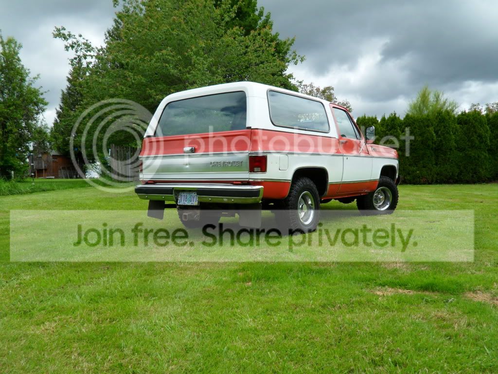

Somebody please tell me that the rear lower quarter trim piece is off center in this photo. Should the two points on the wheel well not match? Which would mean that the rear piece gets angled downward some?

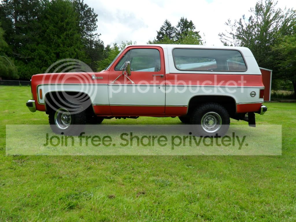

Mask the truck leaving only the white stripe area exposed
Spray white (when to pull tape? immediately or wait till dry)
when white is dry, mask the white off and spray gold
then clear whole thing
Chief, I have found it handy to have a razor blade handy when pulling tape...every once in a while you have a hangup on the tape.
Like Paul says as soon as its past tacky, and pretty much dry. I pull the tape at a slight angle away from the paint just sprayed, and watch the edge closely, if it starts to lift, hit it with the razor blade, then proceed on. I've even cut the edge of the paint/tape line to ensure it doesn't lift from the surface.
Yep. How mine is is how they should be. THis way, it lines up at the lower trim line on the body and the lower trim line at the tail gate.
