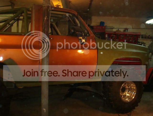

8 more hours today and no luck...that fender just won't align with the door

the bottom of the fender is obviously out.. pull it off and drive the mount flange on the cowl in with a 2x4 and sledge..
I already did that with a giant crescent wrench...the fender bottoms out on something first and when I tighten the bolt it re-straightens the mount flange
I've looked up in there....I swear I don't see anything that looks like it is in the way. The fender gasket is the only thing making contact.
Do you think the gasket could be doing it? I figured it was soft enough to not be a problem....
something's definitely keeping it out.. maybe you can "massage" the inside lower portion of the fender...
When I remove the bolt it "springs" out about 2 inches away from the rocker
When I had it off today I ground down the pinch weld that runs verticle back there...I didn't think it was causing the problem because there are no marks on the cowl...but I ground it down anyway...it didn't help.
By "massage", I think you mean get the freakin' sledgehammer at flatten that S.O.B that's what I feel like doing.
I'm assuming it's "springing out" with the top, back bolts tight.
loosen EVERY other bolt so they are almost undone, than tighten that one at the bottom and see if it goes in.. .
Yeah...with the top back bolt tight.
I initially removed the fender and unbolted the core support. Then put the fender on and tightened that bottom first. I think that time it was pretty flat against the rocker panel...but when I bolted in the top it was still sticking out in the middle. and that was with only the back bottom and back top bolts in....no core support bolts or any other bolts
do that again, but this time when you tighten that bottom bolt first you need to make sure it is pulled all the way down.. you may even wanna hog the hole out a tad.. by hard mounting that as low as possible, it wont want to bow out as much in the middle... instead you'll somewhat be stretching it flat once the top is tight....
