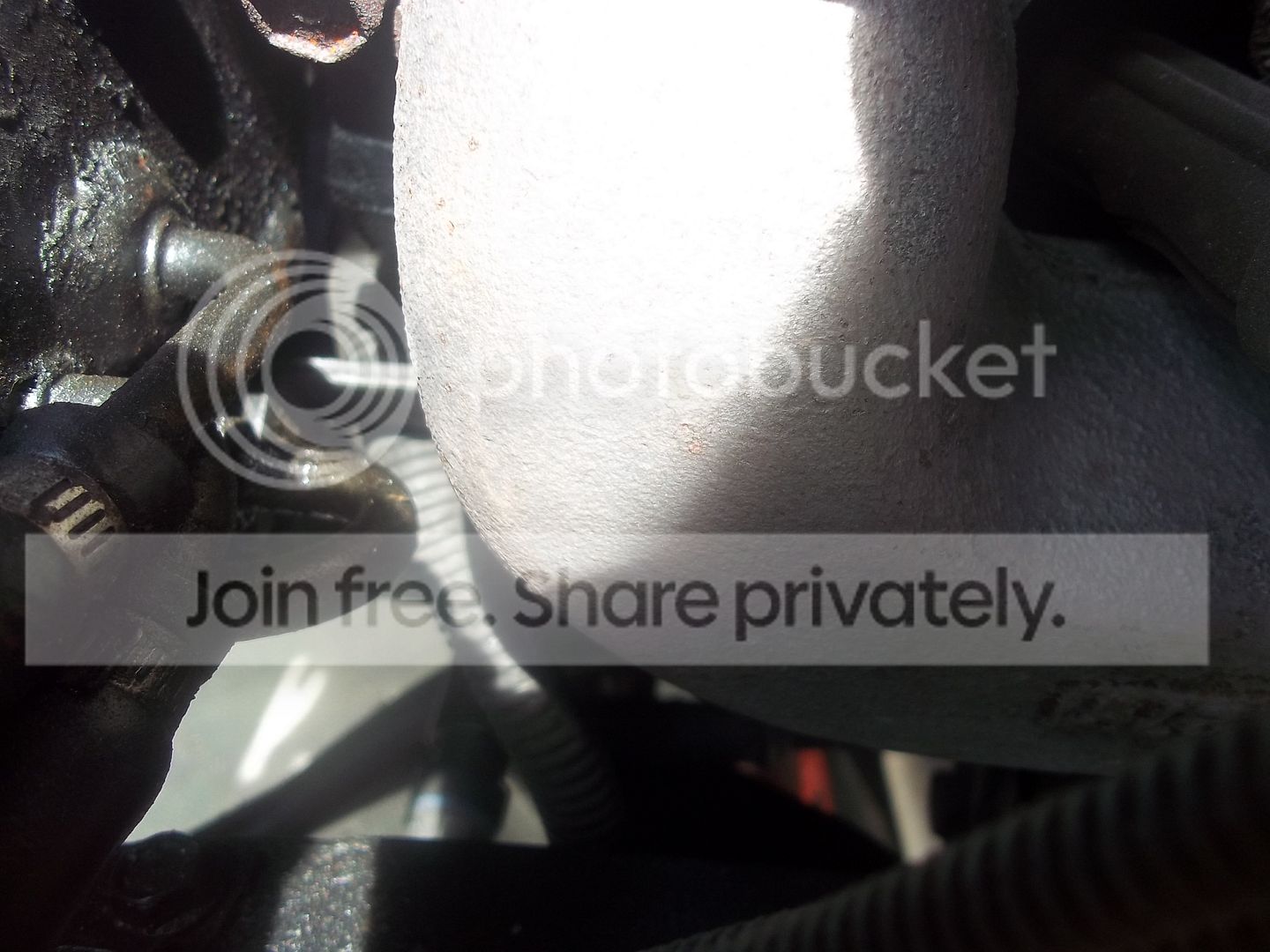

I had very good luck with the VHT flame proof header paint on a used set of headers. Sandblasted to bare, then three or four thin coats of the VHT and three years later they still looked good.
As for the master, maybe swap in one of the aluminum versions? Might not be 100% period correct, but it won't look like ass.
I've got some "clay coating" from mud pit in Hollister on my manifolds. It looks horrible but has worked well at keeping the rust off. Maybe I'll clean them and try the VHT...
