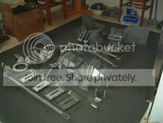

first, ANY part, whether a hood, air cleaner, wheelwell, door, etc will benefit from a proper coating procedure.. in other words, no matter what paint you put on a zinc/fill prime process prior will make it that much more durable..
for example, full load of blasted parts..
zinced

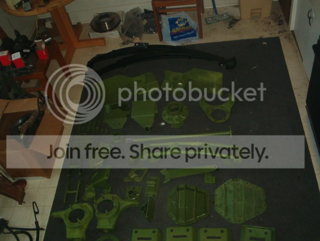

then 2k urethane primer.. can't seem to find that pic...

Painted truck parts on the kitchen floor.....
