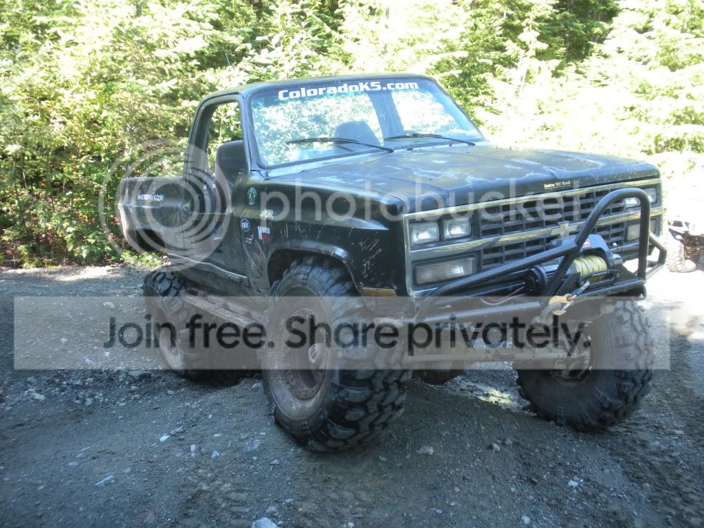

Here is my setup. ~5" lift axle moved forward ~3" and as much as I can cut. I hammered the firewall an inch or two to line up with the fender cut. I also bumpstopped about 4" of uptravel out to prevent my tire from rubbing on the firewall. I still get into the rad support sometimes if I am really twisted up and turning.
As you can see its tight with 40's, but my tires are 16" wide too so that doesnt help.

Well one thing that will help you for sure fitting 42's is moving the front axle forward. The normal clearance issues are at the firewall when the suspension compresses the axle moves aft. Regular lift springs will help some with clearances as they generally dont travel near as much as the 52's or 56's.

well damn man! This sounds like a bad idea...
do you think they would fit a lot better with 2 more inches of lift? I might be hackin my truck up more than I really want to in order to make this work. This sucks... Maybe 42's are just too big.
Man Im not trying to discourage you in any way. Just pointing out a few things so you can be prepared for it. :waytogo:
I mean if you can get the tires for nothing then sure go for it. It takes a lot of upgrades to run a tire that big. I know I was kinda shocked how much bigger the tires were going from 50% 37's to brand new 40's I trimmed some more and the first time I went wheeling I instantly knew I didnt cut near enough :doah:
