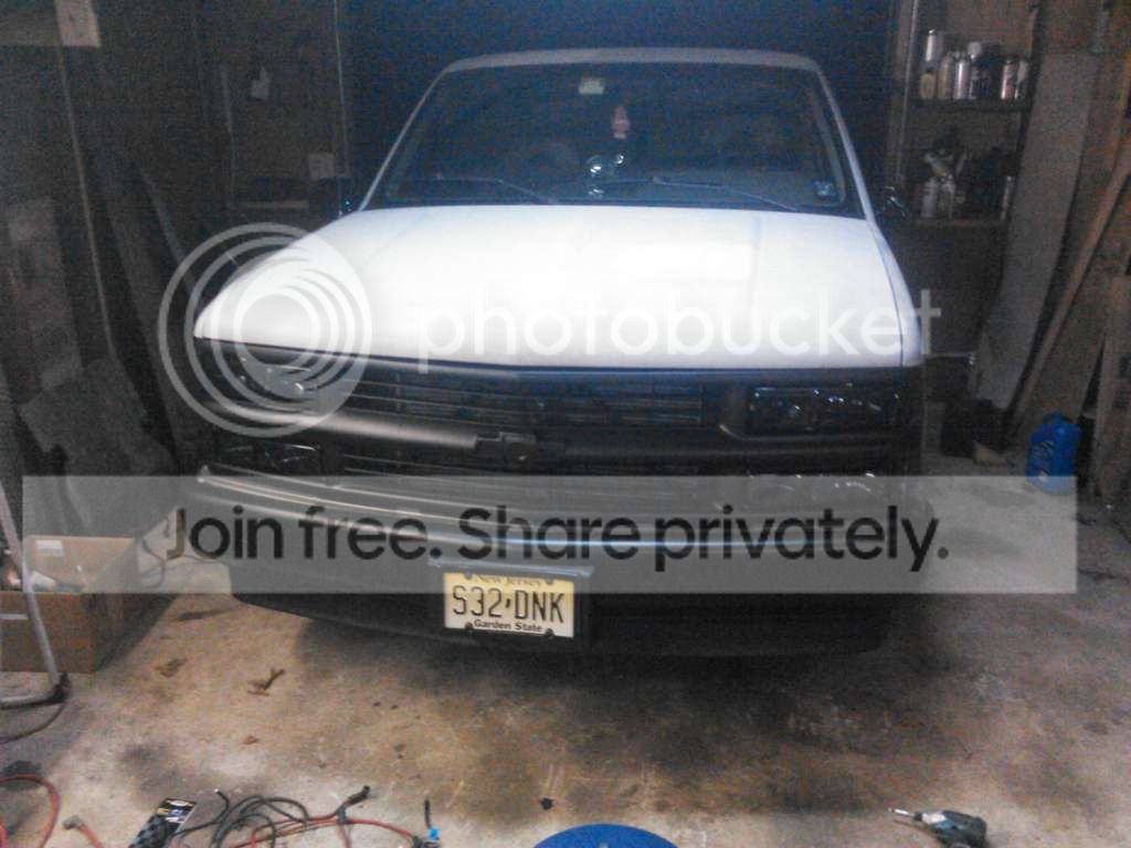

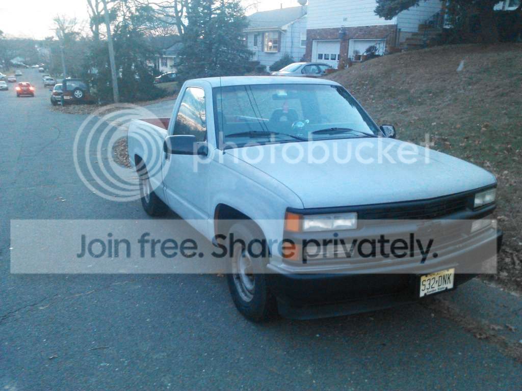

Very successful trip to the junkyard today. Lots and lots of gmt400s stripped of their grilles. Was looking for that pre 94 sport grill. Finally found one and then I stumbled on a 95+ grille that was color matched to the truck instead of chrome. It was in awesome shape and I really liked it not in chrome so I brought it, head lights and buckets, and marker lights. Plus a chevy horn button. I also found a standard cab pre94 silverado with a full interior in it that Im going to go back and get some pieces out of.
But heres the pics of the flat black front end. My GMC base model work truck is growing up into a Chevy Street Rod :thumb:
Love the grill!!! Way better than the wt grill fer sure.

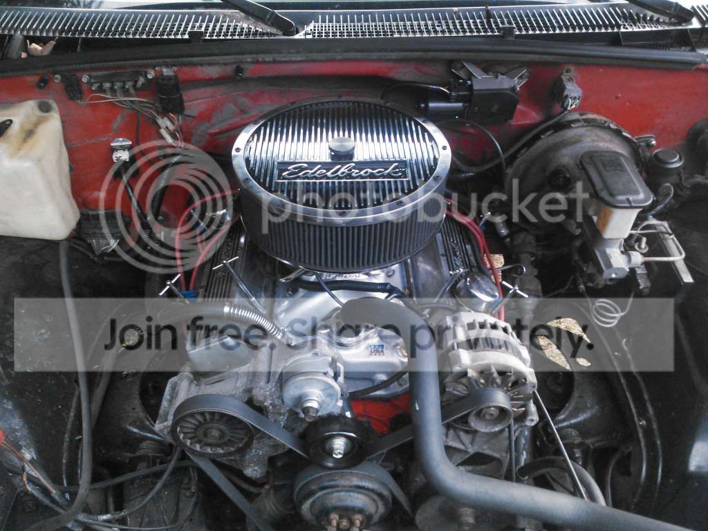

Snapped an underhood of the new air cleaner to match the valve covers.

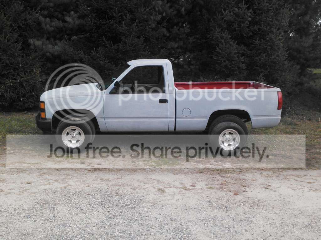

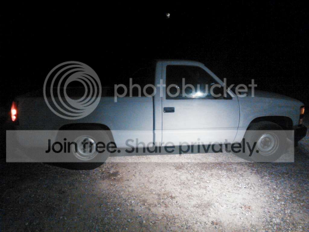

Terrible picture but the truck is now sitting lower in the rear than the front :doah:
Put 3" drop leaf springs in but didnt have time to put the 1in drop coils in the front. Im planning on dropping the front 1in with them and picking the back up an inch buy swapping around the zero rate leafs that were in the pack to thicken it. Hopefully it will sit with just a slight rake.

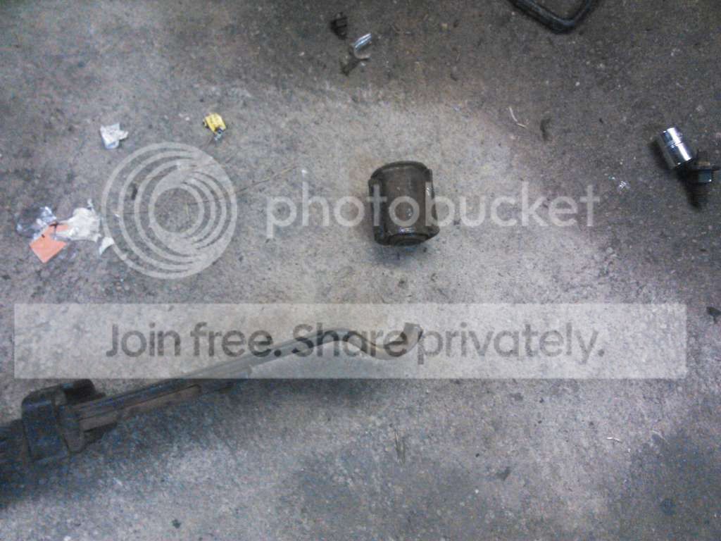

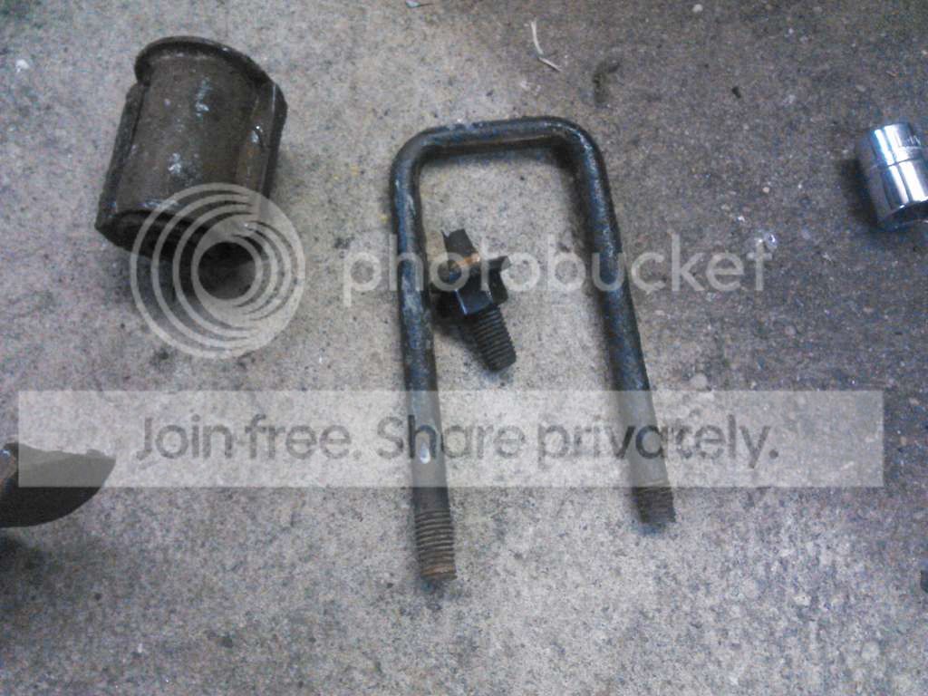

Heres a good reason to change your leaf springs...
And I wound up doing a u bolt flip because my stock ones were rotted to hell...
I'll never understand what the purpose of putting square style u bolts in something is...

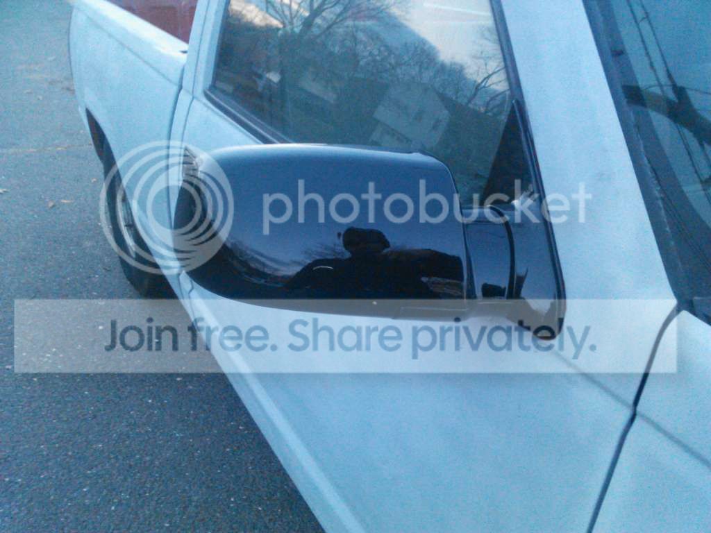

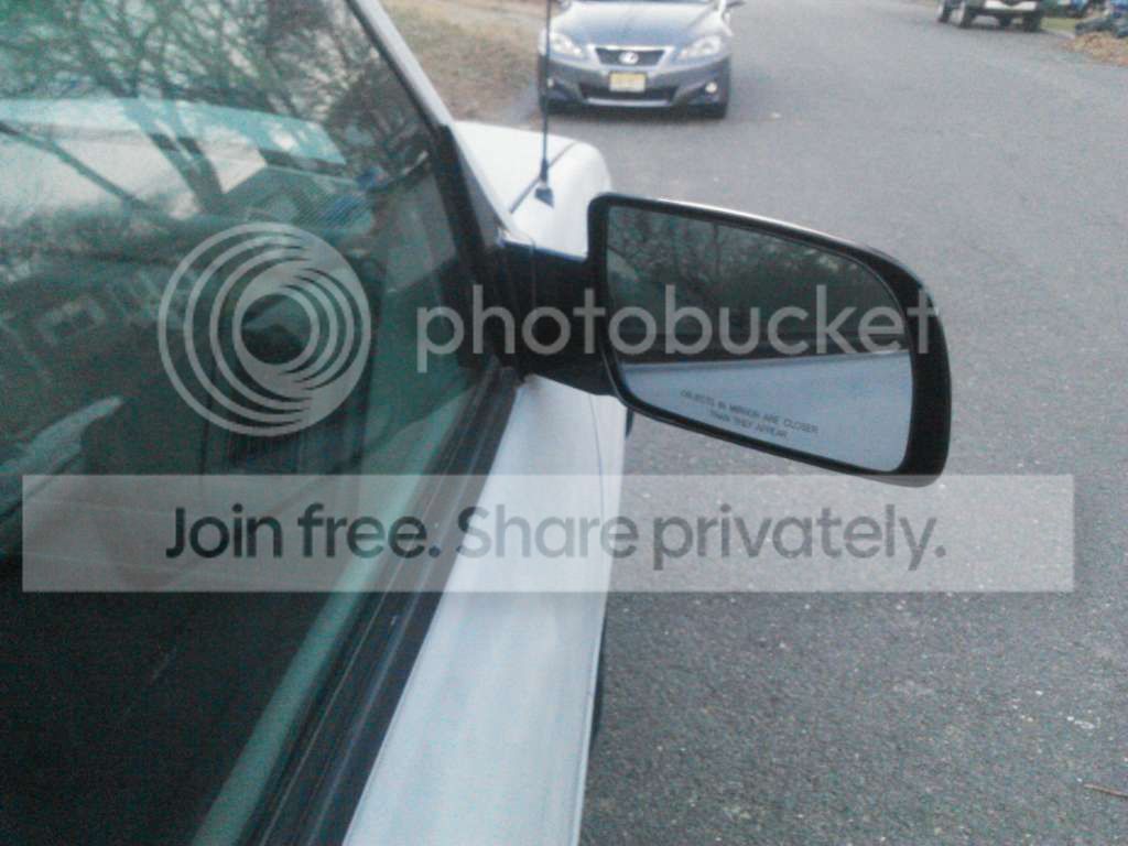

Threw some $50 China manual sport mirrors on. I cant believe the quality I got for $50. Theyre solid as all hell...

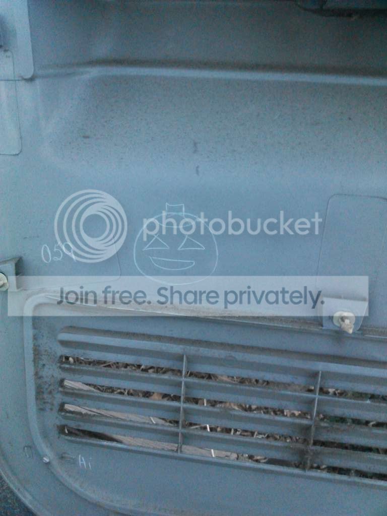

Also found out that apparently my production date must have been halloween since theres a pumpkin grease penciled onto my door panel lol.
Thats pretty cool. Makes it even more unique. Kind of like finding writing behind drywall or in cabinets of houses from previous owners.

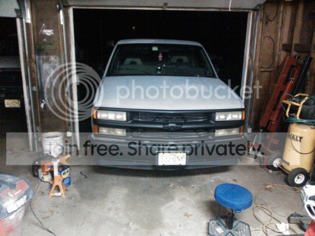

I switched out my plug wires for a fresh set of MSD Streetfires and put some nice fiberglass boots on them so I wont have anymore damn burnt wires.
Also put my new smoked headlights, corner lights, and turn signals in. They look sweet but fit like the ebay junk they are so some hole slotting is in order to get them fitting correctly.
