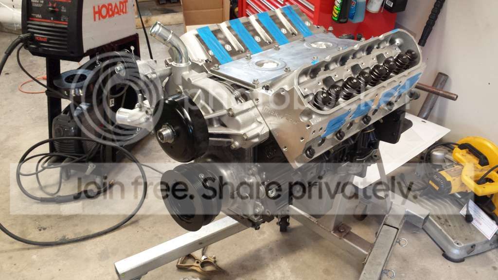

Not much on this front. Planning on pulling the truck into the shop soon to fab up a new trans crossmember. Going to solid mount the trans and make a tube crossmember with bushing and tabs at the frame and big plate notch outs to make the dual exhaust easier. I also decided to use tabs and tube/bushing combos to make my motor mounts. I want to yank the SBC out and get the new motor mocked up so I can pull it again and burn everything 100% w/o the motor in the way.
Gonna order my roller rockers for next week, and maybe valve covers.

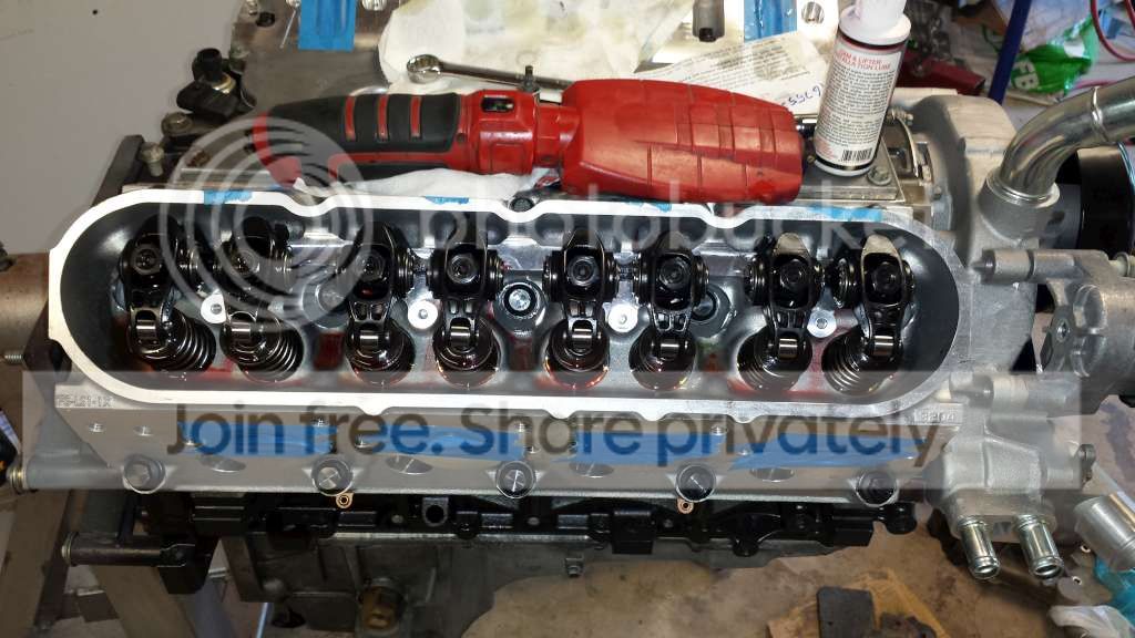

Roller rockers installed and lashed with correct length push rods. Wound up .100 over stock length like trick flow recommends. Im guessing their recommendation is for full roller rockers like I have. I read numerous reports that the .100 over stocks they recommend will bottom out with factory rockers. Guess its good mines adjustable.

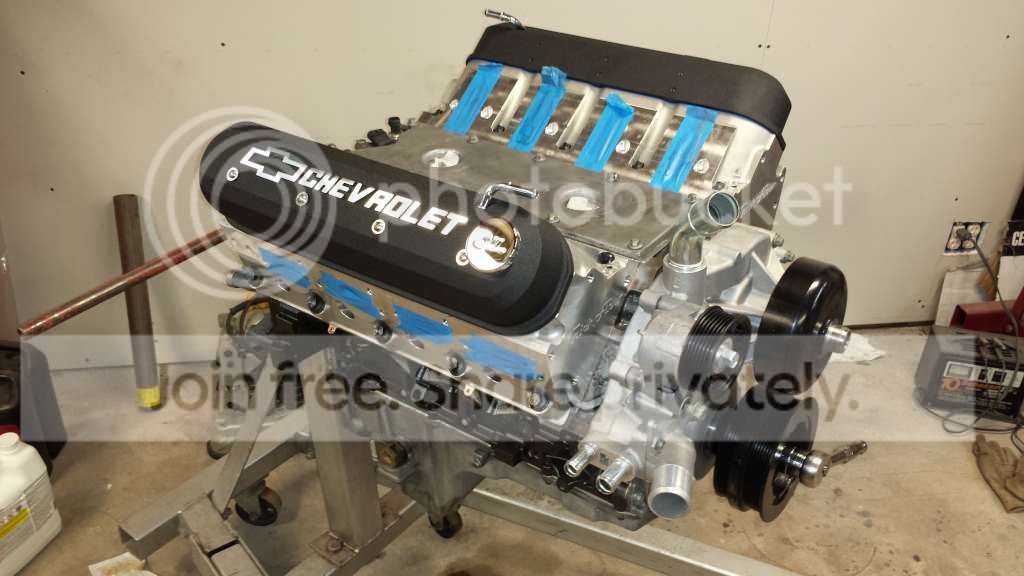

I thought my valve covers were coming tomorrow but I left to install the push rods and came home to them on the porch. Nice blingy picture of the motor buttoned up minus intake tomorrow!
Some tabs and brackets will be here for fabbing the trans crossmember too. Holy **** Im going to fab something for the first time in almost a year!
Ive never been a "bling it out" guys but damn these valve covers are nice...
Gonna change that POS chrome oil cap for an aluminum one though.

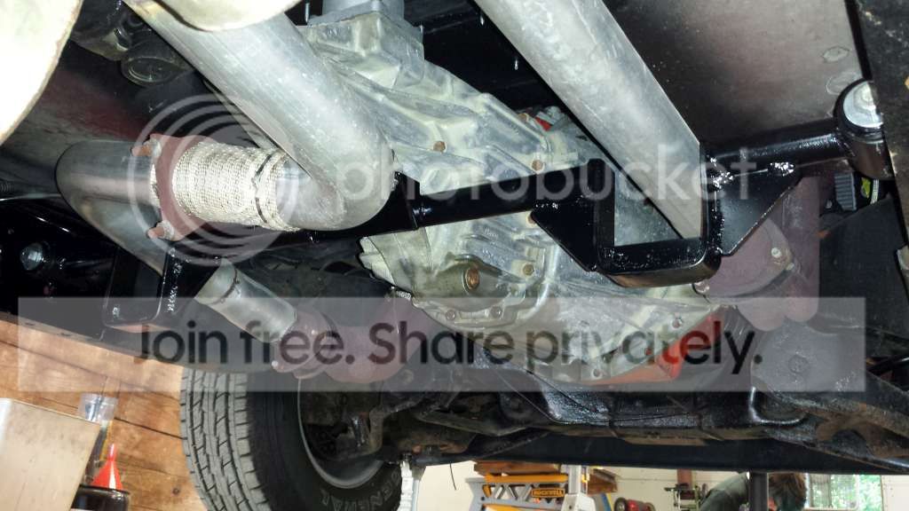

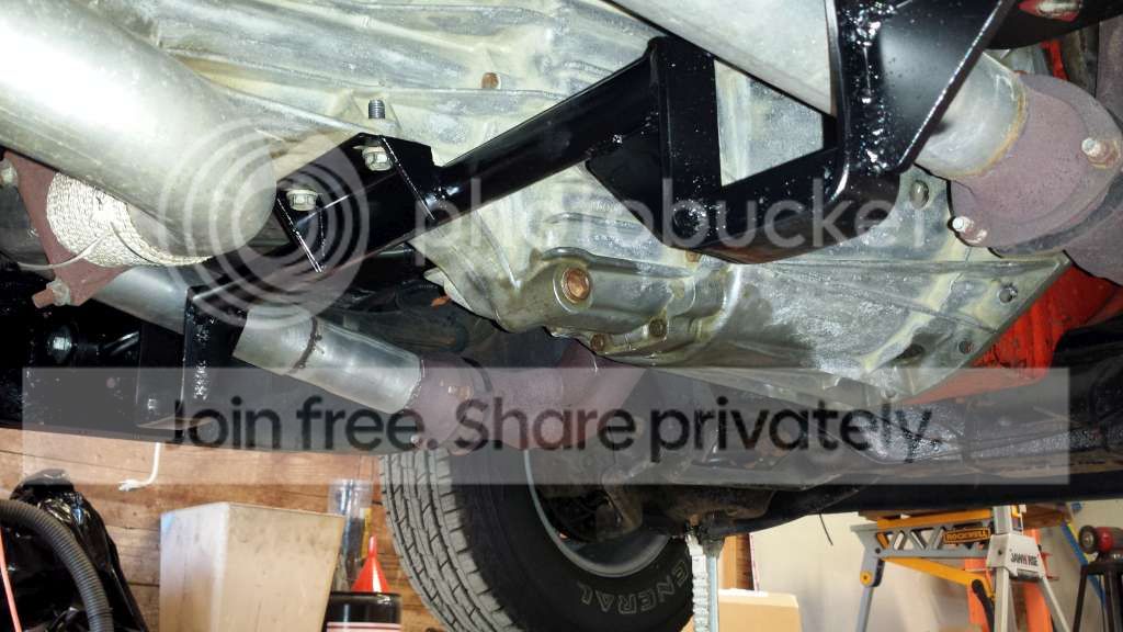

Build a trans crossmember since I was home this weekend. Nice a light and gobs of exhaust room for the new exhaust. The bushing kits I had were a little over kill for a 2wd setup but eh I had them already. Also comes out really easy and fast and obviously theres way more room under the truck without a giant piece of plate under there.
that will do just fine I think .
my 85 2wd I just used a 1ton 4wd flat member and added a upriser to bolt the mount to .
