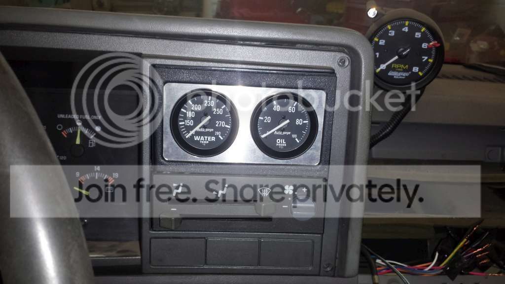

whiteface gauges to me are like low profile tires and curb feelers....
I might just throw the black 2in auto gauges I have in it for the time being since its just a 3x5 piece of aluminum to recut...
So I saved myself the $200 and just did that...
So Im just gonna order the wideband. Speedo will be down the road because they arent freakin cheap...

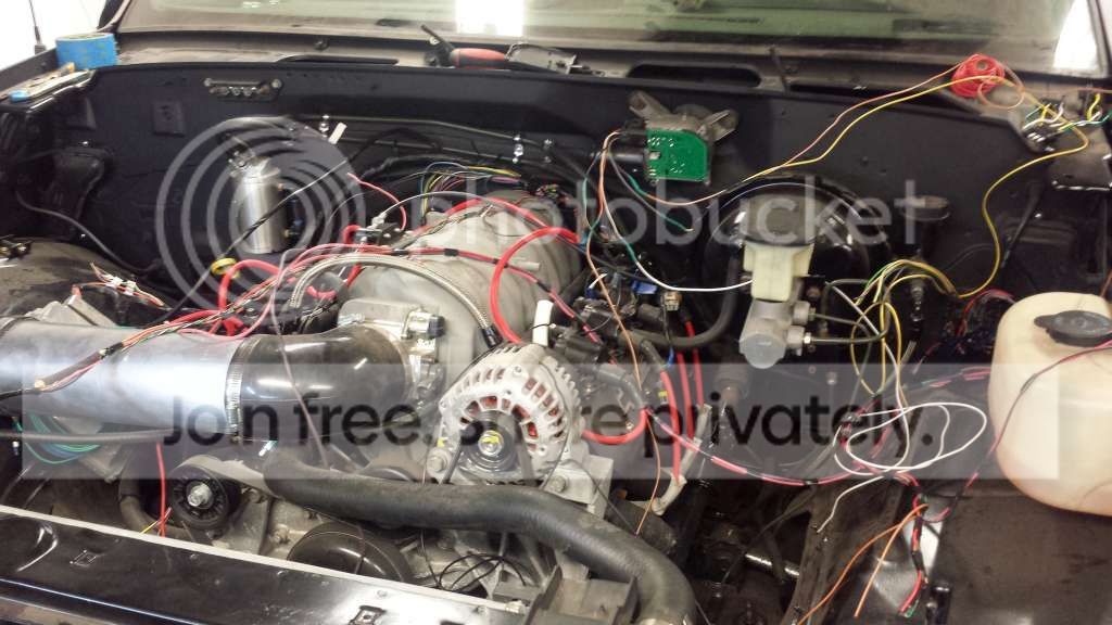

Well heres where Im at.

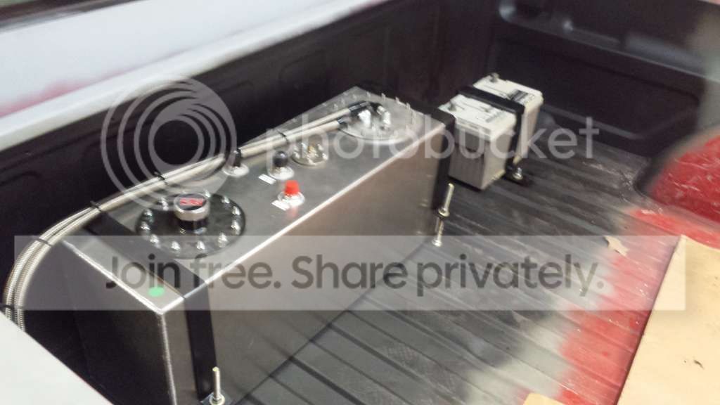

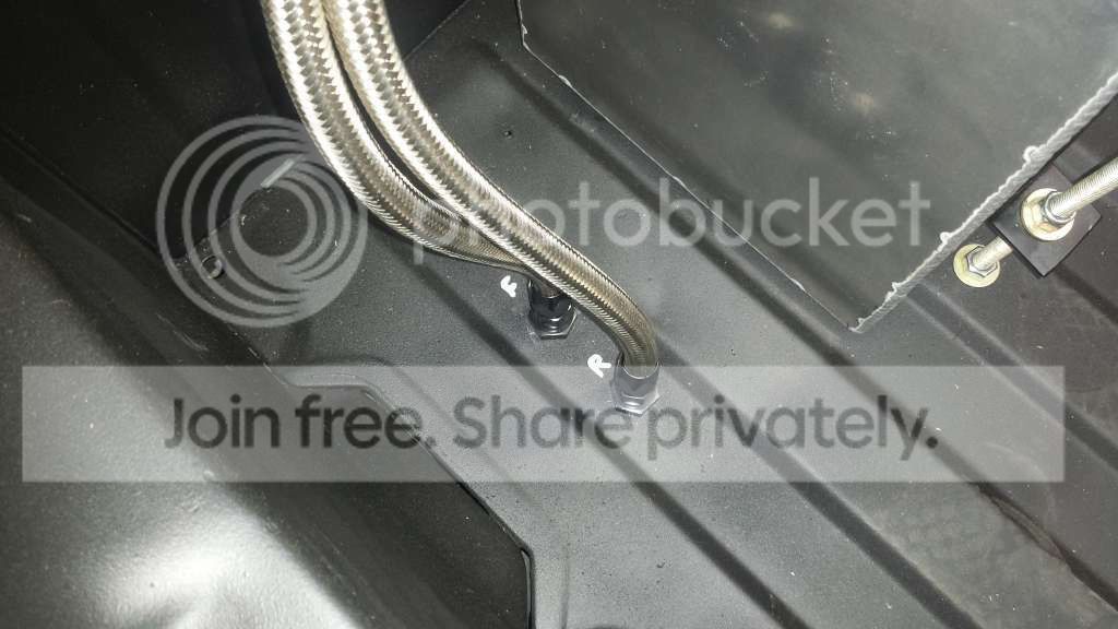

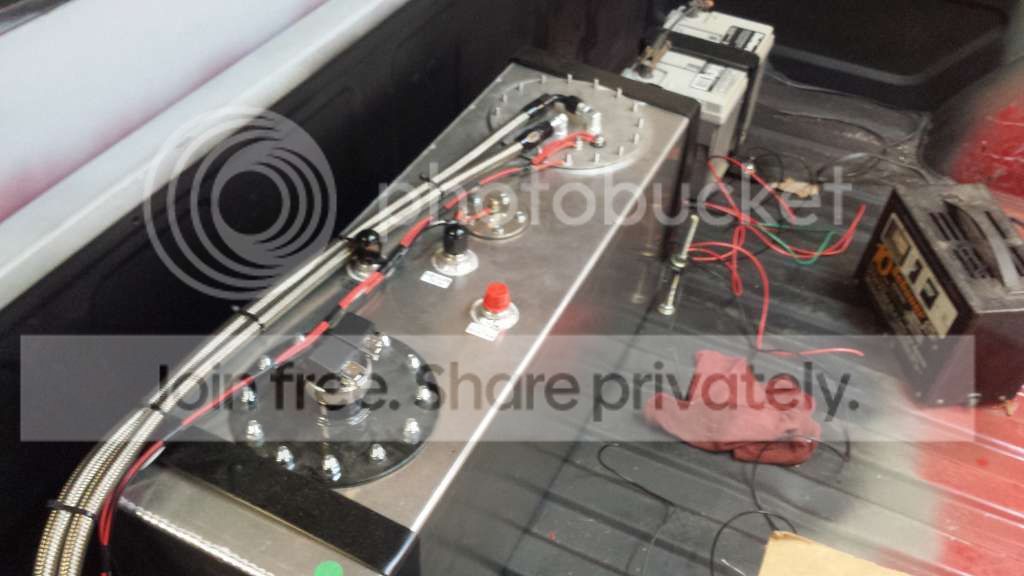

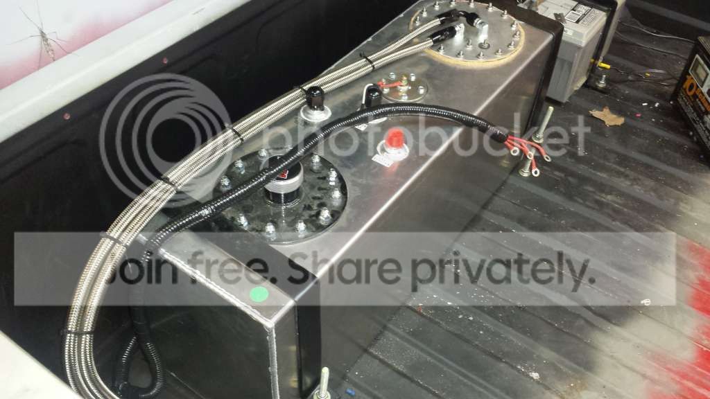

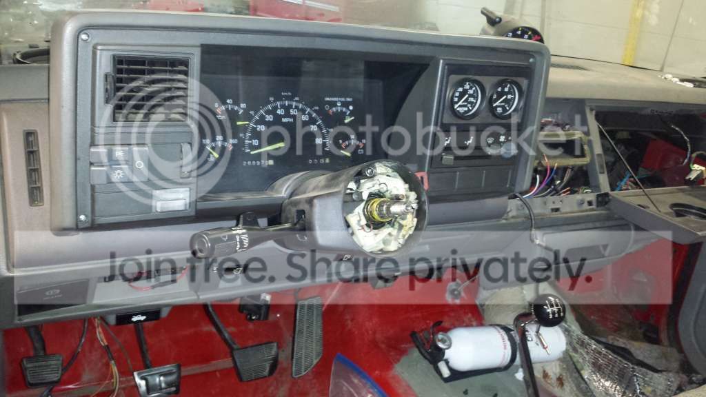

Battery is done, ran through bulkhead to the starter at the moment. Fuel cell is mounted, plumbed through bulkheads. Gauges are all hooked up a wired, dash board is buttoned up, just waiting on a new snap ring for the steering column.

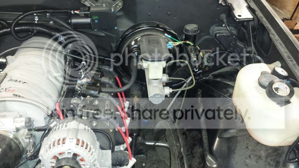

The wiring is done under the hood for the most part. I had to re-stub out for the wiper motor and get a new plug for it. Then I test wired it and it was doing some funky **** that Im chocking up to bad grounding in the cab because I had the battery temporarily wired up. Juice and ground was back feeding everywhere so I walked away from it and decided to just get the battery in and truck/motor fully grounded before continuing.
It looks like a real mess under the hood but Ive got it down. Nothing is a mystery except that damn wiper.

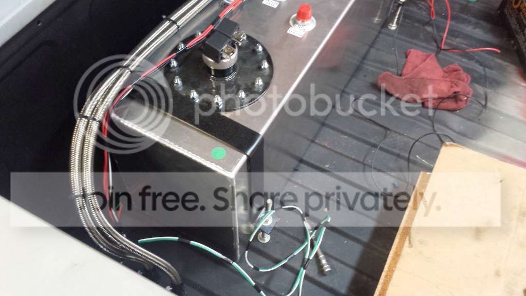

Got any details on that fuel cell setup?
EDIT: Guess I should be more specific - size, manufacturer etc.

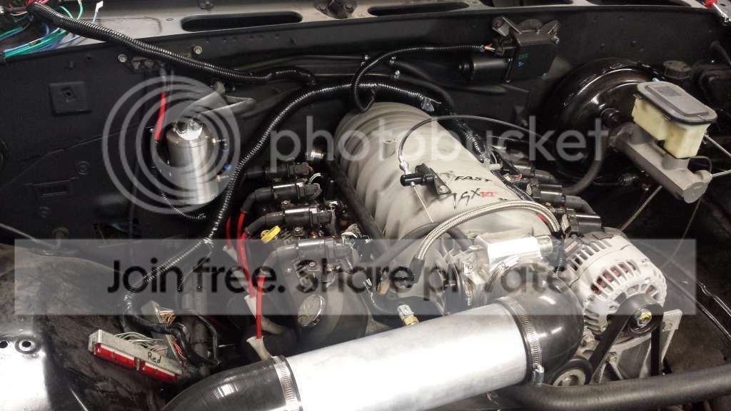

Friday I left off with this mess.

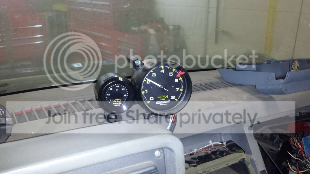

And got my wideband installed next to the tach. I wound up cutting a little over and inch off the gauge pod because it was so ridiculously deep. Yay lathe.

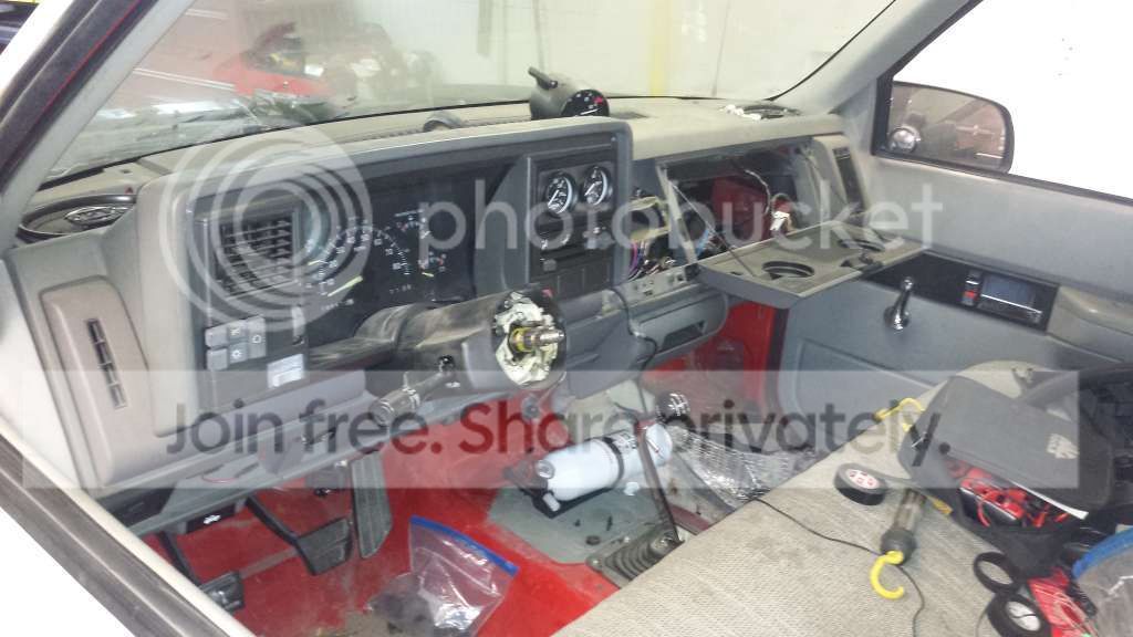

Then yesterday me and the wife worked on the truck from noon until midnight. Things started looking, well good...
Lots of loom, 5 rolls of tape and extensions of legs of harness later and I had a harness that fit and tucked really well. I wish the drivers side leg tucked so damn nice like the passenger side but unfortunately with the alternator, tps, iac, and cts plus the charging wire in the harness it was twice the side of the passengers...
Ive got a couple small hookups to make, mount the ecu some how, mount the LS fuse panel, reflash the ECU and Im golden to fire.
