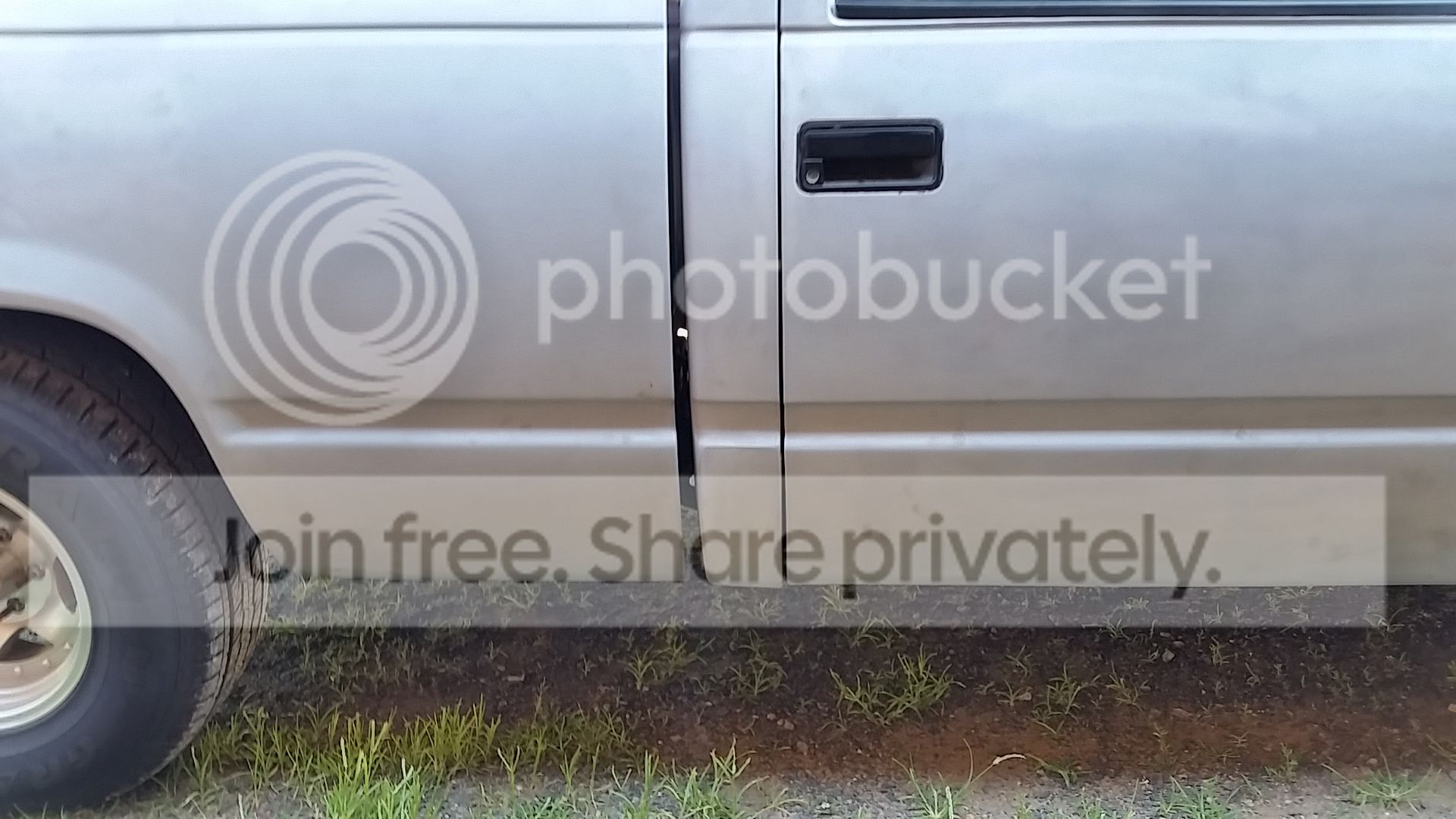

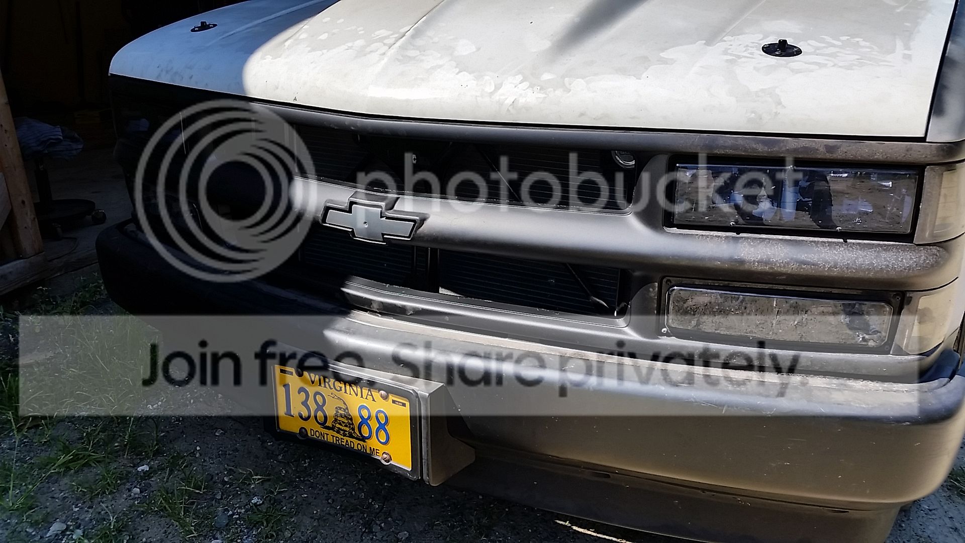

I also finished up all the body mount repairs and got the grille skeletoned out and back on. So the truck is basically back together.
Body still needs some shimming here and there.

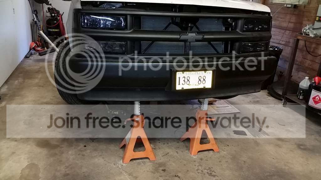

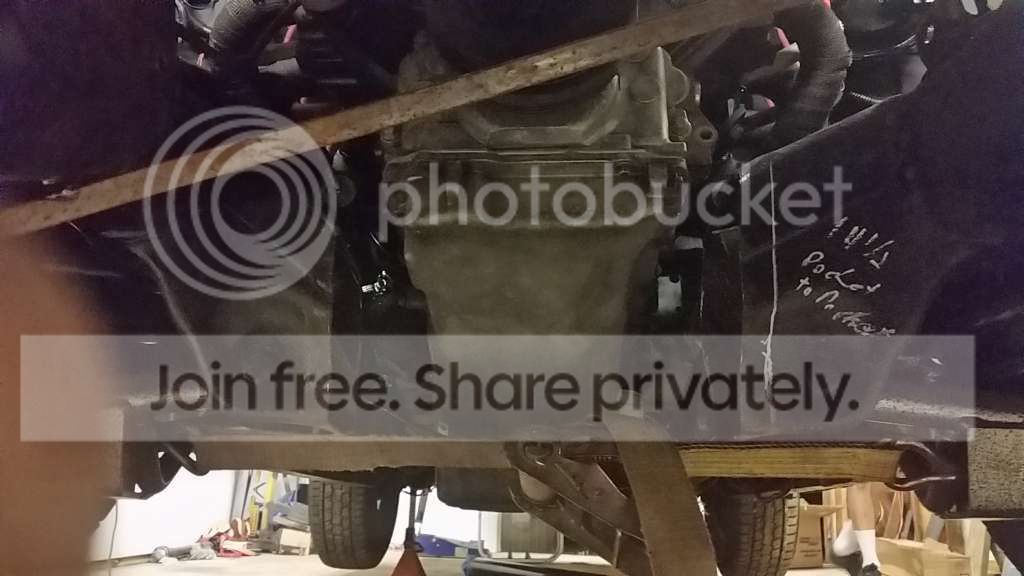

Mustang II rack, PS delete, centerforce clutch, and holley LS swap high clearance pan.

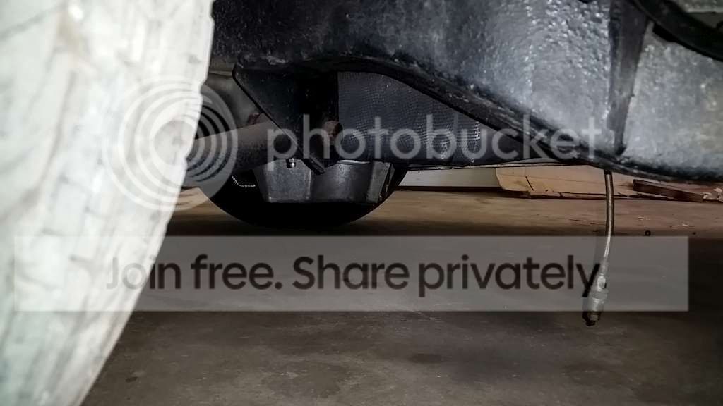

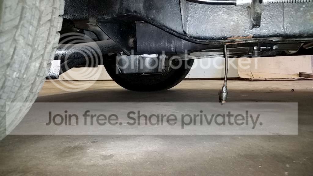

Up WAY in the air trans out.
Oil pan hang down for reference.

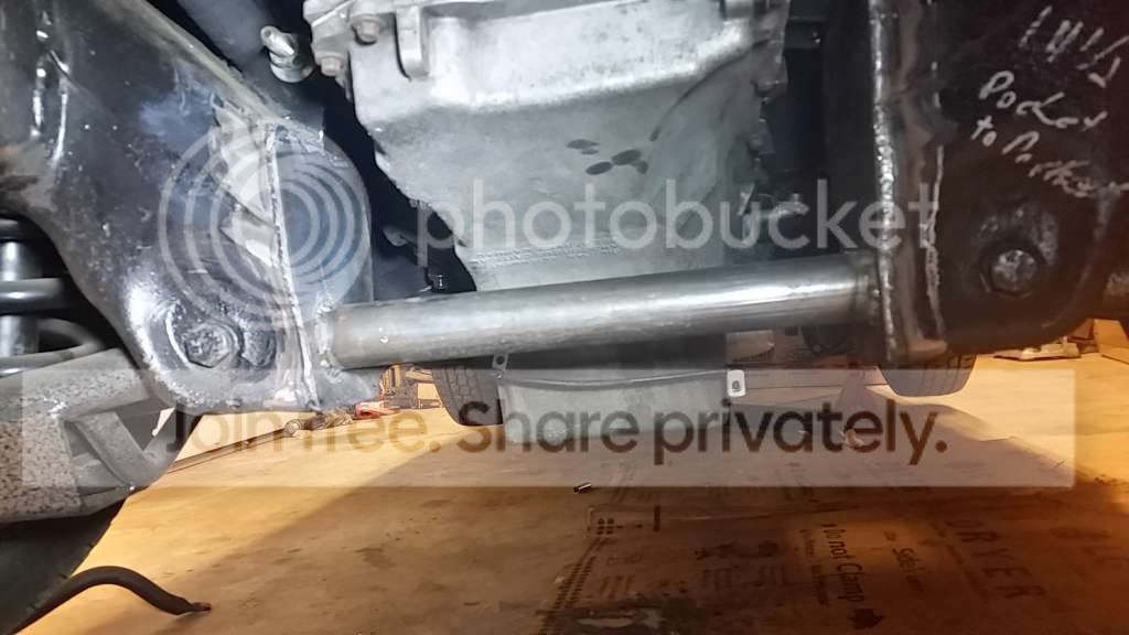

Im also going to tube out the engine crossmember so the pan can be dropped with the motor in place. Shoulda done it to begin with...
