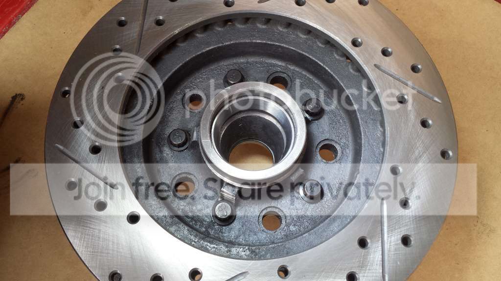

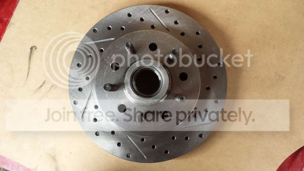

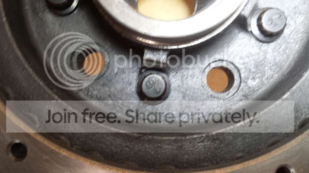

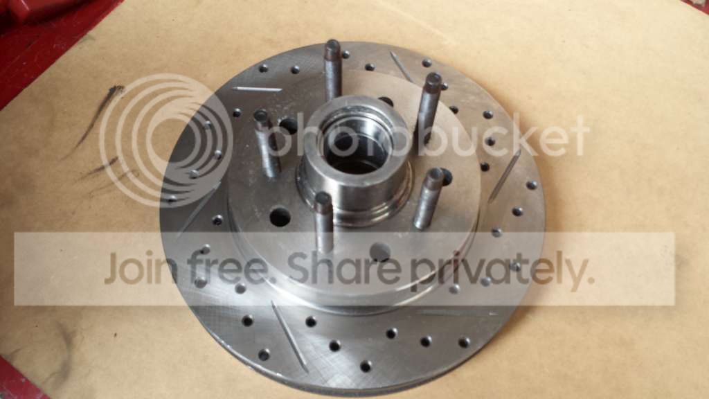

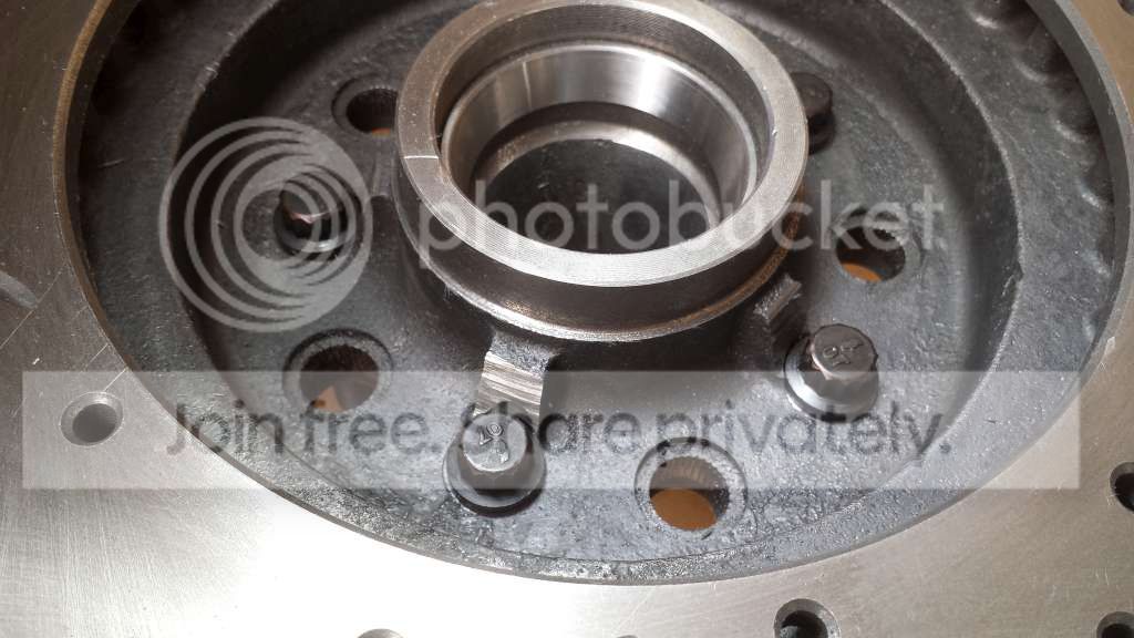

Actually had a day where I didnt want to shoot myself in the head. Re-drilled my front rotors to 5x4.75. Worked very well. Im extremely pleased with my new drill press. I counterbored a 3/4in diameter on the back side for the new studs to evenly seat on and it all went flawless. I took lots of pictures as hopefully in the future Ill be trying to turn a buck on it from the gmt400 crowd. No one around offers this, Im guessing because the inside wheel bearing race has a cast in support that needs to be trimmed at an angle.
Im not so sure a press in stud would be a great idea because you would probably need to completely cut out the support. Im guessing real world it wouldnt make a difference though.
Im using 3 inch screw in studs front and back on the truck. I just happen to like the look of open lugnuts and long studs. I also trimmed my scatter shield spacer to just be a bellhousing spacer. Was going to throw it in but I need to bring my small compressor to the shop to air hammer out the trans dowel pins since our big one took a ****.

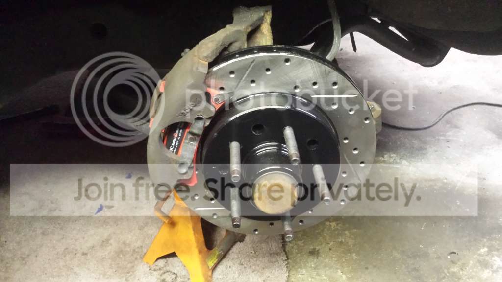

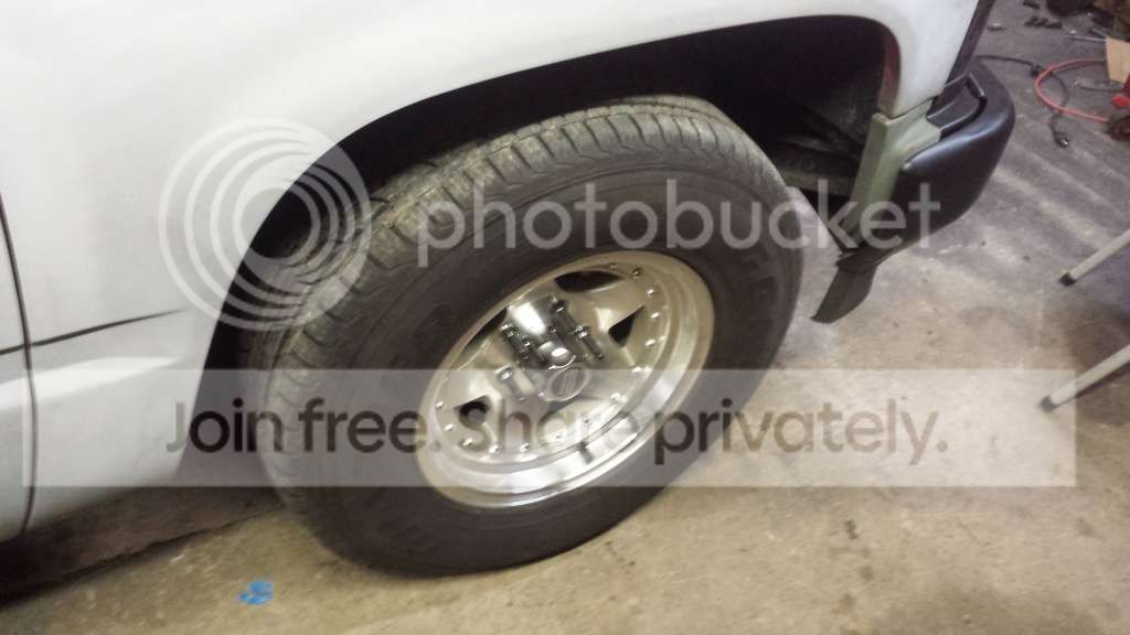

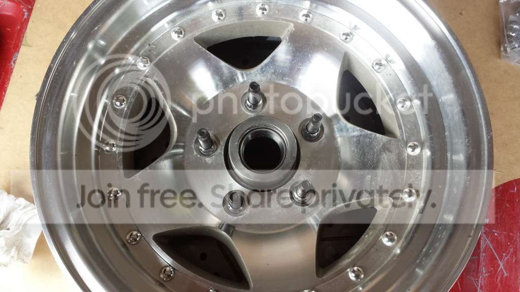

Got my front end put back together and my wheels on woo! So the front end is buttoned up and my AR23s are on it.
Shot of the nice rotors. I painted them black with caliper paint on the hat, back side, and in the fins. I wasnt going to but I figured I would be kicking myself in the ass later when they rusted up and I changed my mind and couldnt clean out the fins. Im planning on changing out the calipers to some fresh ones later on so I can paint them easily. Probably wire wheel and paint the spindles and do balljoints at the same time. I wish I could find some tubular arms that dont have drop built into them for this truck... O and I put EBC reds on the front btw. First time ever using a "performance" brake pad.
And there isnt much room to take a good shot of the wheels actually on the truck. Just to show them on. I love the long ass studs with open lug nuts :D
