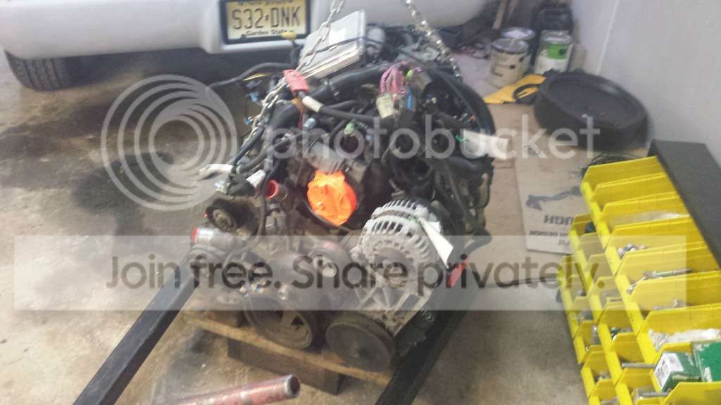

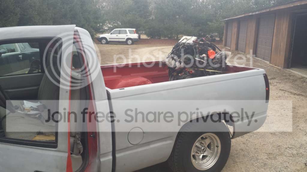

But that said the motor has arrived. 130k-ish out of an 05 suburban with wiring harness and accessories. Im on the fence with what Im going to do now. I hate to flip flop like this but the money that headers and head work is going to cost me I could just pay for the turbo and make more through stock heads...
We'll see. Im going to crunch some numbers and give the machine shop a call to get a valve job quote.

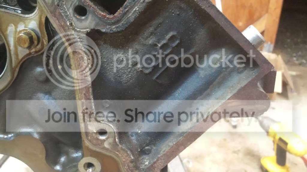

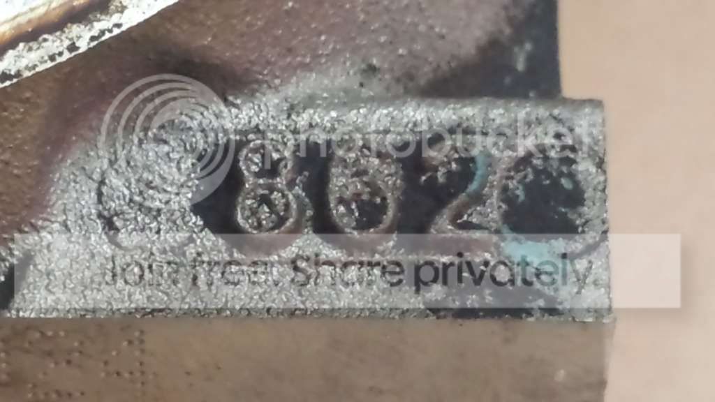

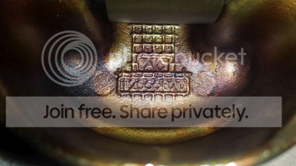

What casting number are the heads and how many miles are on it. For what it costs to have a fresh bottom end Im going to do it. I always intended to rebuild it as Ive never had much luck with throwing junkyard parts in. Hell my 70k damn JY trans pops 3rd and 5th after I paid $500 for it...

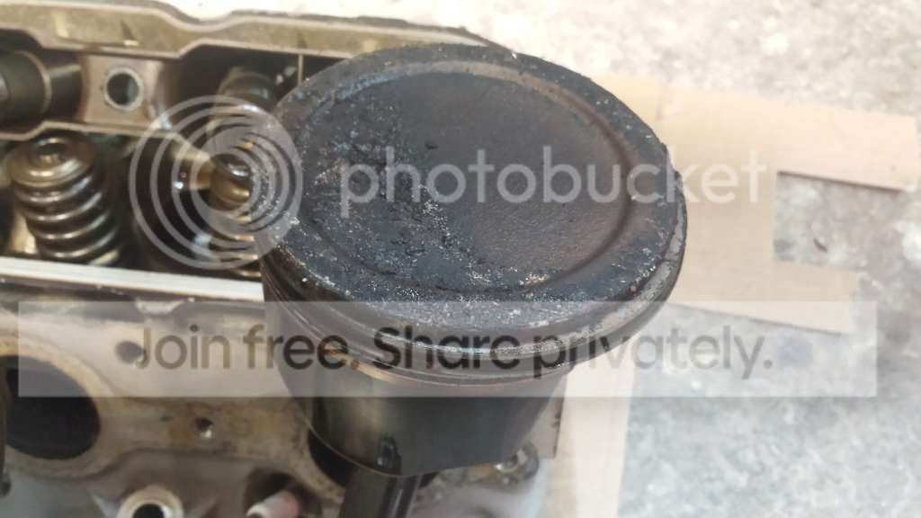

I dont know what happened! 24 hours later and I think someone stuck a stick of dynamite in my 5.3!

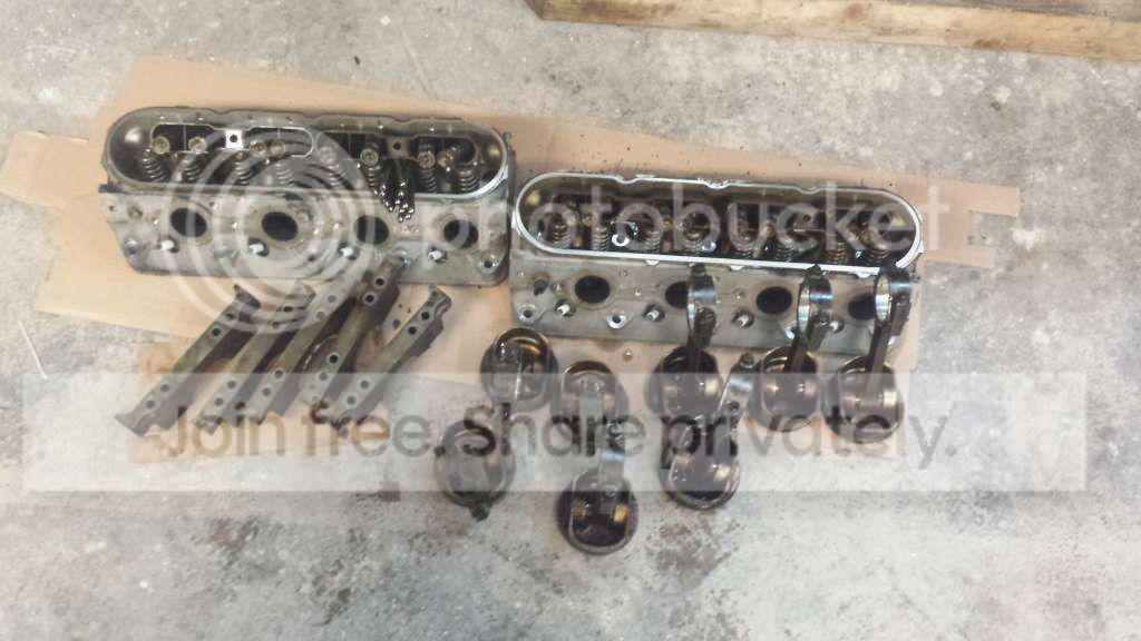

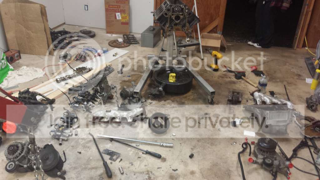

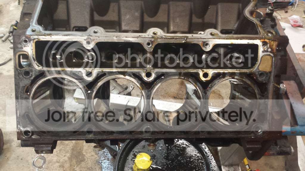

Torn down 100% :D
Motor is flawless. Its amazing what not flooding the cylinders with fuel on the cold startup does for longevity in a modern motor.
Just took some shots of casting numbers etc.

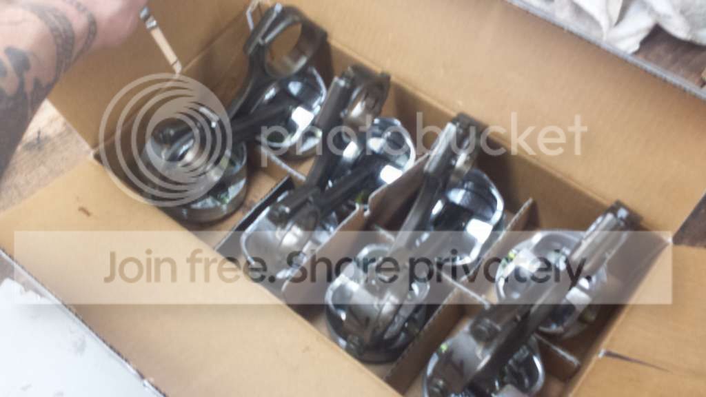

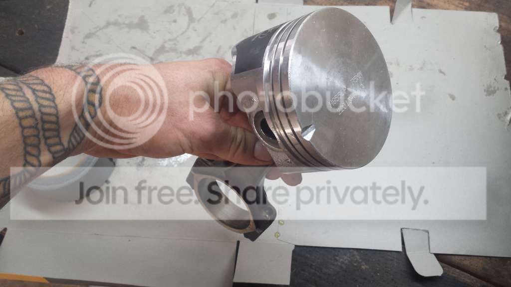

Since I got my pistons in I wanted to make some sort of progress. Pressed the old dished pistons off the rods. Moved onto installing the rods onto the new flattop pistons. I have to say this is probably the first and last engine I will use interference wrist pins on. The $100 in machine work to have the rods honed out for full floating pins, and $50 more for later full floating pistons would have been worth it for assembly in my eyes. Again this is the first time I've done this but I busted out the mapp gas torch, lubed up the pistons, and heated up the small end of the rods to 400*ish. My first mistake was not making a jig for the pin depth so I had them installed evenly. At the end of the night I had 7 pistons with wrist pins that weren't properly centered in the piston and 1 with a pin only 2/3 of the way in from not being quick enough. Hasty on my part.

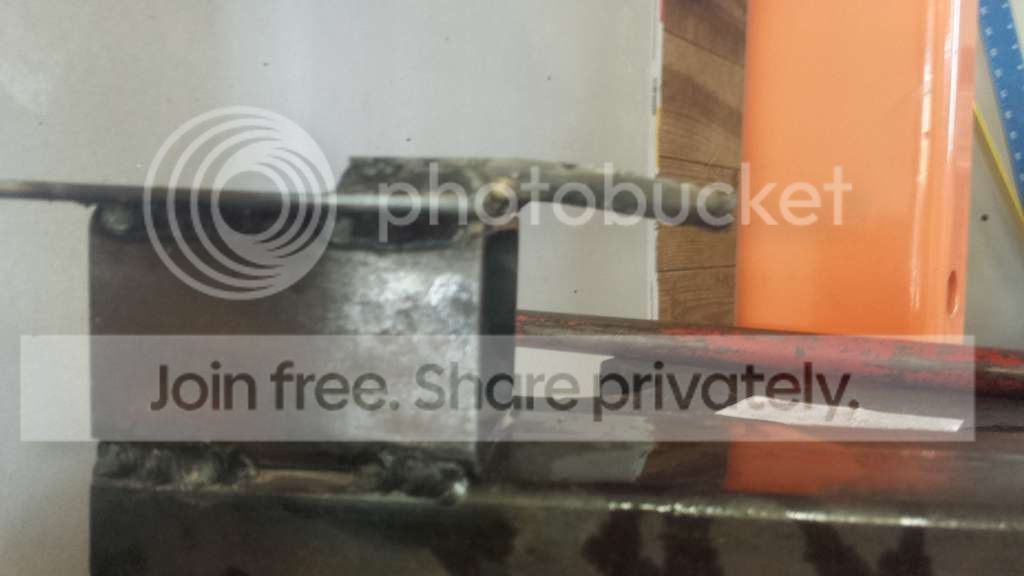

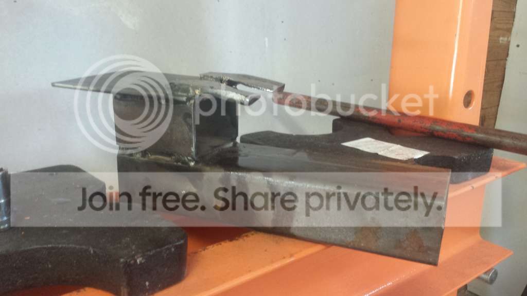

I really didnt want to swallow my pride and take them to the machine shop. Ive learned the error of my method (DONT ****ING RUSH) for the future but now I had to solve the dilemma I had gotten in. Since simply jigging the piston and pressing the pins back out ruins a cast piston. I knew I couldn't just remove and try again. I started doing a little research and found some links and photos of proper tooling to remove and install pins w/o destroying the piston in the press. At $500 that wasnt happening. Neither was ruining the pistons at $200 for a set. And to be quite frank I wasnt willing to concede. So out came the skills set that I am familiar with and started making a jig that would carry the rod in the press while I seated the wrist pins completely.
After about an hour, and a very smelly shop from quenching them in oil to try to deter bending here's what I had.
Although it bent on the second to last piston it served its purpose. Was my own damn fault too as I had forgot to lube up the pin with oil before putting it in the press on that second to last one... I plan on straightening it out and beefing up the "forks" to hold the pressure better. Basically what it did was go between the rod and the piston in the gap that the piston floats on. Since I was now supporting the rod where the strength and press fit actually is I was no longer exerting 10tons of force on the piston skirt ruining them. I saved my pistons and saved face lol :whistle:
So at the end of the morning that left me with 8 flat tops mounted on 8 cleaned up rods all assembly lubed and ready for the motor.

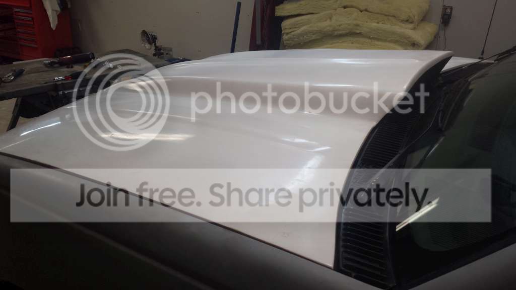

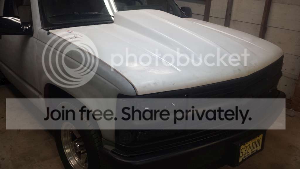

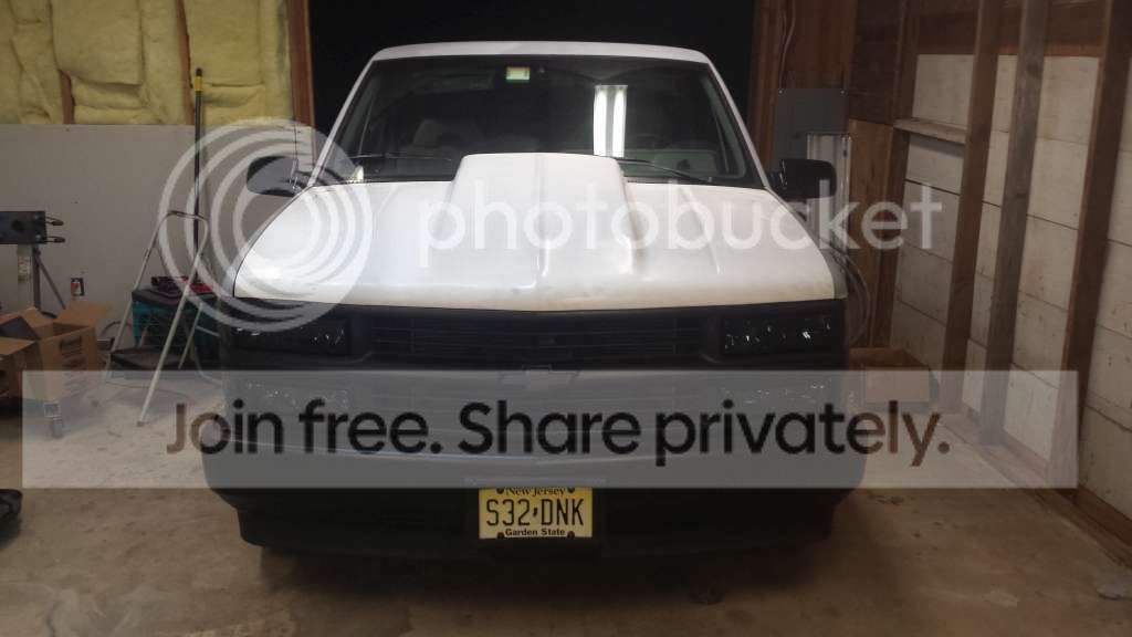

Got a little side tracked from the motor build and dropped $400 on a cowl hood. I went to the Englishtown swap meet hoping to get a real steal and save on shipping. Funny story sorta. Walked around for almost 3 hours. Every glass guy was sold out of hoods for my truck. Gave up and went to leave and my clutch push rod bent in half. Went back in to try and find someone to help me fix it and found the hood for my truck. Wife came and took me to the shop to make a new clutch rod. Lots of driving later we leave and I get a $55 ticket for loud exhaust. Asshole cops in town setup a check point, must still be pissed they couldnt get the track shut down.
But anywho. I got a 3in traditional style cowl hood. I was happy I found a 3in. IMO 2in isnt enough and 4in is goofy looking. It fits pretty good but not great. Im going to need to shim my fenders up in the front and shave the front lip down in the center a little. I missed driving behind a cowl hood so bad....

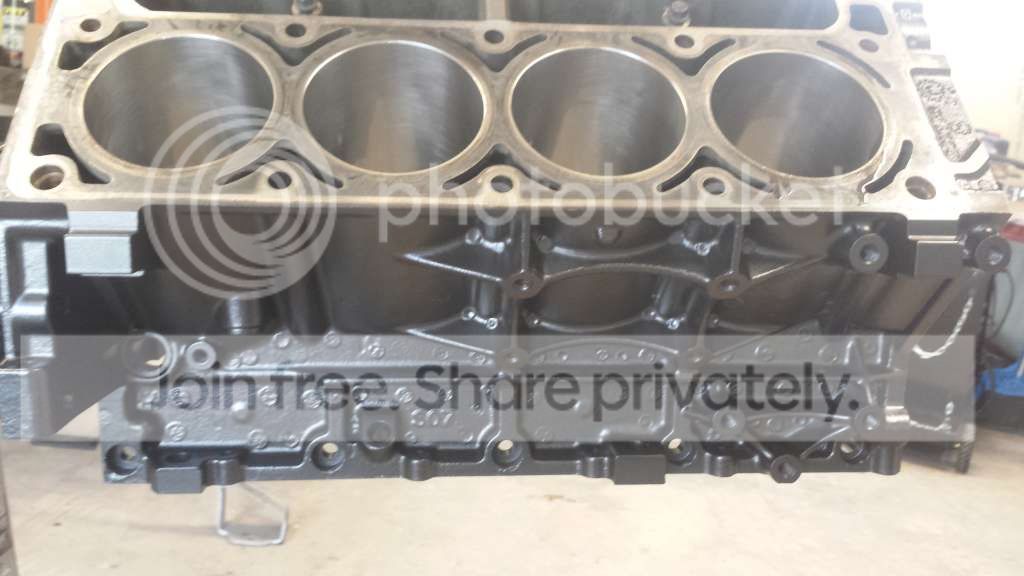

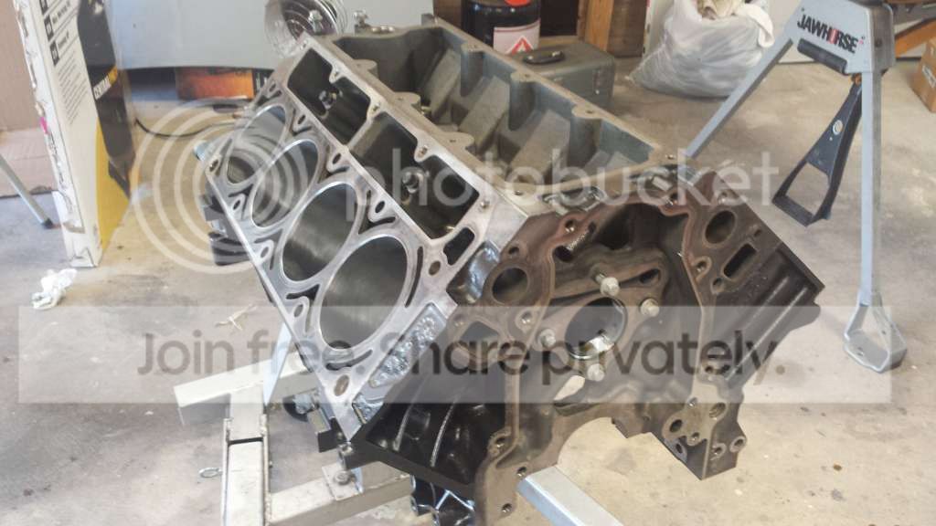

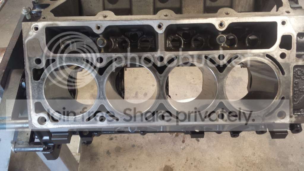

Busy weekend... Close on the house, drove home, hung out for 2 hours, then to the machine shop to pick my block up. Today I painted it and cleaned it to prep for assembly hopefully tomorrow.
I painted it with VHT Pearl Metallica Black. I really like it. Gives it some depth rather than plain old black. I just snapped some shots of it painted and cleaned. I definitely want to get the crank plastigaged and installed tomorrow. Onto rings after that. I picked up a ring grinder so it should be a piece of cake.
