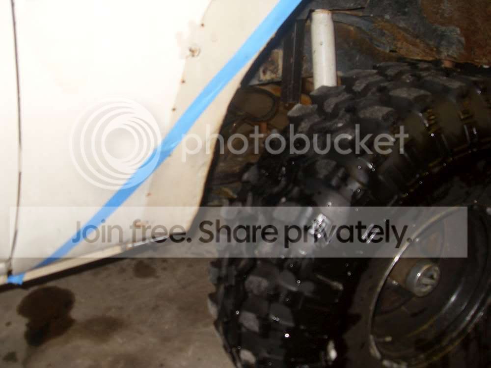

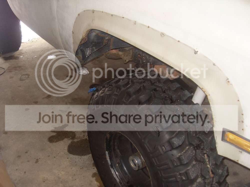

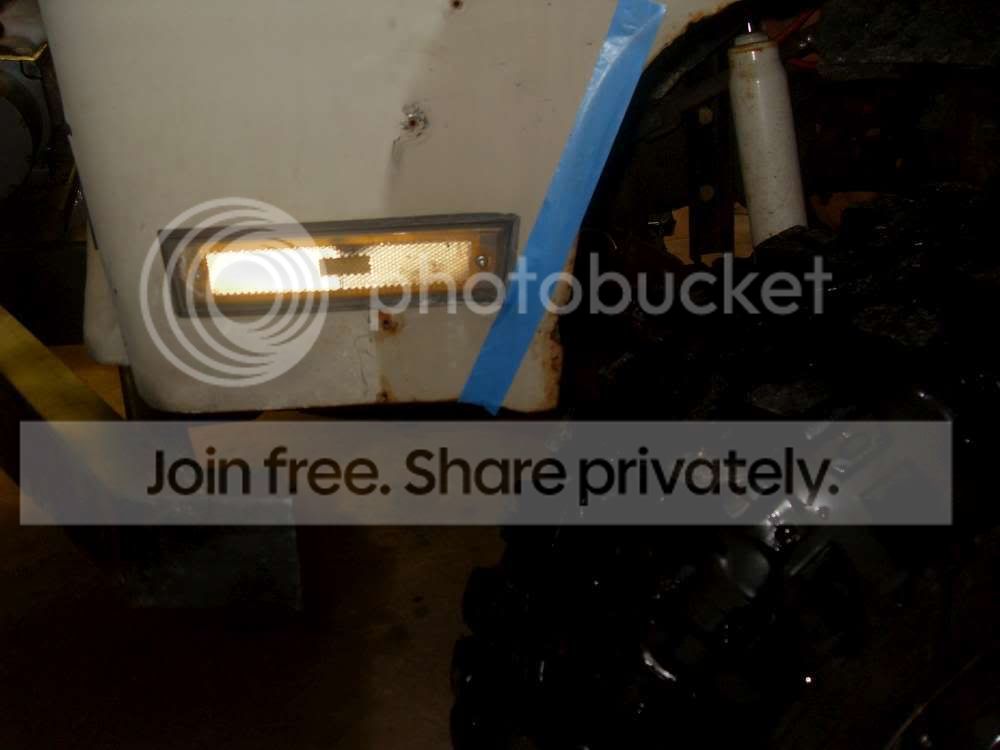

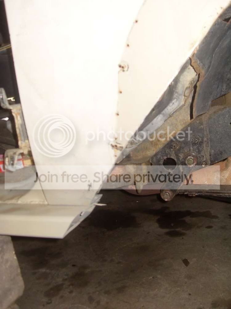

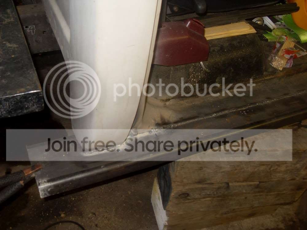

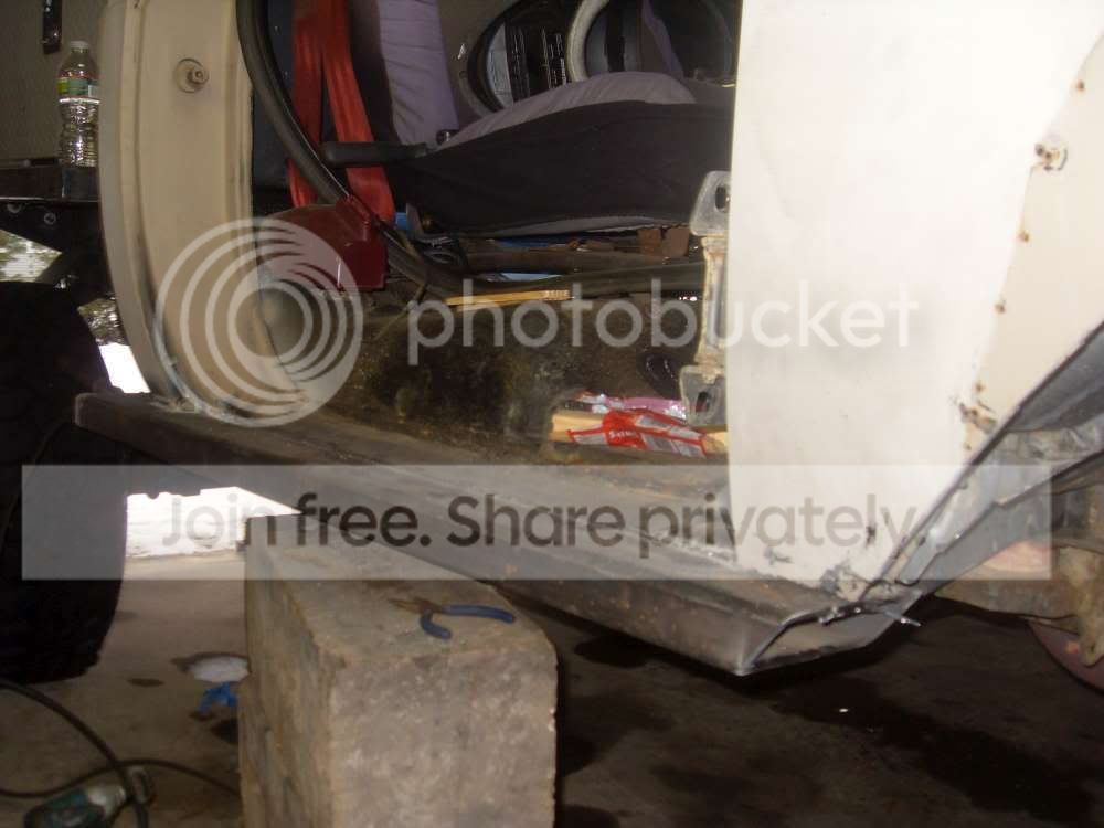

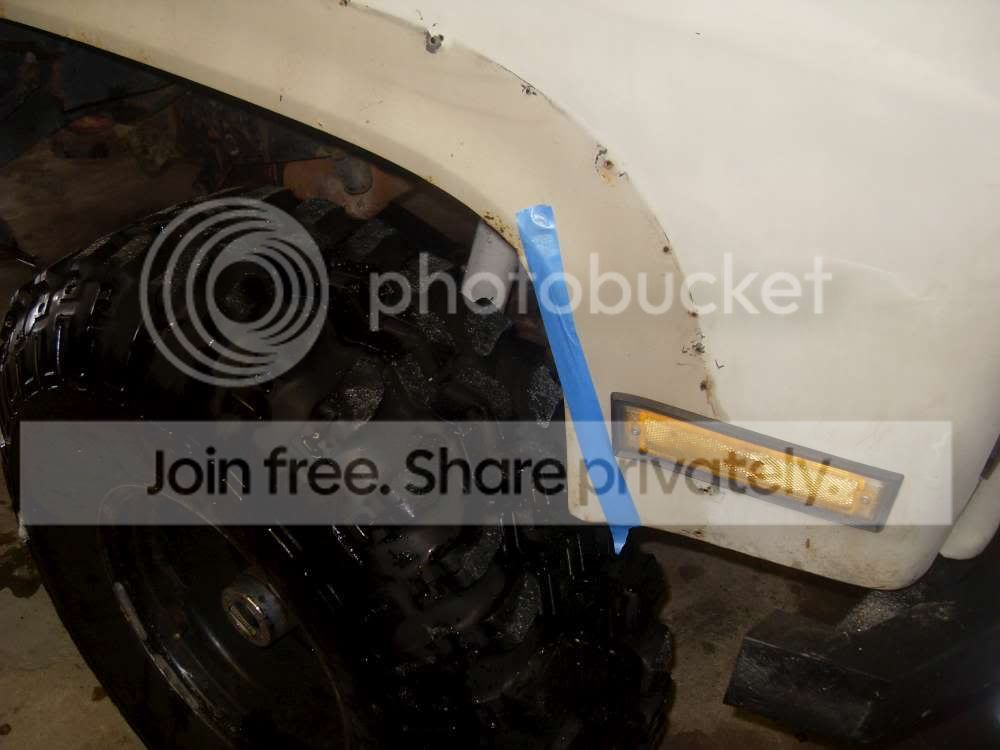

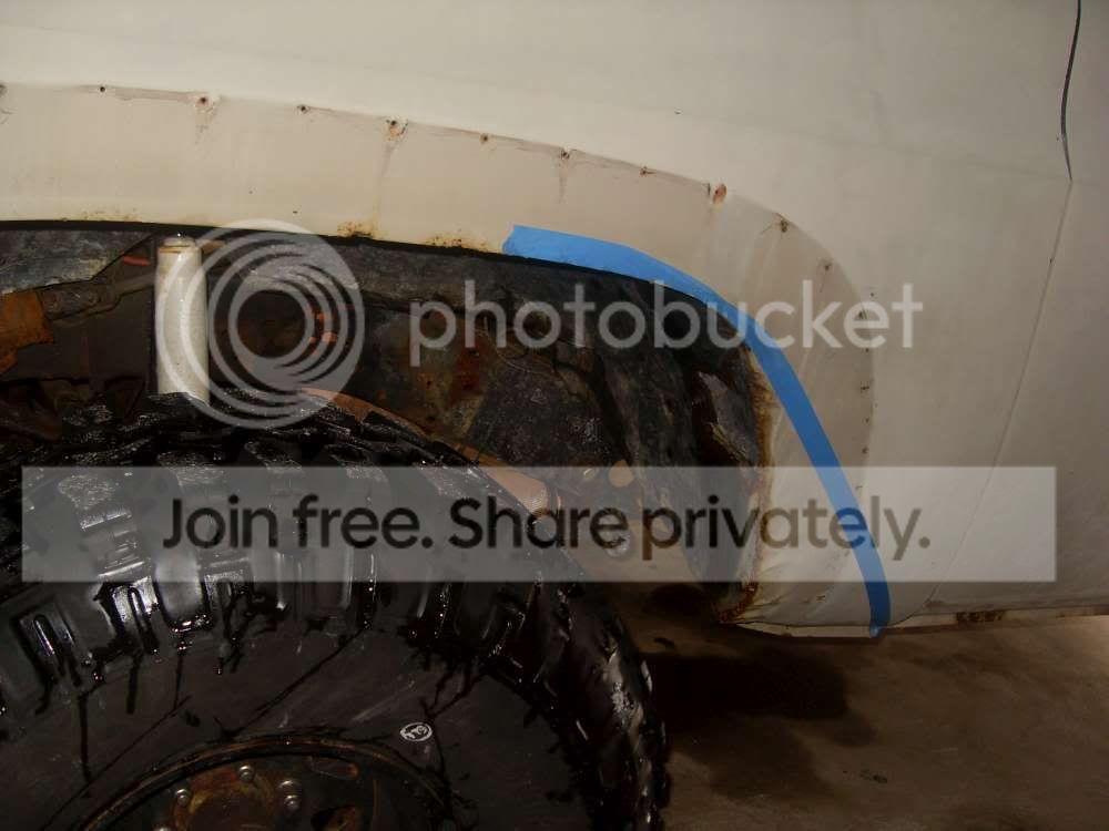

Got half of my tube rockers done today. Also the fender fairy came told me to stop being a little girl and cut my fenders back all the way :D
Cut them all the way back to the firewall on a taper and also trimmed the front a little bit. So now the cutout flares are gone. They'll be replaced with tube eventually.

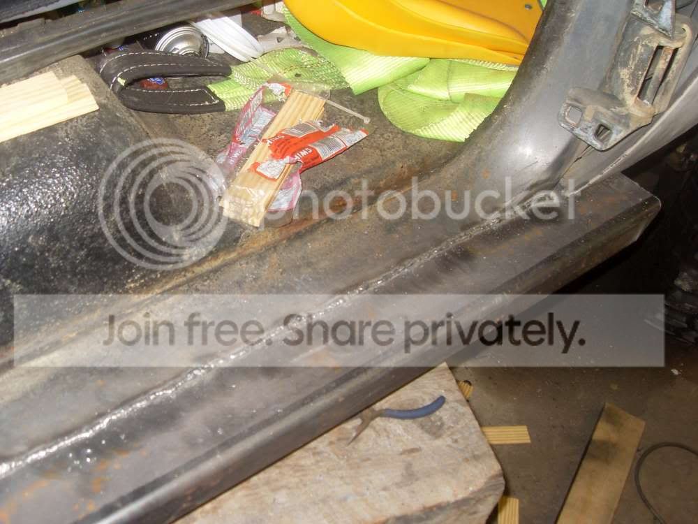

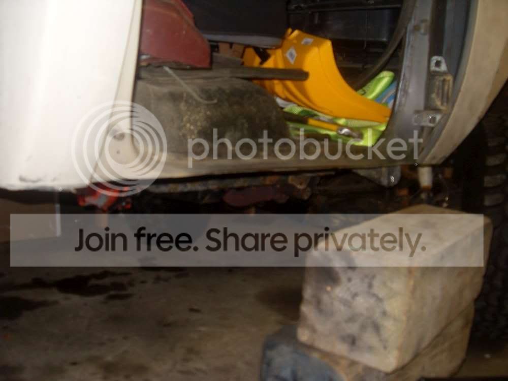

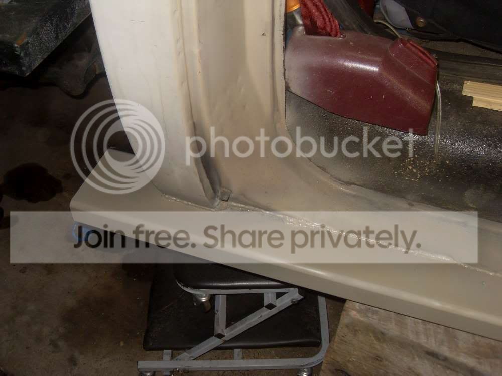

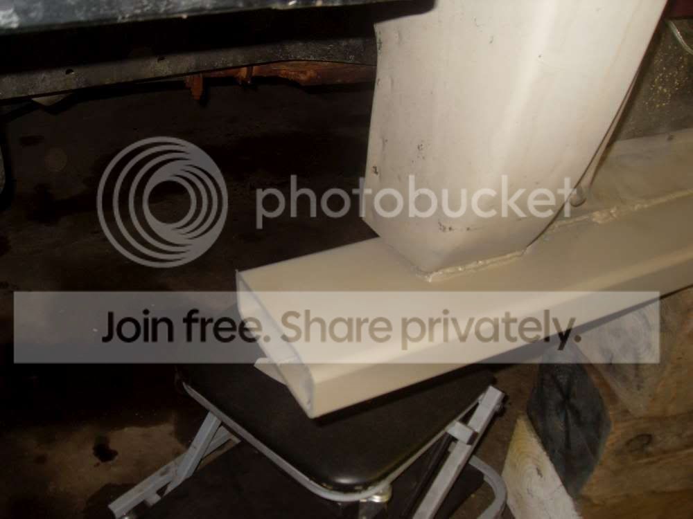

Then I got to work on the passenger side tube rocker. Used 2x6 1/4 wall. It put 60lbs on each side :eek1:. Didnt even start the drivers side or the braces to the frame just got it welded into the body.

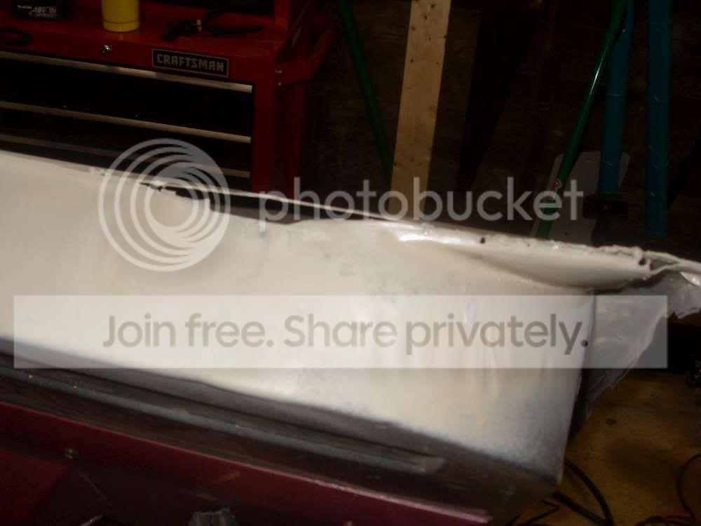

Trimming the bottom of the door was a pain in the ass. I barely got 10 tacks on it the **** is so damn thin. I'm just gonna get some panel adhesive or something and put it in the bottom seam from the inside of the door.
I should be getting my 38.5 XLs within a couple weeks and my 14 bolt next week. I plan to ditch the tool boxes and move the gas tank up behind the cab mounted high.
O and I extended the sliders behind the cab because I plan on tieing the new bed and future exo in there.

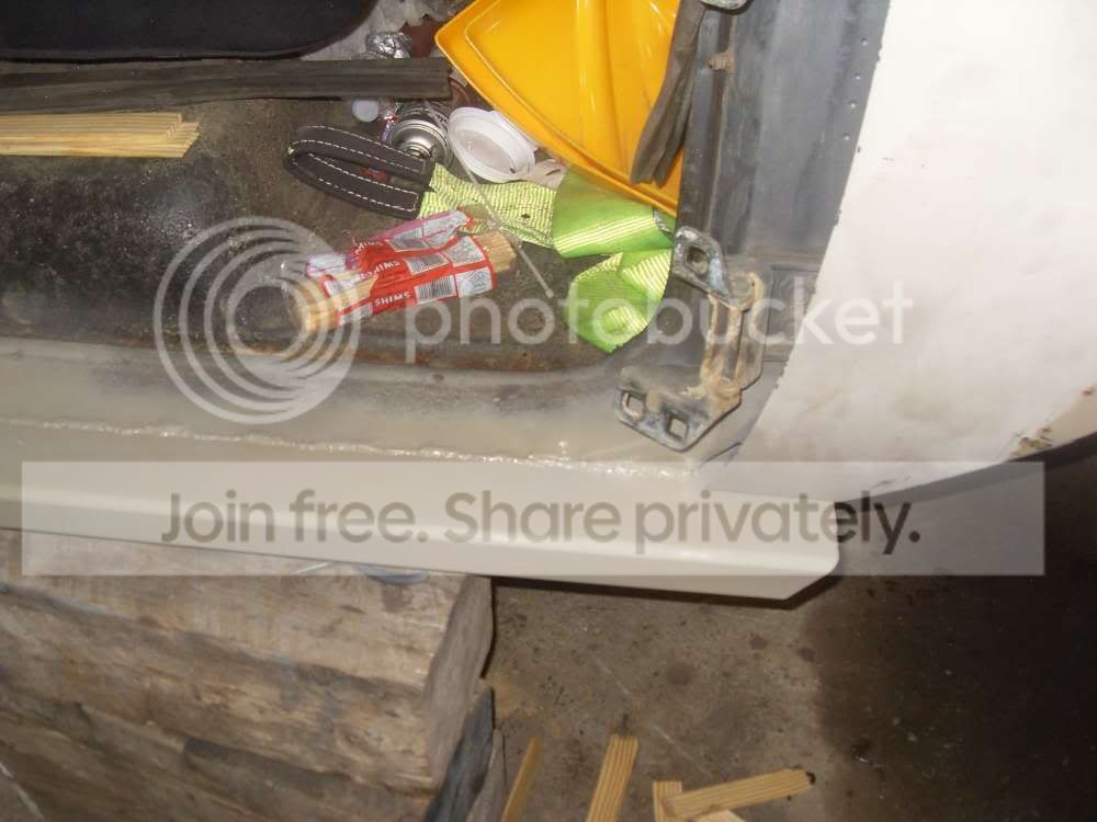

Did the other rocker today. Found a little rot surprise I'm gonna have to fix. Also need to pick some tube up to tie the rockers into the frame.
You're doing a full cage(exo maybe?) right? Just checkin if you're tying those rockers in.

Yes full exo eventually. Whats wrong with tying them in if I wasnt though, if thats what you were getting at.
I've just been told not to tie them in without a full cage because the frame flexes and cracks. :dunno: No personal experience though, I just didn't tie mine in.
