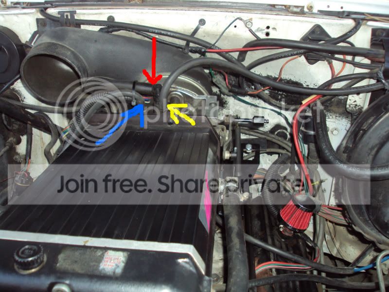

I'm hooking up a boost gauge at the moment, and wondering which vac line I should tap into. The destruction's suck. There is , what I think is a vac line coming off the top of the throttle body connected to the charcoal canister by the head lights. Would this be ok??:whistle:
FWIW there are several, what I would assume are vac lines coming right off the top of the TB.
Yellow goes to the canister , blue to some type of sensor for the SC, red to the PCV

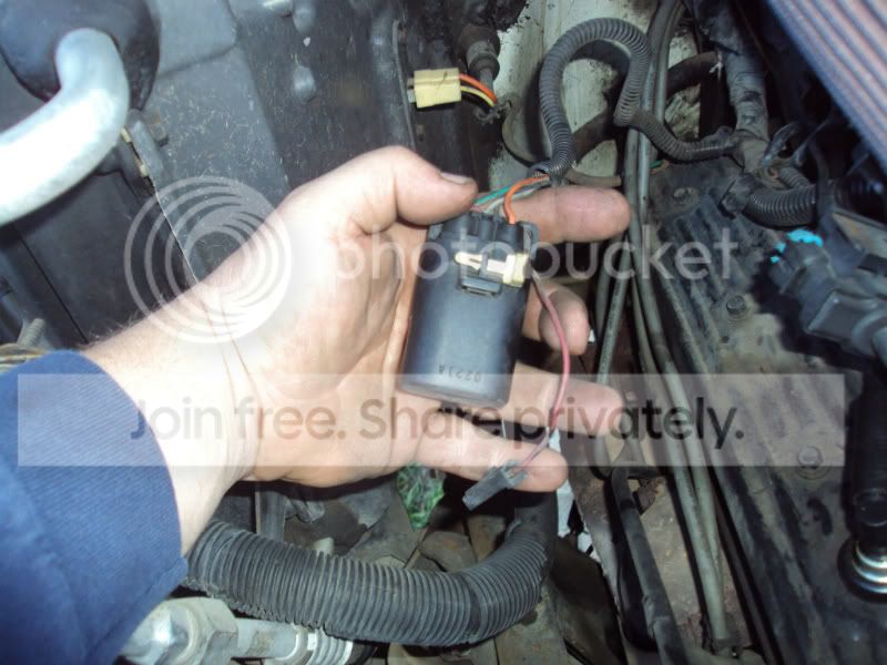

Oh and also, can anyone enlighten me as to what this is thats floppin around in my engine bay with no home??
I hope that red wire isn't important.. then again everything has a home ..
Thanks
that's your fuel pump relay..
I would probably tap into the yellow, but I'm guessing any one of the 3 would work....

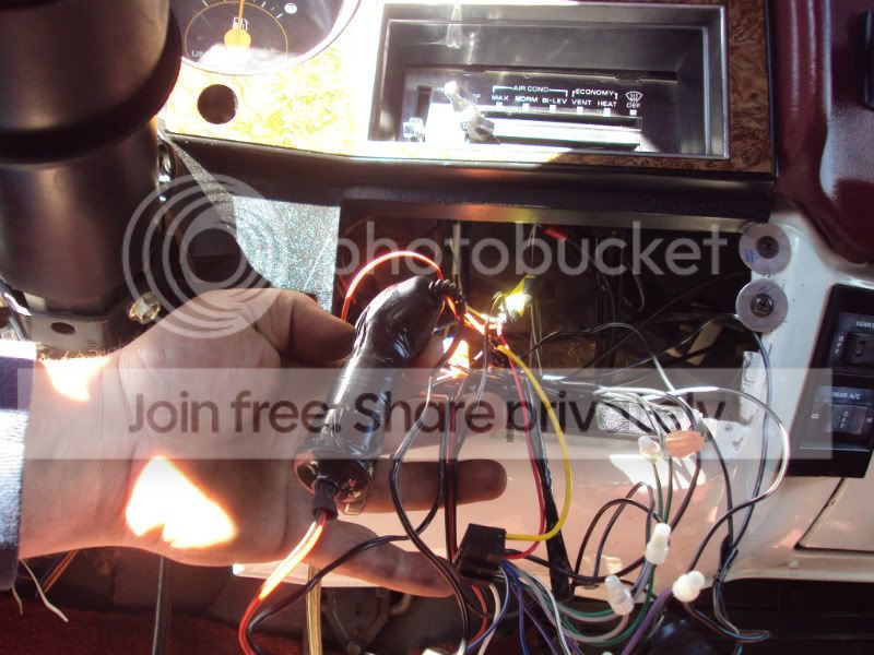

And Ryoken, I thought I might share this with ya. as I was installing this boost gauge , I was able to see behind the radio and , well.....
:haha:
Thanks again sir
anytime, just holla... and yeah, previous owners of these rigs have a tendency to leave interesting wiring...

There is a small stamped steel bracket above your intake tube high up on the firewall. That should be what holds your FP relay. The red wire is to "hotwire" power directly to the pump, say if the relay fails or for testing purposes.

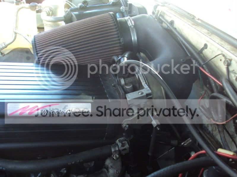

Is that a stock TBI intake manifold with the SC bolted to an adapter and then to the intake? Seems like a flow restriction if that's the case. Wonder if Whipple makes an adapter for an old 4 barrel carbed intake so you could swap that out for better flow. Project for another day, getting ahead of myself here....

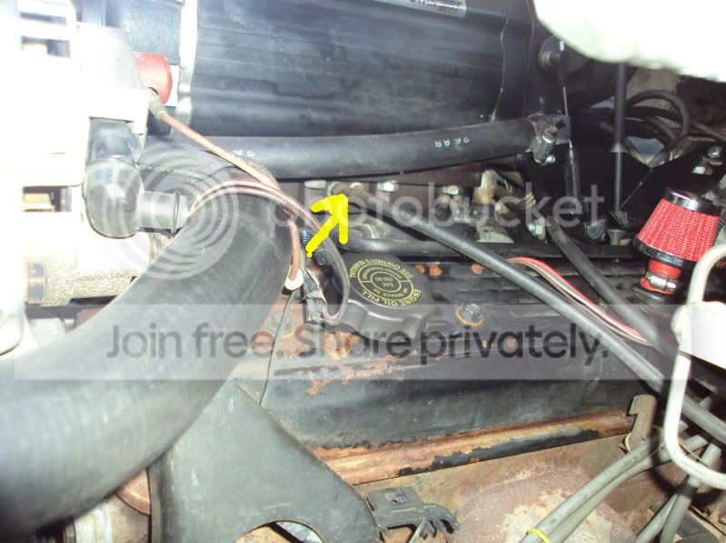

What is that vac line that comes out the side under the SC, drivers side. Where does it go? That could be a place to tap into for the boost gauge.
I have NO idea :dunno: I figured you guys might know by looking at it lol
That filter set up, temporary, just till I get a better intake made.
I see what y'all are saying. I see that line your talking about here?

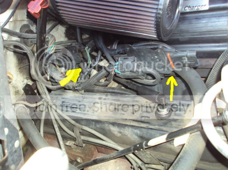

I didn't tap into to that line, as it was dark and I didn't see it. I found one directly opposite to that that I thought may be going to the bypass, of sorts. Pic below altho that particular hose is under the mess. But it connects to a sensor dude that connected to a diaphragm looking dude. (see arrows) The other would have been far easier to get to:whistle:
