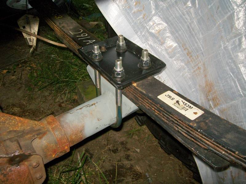

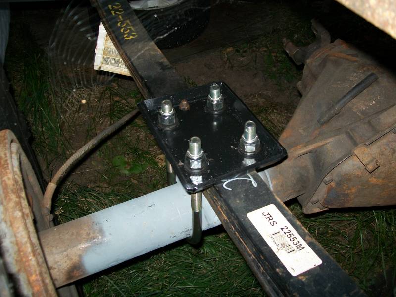

I have a question about this pic too....:
Why is the spring perch bolt whole so off-center on the perch? And in turn (which looks like it was caused b/c of the off-center bolt whole on the spring perch), why is the center pin of the spring so far off on the spring plate? I can't seem to figure out why this is and what benefit there is :dunno:. It seems like axle wrap would occur badly with this set up.

The axle are moved back 3 1/2" on the springs to get 90º departure angle, I'm still running the overloads so that will help on the wrap issue, but I'm considering some antiwrapbars, haven't decided on a design yet though.
