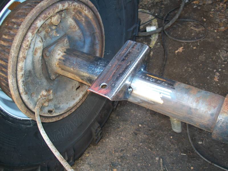

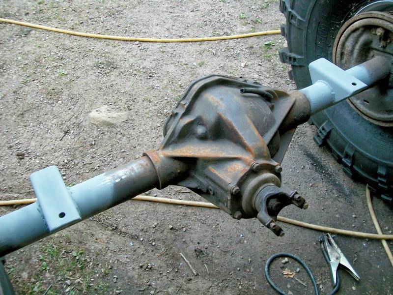

first actuall work on the burb since last year,hopefully I´ll get both sides welded on and capped today,if the weather permits.

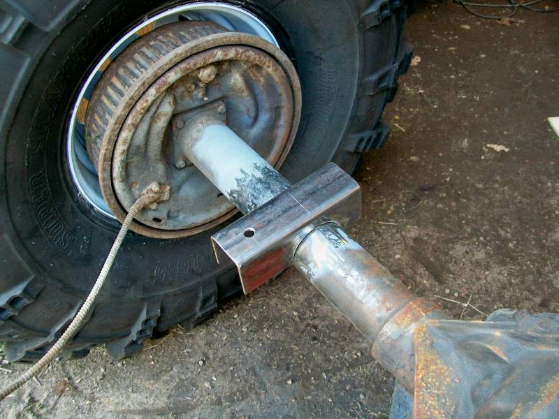

got the springpads welded up and some temporary primer on them.

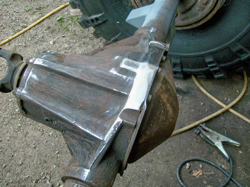

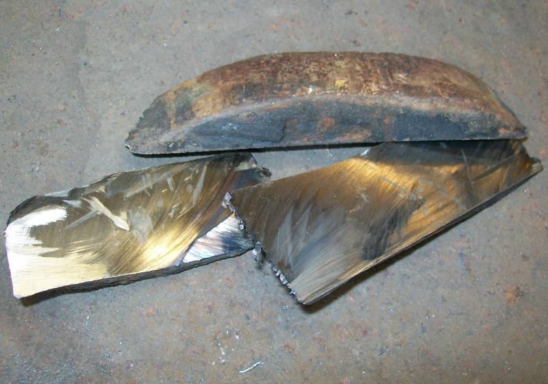

and these chunks of iron also came of
and smoothed the housing a little bit.

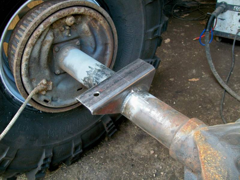

I screwed up my measuring on the springpads,cc should be 790mm,and somehow I put them on a 890mm cc,so I cut off one side and ground smooth,and cut up the material for 2 new pads,and they are ready to go under the drillpress tomorrow,not what I was hoping for,just roll the axle back out and start over,so I guess the lawnmover won´t get fixed tomorrow either:doah:
