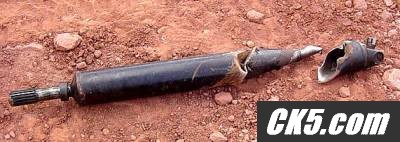

Did this shaft in at BB '03 on Pritchett.

Dirkster built me a replacement out of 3" drill stem, was .375" wall but he turned it down to ~.200". That was the Chuck Norris of driveshafts! :saweet:
