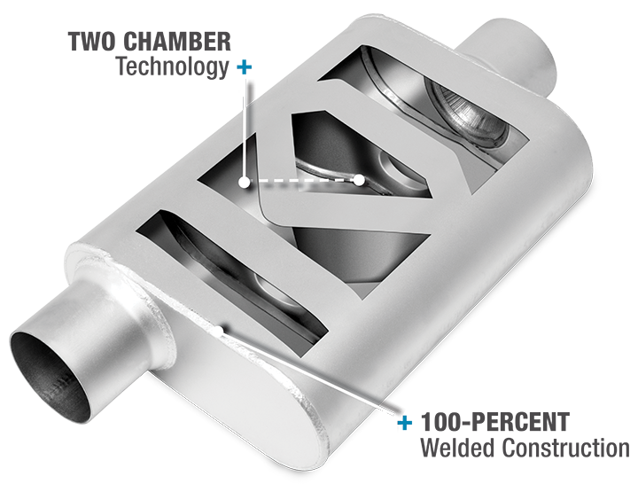

Also, I see the Thrush muffler design is similar to Flowmaster which hurts flow causing less hp/tq. Not trying to bad talk your muffler just showing the dyno tests I have seen with this design.
The H pipe is supposed to help with scavenging by giving more room for the gasses to go out when the firing order has to cylinders firing on one side.
Technically it's only relieving back pressure and making the sound smoother, the fact it adds any power is a bonus.
As for flow, yes all dual chamber or baffle design type mufflers will have less flow than a straight through.
But if you're like me and want a quiet muffler with a deep rumble when you push it and don't have to worry about packing materials degrading in time these mufflers are the ticket
