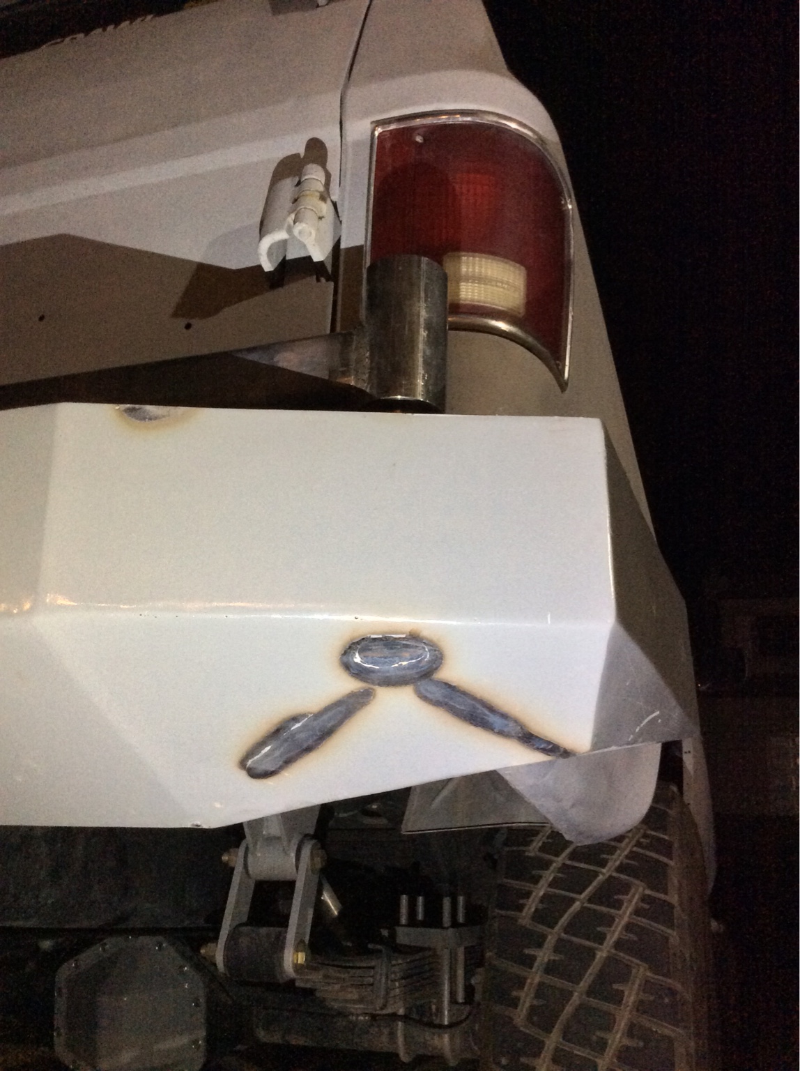

Some of this welds on the 90 and 45 on the tire carrier look kinda boogery. Is it just the pic?

A couple of them are, ran out of wire and had to finish with the stick welder. I've cleaned them up, they're painted over now.

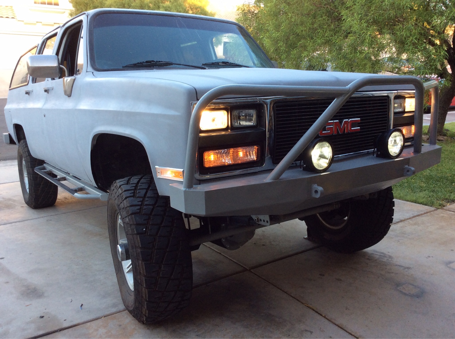

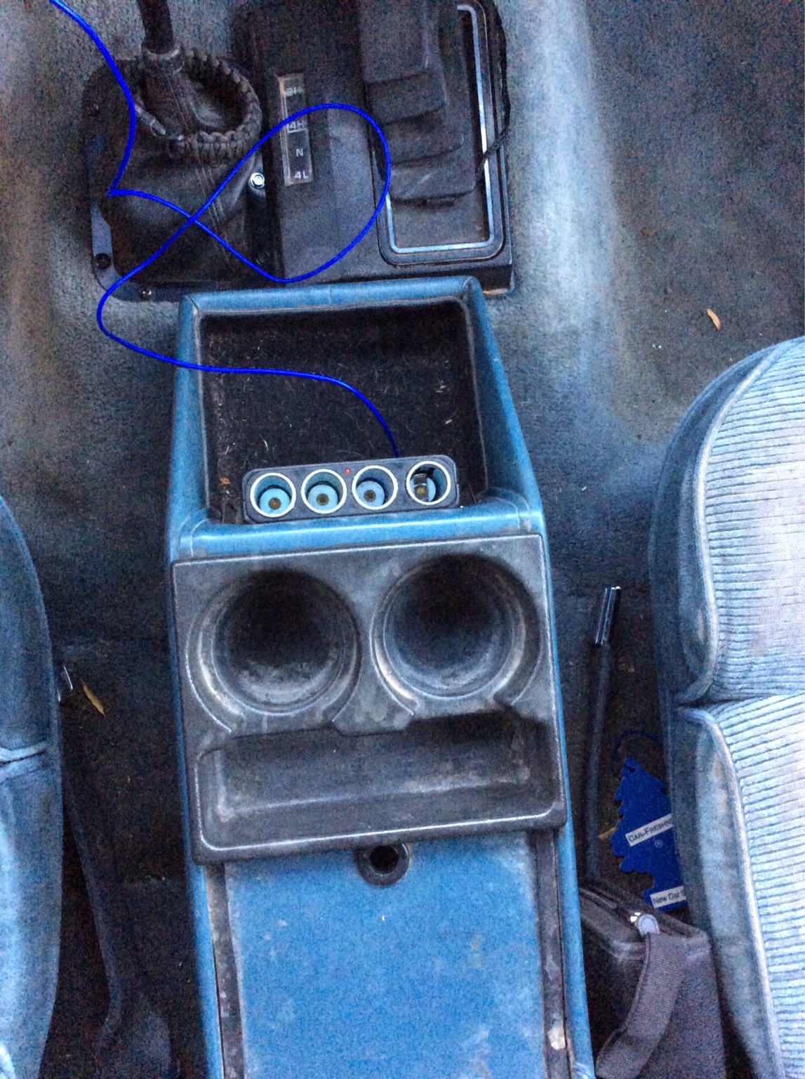

My buddy Henri came by today and we got some **** done! The rear lights are wired up with a weatherpack connector at the bumper, installed & wired a bunch of 12v plugs and USB ports in the cab and installed a set of 7" LED spot lights on the front bumper.

And a few additional 12v plugs on the center console.
All the lights work!
The front lights need to be adjusted a little.

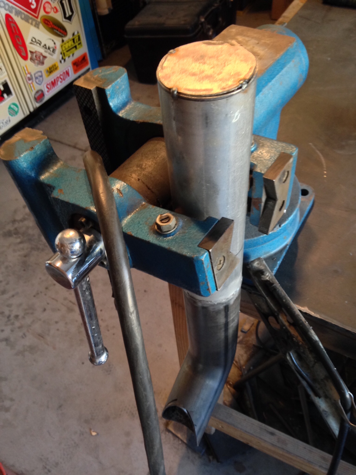

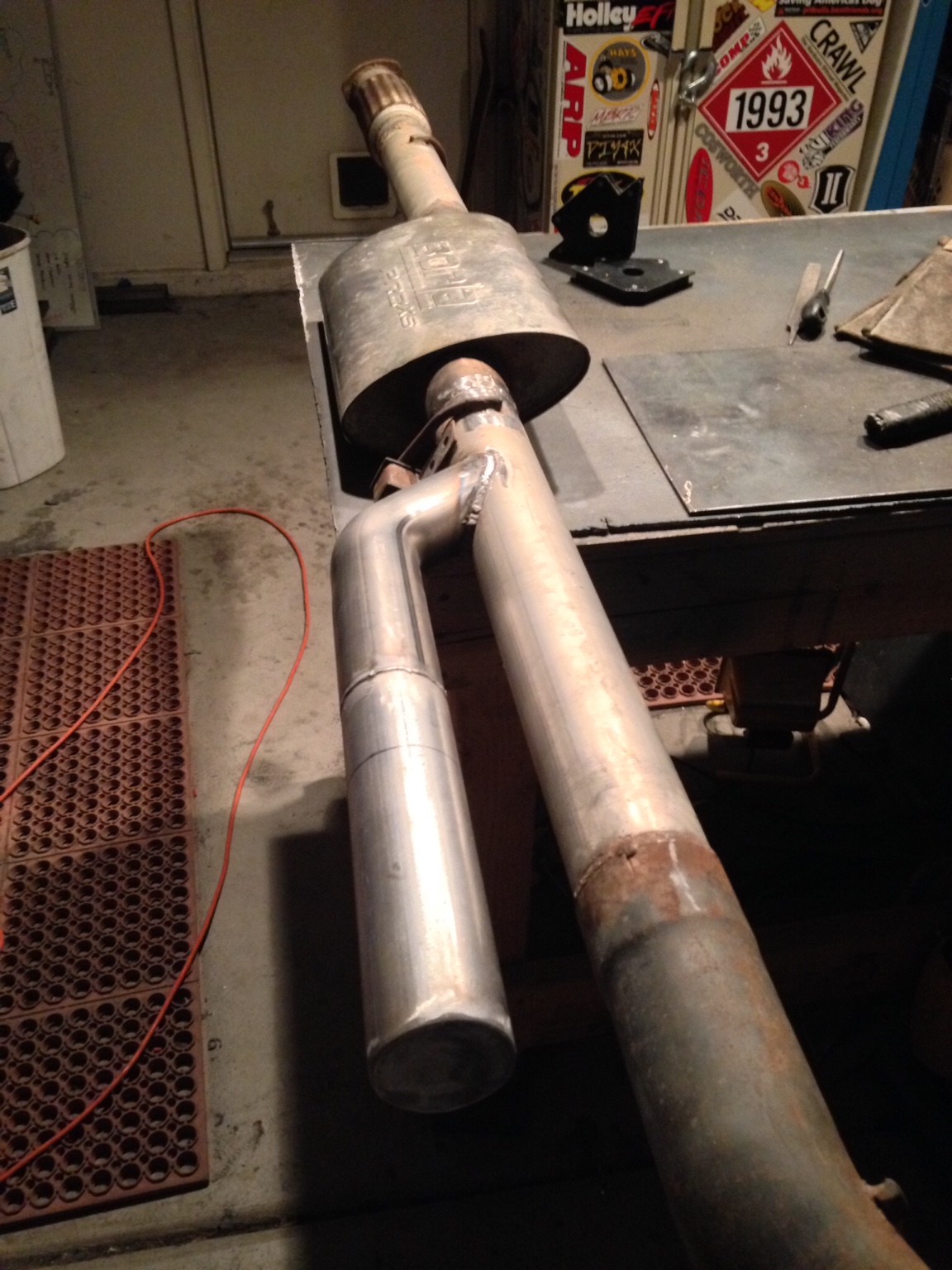

I got the exhaust welded up today. I ended up having to remove the drivers side rear shock but the whole exhaust system slid out the back in one piece. Even with the side branch on there it installs and removes easily. I had the job done in just over and hour.
I took a scrap piece of tube and split it open at the seam, hammered it flat and cut it to cap off the end of the side branch.
With the system removed, I cut a hole in the pipe where I had marked it earlier. Tacked the side branch in one spot to adjust then welded it up when I got it right. My little MIG machine did alright tonight, it has days where it doesn't cooperate at all. Once that was done I stuck it all back in the truck and bolted the shock back on. I'll test drive it tomorrow and post the results.
It's above the centerline of the 3" pipe for two reasons. Clearance, none of the exhaust hangs below the frame. And condensation, with it above the tube it's less likely to collect moisture.
