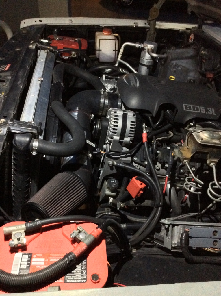

All the AC stuff is reassembled with new O-rings throughout. I'll probably drop it off to be charged on Monday. Tomorrow I'm going to my shop to build the rear tire carrier. Nobody is available to help so we'll see how much I get done.
Some of the new AC parts fit a little differently so I moved the intake to the other side. I had almost everything I need to make it work, all I had to buy was two hose clamps.
Why did they fit differently? It's all the same models correct? Or did you upgrade to the bigger compressor and that require other changes?
The new compressor's lines come out of the compressor at a different angle so the hoses are routed differently. Same thing with the new condenser.

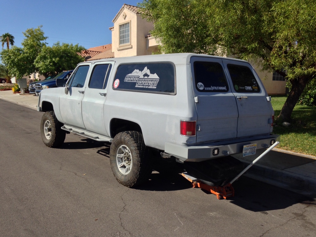

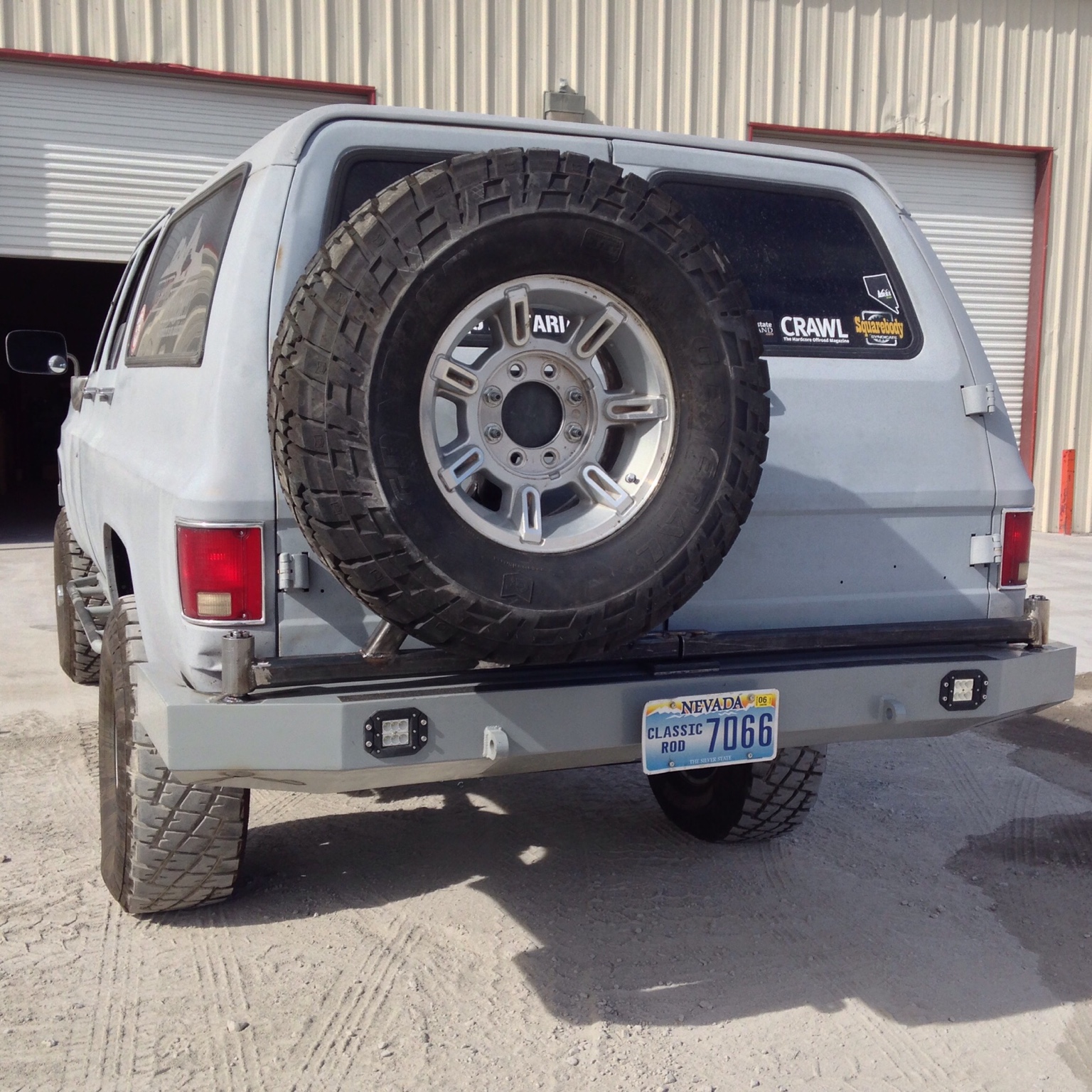

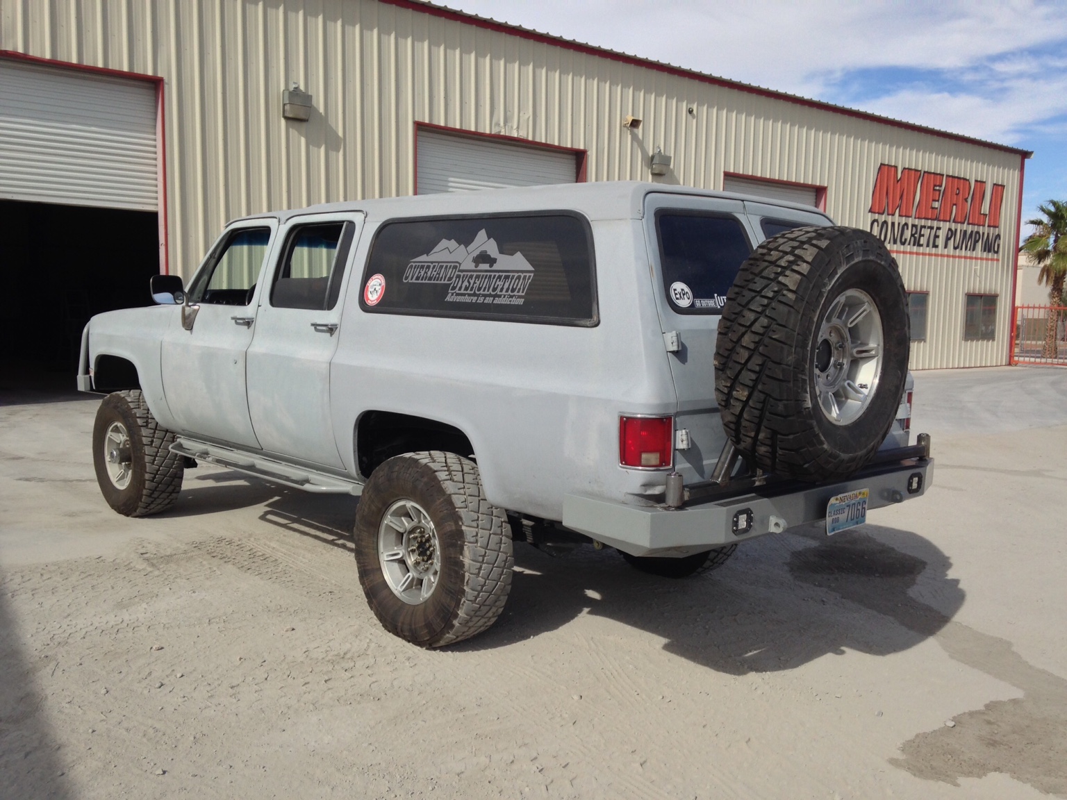

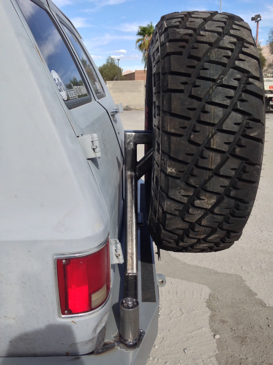

So Sunday a couple of us got together and added the two swing outs to the rear bumper. Overall I'm happy with them, the drivers side one deflected some when welding and it doesn't sit tight against the plastic pad on the bumper like I hoped it would. I'll fix that tomorrow, I'm thinking I'll clamp the tube down tight to the bumper and warm up the arm near the spindle with a rose bud. Let it cool like that and it should tighten it up some. The mig welder at the shop ran out of wire and I had to finish it with the stick machine. Only one gusset on the tire carrier was stick welded but everything inside the bumper was, I'm glad that **** ain't visible. The spindles are gusseted 4" out in two directions, each gusset is one piece from top to bottom. I shouldn't have any issues there. I still need to add the latch as well, I welded a piece of flat bar across the two arms to get it home.
I just got home from dropping my wife at the airport, she'll be gone until next Monday then we leave that Wednesday for BB15. I've got to finish the rear bumper and get it all painted. That'll be two days after work I'm sure. I still need to get it to the AC shop to be charged and get everything loaded. It'll be a busy week but I should be fine.
