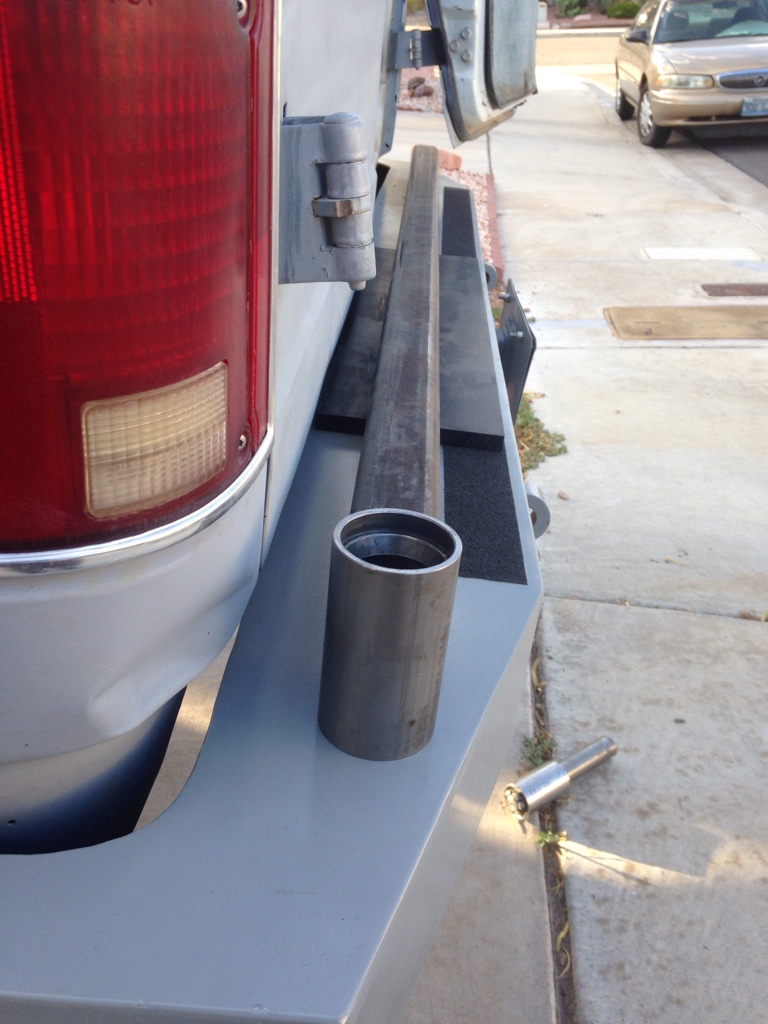

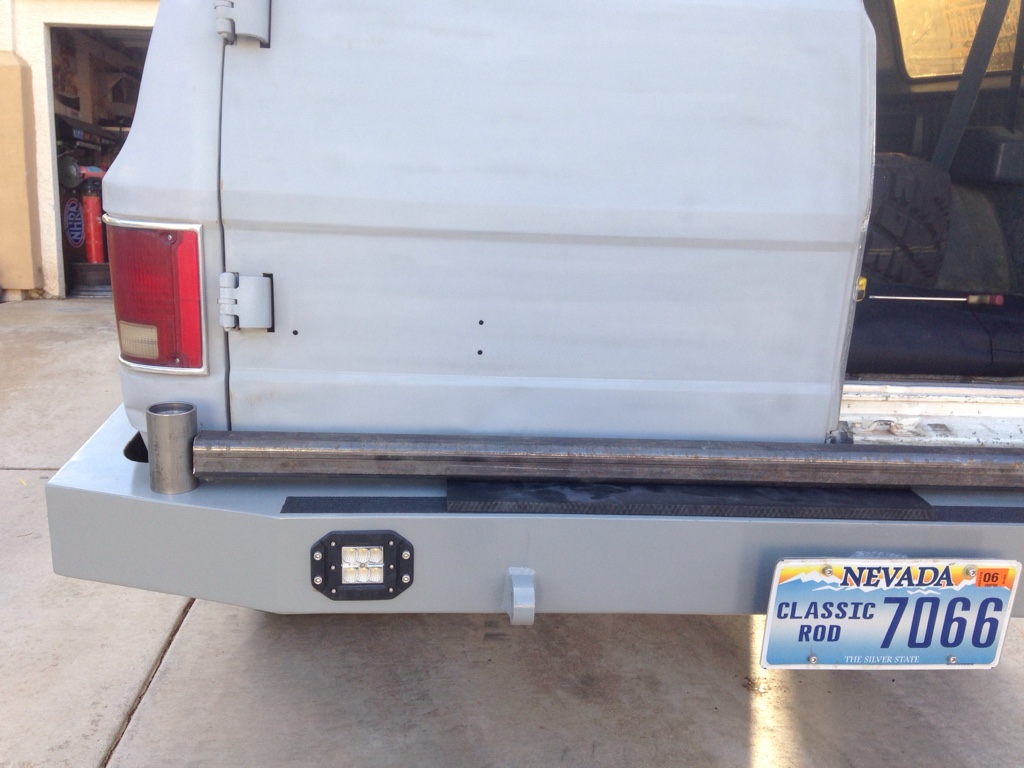

So what kind of material should I build the swing outs out of? I'm building two, they'll meet in the middle where they'll be supported and latched. The drivers side will carry the spare tire and probably the hi-lift, pass side will carry fuel and water cans. I'm thinking 2" square tube, .250" wall for the main arms on the bottom and a lighter wall for the spare tire support.
i'm thinking .250" wall for the main arms and upright support for the spare, everything else out of .095"...

Did some measuring...

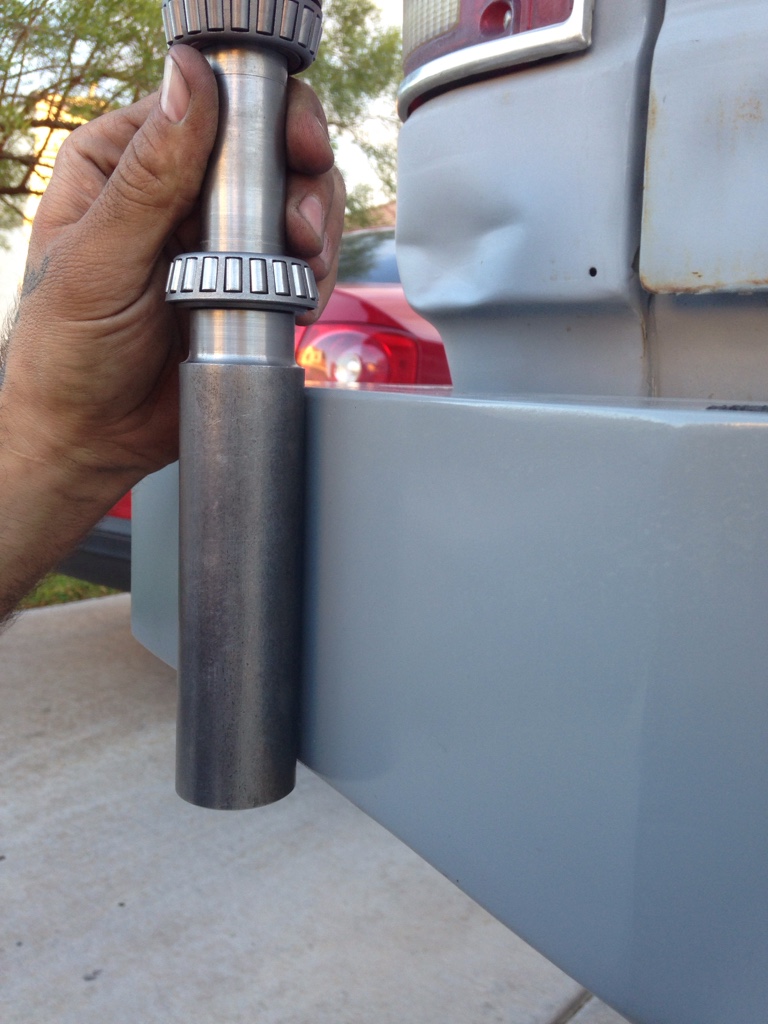

This will allow the doors to fully open, the tire might hit the side of the body but I'll set up a stop of some kind to hold it in place. I need to drill two 1.5" holes in the bumper and get the spindles welded in. The swing outs will pin in place when shut with spring loaded pull pins. Like these.

One thing I have found with bumpers like that is you need to do some very solid bracing below the pivot. It usually doesn't happen right away but after a couple years it starts to fatigue the metal. Actually I have seen it take 5 or 6 years. But it eventually happens. So added bracing under the bumper will help that
From looking at how far the doors open, I'd incorporate some sort of a stop pin in it, that wouldn't always stop it short of opening all the way but if you needed to. For instance if you were along the side the road, you could open it to 90* and stop it so you could still get in the back. Just a thought.
Yep. It'll be welded top and bottom and have gussets as well.
Good idea.
