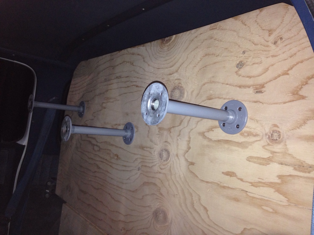

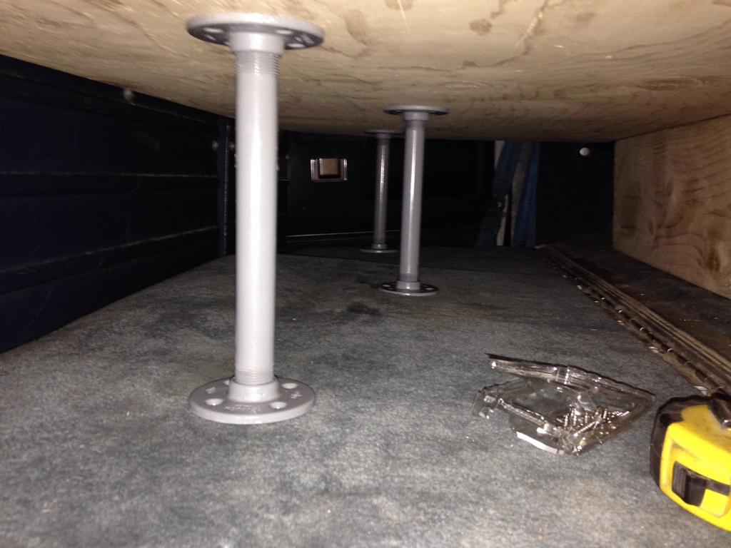

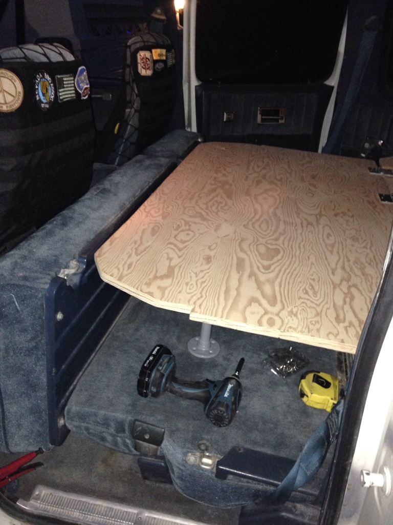

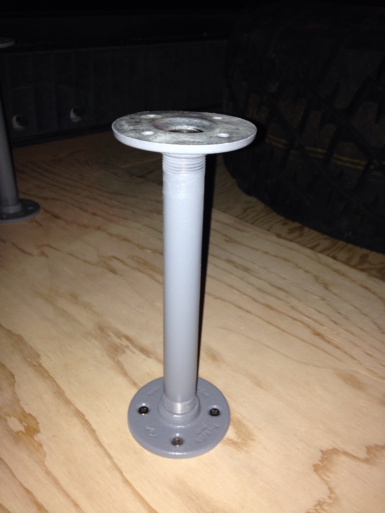

Tonight I added some simple stands to the front section of the platform. Just 3/4" pipe and floor flanges cut to length and threaded then hit with a coat of paint. When the platform is flipped back they unthread and ride right between the seat and the platform. I rolled around on it, it holds my 250lb ass just fine.
Towards the front seats.
