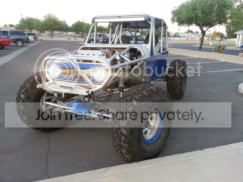

The "under destruction builds" supersize75k5 's driveway of despair and repair
Ohhhhyeah
Hey shawn didnt you have a clear hood for it a while back? What happened to that?
Toyota FJ grill? Any reason?
Looks great!

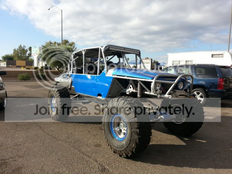

This will be titled and insured as a Toyota fj40 to make insuring and getting on the road a little easier.
The steel cowl is fj40 as well, I do have a lexan hood from Trent fabrication that I didn't get paint on due to running out of one of the toners, same reason the cowl didn't get paint.

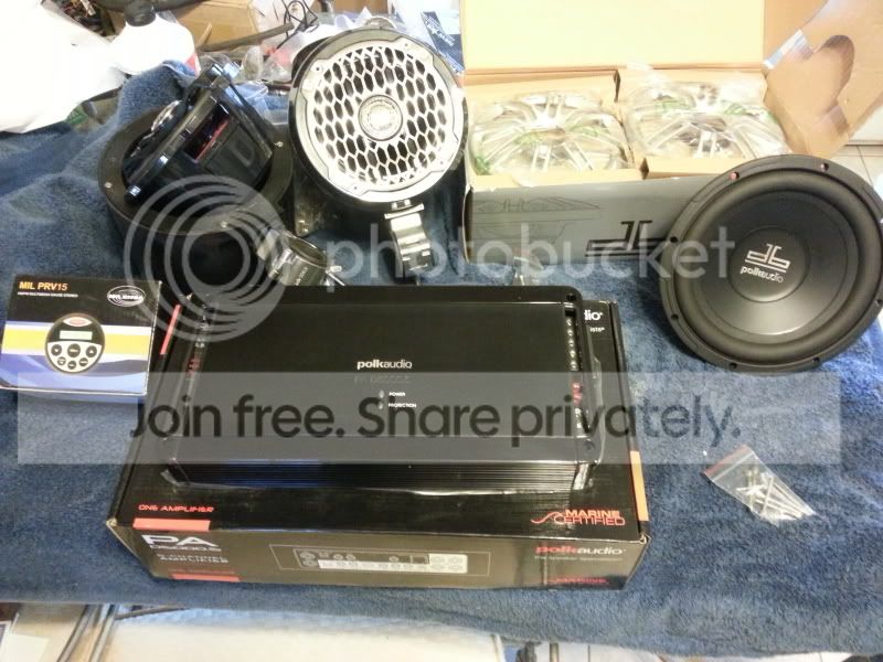

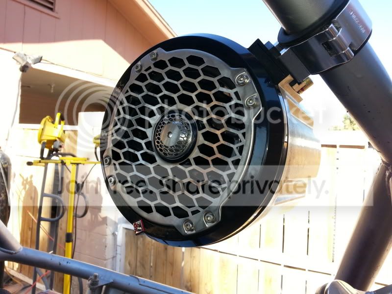

Tunes came in.

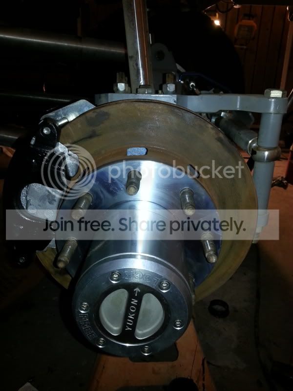

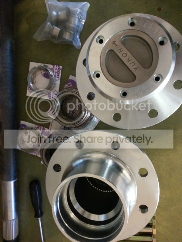

Solid axle hubs finally came in but the box lacked my brake brackets Wtf:doah:

Damn hubs look secckkkkssey:pimp:

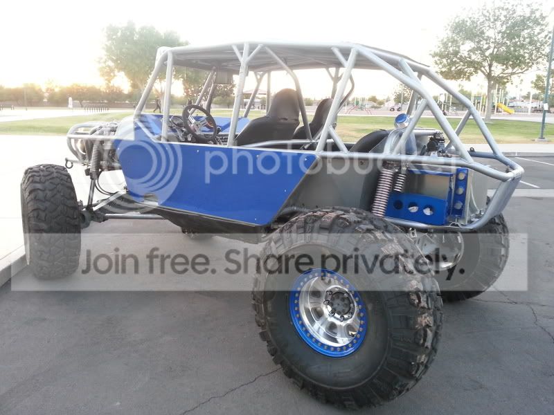

Been at it since this afternoon, going to keep going while I have the energy!
I can't wait to see it with the blue hood on. It's looking really good.

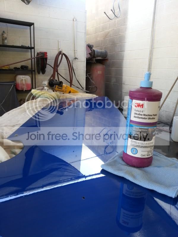

Hood is painted, I can't wait to peal off the top protective film and pray the flex agent worked :popcorn:

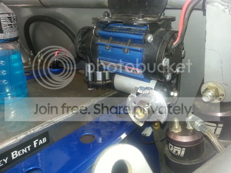

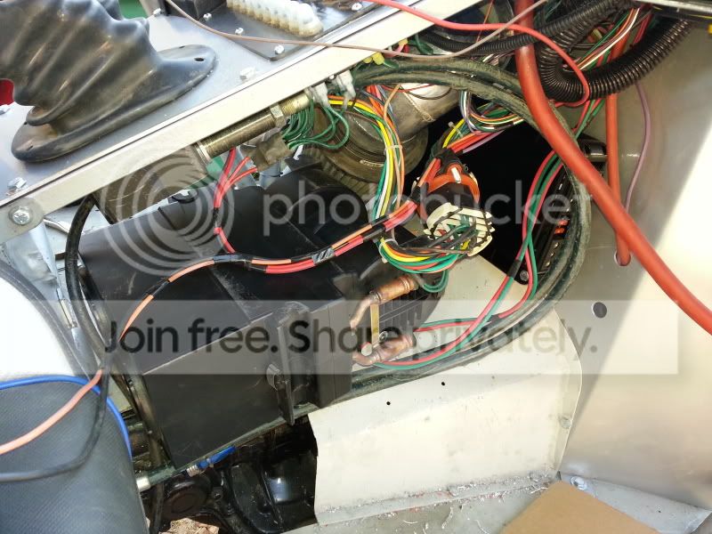

Left to do..air filter adaptor, Wire the amp and speakers, diff fluid up front, wire the arb, change out all the ORI bolts to grade 8, mount the second battery, make front consol skins, mount the heater, run lines, add a relay and switch, second interior light, weld on the muffler, install the new hopefully done upper links, solder and wire a few things, weld tabs for the front seats, radiator overflow mount, few vent tubes.
And need to clean up this mess, duct the heater, add front speakers, bla bla

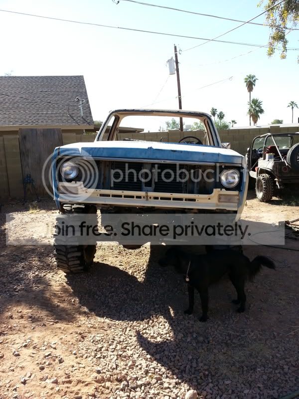

Blazer..um was hoping to shoot the paint on it tomorrow night but we have or started on the bodywork..so.. Not sure what is happening there, needs the shocks purchased and put on, front trim, windshield installed, diffs need welded and fluid installed.

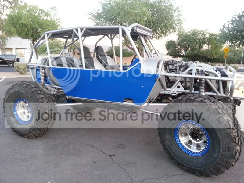

So it's six o clock, I didn't go to bed last night..or the night before and have really broke some fun parts already. The problem with multiple projects and a white board with out definitive lines..well stuff got mixed up...add in no sleep and some despair..it then got much much worse.
I got the overnighted brake brackets, spent the other evening putting it all together..but that is after I ran around like a loon. I had to pick up the tq co never tear for the 07, pick up some nitrogen, pick up some correct straps for the drive line shop, then haul ass to to the body shop for the hood, me being so busy I was presently surprised the painter there did it for me:popcorn: then.. To pick up the transmission.. Took three to make one:confused:
Spent all night finishing up pidly stuff, then work up..and took the dog to breakfast and marveled at the I true takers it gathered.
4wd test..

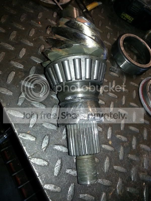

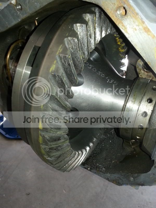

Then all hell broke out.. Ever swore you filled the diff and were wrong? Well wrong 14 bolt on the list and wrong project ..
Gears that were already bran new... In a couple blocks i
wore the new fit off them ..
Ya... Big mistake e day before I take it out..but then I called Andrew at letzroll..he had the gears in stock , turned em on the lathe and got me booing with in the hour..spent the afternoon over there and left happy . Damn mistake was costly But the buggy has new rear gears and a nice install..again.. Also got a new solinoid for the arb and some other parts. My new upper links didn't get finished due to him waiting on materials but we figured..eh it's sketchy but they will hold..

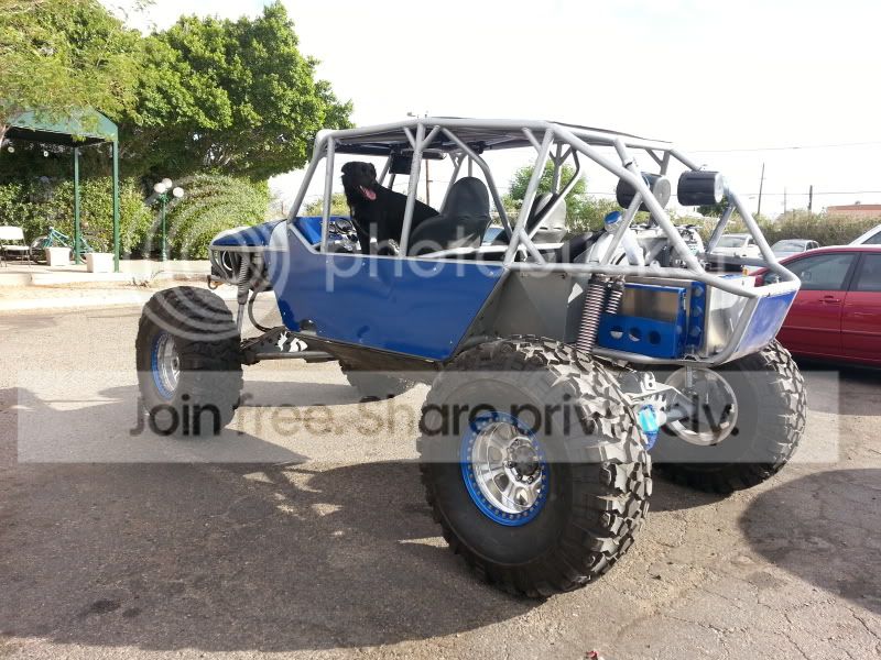

So I head home around 7 last night to install the trans, battery and the new king coil over on the passenger side, hour or two later is becomes time for the test drive and I have no overdrive or reverse. Wtf yay.
Then back to the buggy belts, um after some progress we went for a spin and discovered the rear upper links didn't have enough thread engagement.. The axle rotated, took out my fuel lines, brake lines, shader valves on the ori's lower chamber, a rock light..all in front of some guy in a ford right past the speed bump we nailed..he waled up with my heavy 250 wall d shaft. Well that was 3 hours ago an aside from brake lines she is ba k together. Fawwwwwk I am tires.
