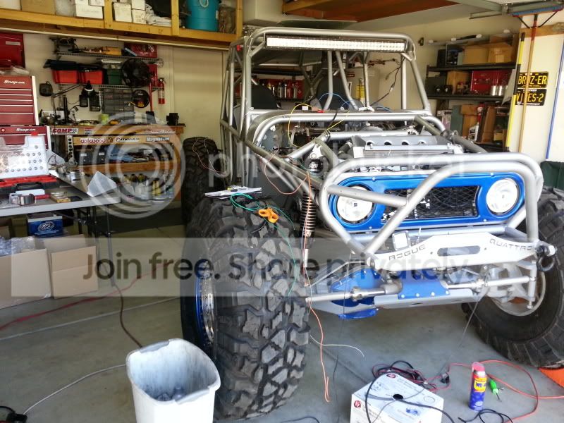

At any rate, parts are finally flying in for the buggy. Brakes are done, wiring should be finished this weekend and the fluid are in it.. Whoop!

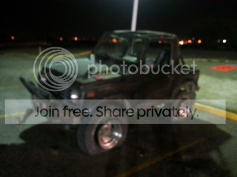

Took the Sami out..slide it into a embankment..knocked the tires off the beads, dented some crap and drove it backwards with me and my lady friend a mile or so with two driver side flats:popcorn: did the old bead reseat after my Indian showed up with my jack and n2o tank and a lighter with starting fluid and a ratchet strap. Fun.
Next night came back, tried again and fried the clutch, a sidewall, and something with the front shaft cause half of its gone.. So it will get a new clutch this weekend, probably an upgrade.

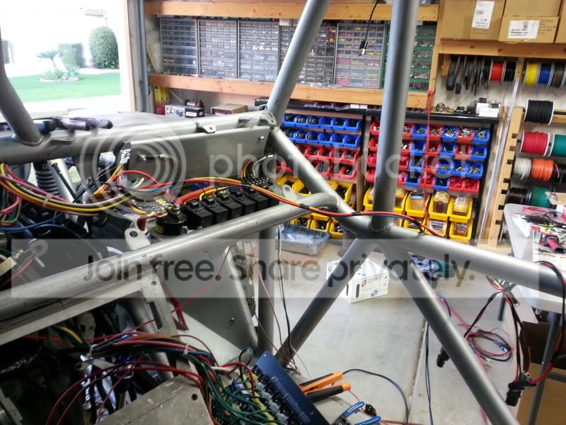

And lastly today's wonderful progress. There is a great resource here in town and he knows his stuff for auto wiring :thumb:

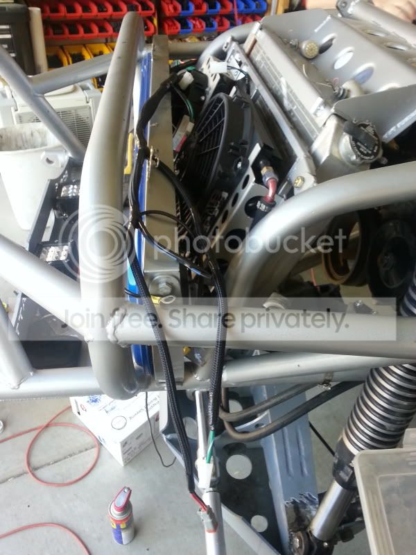

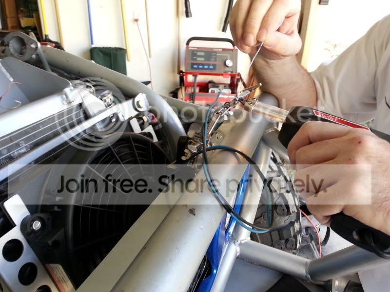

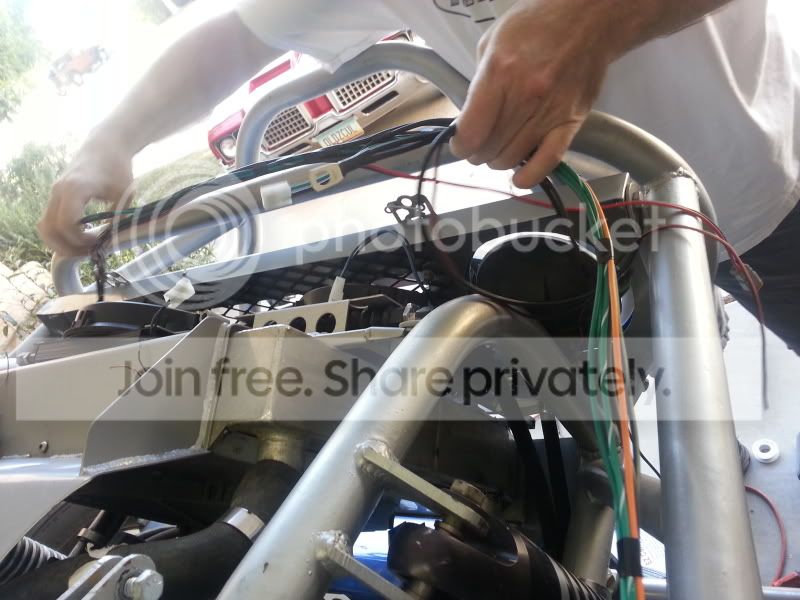

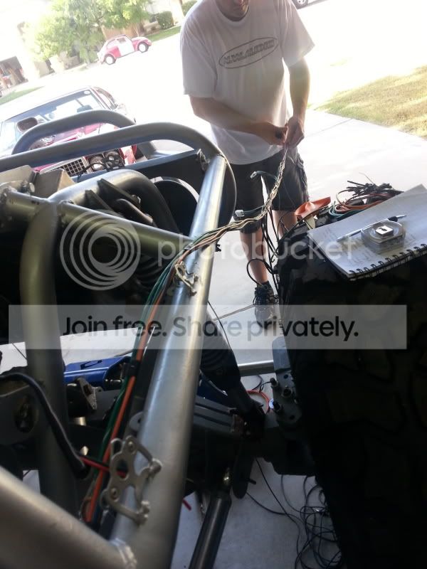

We made a front vehicle harness, all connectors are double crimped, solderd and heat shrinked, then loomed with the fancy uv rated pain to install stuff and nice fancy plugs other than the fans that used 10 gauge and there own style connector and everything has its own wire color for its circuit.
Up front is wired as follows.
-rigid flood led light Dually d2's... orange wire
-rigid amber led 20 inch bar...blue w white stripe wire
-hella 55w heat lights..brown wire
-trans cooler fan... green with black stripe wire
-power steering cooler fan ...solid green wire
-radiator cooling fan...green with white stripe

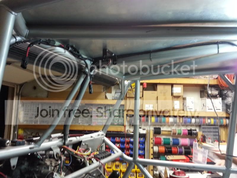

With the front tackled we moved along to making a harness for the roof.

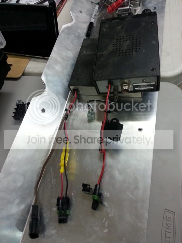

Up here we ran a 12 gauge wire off one of the extra fused circuits we left on the panel. This circuit will handle the following.
Cb with pa "inline fuse"
Siren/horn "inline fuse"
Race radio " inline fuse"
12v USB power to supply the Samsung tablet.
They are all wired with weatherpak plugs and the devices use a common stud ground then they also all have their own plug so they are easy to remove. These will mounted through a face panel to hide the stuff behind them and clean up the look.
Also up top in the 40 inch rigid led bar..yellow wire
Interior lights are the rigid led lights designed to mount on a tube, these are blue wired also with weatherpak plugs.

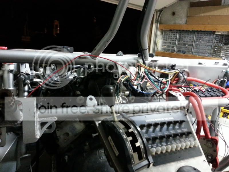

I'll snap some pics later of the awesome wiring to the battery, battery selector switch, distribution block "1 inwith 3 out"..battery cable selection is 0 gauge fine strand.
Line lock it also wired, as is the fuel pump and starter wires.

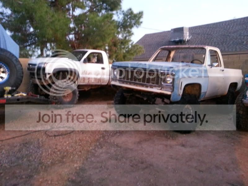

Well the blazer was a project with my dad, we gathered up 3 and made one.. 3/4 tons, cross over, stripped and painted frame with the weld in kits, 56" with shackle flip, new springs and all that jaz. It's now getting the rear welded, some color and the darn frame lacks any brake components so that's going to suck $$
It has a rebuilt 350, sm465 and a 205. I figure it would be nice to have as a back up mud toy and street truck when I want a door that slams like a door should :D
07 is waiting for me to get a call from jakesperformance saying I'm next on the list for a trans build.
I love how you spend a lot of time and big bucks on some parts.... then weld the rear lol definitely all about function for you
