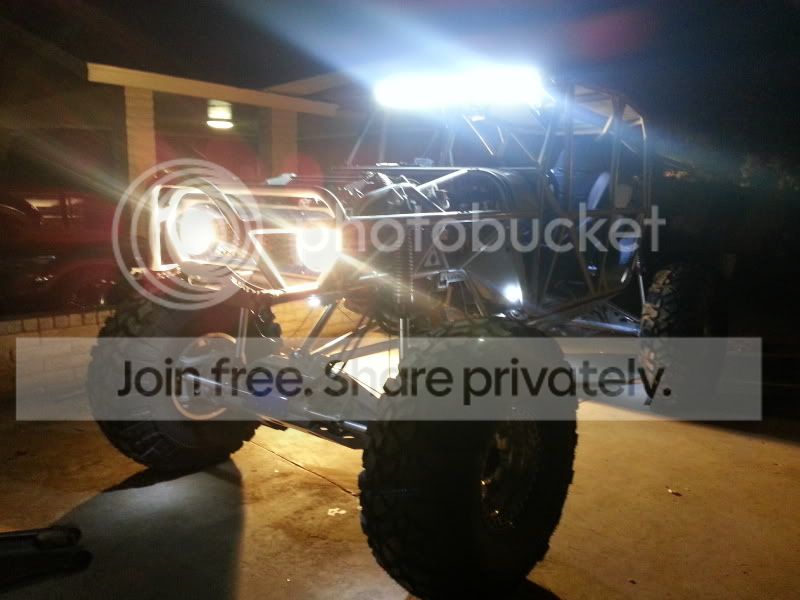

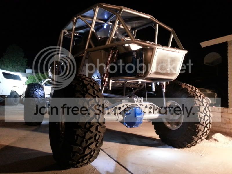

Buggy is jacked way up to make working under it nicer, this is not ride height.

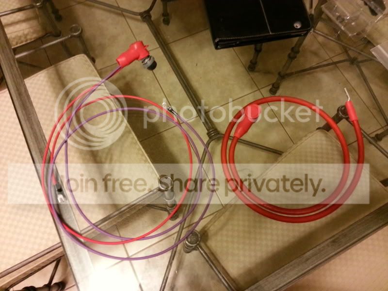

Alternator charge wire and boot. All fine strand and 4 gauge. Along side it is the ignition switch wire and a boot on it to protect it from arcing out if I ever goof while crawling around or fixing something.

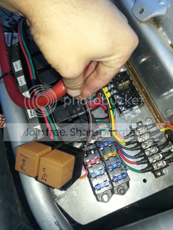

Adding in the new engine harness and fuse/ relay block.

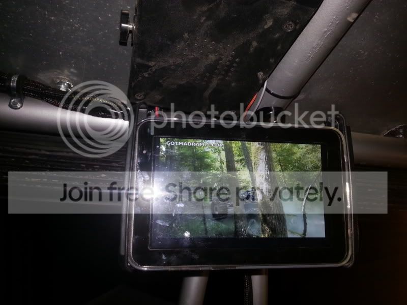

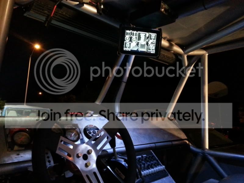

Interior engine obd2 diagnostics displayed on the Samsung tablet with gps. This tablet will hold my music, do my off and on road navigation and also has a camera and a app to record and log data during my trips. The app for the obd2 is called torque, it used a blue tooth dongle that plugs into the adl plug.

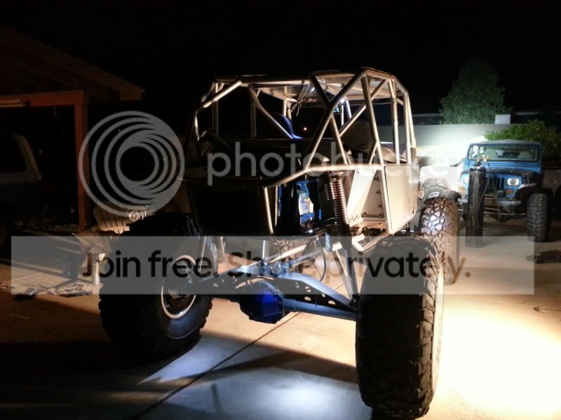

Still lots to tidy up and I am waiting on the front hubs, bearing, brakes and such in the mail, should have that next week.
A lot left to tidy up but she did move under her own power.. Even if I only went a foot before slamming into park because of no brakes it was a nice ride!

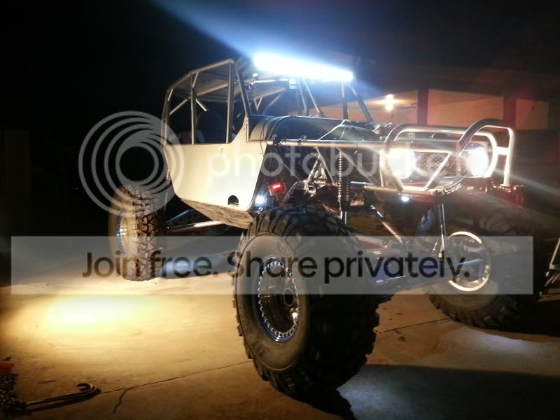

Short list..need to make a rear harness, ordered 4 inch 32 led lights for the stop turn as well as a signal pulser to make the brakes flash a few times when I hit them then go solid.
The reverse lights are 13 led lights that will have a in line strobe box, the front rigid Dually d2's will also be able to strobe. I plan to race this in a fe of the dirt riot races next season so a solid amber and flashing blue will also be prebuilt into the harness.
The arb harness is getting ditched, so I will use the 40amp relay and circuit on my switch panel to control the solinoid and compressor.

What app are you using for off-road navigation? I've got a Samsung tablet you're giving me bad thoughts about. :)
I've done a little research on them but didn't see any navigation app that really stood out for off highway maps.
I havoc used it off road yet but back country navigator is the one I downloaded and will start with.

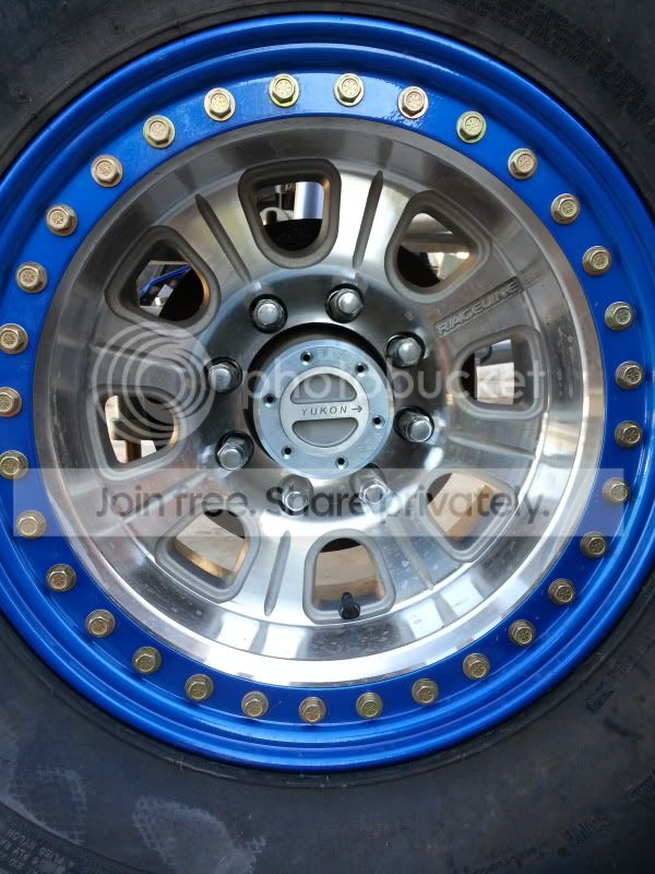

These bad boys came in today
New Yukon spicer style 35 spline hubs! Can't wait to try to be the first to break them!

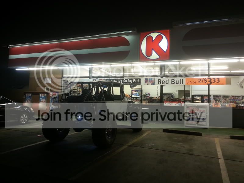

I'm excited too:D idled it over to the gas station and the responces were quite fun. I gave up and just said yes to all the jeep questions.

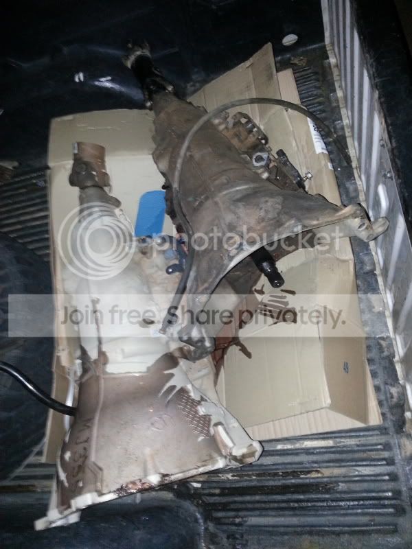

Well I decided I want to go, even if I just put a stocker mild one back in. I dug through my dead trans pile for the trans I broke the intermediate shaft in and then pulled dead trans number 14 out of the truck tonight "in less than 20 minutes with me and my Indian I might add" :thumb:

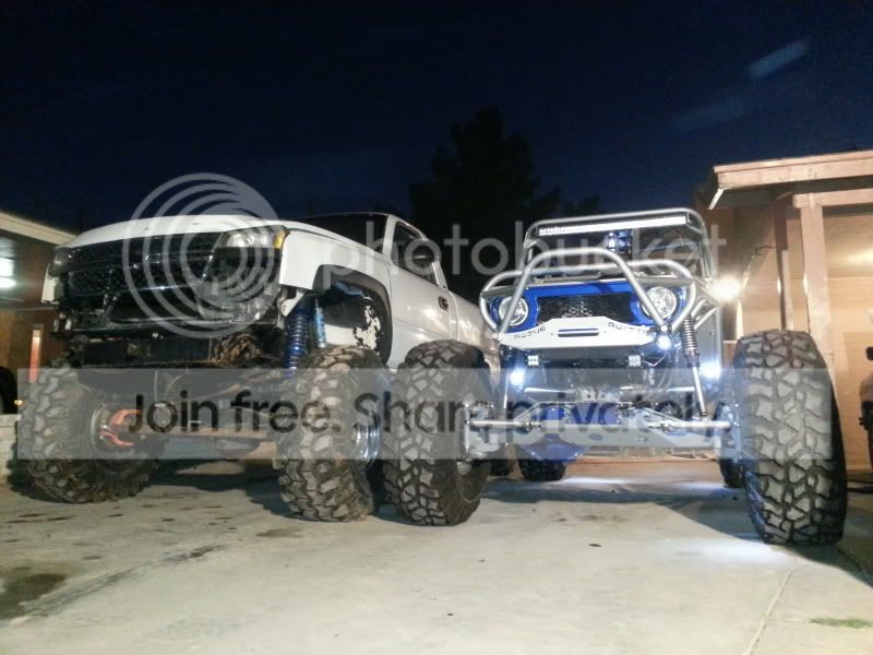

Truck is cleaned up, 44" TSL's look smaller than the buggys 42's!
Tomorrow I'll have him drop them off and I should have one or two transmissions waiting for me end of the day Wednesday. I also decided to enter tuff truck this year, if I get in I'll toss some timea cage and some money at the truck. Over all my interest has dropped in the truck so I am really hoping this trans can just get me by for a couple weeks. I'm to the point that I could move on from it but would like to try to get my interest back.
We also pulled the trans and t case from the samuri.. Sadly I broke the t case along with roasting the clutch after I could not get it in 4low. Bummer..turns out the t case and it rotating was the reason :doah:. Broke 3 of the bolts on one side. So I'll need to address that but I have a spare case here from a Sami I parted out last year with bad gears so somehow that all worked out:pimp:

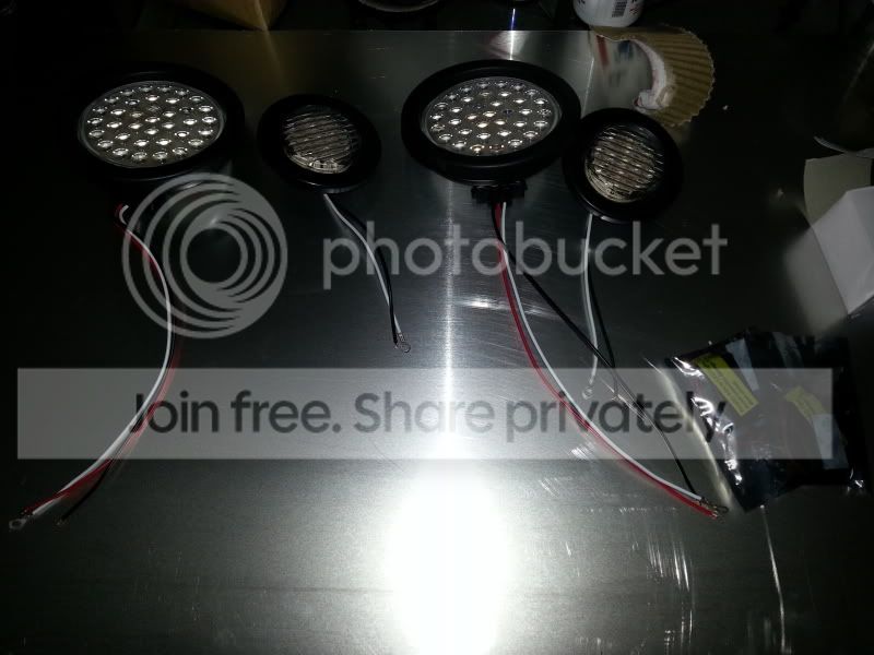

The buggys tsil lights came in too. 32 4 inch led clear lens, 19 led 2 inch back ups. I also orderd in line strobes to put on the front rigid duallys and these 2 inch LEDs. Those will fired off my switch panel that is already ready for it.
Not excited to make the panel but will get on that asap. The tail lights I ordered a pulser, it flashed them quickly several times when you first hit the brakes then they go solid. I put a brake switch that in inline on the hard line to work it. I may mak a brake switch or pulse modual bypass so I don't make my friends go into seizures on the trail though:popcorn:

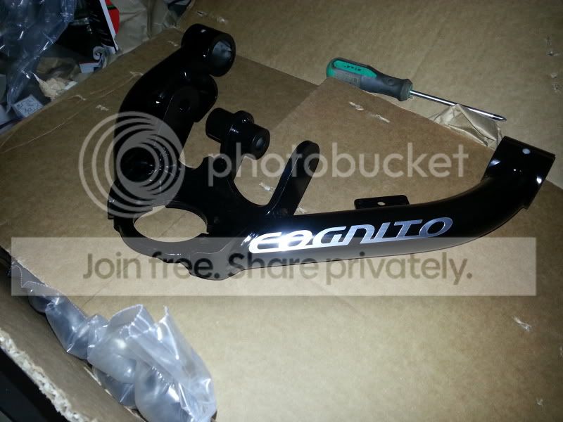

And lastly in my circus of 5 projects at once.. I got the Cognito arms, fancy ball joints and some tie rod sleeves for the duramax. I wanted to do a solid axle but I just don't have the time and I don't want the truck down during wheeling season when I need it to tow.

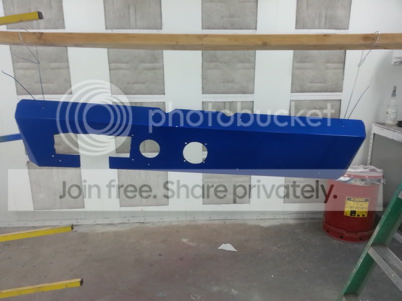

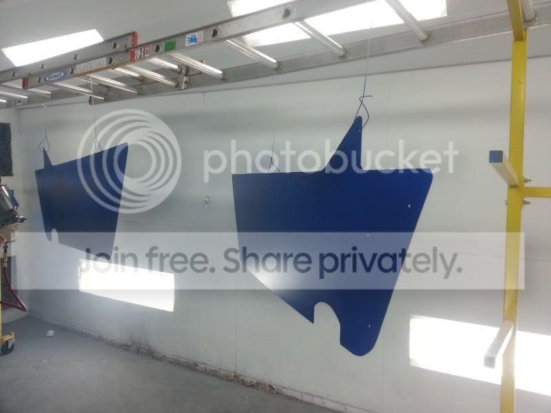

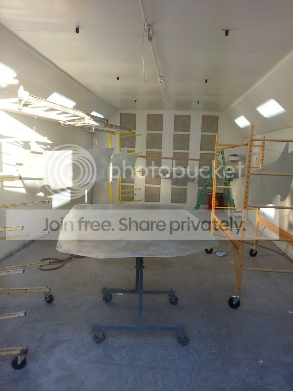

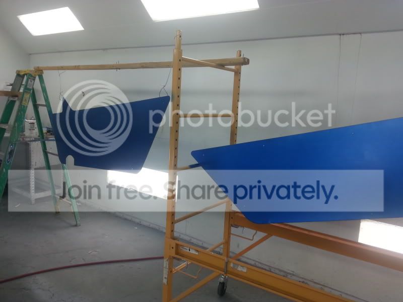

Finally had a day to take the buggy down and play at my buddies body shop.
More pics in a bit. Changed the color from arrival blue to 2001 Subaru wrx blue, matched the powdercoat better.

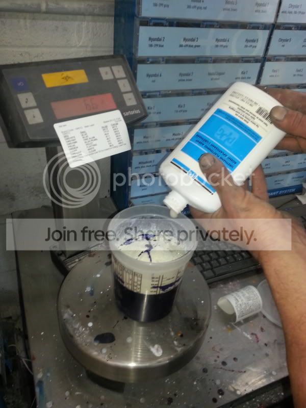

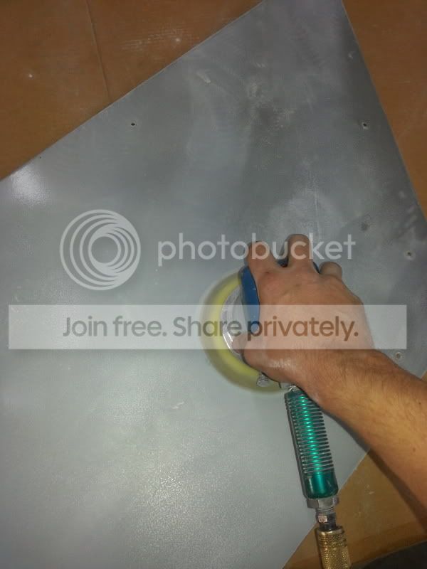

Cleaned all the bare aluminum, sanded to 400, sprayed on a sealer, Mixed the paint step by step trying not to goof up $$$$$..couple coats of paint, few coats of clear with time to flash in between.
Bummer is I went through all of one of the blue toners I need so the hood will have to wait till next week.
72oz of ready to spray product I went through not counting the clear..yikes.
Our jungle Jim we set up to get as much as we could in the booth..roof, dash and two sets of skins.
Tomorrow I am going to wet sand the nice side skins and dash with 2000 and buff them till they shine so bad I don't want to rub it on rocks.
