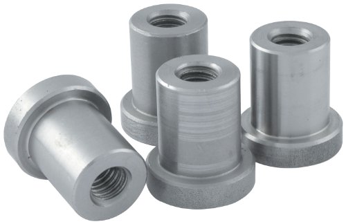

Slick trick with the V-shaped fixture to hold the weld washer flush..... immagonna steal that idea. :waytogo:
I actually bought some weld-washers recently from Barnes4wd, which was the only place I could find online. Picked up 5/16, 3/8, and 1/2" versions but they are all fine-thread.... this will work well for my muffler hangers but I would like to find some standard coarse-thread versions for other applications. If you have a part number (or link in your Amazon store) please share it when you get a chance.

Steal away. This was just a handy piece of scrap from the engine mounts. I've bought those same fine threaded inserts, and also wanted regular coarse thread for these basic structural mounts, and these are kind of a commodity item now that Allstar makes them.
Here's the direct link to the inserts: https://amzn.to/3aEM9Yk
At your suggestion, I added them to my Amazon store: https://www.amazon.com/shop/willomet_motor_and_fab

Thanks..... you just cost me another $200.
