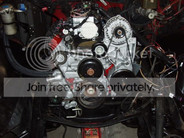

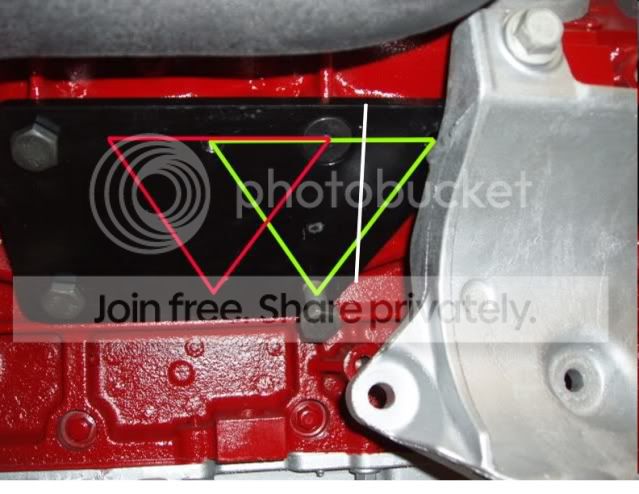

The one issue with using the #2 plates comes when you are going to use the LS's AC compressor in it's original low location. Here is the problem I ran into:
Basically, the forward ear of the adapter plate interfered with the compressor bracket. The green triangle is where the clam shell mount from the old SBC was supposed to go. I determined that moving it to the location of the red triangle would solve the problem. Then cut the excess off at the white line. Essentially, I would be modifying the #2 type plate to be just like a #3 plate.

Now everything will fit:

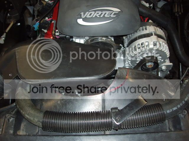

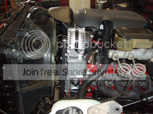

He did wind up having to shift the transmission crossmember back a couple of inches but I think the mounts he used set the LS engine about 1" forward so it's actually sitting where the original SBC would be sitting. It actually looked pretty sweet since he was able to re-use the '85 fan shroud with a stock LS mechanical fan and intake. I'm not sure but I think if you were to use a shorter 4wd 4L60E you may not have to move the trans crossmember back as much as he did if at all. I don't have a cherry picker and the extra space in my garage yet to start playing LS Tetris yet so I'm just spit balling and hoping something will be useful lol.
I went and saw a friend of mine today, and he had a clutch fan for me to use for mock-up. It has a broken blade. But he also thinks he has a good one, so I will swing by his shop on Friday and see if he found it. If so, that will save me some time on Saturday and some $$$ too. I also got the shroud to fit too, I had to cut a little around the air intake, but it all fits real nice, but I need to trim it a little more (where the Sharpie line is). The fan sits just right in the shroud.
