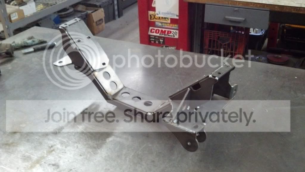

Okay, so I ended up going through every single piece of mostly used 1/4" plate I had left in my pile, and came up with just enough to squeeze out all the pieces I needed for the crossmember... One piece is actually missing a small piece of a corner just because I couldn't quite get the last piece to fit, lol.
Here she is tacked together:

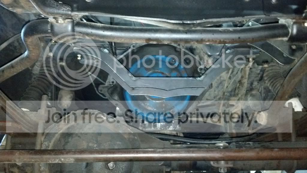

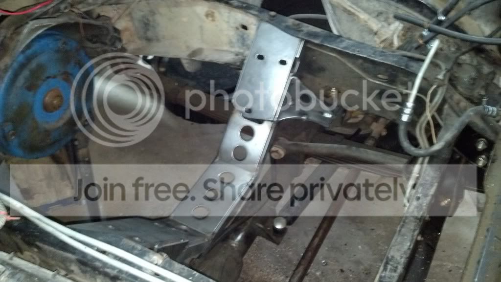

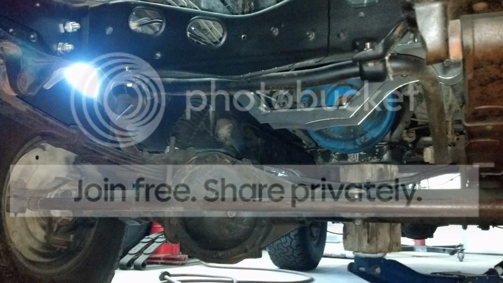

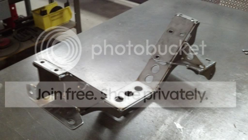

Got this far just before I left the shop today. After I tacked the whole assembly together I trial fitted it in the truck. I am happy to report that I got every nut and bolt in without any issues :) There is one hole that the bolt isn't centered in though, so I'll change that before I cut another one - it still fit but wasn't perfect. I want to get everything as close as possible on this truck since the frame seems to be as straight as I could ever expect. That way if someone else's frame is slightly different than this one in either direction it should still fit in there pretty good. I know it's asking a lot to make something this complex fit every one of these old trucks just right but I want to get it as easy to install as possible. Oh, and there are NO holes to drill for this one! Only the 4 rivets of the factory crossmember have to be ground off. Then this bolts in to the factory bolt holes and two of the rivet holes!

That is awesome work! I started to wonder why you got rid of the removeability of the center,,, then you showed the bottom view!! I need a bunch of money to send your way for some of this cool stuff! On the rear bumper subject, could you let out a few peeks? I have a buddy who wants a rear bumper for his '90 so that he can carry his spare and gas can.

Thanks man! I definitely wasn't going to get rid of the removable center section for this one, I just made it a little easier to build and a little more stable once together, so the design has changed. Still removable though!
