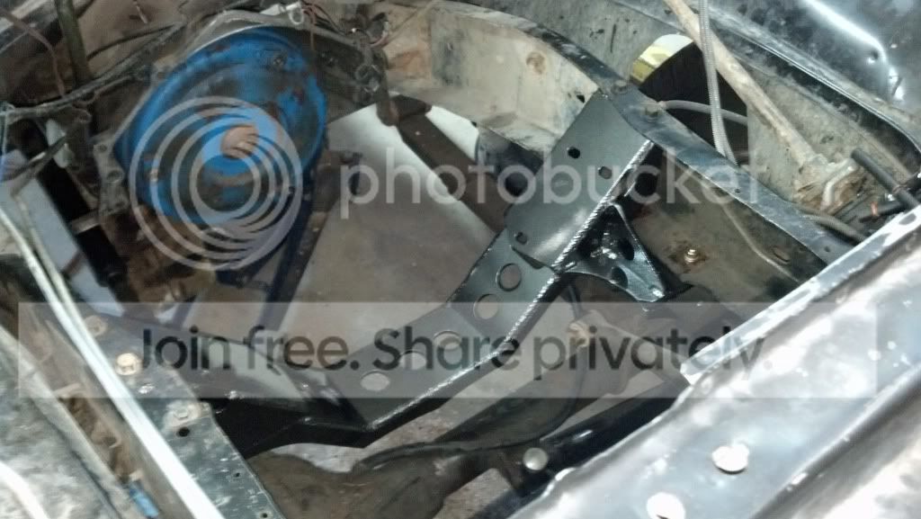

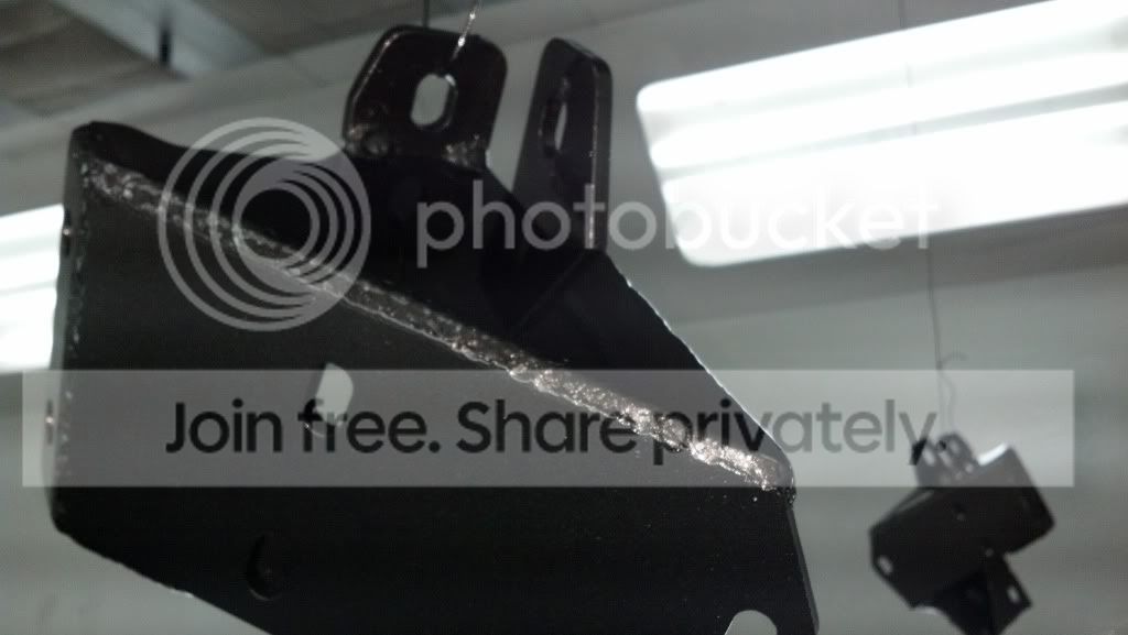

Well, I didn't get to the shop today until after noontime, then boxed up some stuff and brought a bunch over to FedEx. Glad to get some shipments out the door again!! I think I am mostly all caught up on customer stuff for the moment. That brought me to three o-clock, and then I finished up a few welds on the new engine crossmember, and got it into the booth for some epoxy primer, color, and clear.

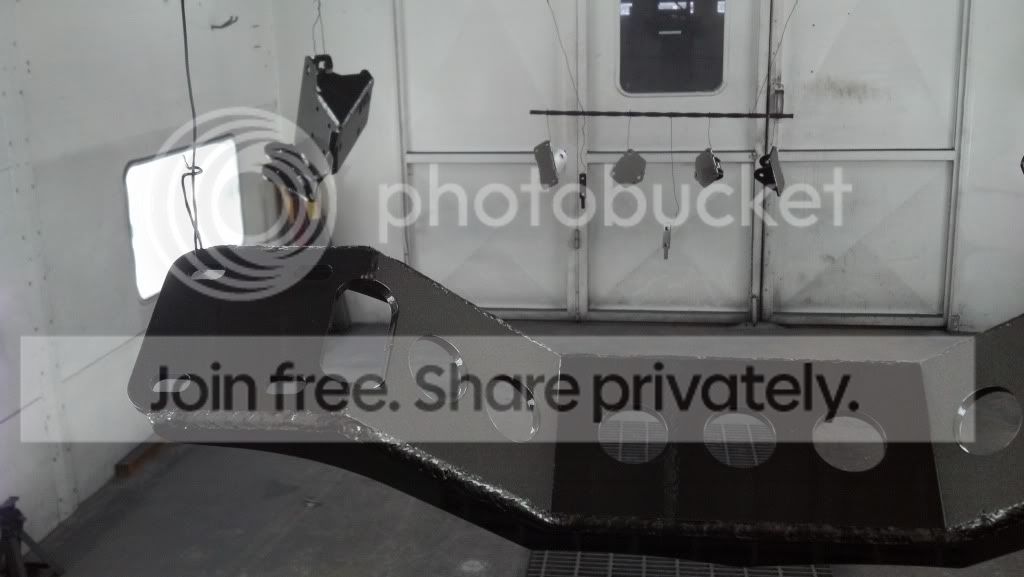

I was feeling like I was running late, so in my haste, I filled my gun with basecoat before I realized I hadn't put the needle into it yet. Yay. So almost half a gun-load of nice basecoat peed out all over my table and onto the floor before I could pick up the gun and dump the rest back into the mixing cup. Stupid mistake!! Cost me about a half-hour of cleanup!! Man, did I feel like an idiot, lol! And that is what I get for trying to rush things - you'd think I'd know better by now, but nope, apparently not!
Anyways, after some more time in the booth, this is how I'm ending my day:
Can I just say that I think it's pretty damn cool to be able to go from drawings in the computer, to plate steel, to cut pieces, to welded pieces, and all the way to finished, really nice looking base-clearcoated pieces, all at the same shop!!! It's pretty bad-ass if I do say so myself!

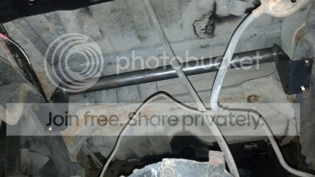

So here is the basic rear upper shock crossmember bolted in place (yes, I actually designed something that you have to drill the holes to mount! Lol). I think I am going to do standard shock tabs for the upper, at a slight angle so the shock will come down and outwards towards the wheel. This will allow you to mount the crossmember in either direction (shock tabs facing forward or rearward) to tailor your shock angle to your liking. That would put them either at almost the same angle as stock, or angled forward a fair bit more than stock. That would allow you to fit a slightly longer shock in there to gain a little more travel, but still not have too much of an angle so that they still function properly. I'll get the lower mount posted up sometime tomorrow hopefully.

And heres installed.
Like 4 hours of measuring and cutting with a grinder and tacking and bs lol.
If only I had your setup. I coulda made them in like 30 min lol.

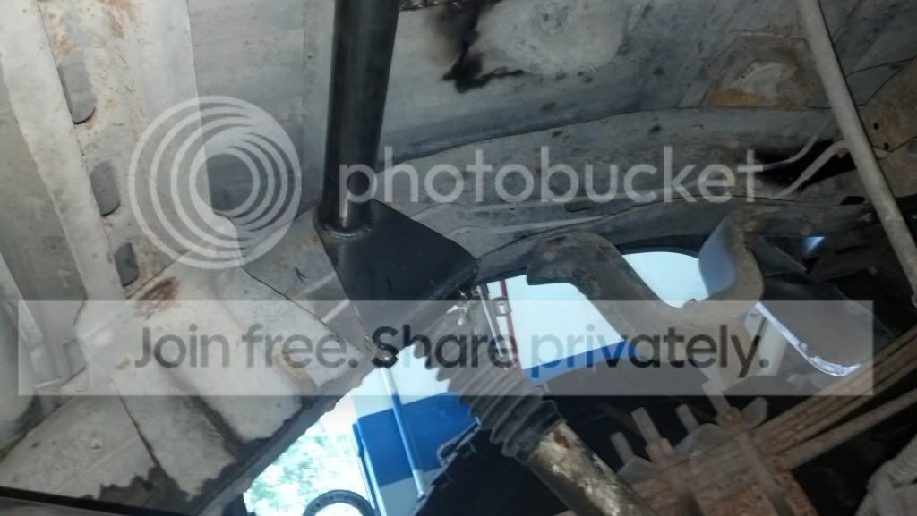

One installed pic.
Lol, yeah I think I had the drawings done, the 1/4" plate cut and the tube cut, ready to be welded together in about 30 minutes. Just couldn't finish it that day due to me being a tard and running out of welding wire. I think it took me longer to drill the damn holes in the frame than it took me to build what I've got there so far. Well maybe not, but it sure seems like it. I hate drilling frames from underneath. I'm not a fan of hot metal flakes falling directly on me. Of course I end up doing it all the time. My eye doctor loves me so much (from taking out various pieces of metal very frequently) that I was actually invited to her wedding a while ago. I'm not so sure that's a good thing. But it was a cool wedding and she's super nice so that's a plus.

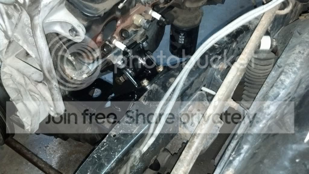

Here's the new crossmember in place, bolted in and tightened up very nicely! I'm very happy with the design on this one ;)
Complete with greasy fingerprints:
-Darren

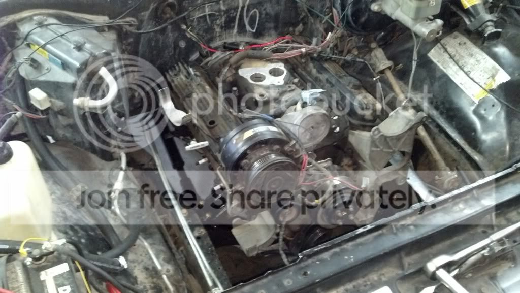

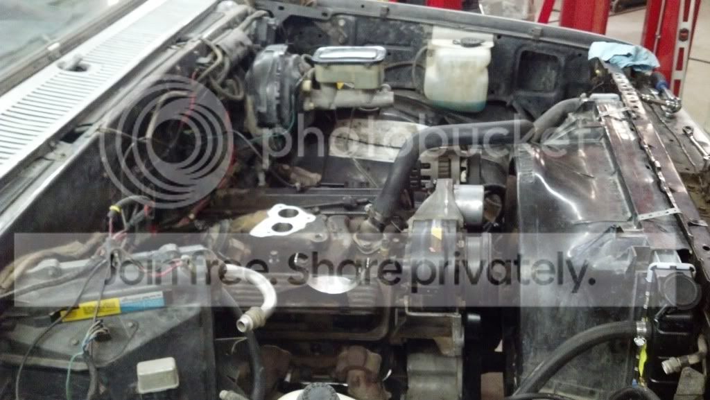

Sorry man! There's nothing to show just yet, just some dimensions in the computer. I got stuck dealing with radiator and header issues today, and didn't get crap accomplished (well other than motor put in...). Just got back with a new radiator and decided to ditch the headers for now and just run factory exhaust manifolds. Prolly good too since I hate exhaust leaks, lol.
-Darren
Well I think I've had it for today. I got the engine in, a new radiator in, got the whole serpentine setup on, and got the exhaust manifolds on too. I even managed to sneak in cutting some shackles on the table. Seems like everything fought me today, to the point of using a 3 foot pry bar on both of the exhaust manifolds to get the front bolts in - it's amazing how much heat-cycling metal warps it, lol. But at least it's done, and now it's on to the wiring harness and rear bumper. Sorry I couldn't get anything up on the rear bumper today, the stuff fighting me plus the almost 100 degree temps in the shop just beat me down. Now I've got a looong drive home and crap to do at the house still. Hopefully tomorrow I will accomplish a bunch, because Thursday, Friday and Saturday I have to go out of town on a job.
