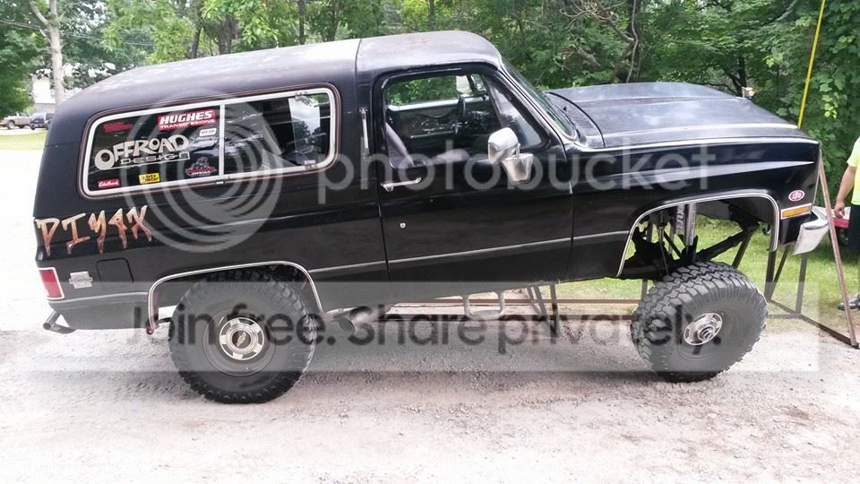

If you can halfway weld, custom shock mounts are easy. My front shocks mount vertical from my custom axle mounts to my upper custom mounts. And it still flexes pretty well for only being a 12" travel shock. Actually only about 11.8"

Ive had the pipes straight out the back, out the back corners, and where they are now. Every situation smells the cab with top on and back window down. I dont notice it at all with the rear window up.
Top off and I dont smell any fumes.
And those are actually the mufflers sticking out the sides. Not the tips. Supertrapps :D

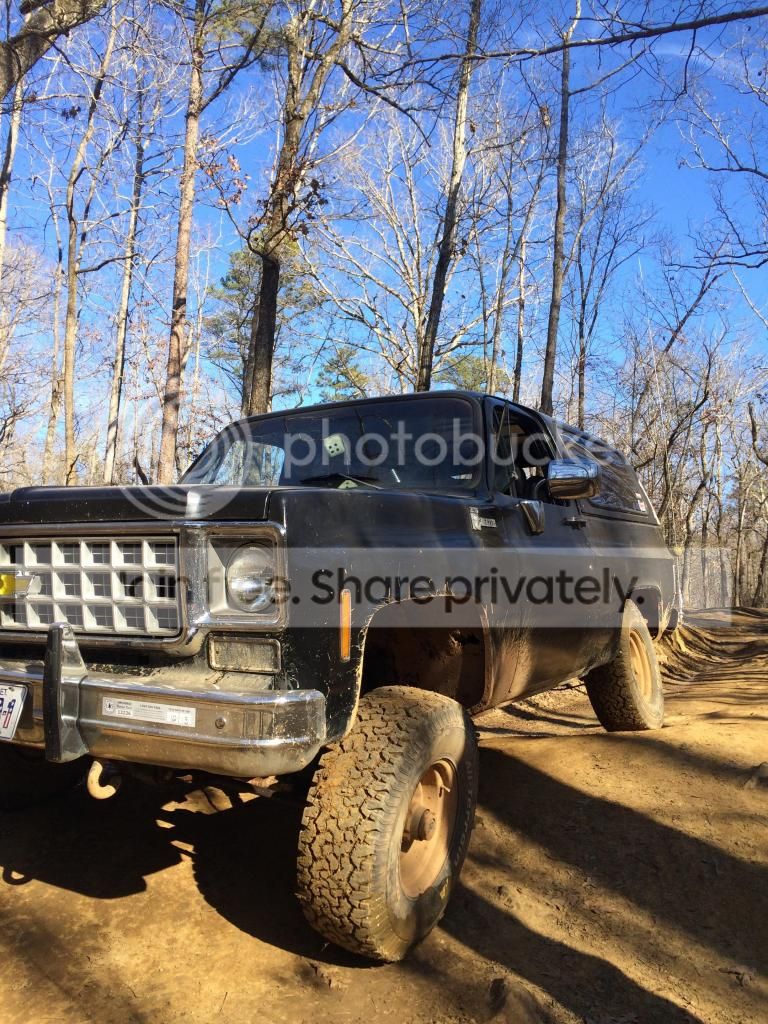

You can put the pics directly in your thread by using the links on Photobucket... but someone needs to have a talk with you about your photography skills :doah:
Hey man it wasn't me, you'll have to take that up with my buddy, he was spotting me and snapped a few pics, hell he took them with a iPhone 5 so I didn't think they were that bad. Haha
Those pics pook good to me. Rig looks good.
