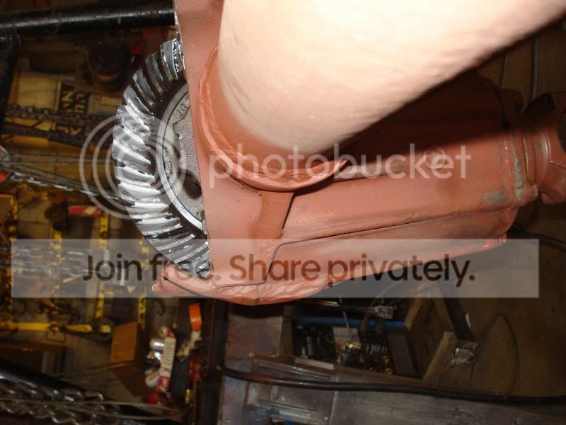

Decided to just pull the 14ff out and weld it since I was going to add a truss.I did some good preheat and went at it with some nickel rod to get the best weld.

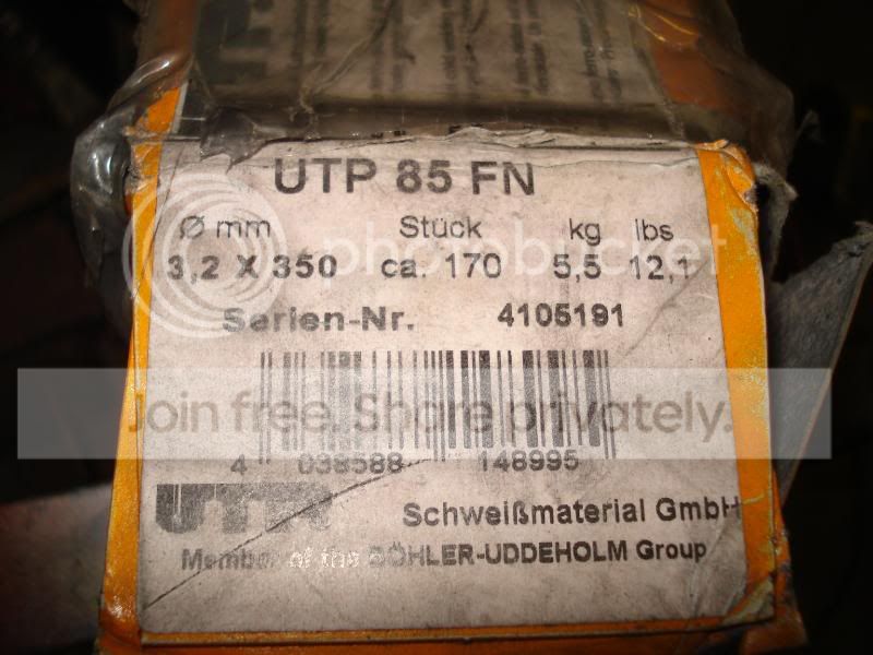

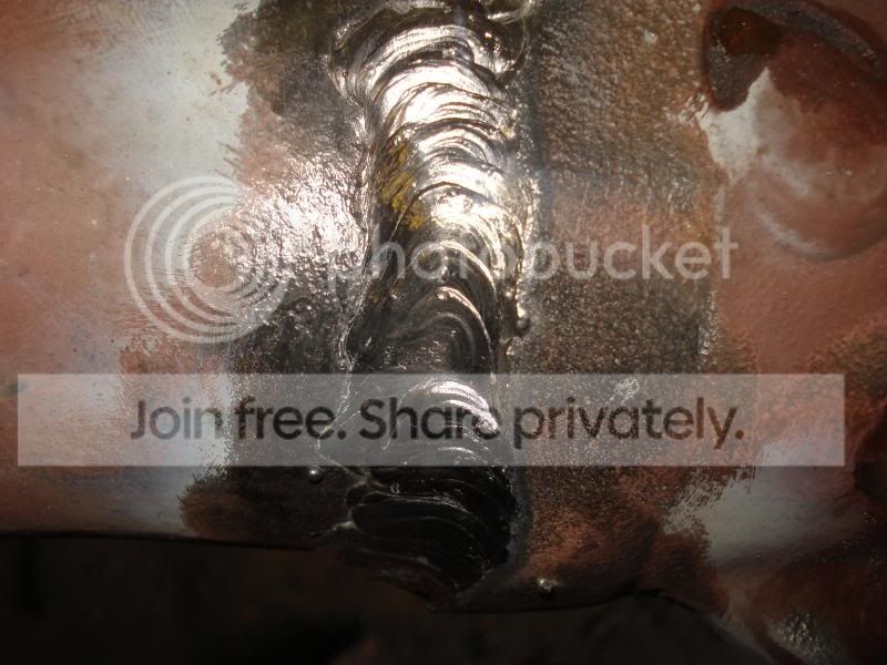

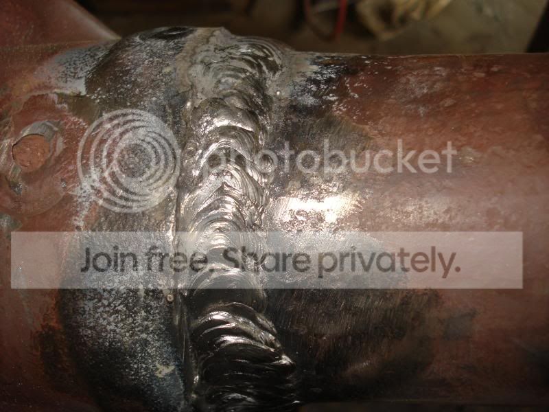

I did no preheat or post heat had no cracks. but I did do it in 2 passes so it wasn't too cold. I used nirod on the tubes. I wasn't planning on welding the tubes untill I read this thread the other day. I was just finishing shaving the dif so why not.
the rod:
left side left handed weld
right side right handed weld
