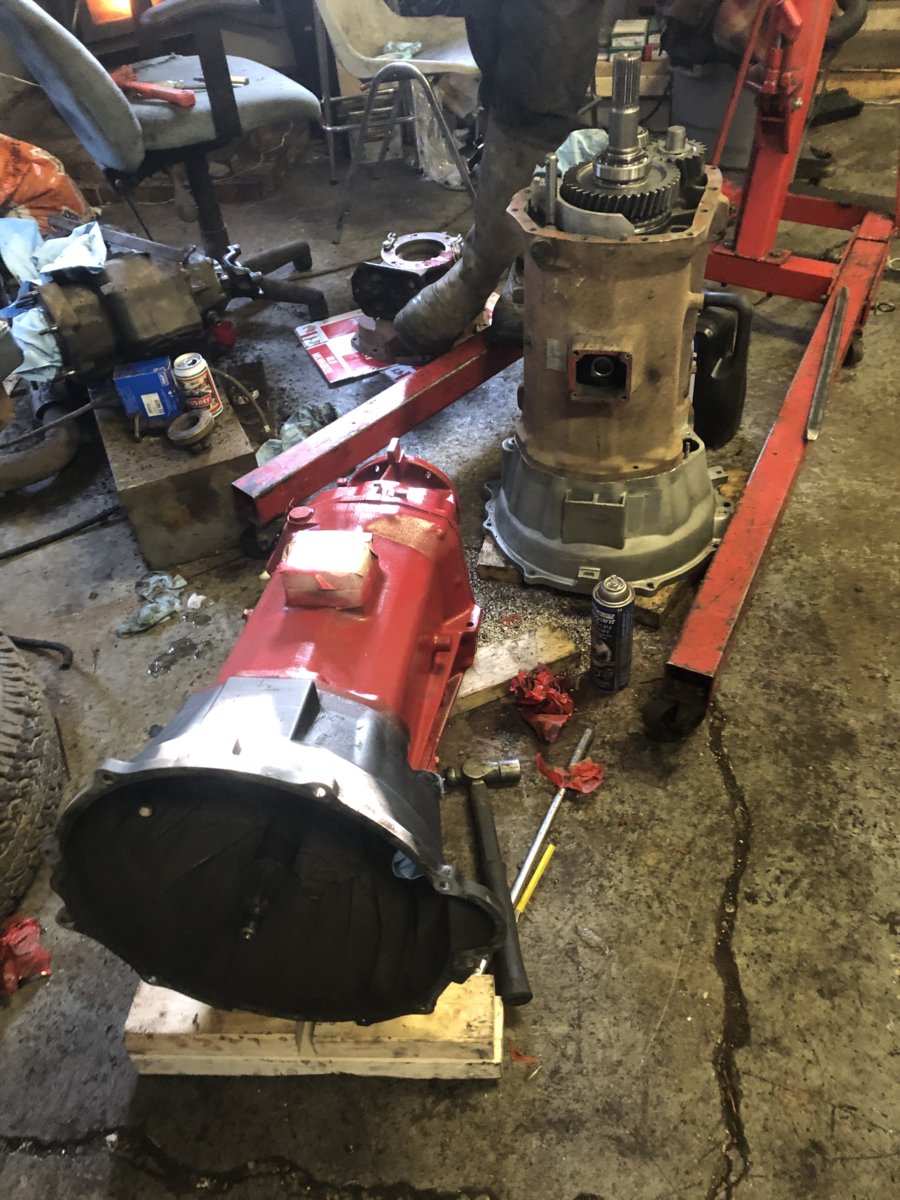

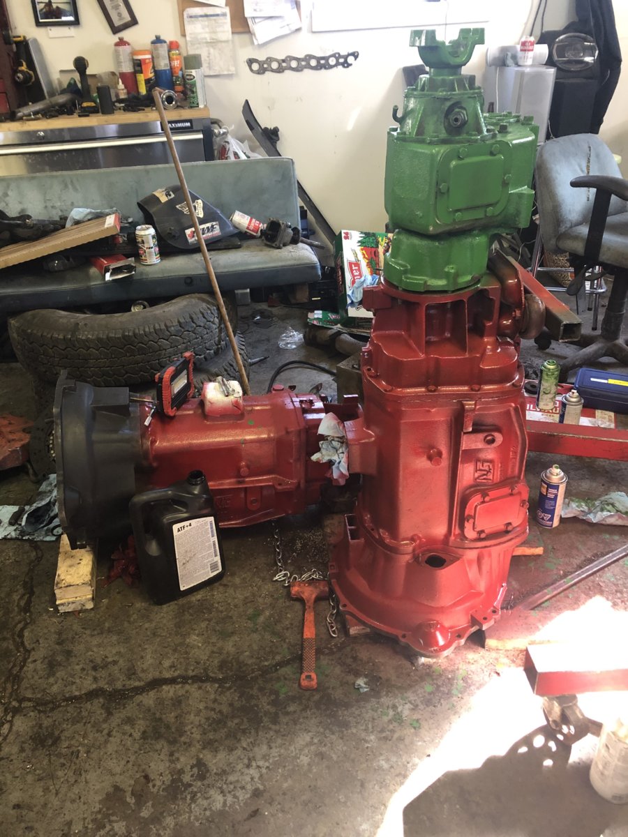

I'm at a crossroads now, my buddy is halfway through a trans swap on his 92 W250, and he's using an NV4500. We talked it through and I may sell him this 5600 to swap in, as I have little chance of getting my shop in the ground and getting into the guts of my project for quite some time, what with the current events and whatnot. I have plenty of time to find another one. Got a picture of the 5600 and the 4500 side by side, though. Gives a good idea of the size difference
Found my buddy a killer deal on an NV5600, so my trans will remain mine. Drove a few hours south to get it, pulled it down, and inspected it. Supposedly it was rebuilt but had the end play on the shafts set incorrectly. Easy fix. Buddy also cleaned up and painted mine for me while he was bored in the shop. If any more of these things show up it might be time to seek help, haha

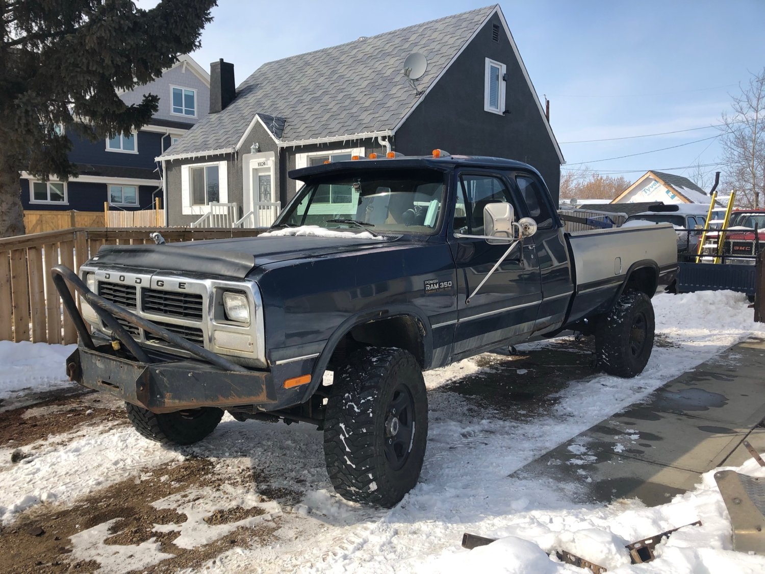

Don’t have much to report on the crew, I’ve still got 2 feet of snow and minus 12 during the days, although the snow is leaving pretty fast now. I know some folks didn’t mind seeing my old Ram, and that’s what I’ve been busy on the last few days. Not supposed to be leaving the house anyway. So it’s now single rear wheel, got some decent used Toyo’s on it and hopefully it’ll be going for an out of province inspection soon. I’ll need this rig to pick up parts for the crew anyway, haha

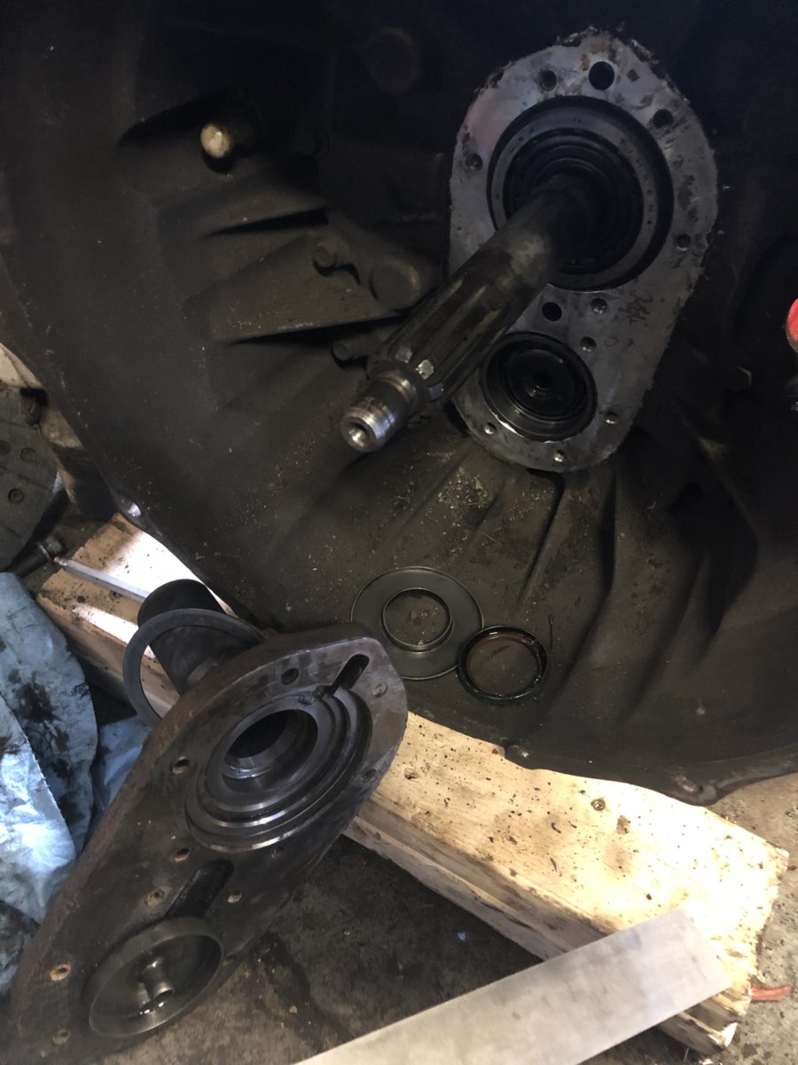

I checked the end play in mine and had to order some shims. In the meantime I just hammered out the input seal as it was starting to leak. Might as well do it cause I’m there and it’s easy now

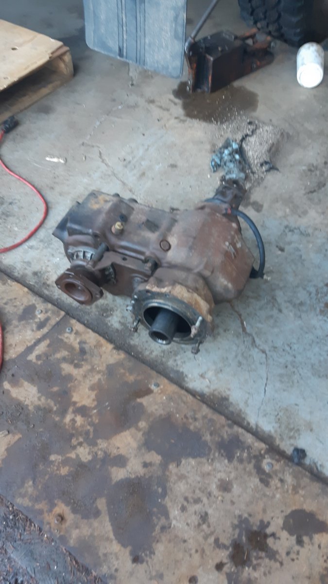

The last piece of the drivetrain puzzle has fallen into place, buddy of mine traded a divorced Ford 205 he had lying around for a Dodge 29 spline 205, and he sold it to me. I’ve been passively looking for a 29 spline 205 for the last year, they’ve gotten considerably harder to find since I last built a truck. So that’s a load off the old mind

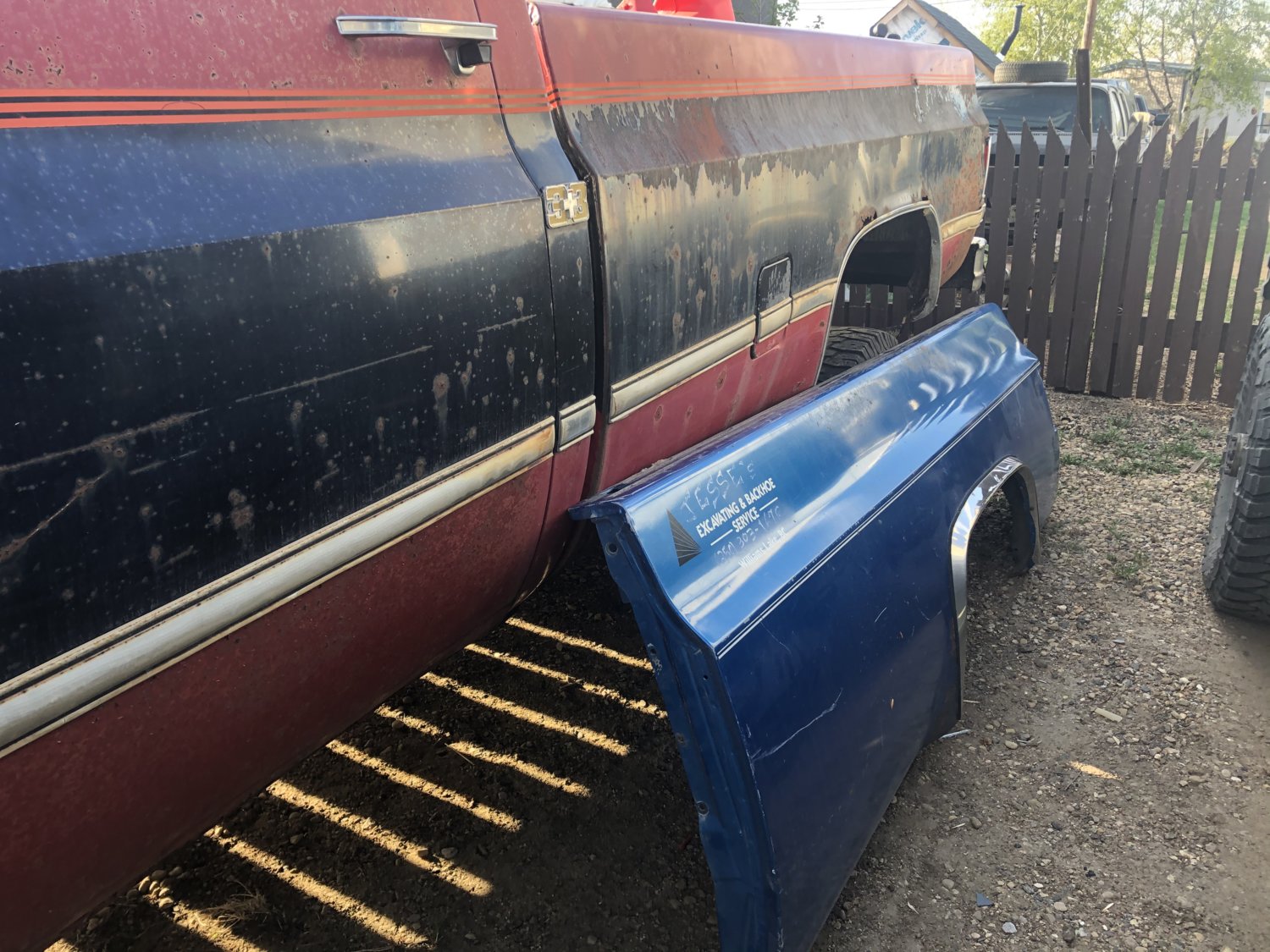

Minor update, still waiting on the shop to really tear into the build. But I did manage to pick up a nice box side today. Just needed one, took forever to find someone who wouldn’t only sell them as a set. Now the body panels are all taken care of

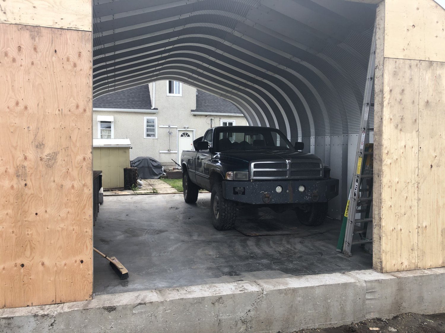

Finally got the shop up, pulled the donor in and it’s ready to tear apart! The shop has a long way to go yet, there’s no apron on the front so I had to drive through the yard, but it’s a covered place to work finally. Plan is to pull the engine and part out or scrap the rest, I’m jumping the gun a bit here but I need to downsize the fleet and get things out of the yard. Tear down commences tomorrow!

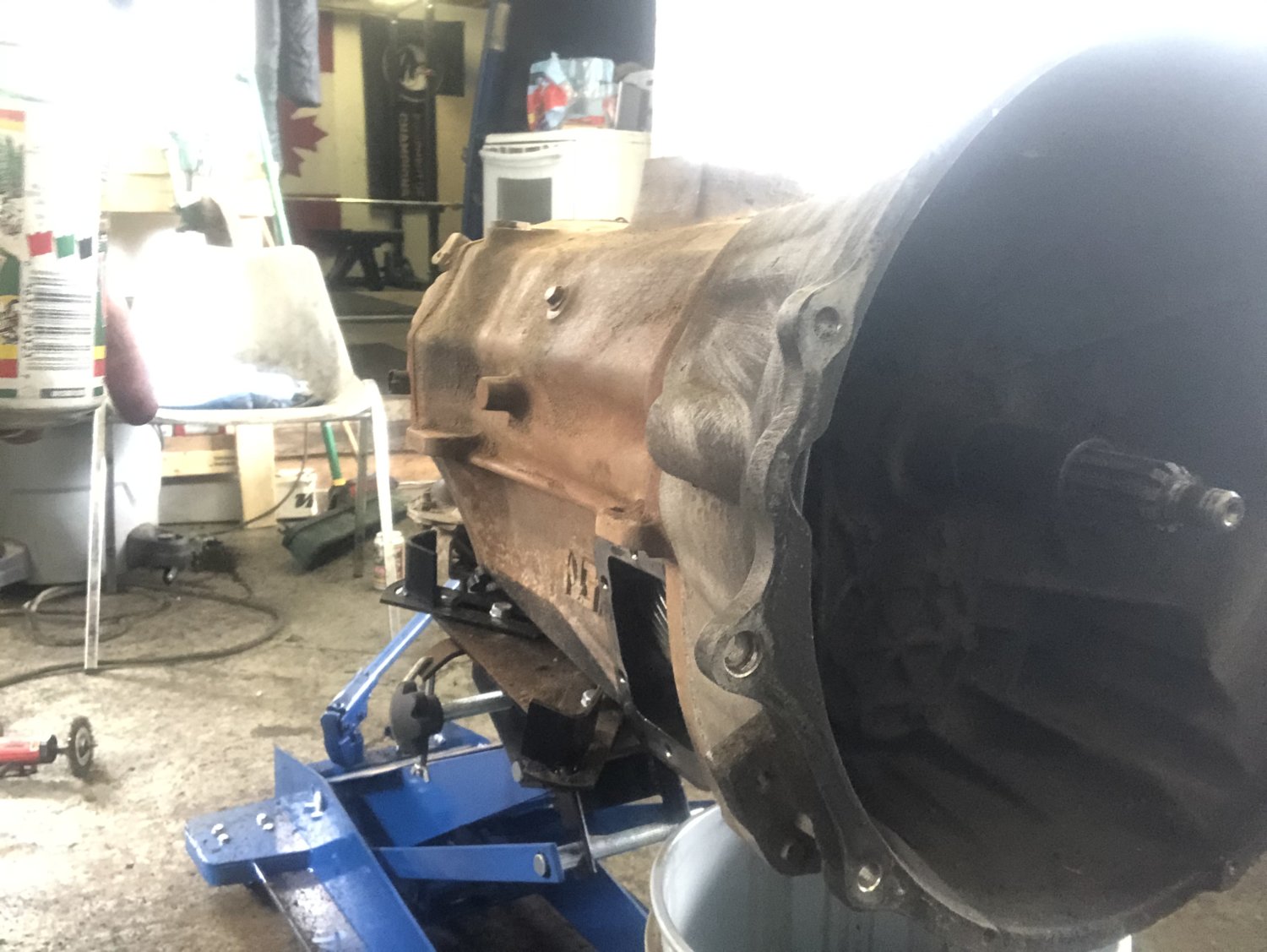

Mounted it to a Canadian Tire engine stand, note the safety tire, I don’t trust the thing. It sagged pretty good the last time I had a 12 valve short block on it, haha

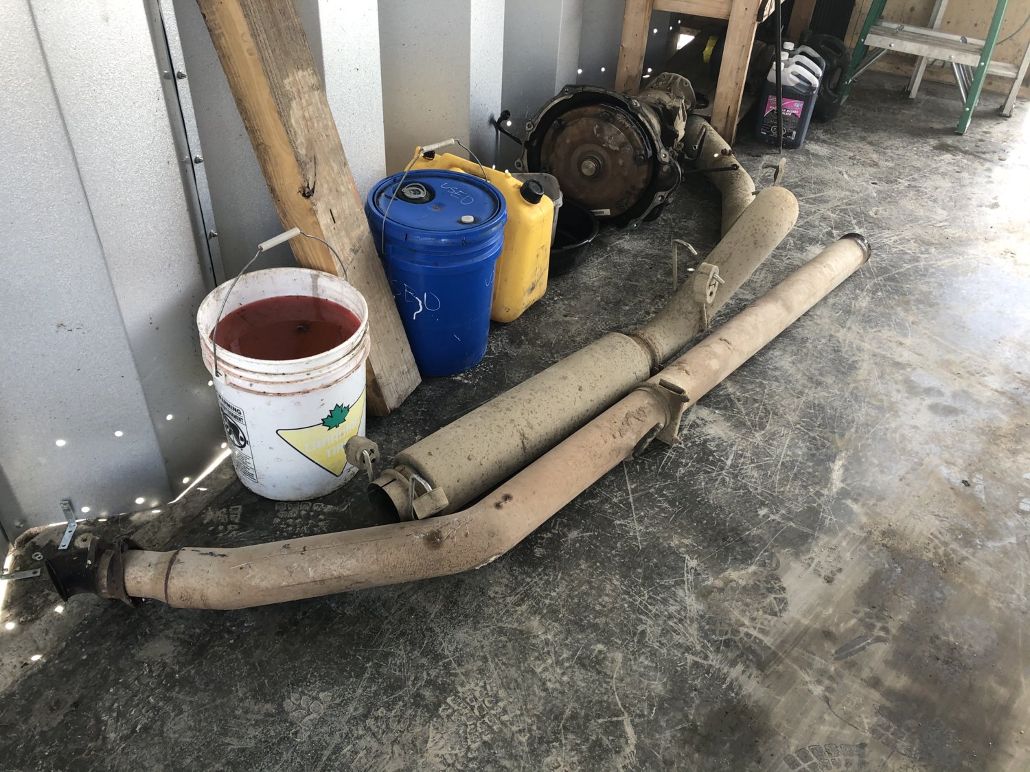

Started pulling accessories off that I won’t need, like the heat exchanger for the auto trans, and things I don’t want to blast with the pressure washer, like the alternator and turbo. Started cleaning it up, not sure how deep I’m going to get into it. Definitely a basic reseal, crank mains, oil cooler, exhaust manifold gaskets. Might do a head gasket, if for no other reason than to inspect the top end
Also salvaged a fairly new looking MBRP exhaust from the parts truck, I’m sure it can be used in the Chevy with a little modification. The downpipe is still only a 3” inlet for the Hx35, but I really want to put an He351 off a newer 3rd gen on it, like I seem to do with every 12 valve I end up owning

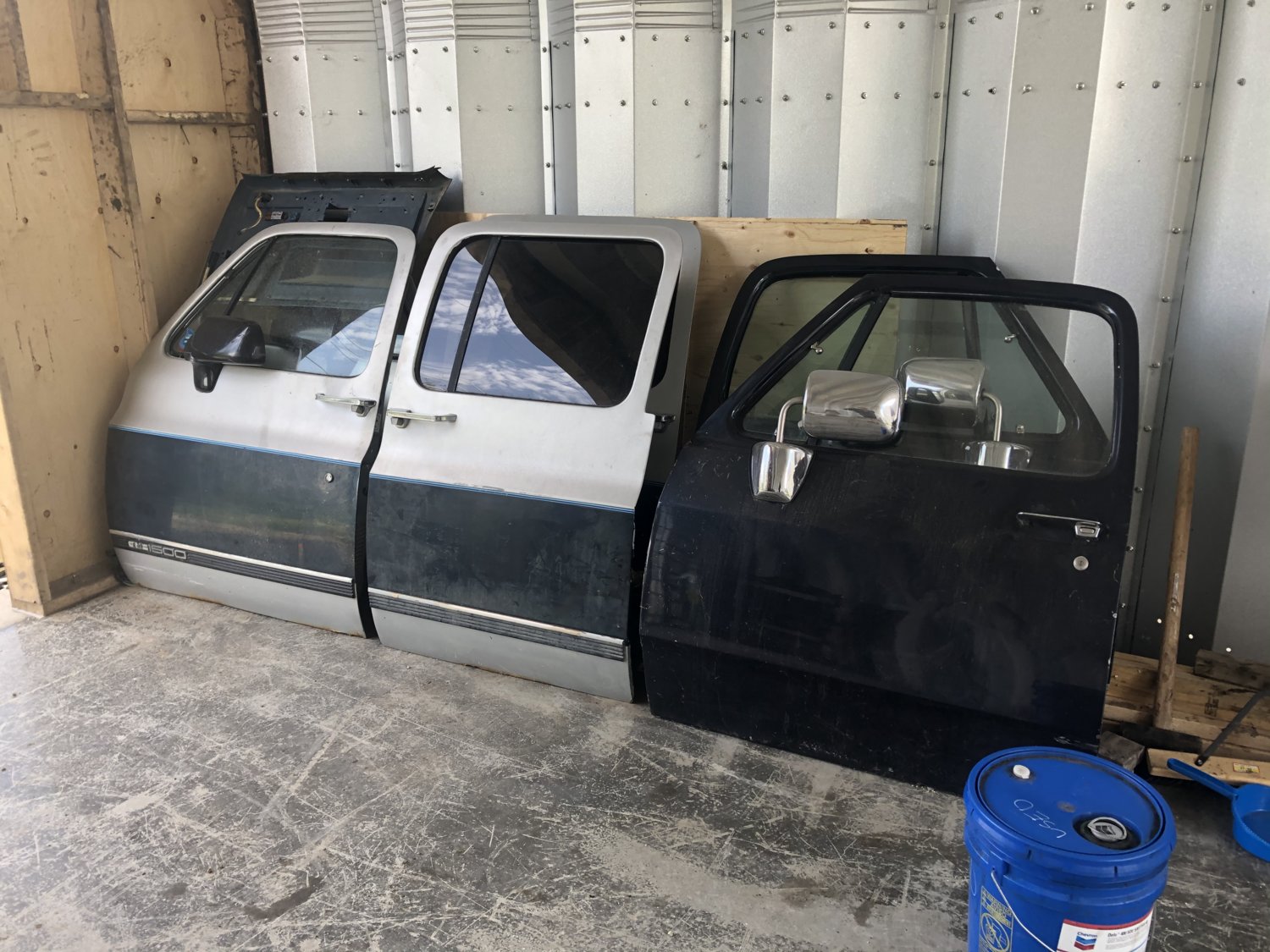

Also seems like a good time to toss on these minty suburban doors I picked up a while back. Power everything, blue interior panels but I’m not too concerned about that right now. Gonna be a shame to toss the original doors in the scrap metal bin, but they’re pretty shot. Can see the speaker through the driver’s door, haha
