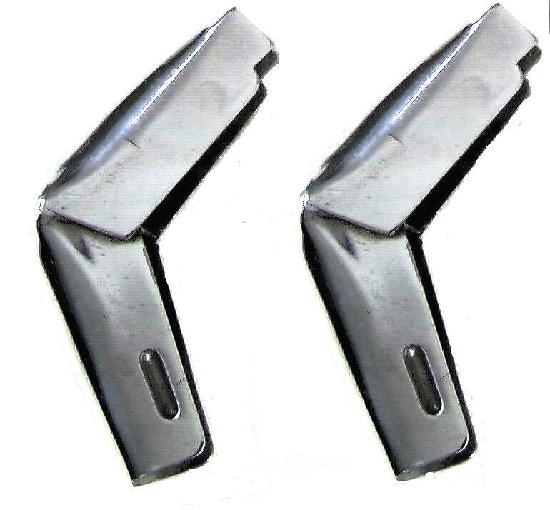

I use these.
My plug boots after after about 9 months to a year would get sparkly dry and brittle and Crack and make it run like crap. It has been 2 years on these and I just changed plug wires since I pulled a couple clips off removing the wires. Boots were fine, I just reused the covers on the new wires.
Saw these on Mrk5's rig
