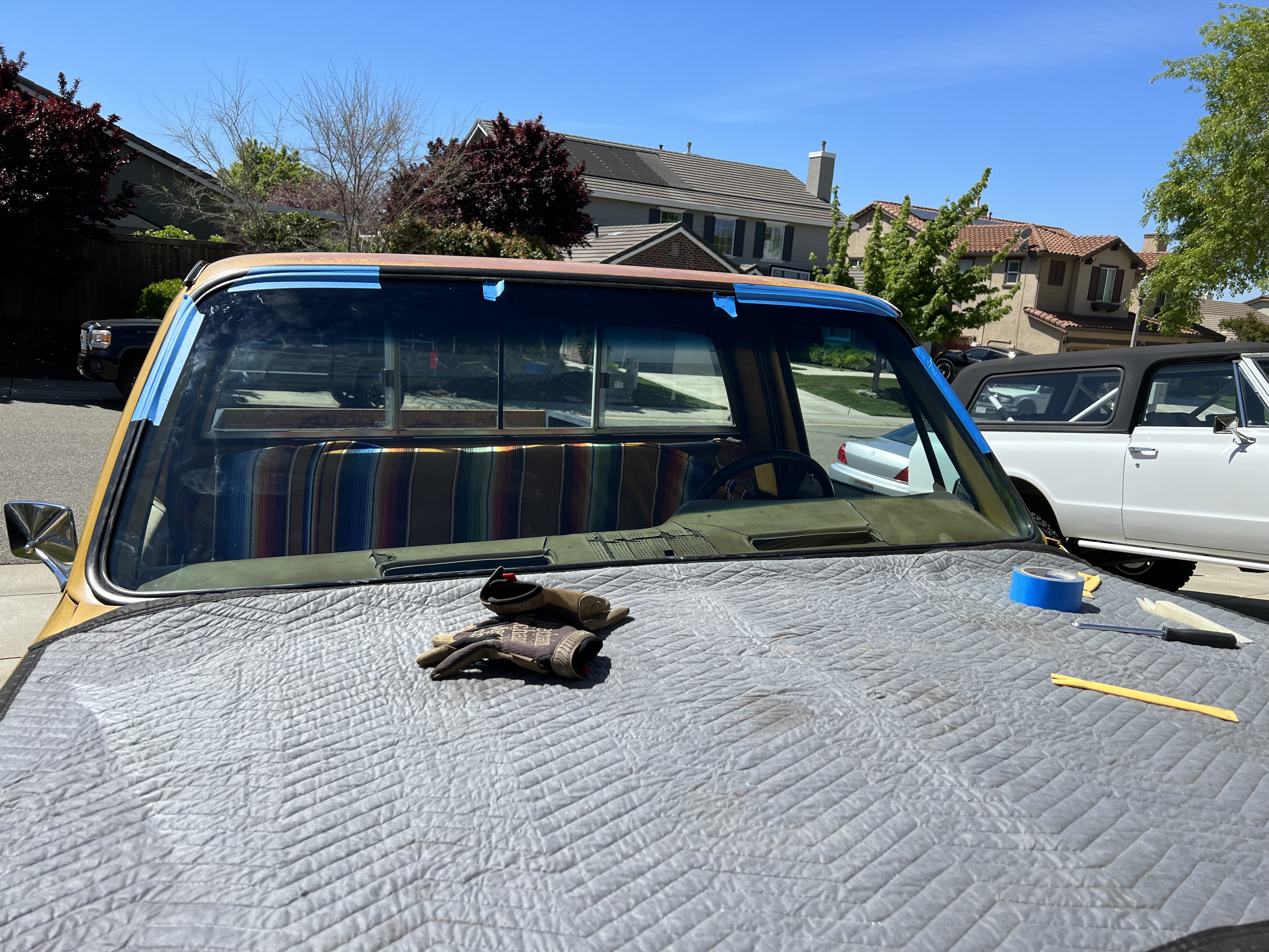

damn, it's bee a year since this thread has been updated. I finally put a new windshield in it, with a new precision seal and chrome locking strip. The dash is starting to bother me now.....

I have been told by my glass guy that he won’t install one unless it’s a gm seal. Which is not happening.
How do you feel like the quality of the precision seal compares to oem?
My glass guy won't install the glass in these trucks regardless of the seal used. I can't say I've used an OE seal unless the seal I reused on my other trucks was OE. It wasn't too bad but you have to take your time and use a liberal amount of window cleaner when installing the glass into the seal and the lock strip. I was able to handle it by myself too.
The glass guy said to use WD40 on the seal but I didn't want that shit all over my truck.
I'm using precision seals in everything and they windshield fits just as good as the OEM I have to cut out. I even have an independent dealer for precision down the road from me that keeps everything for a squarebody in stock.
