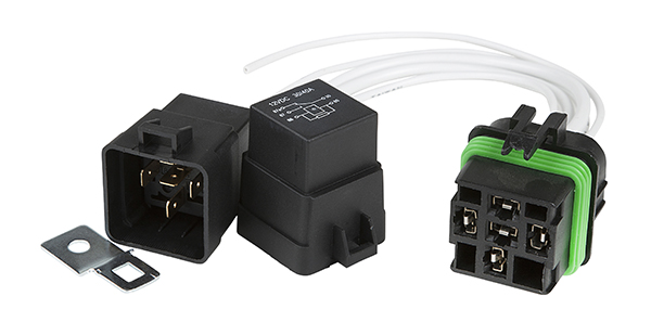

The easiest would be to run a single switched ignition wire to control a relay since it can handle a higher amperage draw and then run a 12 or 10 gauge wire from the relay to a buss bar. That way you essentially turn a single low amperage switched 12v wire into a higher amperage relay controlled circuit that can then provide multiple 12v switched feeds off of the buss bar. Make sure to fuse it all starting with the main feed off the battery. You could use a fuse block instead of a buss bar so that all your outputs circuits are fused. Make sure to use a good quality relay and carry a spare or a jumper wire to bypass it so you don't lose all the circuits if the relay fails. I like the weatherproof ones like this. Many manufacturers make them. This is just an example. https://www.grote.com/products/84-1080-5-pin-relay-and-pigtail/
