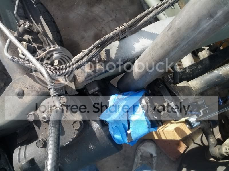

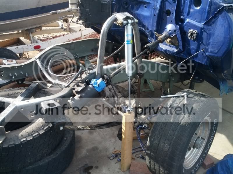

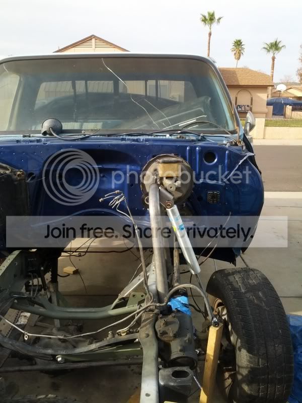

seems to me I think the shock hoops will work... I'll let you guys be the judge..
The hoops will have to be vertical and laid right up against the frame. Will that be a issue? It's also just a smudge off the gear box, and will require a fancy frame spud. Only real problem I see is if the frame twists it could come in contact.

You need the engine and manifolds on before you stand those up like that. Clearance might be an issue.
Is that green grass in winter?
Judging from my pictures and all the other pictures, everything will clear the engine and leave room, it all lays inside the frame.

Take me more pics of that hoop mocked up straight in line with the axle (im mounting my shocks right on top) with the bracket straight out. And take a pic from the front, I wanna see how close you are to the steering shaft. My shocks are way bigger :doah:
Im still gonna run crossover for reasons wade and brian posted in my thread... But I may get those brackets if they will work with my shocks. They look pretty cool.
