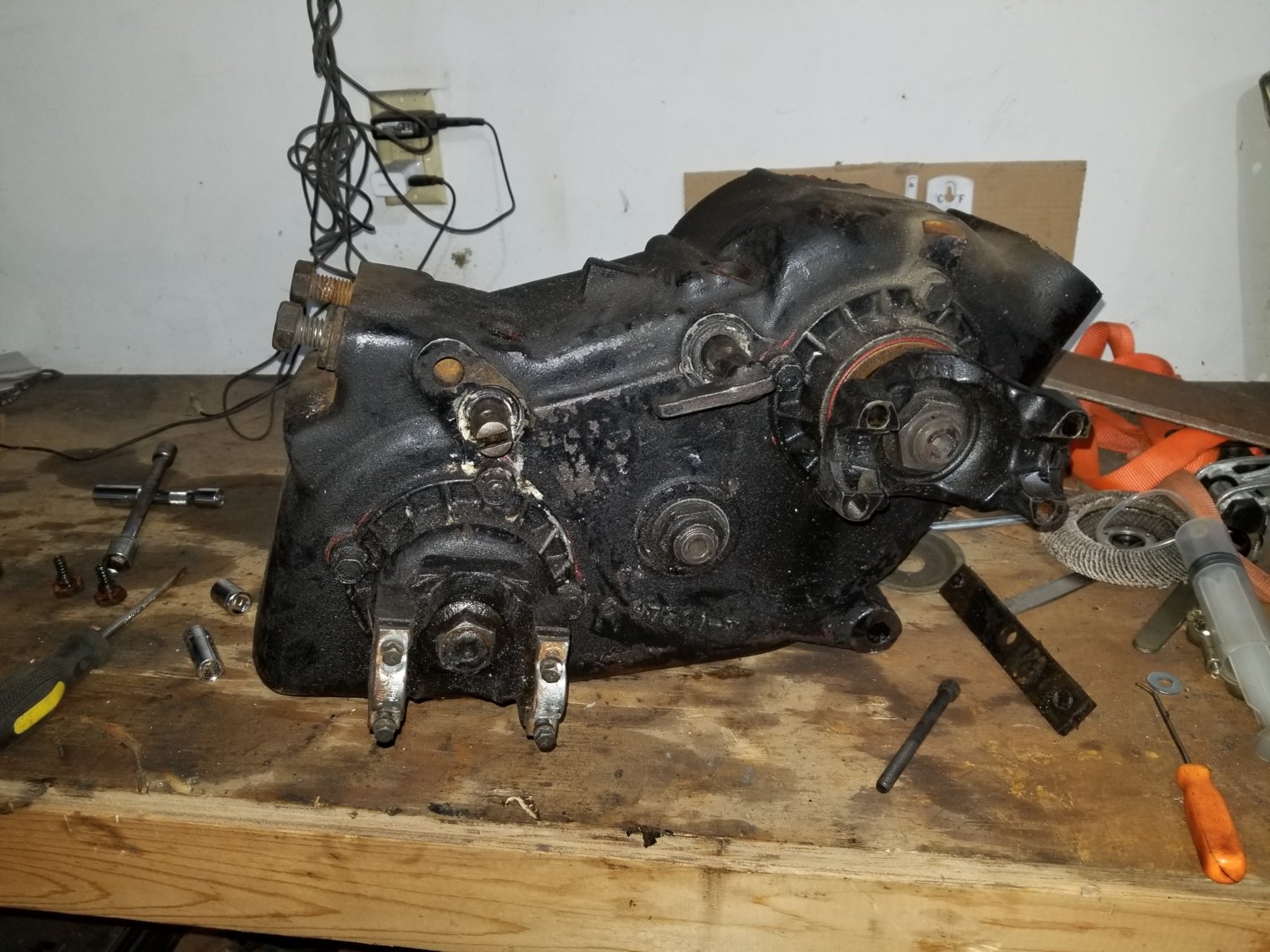

well, put the shifter lever on, and it requires me to put a 2ft pipe on to allow me to shift it. This seems to be an issue... when I refreshed the tcase back when i put it in the truck I never took the shift rails out and havent used 4wd since putting it in. Anyways, i decided to drop the tcase and figure out whats up, why is it so hard to shift? I am still not sure why its so hard to shift seeing i took the ball and spring out and it moves alright. Any advice?

If you look at the stock shifter the ratio of the leverage is high and the bottom section is a couple of inches with the top being a little more than a foot.
Your bottom section is what 6"?
That requires more than 2 feet to compensate.
Since you have a heim and the tcase is further back, if it will clear just shorten the bottom section to as short as possible.

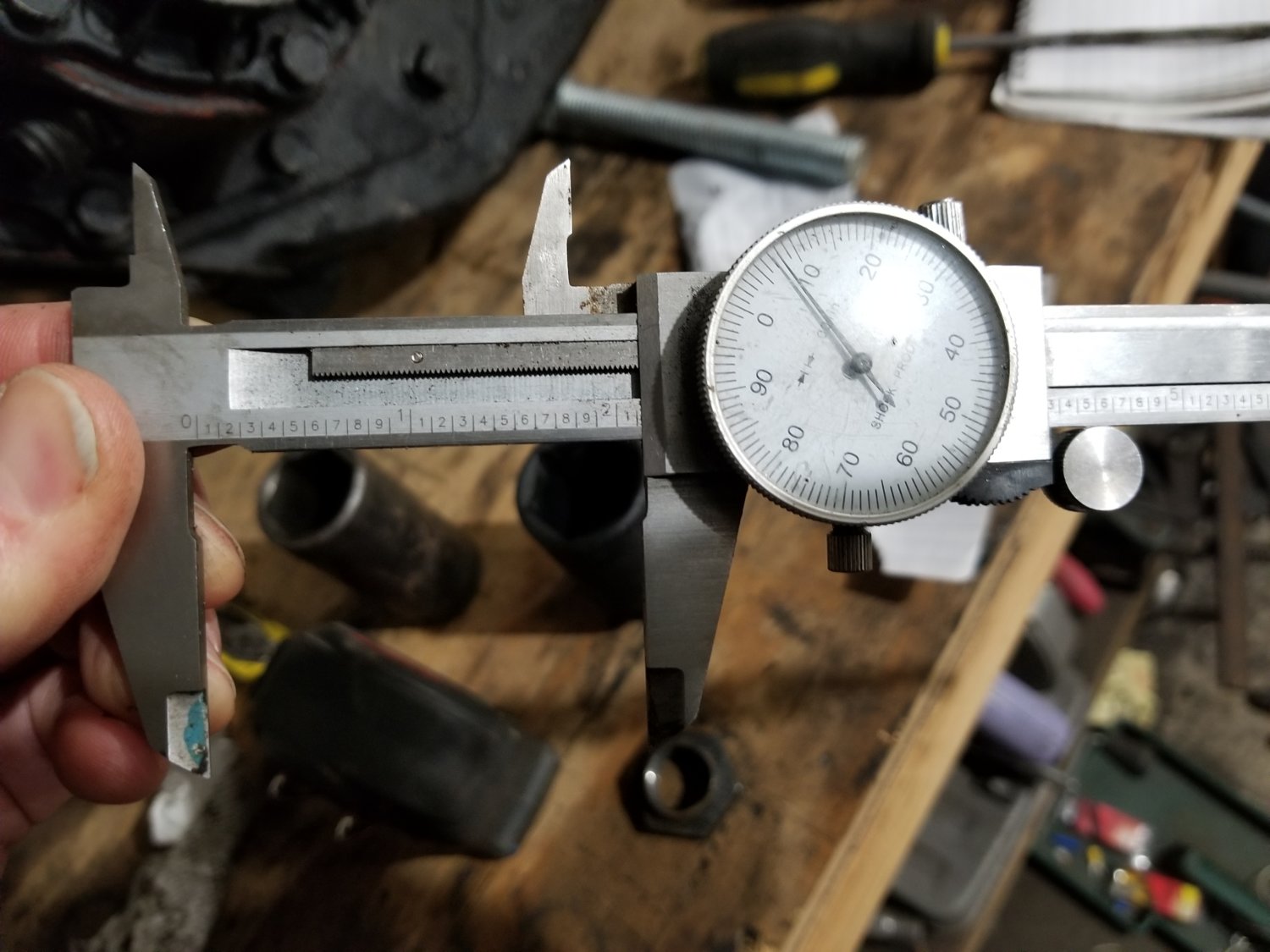

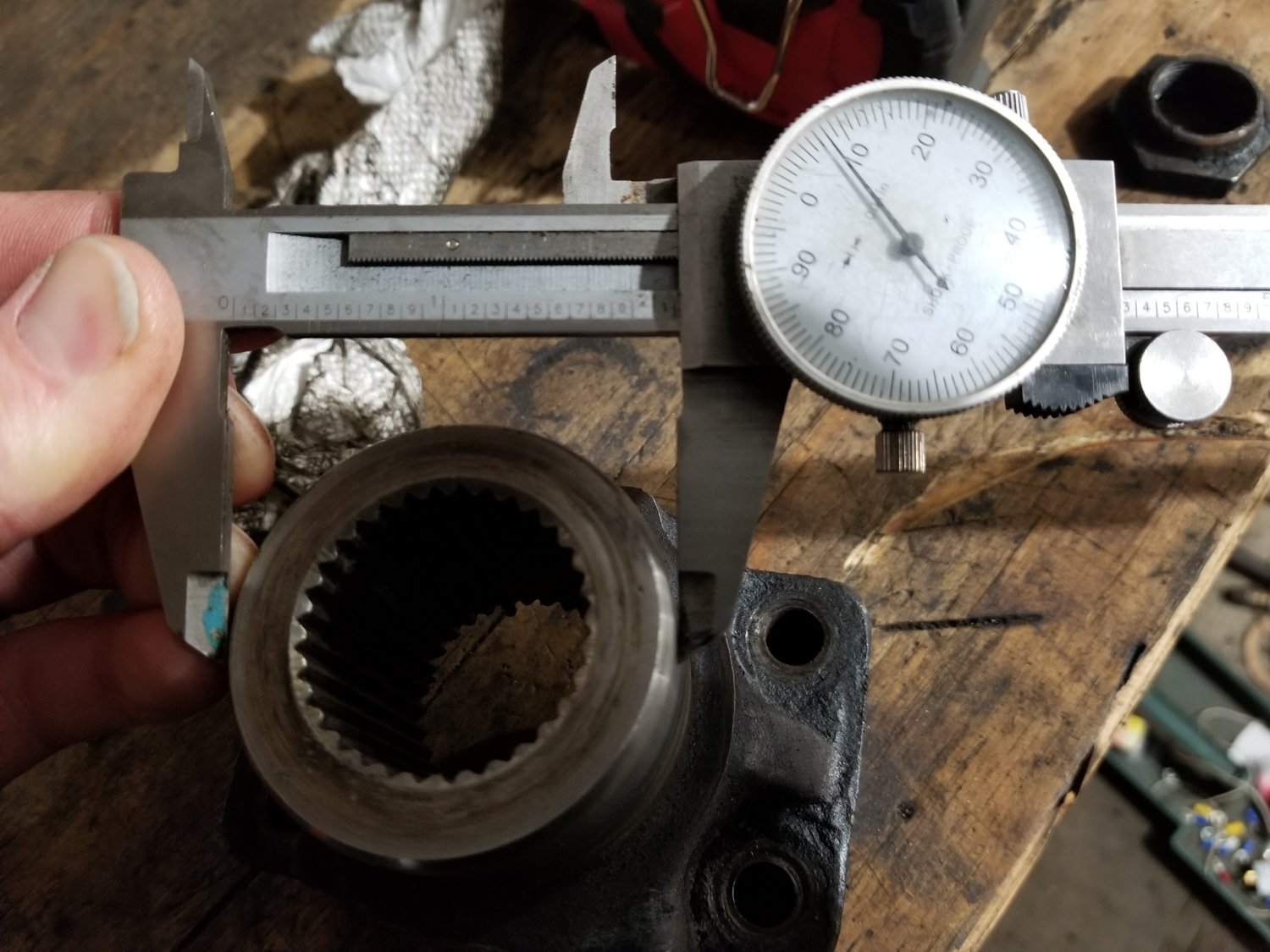

I ended up cutting down the linkage, I also ended up loosening the detent bolt a lil and that seemed to allow it to shift just fine. I am going to put some adjustable tension ones on there. My other problem is when I rebuilt it the yokes had lil groves on the seal area. I cannot for the life of me find a redi-sleeve that is the dimension I need. Anyone know of a good spot to find what I need for a redi-sleeve to stop my yokes from leaking?
I had to look it up for a dodge 205 I think. I remember it being a pain to catalog. Might just have to cruise the catalog by dimension and find which one you want. I have had to do that several times out of probably 100 sleeves.
Is it a 32 spline?
Check with @sweetk30 he had on done and has part numbers

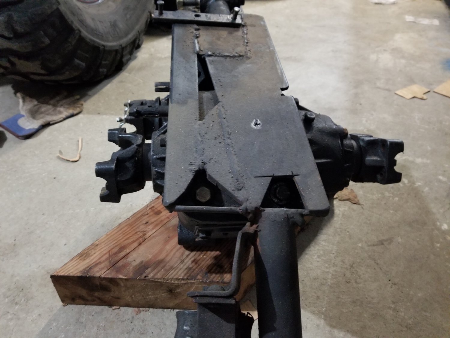

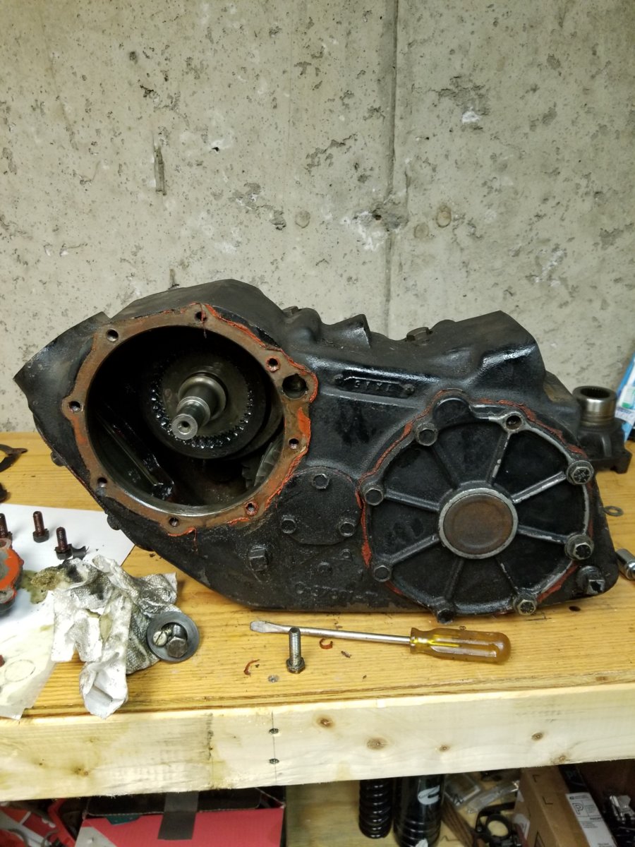

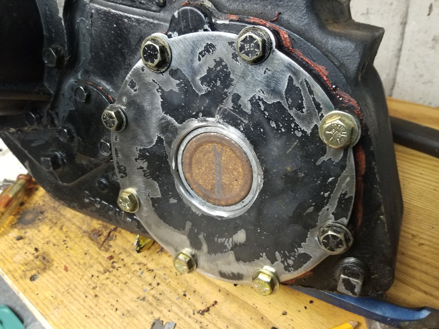

The pace is slow as hell here but more progress, i ended up making a rear mount in solidworks, cut on the plasma table and welded up. It should be good for a little extra bracing. New seals and gasket kit while i had it on the bench.
Gonna toss it back in this weekend i hope.
