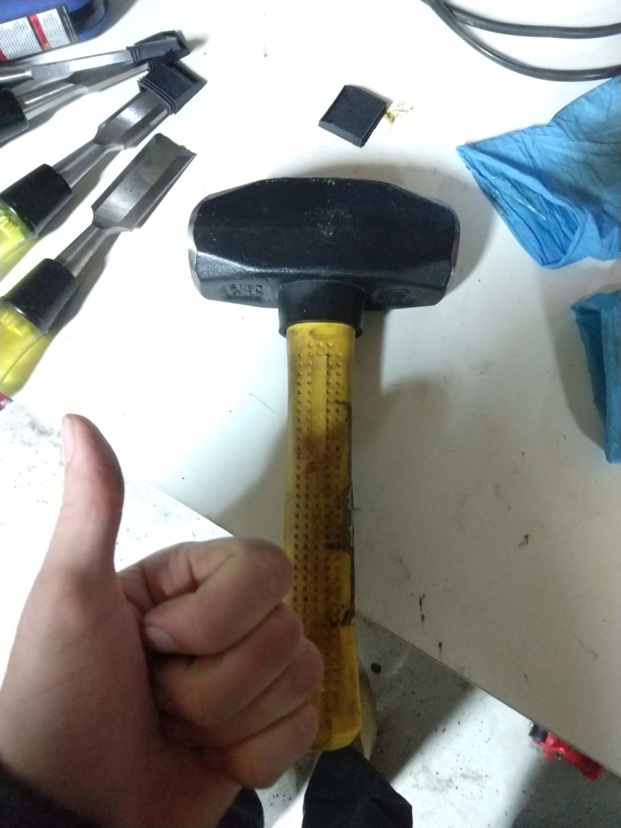

First off, I listened to @Capt Ron and got a much bigger hammer and also some new chisels...

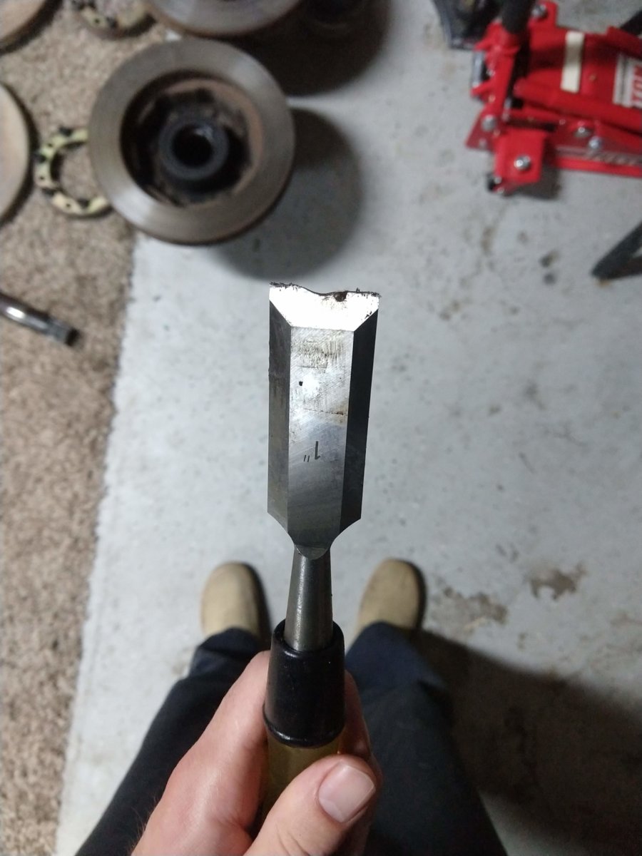

The main chisel I used got beak up pretty quick...

Those are wood working chisels. Not what you want.
You need some metal chisels.

Crap that is expensive. I guess it makes sense though.
If we ever get let out of our boxes again, look for chisels at the pawn or the flea market
Snap on, matco, mac, Cornwall
the ones they sell at the box stores are disposable
