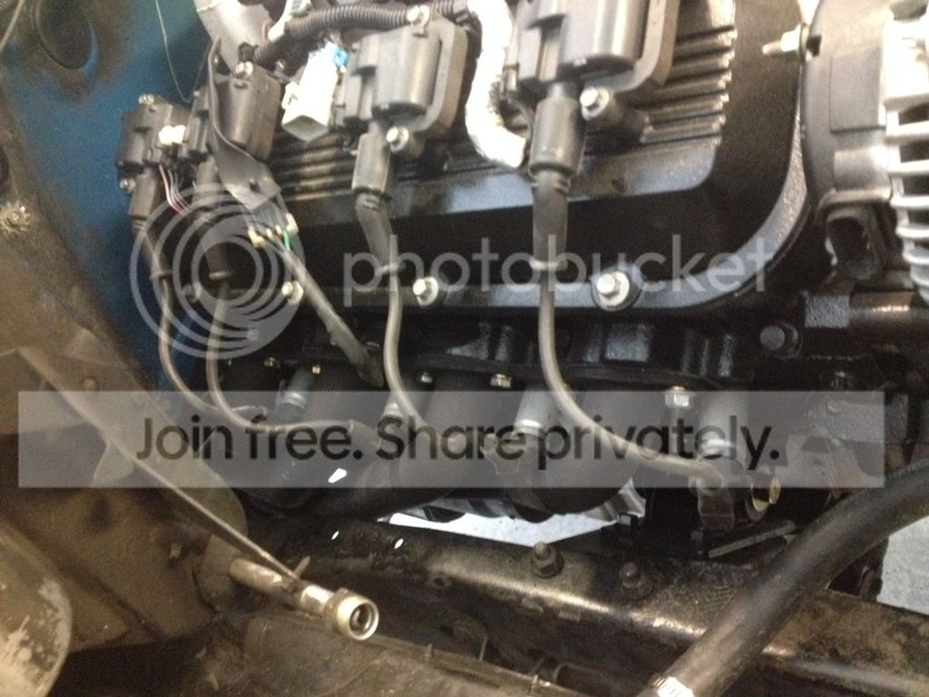

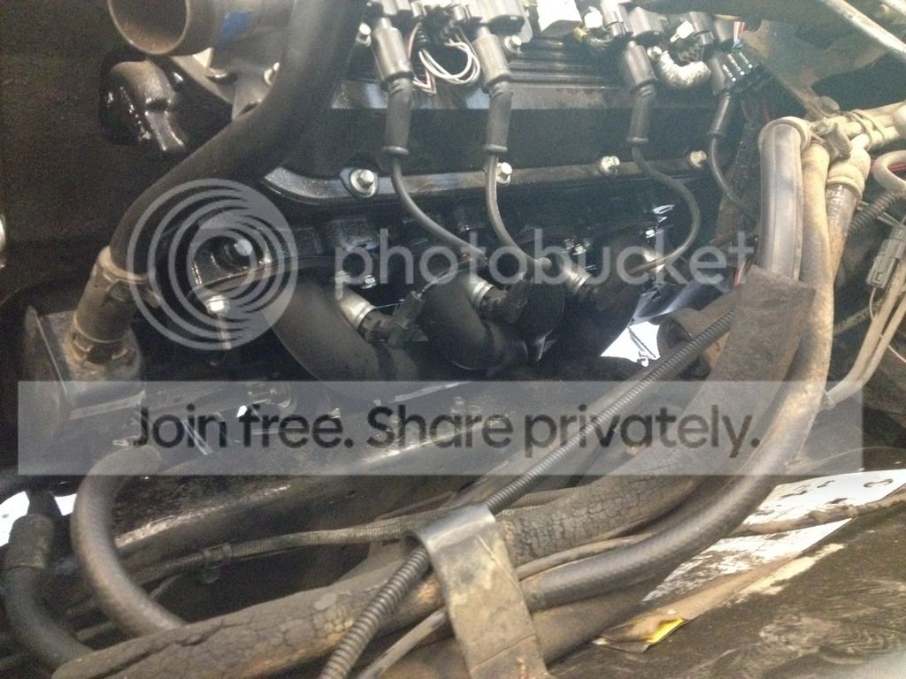

Got my headers installed. Went with mid-length Headman Headers. They seem to work pretty well and fit pretty good. I just went with a mid-80's BBC header (as they fit on the 8.1 just fine) and will add some O2 sensors to the little extension to weld the exhaust tubing to (was included with the headers) that comes off the header when I get those. I also installed my coil packs and new plug wires

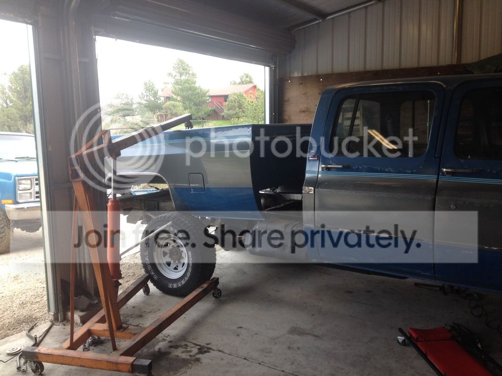

I then started on the fuel system. This is how I moved the bed back to get access to the pumps

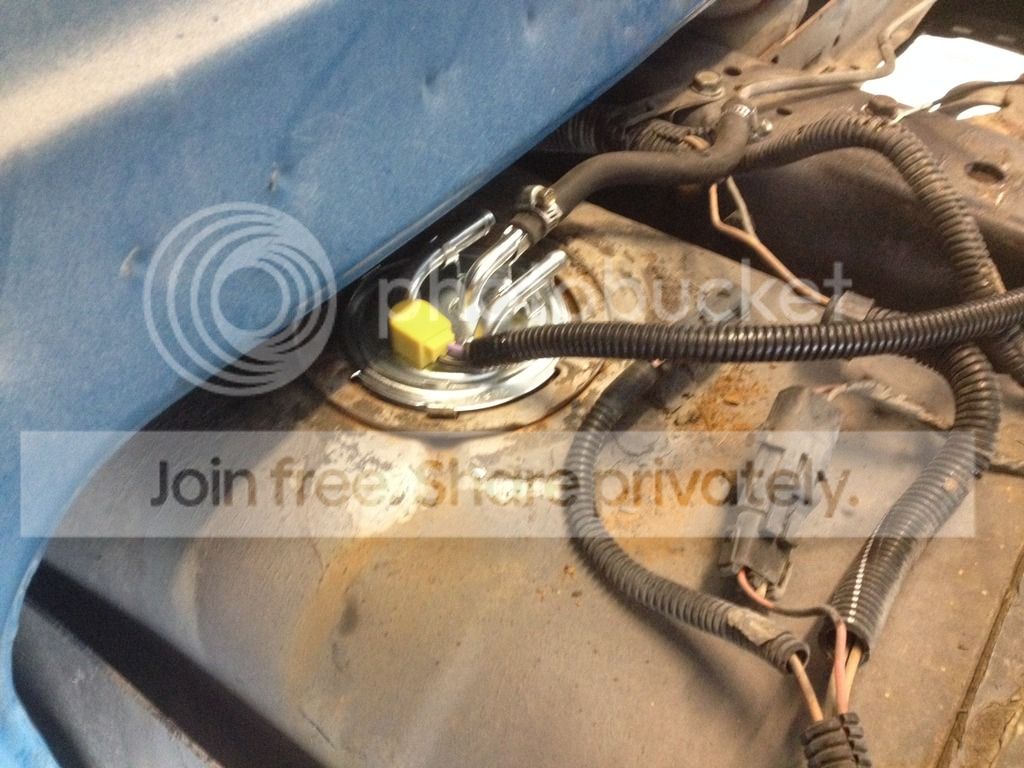

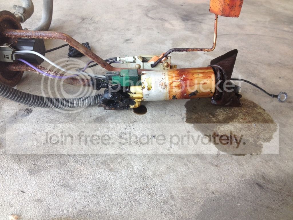

I now realized why the passenger tank wasn't working :eek:. The pump was completely burnt up and the intermediate hose was completely gone

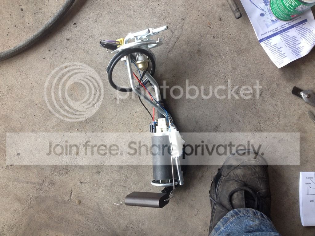

So, I decided I would get a brand new sending unit for the driver tank (as this is going to be my main tank that feeds the motor) and also installed my new EP381 fuel pump. These pumps are for the 1997 Tahoes with the vortecs. They put out the necessary ~60 psi but have the same dimensions and fit inside the hanger of the TBI sending units

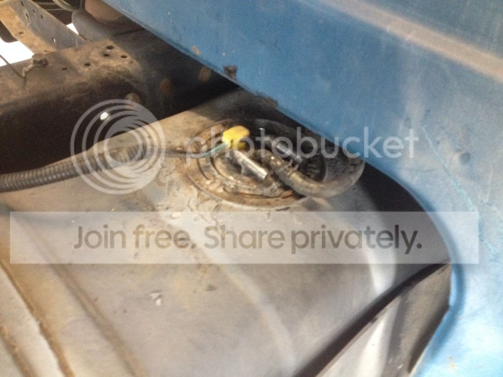

New sending unit/pump installed into driver tank (yes I put a new screen on the pump before installing...the pic above doesn't show that)
Since the crap pump/sending unit pictured above wasn't really up to par, I decided to take the good used sending unit I pulled out of the driver tank, and I know that pump was working cause that's the tank I was driving on before pulling the motor, and I threw that whole pump/sending unit into the passenger tank
And yes the ports are facing the opposite way on purpose cause that was the only way to get it installed (these sending units are side specific on the dual tanks). But I really don't care cause I'm using this passenger tank as a storage tank. I'm going to run a line from the passenger tank feed line to the driver tank, and then hook up a little toggle switch inside the cab that will turn on the fuel pump and transfer fuel from the passenger to the driver. This way I can keep duel tanks and have more fuel capacity if need be. Haven't run the line to the driver tank yet, but when I do I'll take pics of it

are you concerned with the plug wires burning up being that close to the headers?
I like the fuel "storage" idea.
Yes, I'm actually thinking the plug wires will burn up the way they are right now, but it will do for now. I've seen a couple places who make the plug wires specific for running headers, so I'll probably get some later on down the road. But at least I'll be able to start it up with those when I get to that point :D
