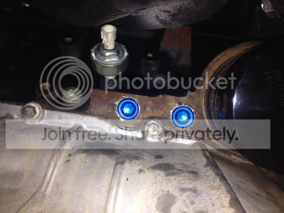

First off, I removed the factory oil cooler. Read of a few guys who just ditched them during a swap and never had issues with it at all. I'll just always run a full synthetic oil in this motor at all times. So drained the oil too and put a new filter on it to get ready for a first fire up. I plugged these with just normal 1/2" NPT plugs

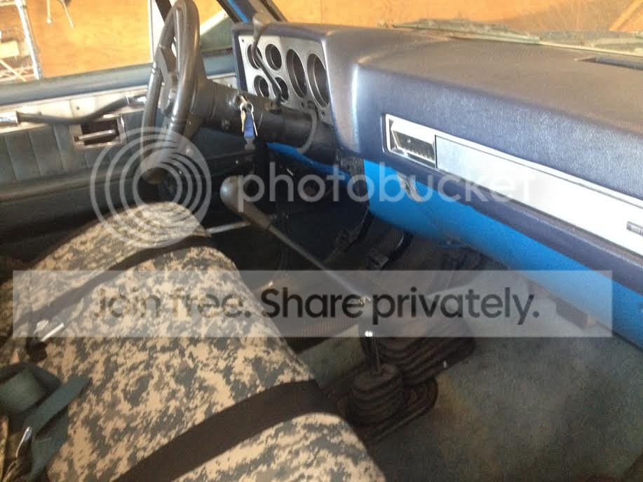

I also topped off the fluid in my NV4500 and finally bolted both shifter boot's/bezels down for good. I had to modify the tcase bezels a little so it could bolt down in the factory location since the shifter on the NV4500 is further back than a SM465, but wasn't a big deal (I still need to remove the auto shifter from the column, just haven't done it yet)

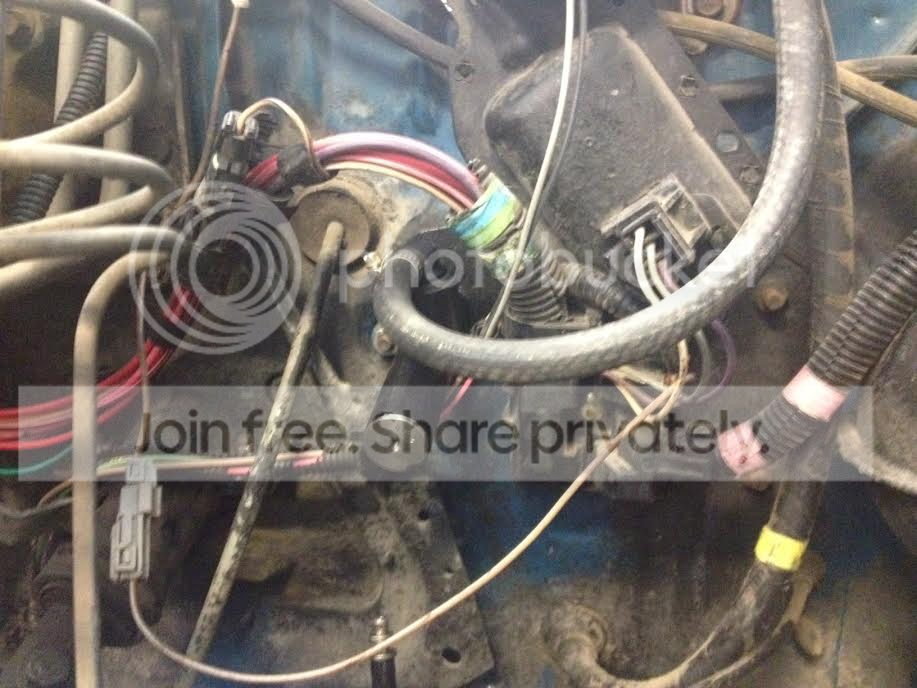

I also cut the whole in the firewall to mount my new master cylinder. Just used a normal whole saw and made a little cardboard template to use as a guide...worked really good

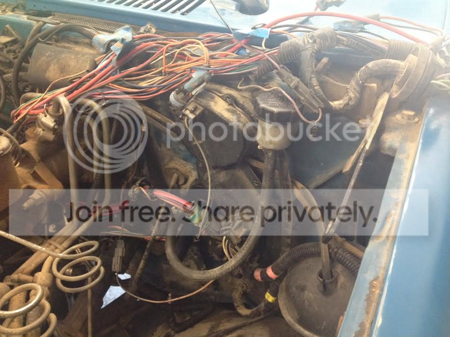

This is where I mounted my master cylinder reservoir for right now, may change it later on, but will work fine for now (please ignore all the wires in this pic, haha. That's all the TBI harness still in the rig, once I install my new wiring harness and get my gauges working, I'll remove about 95% of that to keep it intact with the TBI350 I pulled out of this thing, since we have some plans to use that motor for other projects)

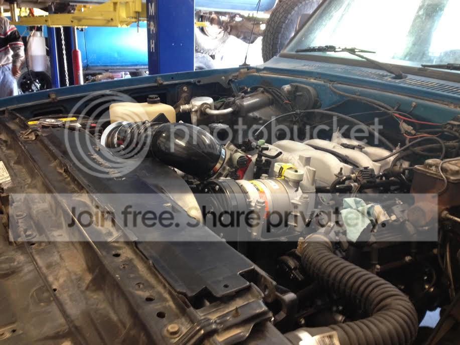

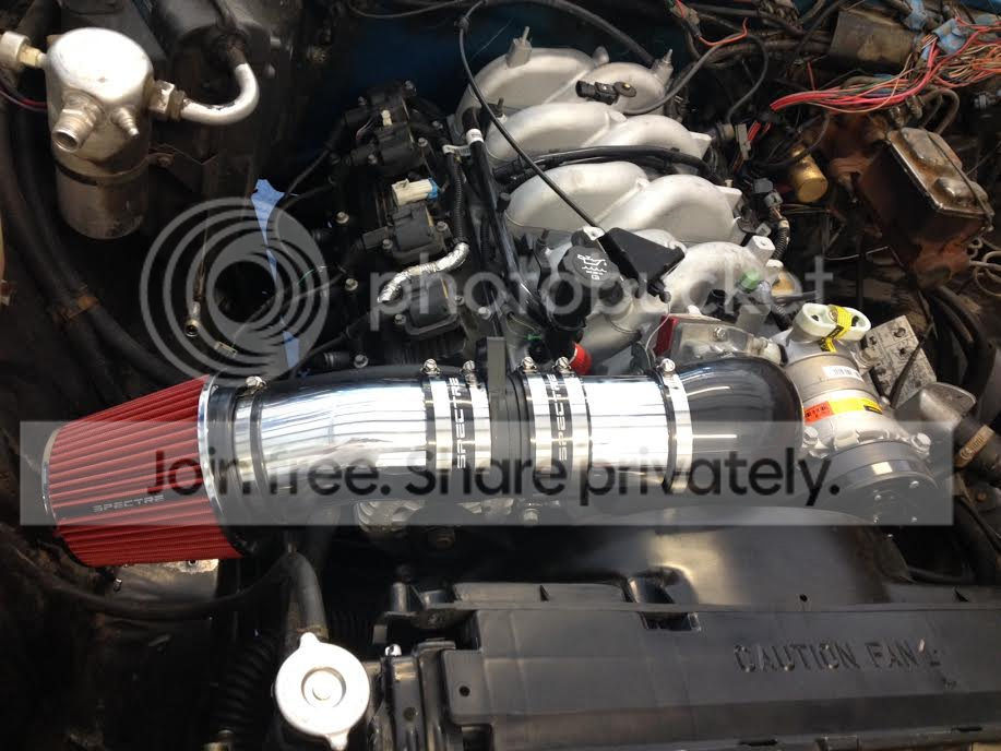

And I got my air intake setup put together. Just pieced together some stuff I purchased from Spectra Performance. I think it turned out really good. I need to either purchase or make up some sort of mount to attach in the middle of the air intake and probably mount to the alternator somewhere just so it's not flapping around, but that will be easy and this will do for initial start up
I also attached my upper and lower radiator hoses and filled up the cooling system, so that's all done. And I got my throttle cable pretty much done. I purchased a cable and bracket off a 1997 5.7 vortec truck, and it fits really good. I just need to modify just a little bit the bracket to mount to the intake, but that's no big deal really.
