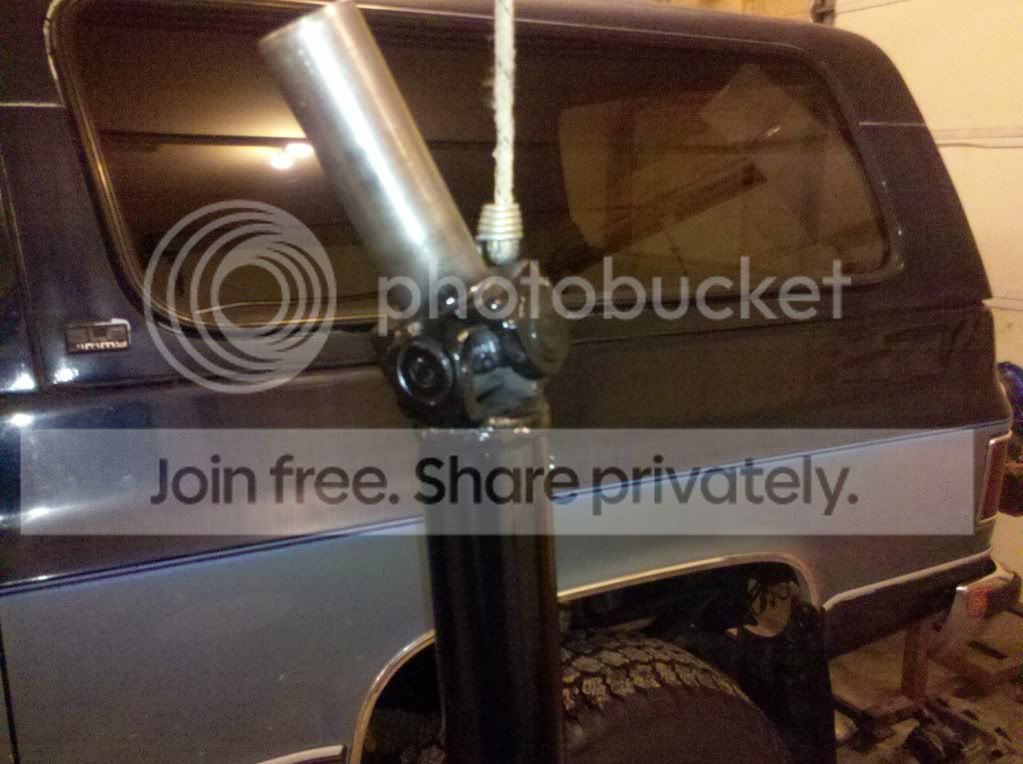

The modified driveshaft, going to probably have to pull the shims out of the rear axle to keep if from vibrating, these are the remnants of a cool cv driveshaft that was broken, I will be getting a SYE soon so I wanted to spend as little as possible

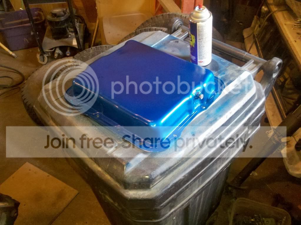

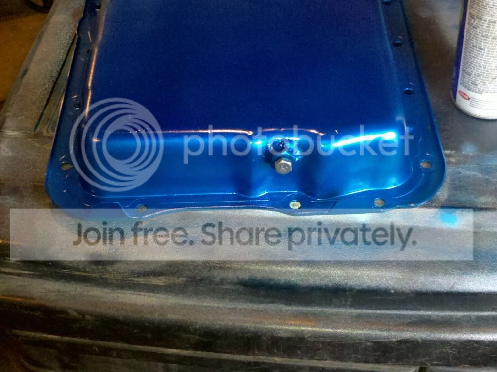

Transmission pan, welded a drain plug in it

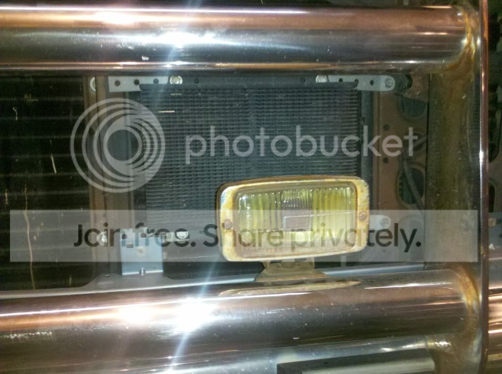

As far as the trans cooler goes here ya go
Well that looks old you say. Well yes it does. I didn't' even look to see if the PO had mounted one up. I have run cleaners through the trans lines so I think I will just stay with the one that is mounted up
