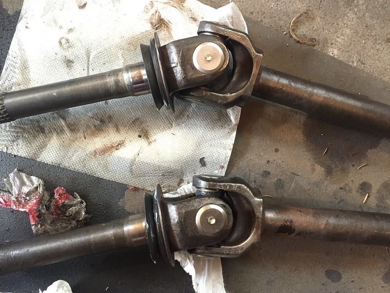

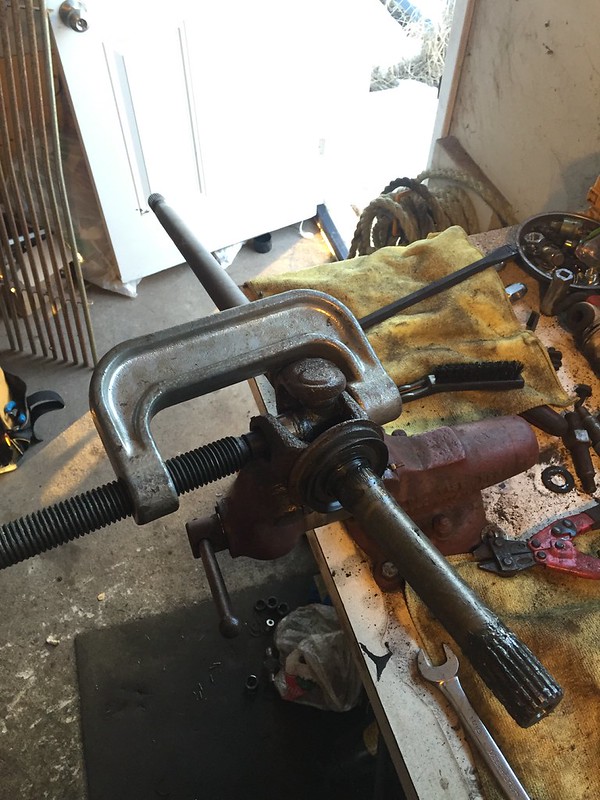

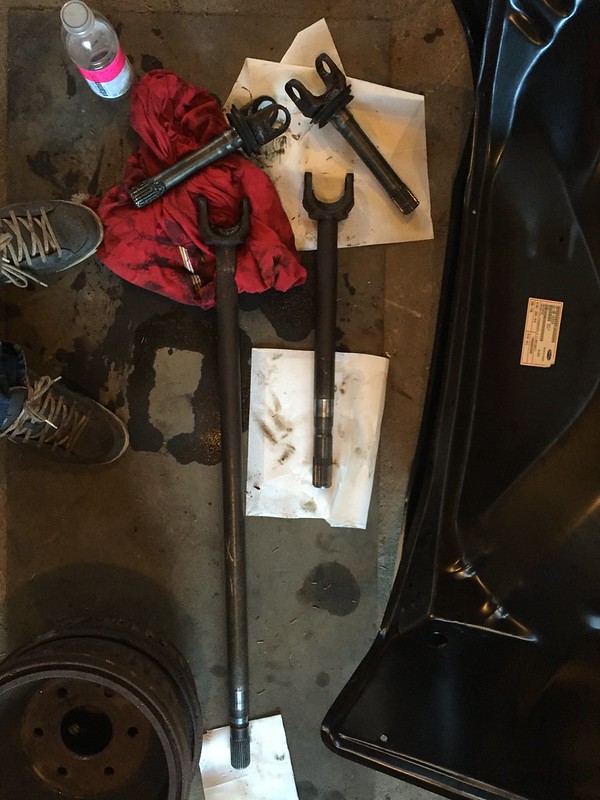

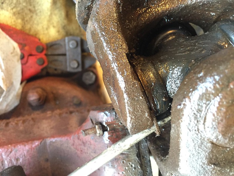

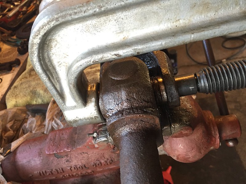

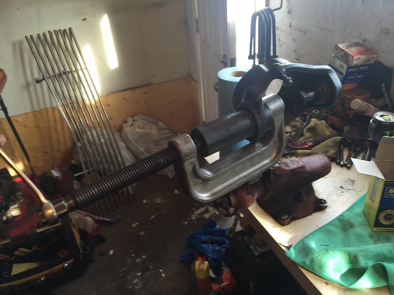

I did manage to remove the u joints in the front axle shafts since i am re-using them, also curious about replacing the two plastic seals, on the outer axle shafts. I figured i should but they do seem in great shape?
The inner clips did come out easily, Luckily i had done this when i first got it so they joints are not terribly old or worn. Brand new MOOG super strengths are going in.
IMG_7888 by Nick Smith, on Flickr

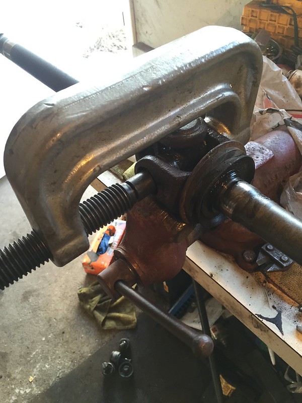

It was the first time ever doing u joints, and ball joints with a press. It is worth its weight, in gold:bow:
IMG_7889 by Nick Smith, on Flickr

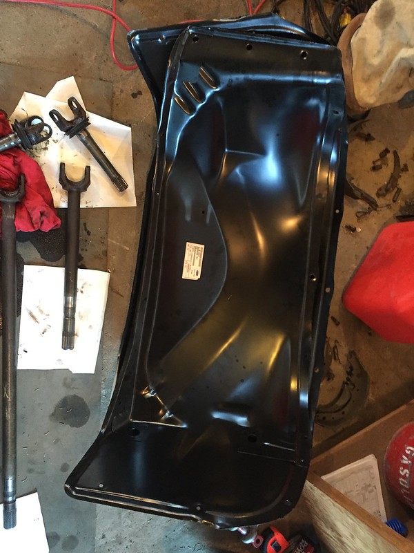

Glad to have these black inner fenders waiting for install.

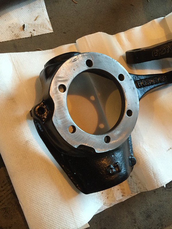

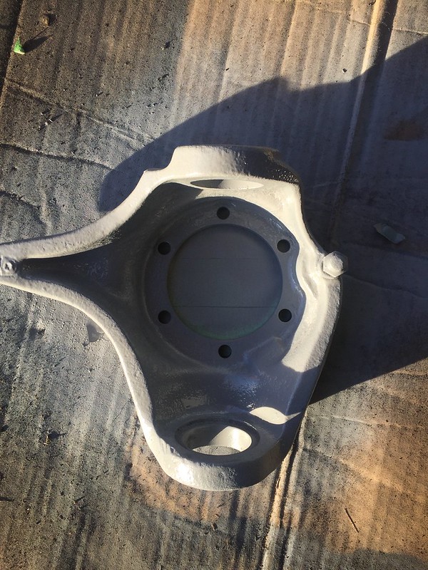

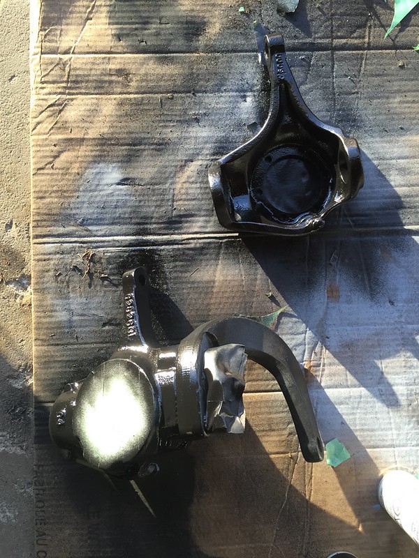

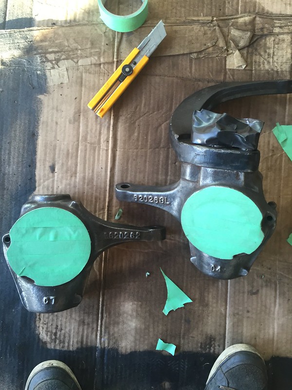

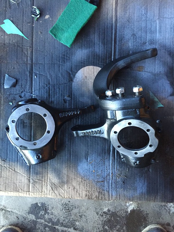

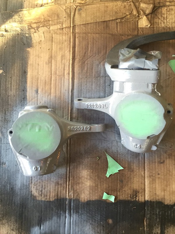

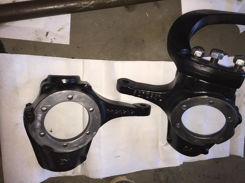

I got the knuckles wire brushed down. I also used a 80 grit sanding disk to get the mounting surface nice and rust free and smooth again. I applied two coats of primer ( duplicolor sealer and primer ), and used two coats of duplicolor satin black on the knuckles.

Once they dried i took the tape off, and i scuffed them a bit with a green bristle pad. Some paint, and crap had seeped in through the tape.

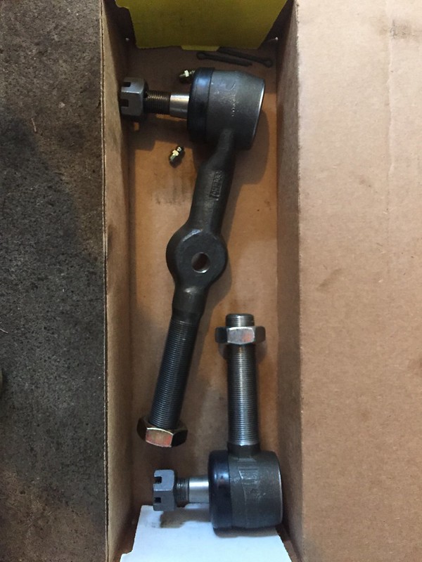

U joints, ball joints, and tie rod ends. Nothing that exciting , but still parts!

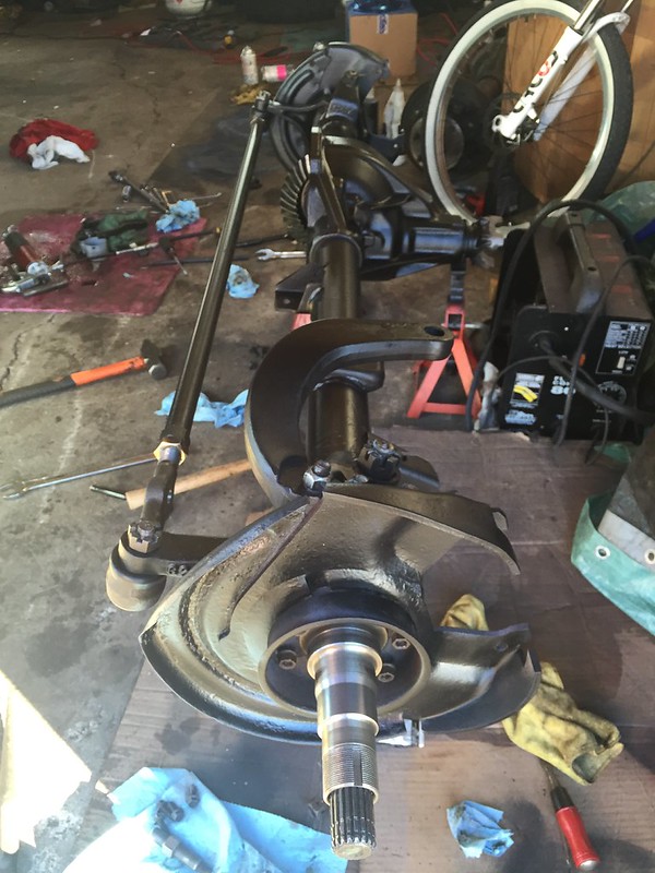

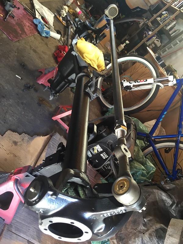

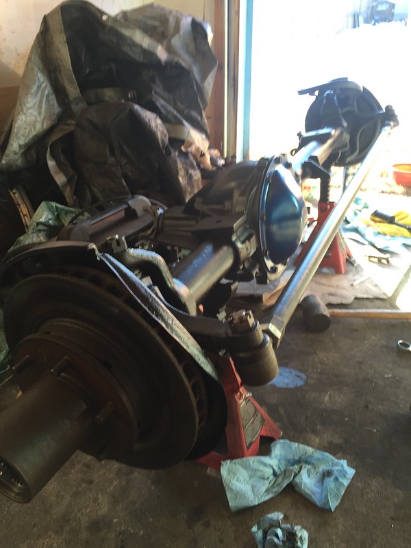

Today i got up nice and early, picked up both axles, and started to get the work done on this front axle. I had quite a bit to do still. It was completely taken apart i just had parts to clean and rebuild. They also replaced the pinion yoke aswell.. maybe that explains the extra gouging on the price..:angry1: i was just happy to get them back and i can finally get this front axle done..

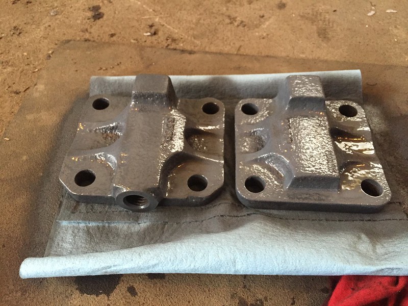

As i started getting to work on the u joints in the axle shafts i primed the ten bolt cover and the u bolt plates for the front. I may switch them out with new ones i have in the rear since they will be useless once my 14bolt goes in.. I have measured, but it only makes sense the ten bolt front and rear would be the same..?

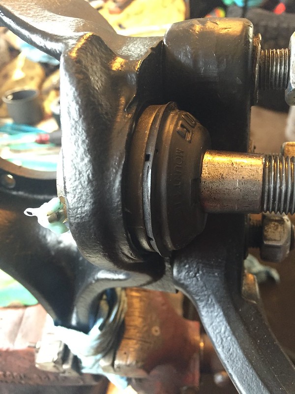

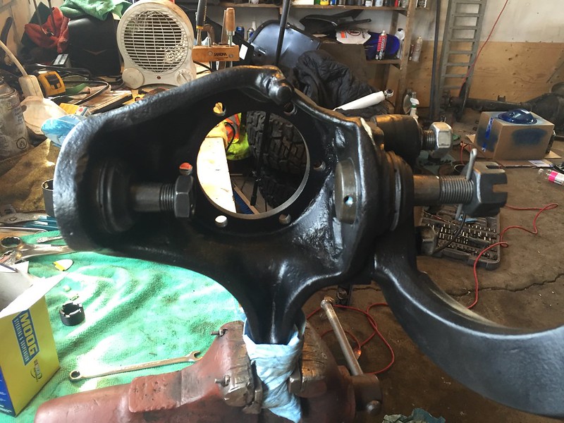

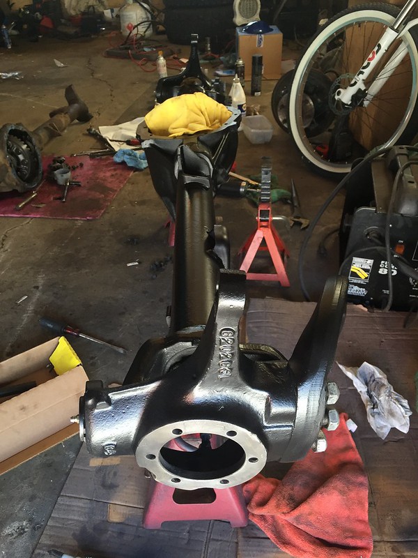

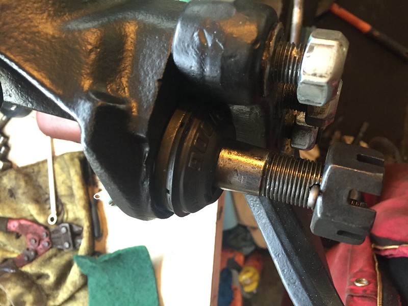

Then i got the ball joints in. The dust boots that are on these moog ones, are really tight fitting, and i can't see them coming all loose like some of the others I've had.

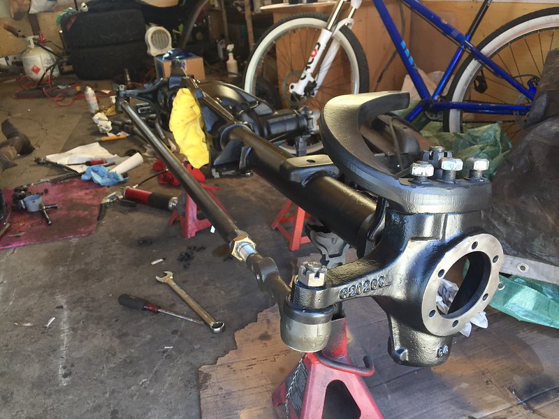

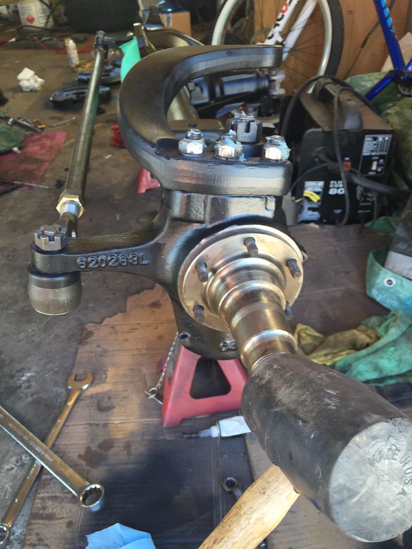

Moved on to the tie rods once i got the knuckles on and loosely tightened up. The beefier tie rod will be nice to have... even though the ten bolt will probably break before it does..:doah:

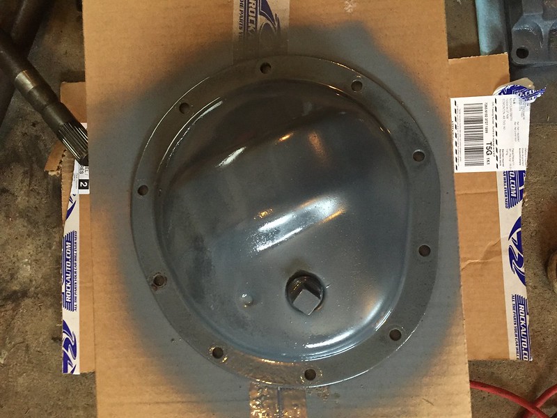

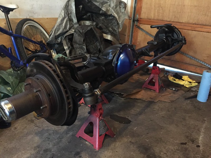

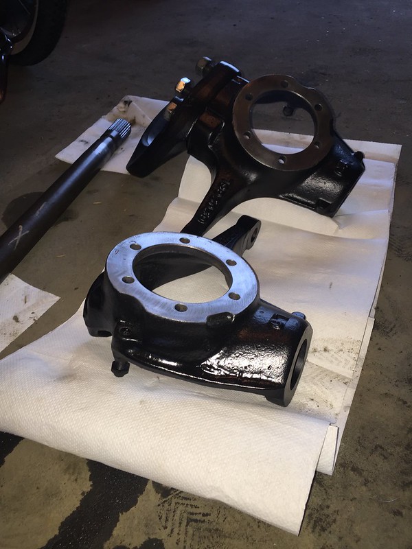

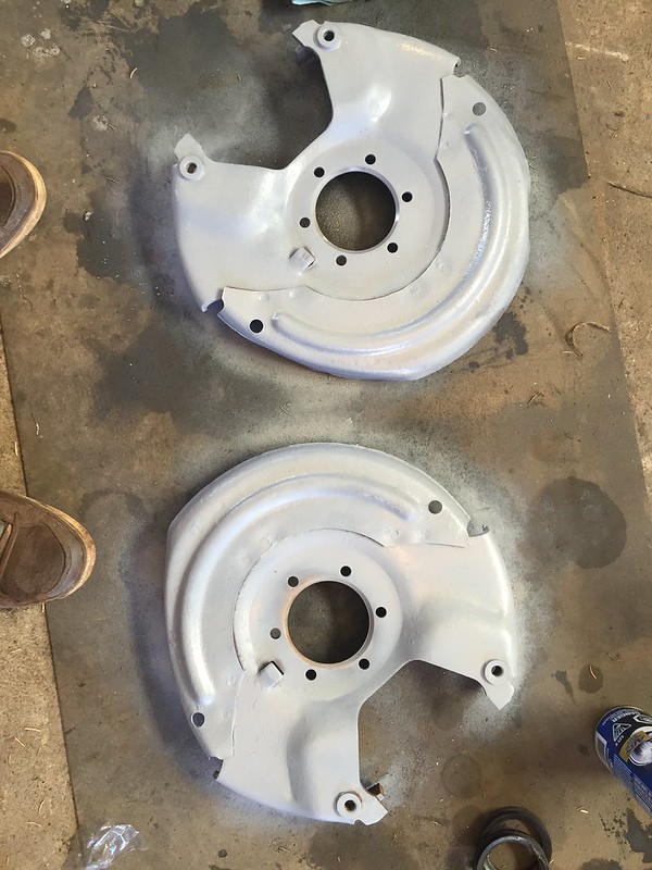

I grinned, primed, and painted the caliber plate holders afterwards..And i also painted the diff cover... and while i was waiting for those to dry, i started getting the spindles back on to the knuckles..
IMG_7982 by Nick Smith, on Flickr
IMG_7984 by Nick Smith, on Flickr
IMG_7987 by Nick Smith, on Flickr
Once the parts were done drying i put them on..
IMG_7991 by Nick Smith, on Flickr

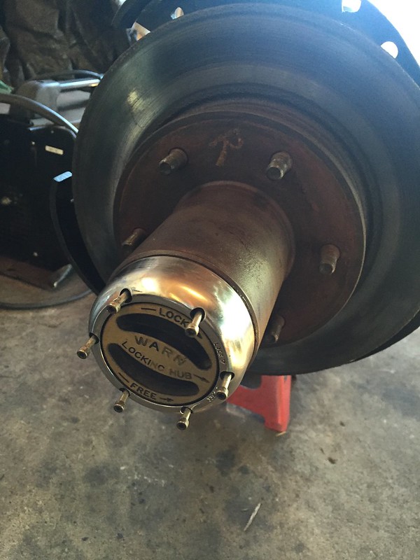

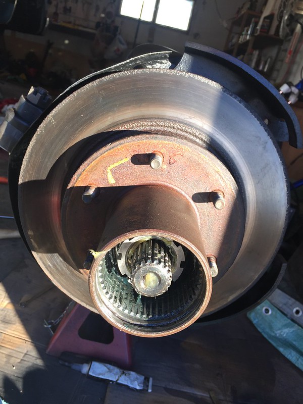

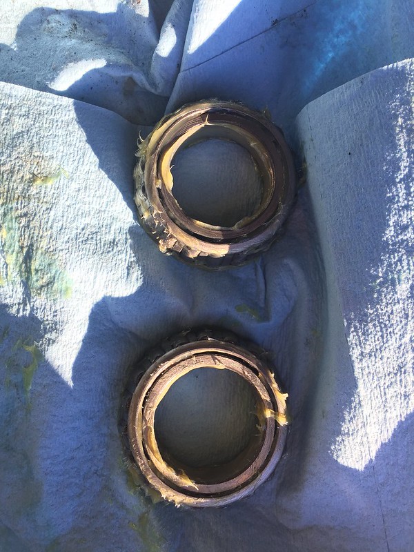

Rotors, wheel bearings and hubs were next... wheel bearings looked mint inside, repacked with grease, and put back in.
IMG_7996 by Nick Smith, on Flickr
IMG_7997 by Nick Smith, on Flickr
IMG_8005 by Nick Smith, on Flickr
IMG_8003 by Nick Smith, on Flickr
IMG_8006 by Nick Smith, on Flickr
IMG_8008 by Nick Smith, on Flickr
New rotors were not in the budget.. but at lease these ones were good shape besides the rust...

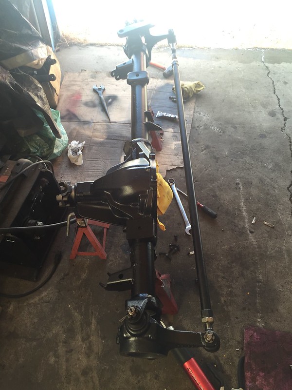

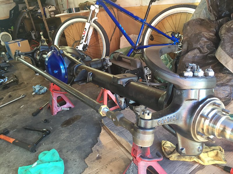

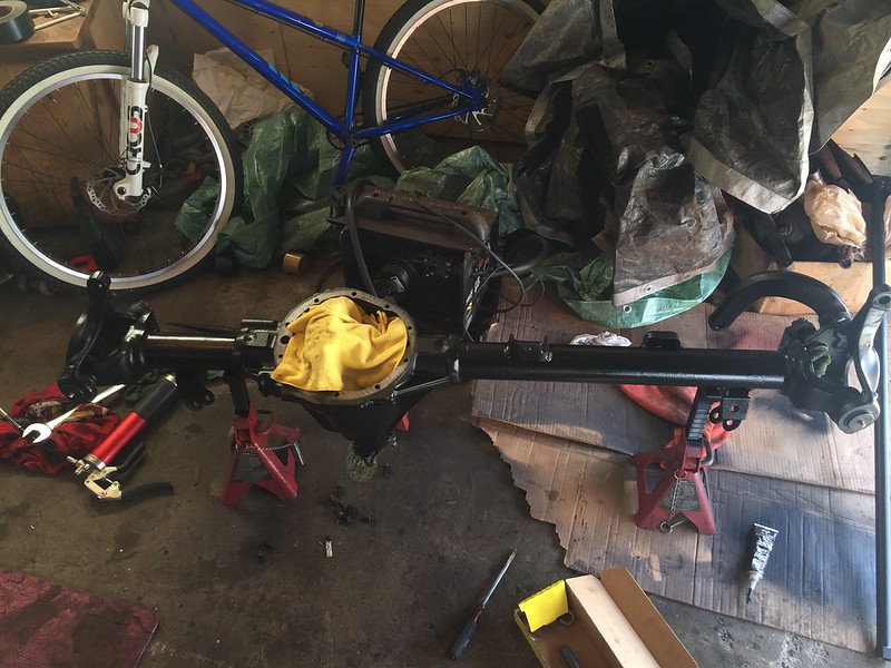

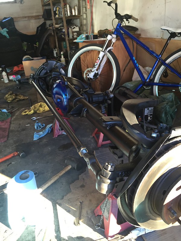

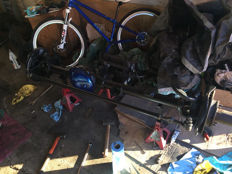

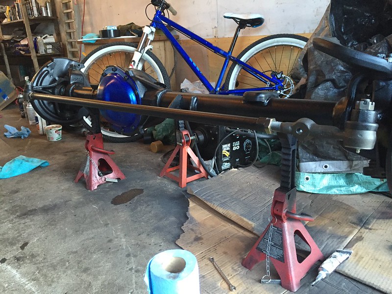

The hole in the new tie rod doesn't fit the new stabilizer bolt that came with it, so i may drill it out another 1/8 of an inch or see if the one from the previous tie rod will fit. Tomorrow i will hopefully get it under the truck, the u bolts tightened, front driveshaft u joints changed, and fluid added. I wish i would have put this back together under the truck because of how heavy it is now..:doah:And then i can start to drop the rear axle..
If you're a little gentle a skateboard works pretty good to help skid a diff around, or a transmission...just saying.
Two observations...1) you got yourself a new bike! Looks like a pretty cool cruiser. :waytogo:
2) Nice diff cover, that blue looks amazing. :flipoff7:

No skateboard for me, left it in victoria, on my last trip. Eric is going to stop by tomorrow to catch up, so ill swindle him into helping me get it positioned under the truck. haha thanks on the diff cover.. i was there buying primer... it was a tough choice between that and red...:1zhelp:. I was going to paint the tie rod as well.. but figured don't overdo it lol.
And i wish that bike was mine, its my friend Colton's. Its a super light, cool cruiser.

Umm i will probably be getting up around 7-8, as usual. Going to be cleaning up the garage and what not around 8-9 id say. I told Eric he was going to be helping me as to not surprise him, but I'm totally up for some extra hands. It'd be nice to have an experienced set of hands, and i could totally use a hand on getting the toe in properly set. Give me a call in the morning if you decide to stop by!
Were you talking about using the rear u-bolt spring plates on the front axle?
Martin
He has DIY plates in the rear now, all he needs to do is oval the holes a touch to use em on the SF 14 bolt...
