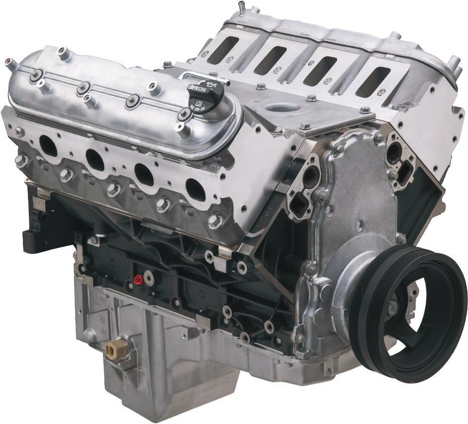

My mind changes daily. I honestly have no real issues with the TBI 350 other than lack of power. I'm inclined to put a small cam in it and be done. When i pulled the intake I realized it was a roller block so I could install one of those high dollar computer controlled cams from Comp and a set of vortec heads and probably be tickled to death.Still kicking around engine ideas?
