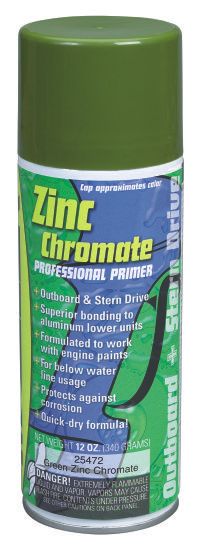

if you want to paint it, you'll want to find some zinc chromate... getting difficult to come by these days...
ryoken,
I've heard of Zinc Chromate, but don't know where. Is it an etching compound or is it a colorant? Reading what I can, it looks like it says that it's both. A colored primer with an etching chemical in it. Since it has a primer in it, doesn't that mean it's a paint prep. If I wind up painting it, that will be needed then. I found where Duracoat is selling a Black Chrome kit that sounds like the black is translucent and you spray a clear sealer over it. It's still a coating and I'd prefer it to be more like anodized if possible.
They also have a primer that sounds like the zinc chromate , but out of the 7 colors only yellow says zinc chromate, the other 6 are heavy duty anti-corrosion. They do sell most or all of their products in professional size containers. The are part of "Sherwin Williams" as are several other brands.
