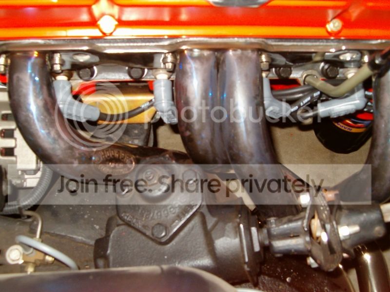

I got the new MSD tach drive dist and wire set on today....custom set as I wanted to run them under the headers.
need to do some tuning now to check the curves in the dist, then move on to the carb..

Always wondered what those little nubs on the top of hte MSD wires were for...
